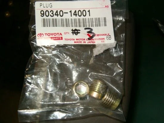

Marshall, when you ordered those plugs, did you have to order individually, or did they come as a pack of 3 ?
Dunno I just told my parts guy to order them and he said ok. Will know early next week.
Edit: Can order just 6.

Solid.......no place for oil. Just grease them with assembly lube or anal lube......whatever you have;)

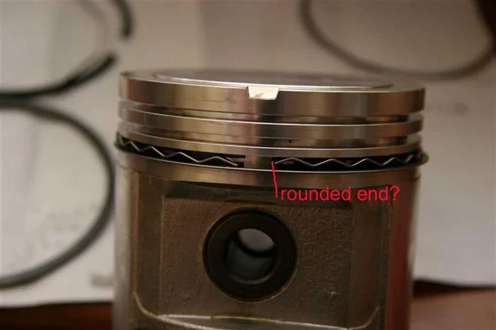

Now this is where I got confused. Where should the gap go for the top two rings? Does it matter. I did them opposite of each other.
Expander
SO is this correct for ring placement? Any tricks?

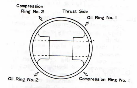

Use the pic below on gap positions..... arrows point to gaps.....left side of motor thrust side......are you using 2 different type rings or just showing comparisons? also something looks strange on that one piston where the oil expander doesn't come together and I don't remember the ends being so crudely cut... Deves is known for their quality workmanship but I believe somethings up here....

I'm somewhat concerned about these Deves rings here Troll.... how bad are those imperfections on the ring side surfaces I have circled in red or is it the camera has them magnified?? and on the oil expander, is one end rounded?? either way on both counts I've never seen such on Deves before..... at this point I would return them and go with the set that came with the pistons.....ITM has been known to include whatever they can get the best deal on at the time on parts (mostly cheap) but what you have there a set of NPR (Nippon) rings, and they are very good also......sorry to butt into your s*** here, but think about it......:beer:
