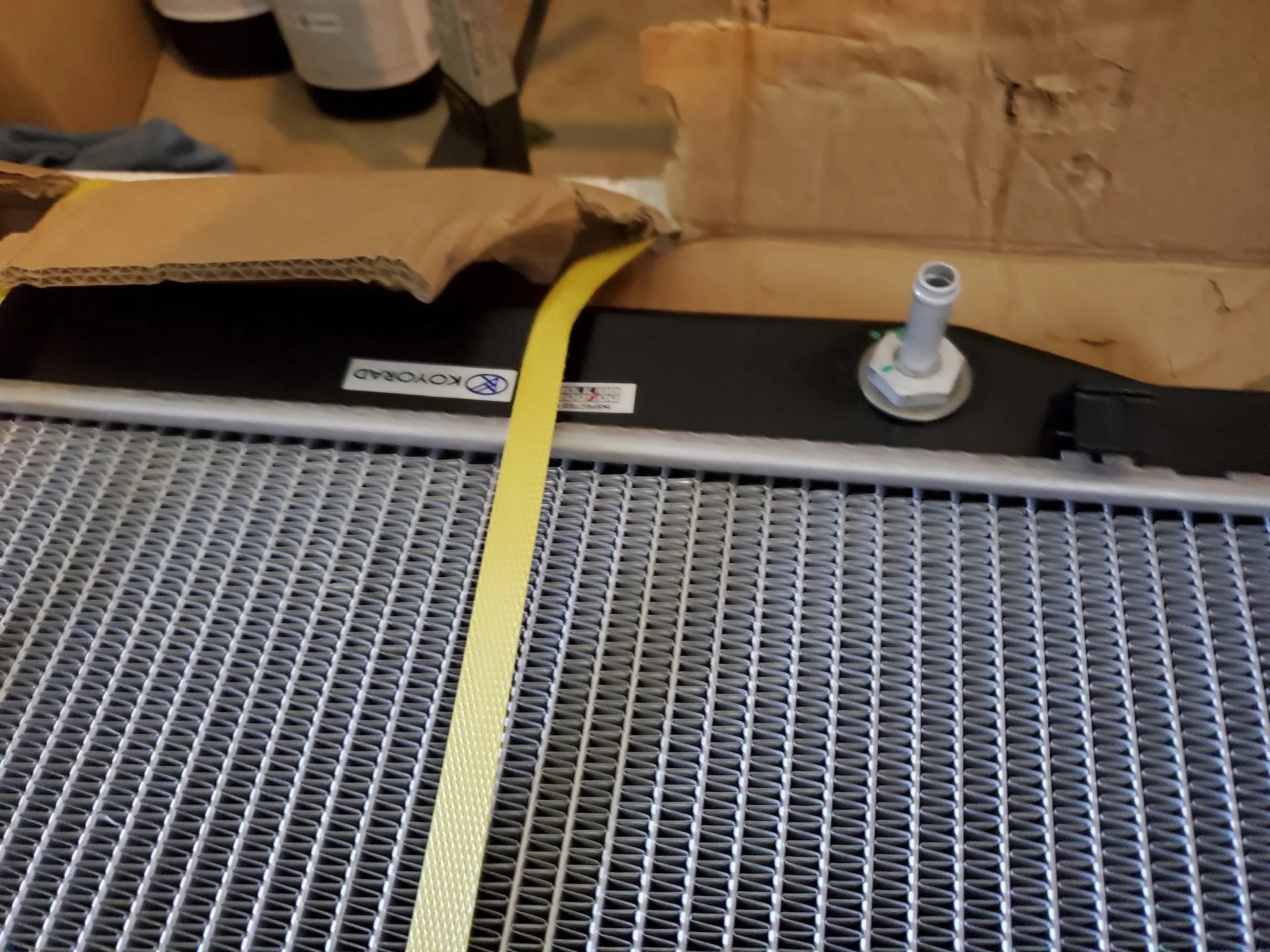

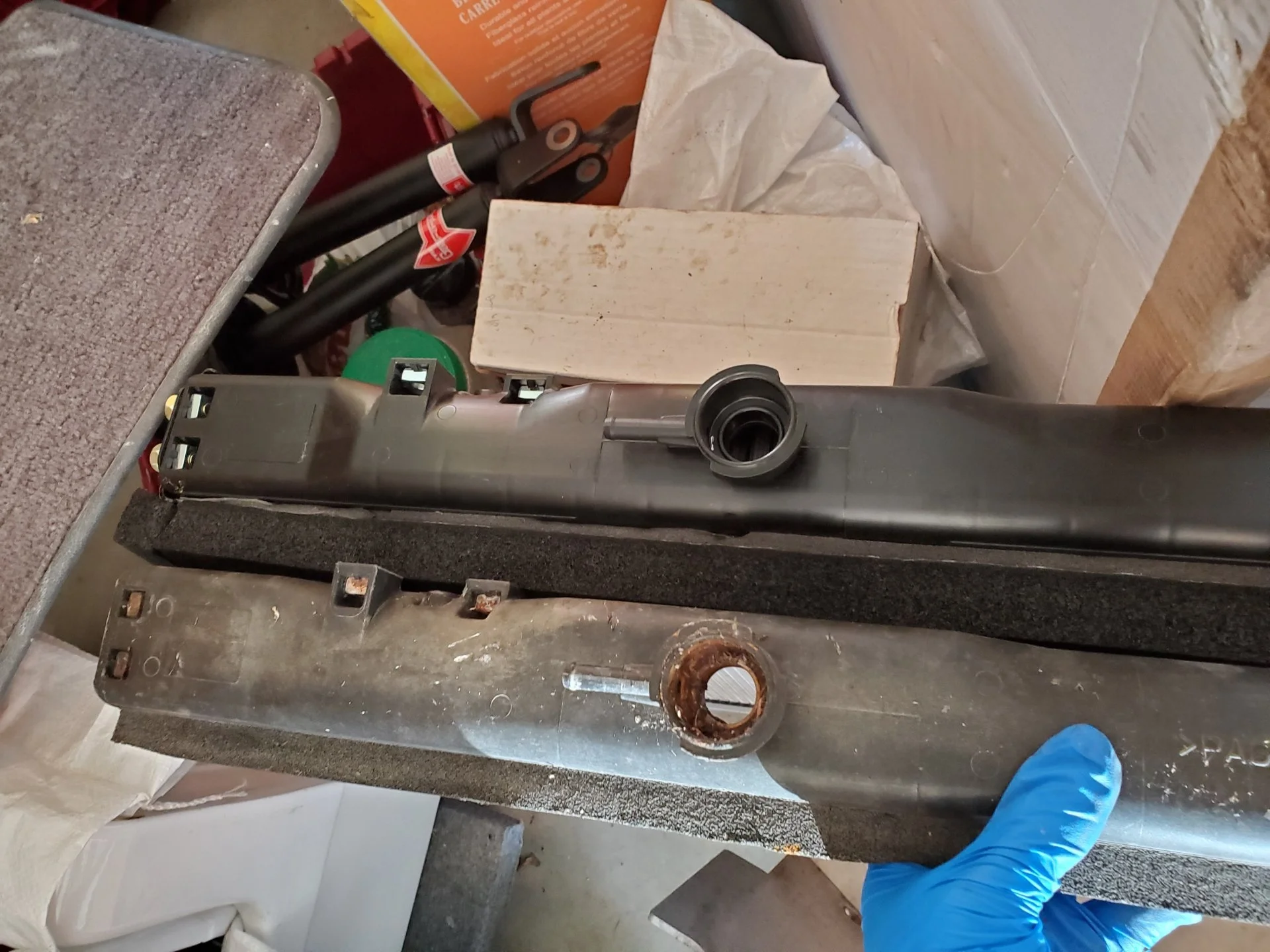

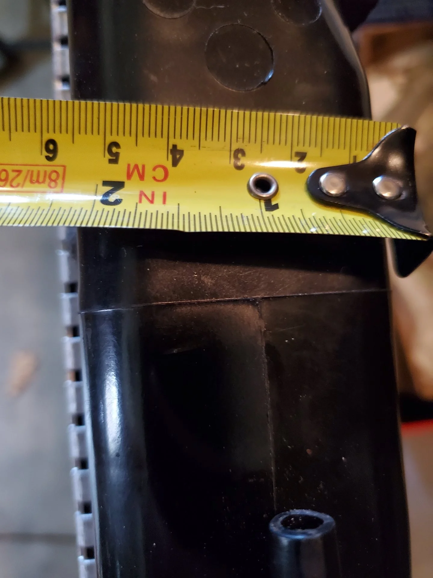

Stay away from TYC 2282. I ordered it because it was same part number as Koyo so I thought it'd be the same. TYC top is thinner than OEM. The trans cooler fittings put strain on the hoses. The coolant reservoir tank also doesn't line up to the rad. The top rad cap is offset by another 3 inches so the overflow tube doesn't reach. It's a piece of junk, waste of my time.
I would've gotten Oem in the first place but darn they are pricey.
Here are comparison pictures:
Koyo
TYC
Top housings compared to OEM:
Koyo
Currently waiting on fipg to dry so I can try out my new air lift pump filling up the rad. Will update if there are leaks but I got all new oem hoses and oem tension clamps.

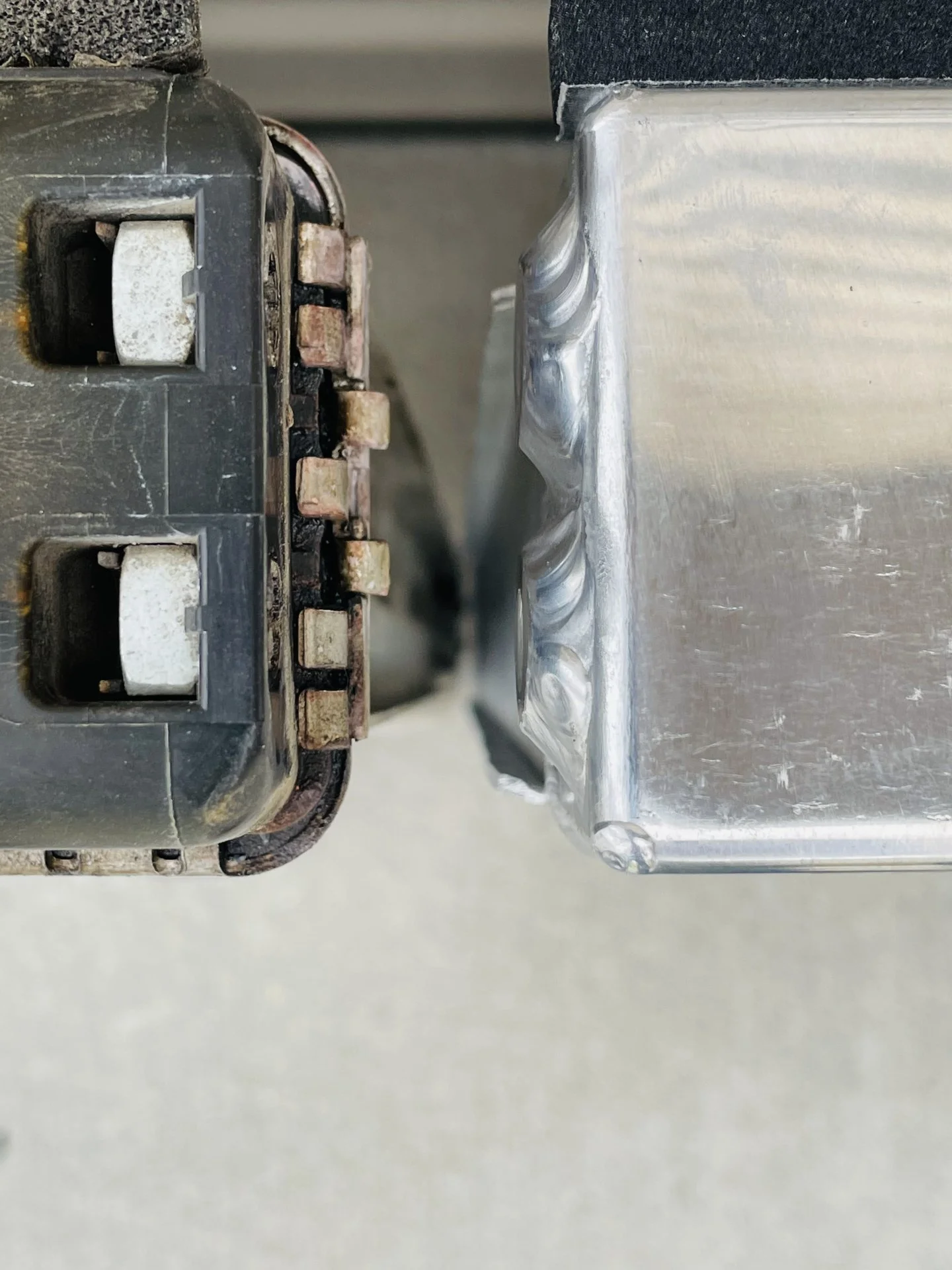

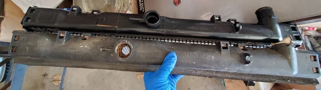

Is that top tank from your 100? How did it get that crusty?
Yeah I seperated my old top tank to get back $7 at the scrapyard in aluminum.

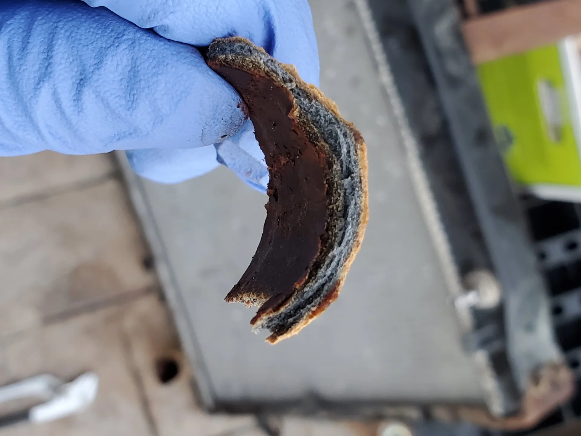

Old rad wasn't even discolored on the plastic tops. However the inlet and outlets were like wet cardboard and discolored to orange. Interesting how plastic wears out and all the plasticizers leach out resulting in this:

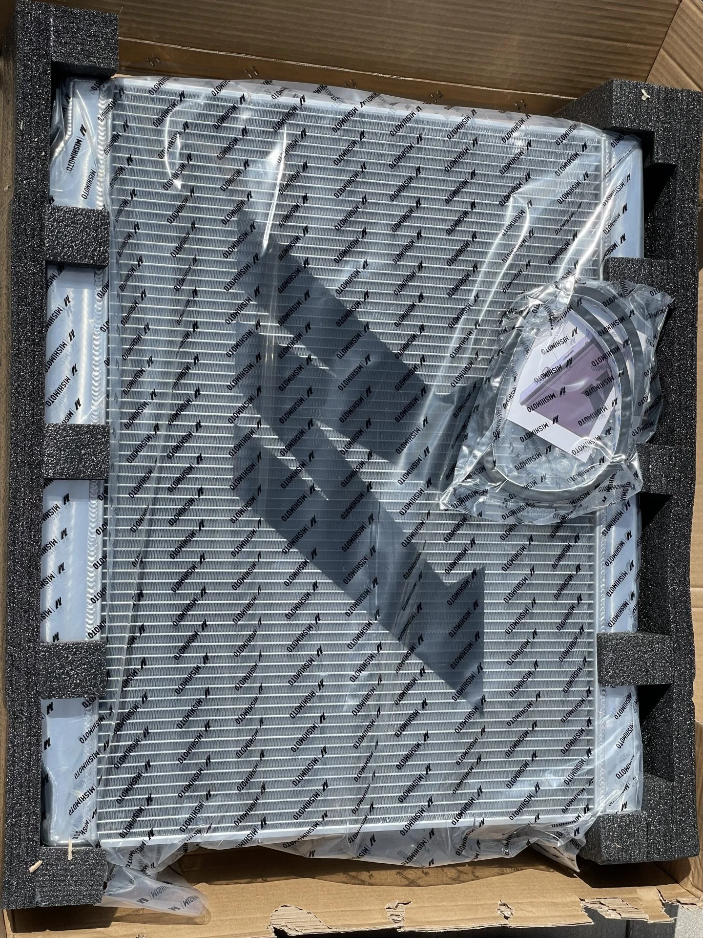

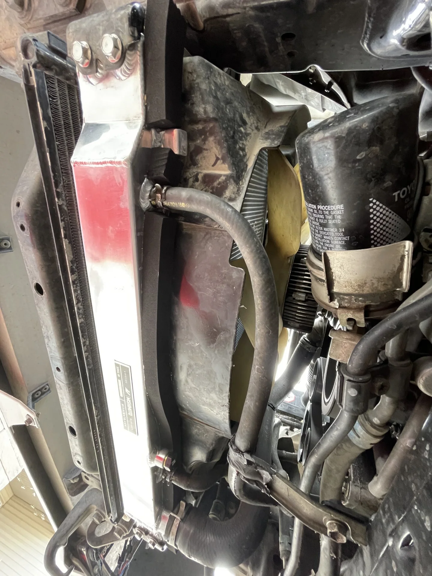

I got it installed awhile back (apologies for the super late posting lol), and have since driven the LX North & South across country multiple times from Glacier National Park to Midland Tx. Hauling car trailers back and forth in 100 degree weather doing 90 and its cool as can be. Highly recommend this for any 100 series owner. Shoot I’d probably recommend a This brand radiator to anyone who wants/needs an uograde. You can Definitely tell right from the packaging that this is a quality product. It was packaged well with double boxing and the foam/plastic wrapping.
The radiator is a tad wider as well, maybe .5 - 1cm? you can see from the side edge of the core.

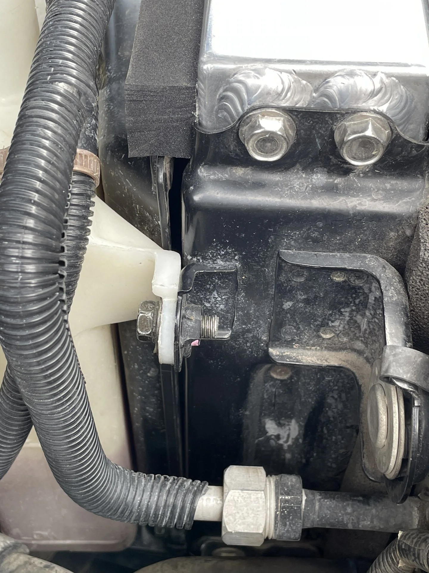

The only aspect I had any sense of discontenment with was in the fan shroud attachment. The radiator is smooth and while the’re are attachment points, the surface contiur differences left a slight gap up top as you can see in the picture below, and a mich bigger gap at the bottom. I used the high density marine foam that I used up top to cover up around the 1/4-1/2 inch gap that went around the underside of the fan shroud. Not ideal, but acceptable enough for what the radiator offers in oeace of mind.

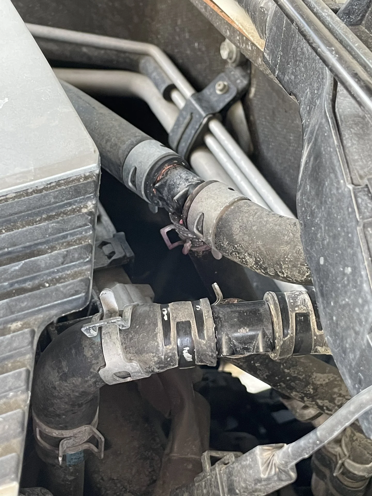

Also, good thing I took the advice on replacing the coolant tees as I was definelt leaking. I bought two of the metal ones referenced earlier from Amazon, but swapped them out after a week for the OEM plastic ones as they kept leaking no matter what I did to try and stop them. OEM may be plastic but they last me 200k so I’ll take that over leaking any day.

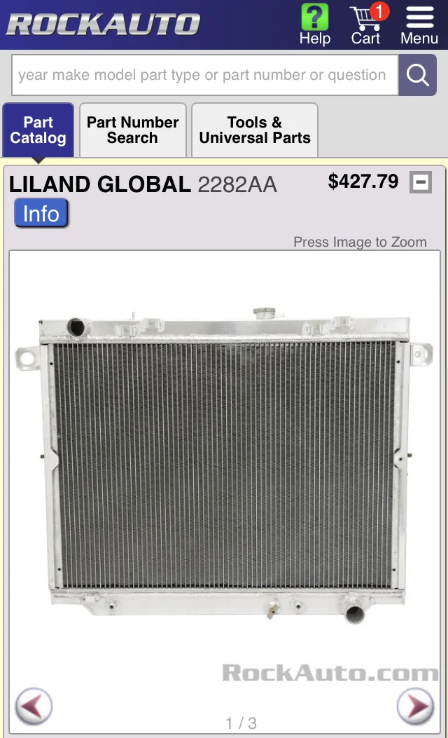

2001 TOYOTA LAND CRUISER 4.7L V8 Radiator | RockAuto
Looks like RockAuto is showing an all aluminum radiator for the LC100 series. Anyone have any background info on this company? It doesn't look like there is a picture of the radiator itself. Not sure if these are the same chinese radiators from ebay/amazon.
Been about three years since this question about the Liland all aluminum radiator on Rockauto for $428 so wondering if anyone has tried it. Any reviews?
