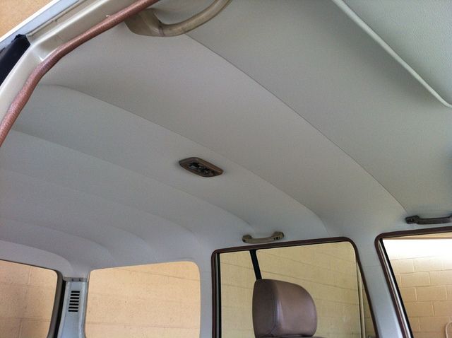

It's amazing to me how many parts from mid-late 90's 4Runners are direct replacements on 80's vintage LCs. I am ordering a set of wiper arms off of ebay right now.
That said, I have a super simple under $50 mod: Dome light replacement. Pulled from a junk yard 1995 4Runner and bolted right in, as if made for the truck. It cleaned up easier than the chalky plastic from my original, and cost less than a lens replacement. I think the cost out the door was $1. It's a bad pic, but you get the idea.
