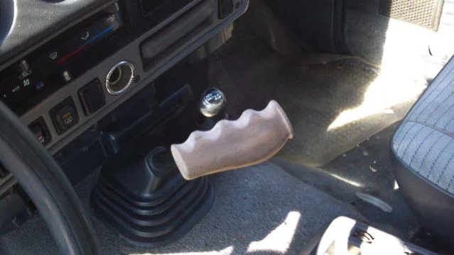

Hand carved shift knob made by me and my hands cost was time made out of walnut very sturdy I was actually surprised I got it right the first time to mount I drilled a hole 3/8 I think dabbled a very little bit of the old trusty jb weld I had in the trucks tool box and threaded her on there very solid and bam one of a kind shifter

Now that I like! You should have the shift pattern laser etched onto it and then varnish that bad boy.

I thought about that man. I recently invested in a rotary tool for engraving thought about trying something with that on some shift knobs im making for some friends who want one I think I can come up with a pattern for more uniformity

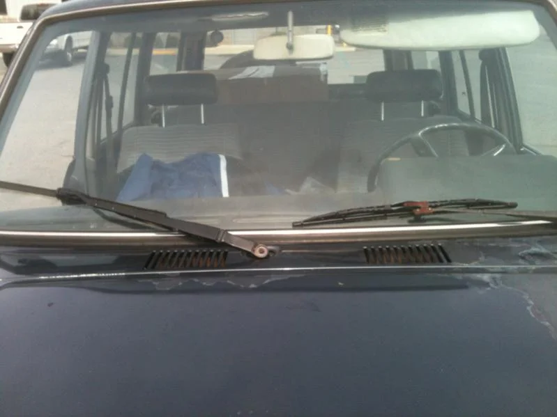

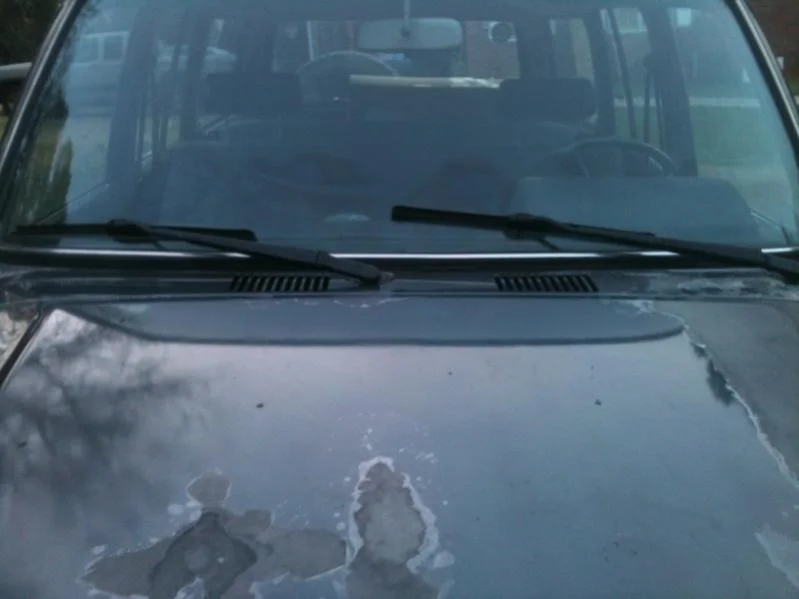

Well I did the wiper mod today and what a difference. I got mine off a '99 4runner from an LKQ junk yard, while I was in there I came across a '95 4 runner and compared the wipers and they are the same. So if your local yard has a different year it'll still fit, I think the guy that originally posted this got his off a '97. Cost me 13 bucks and they even had an almost new set of Bosch platinum blades on them. The passenger side had already stripped the old wiper so I slid it on at the yard to compare and you can see the difference, and then tonight when I got home I installed them. Turned them on and even being dry there were no squeaks so I'm pretty excited about this mod. Now to get the read wiper off an 80 to replace the worn out one on the 60!

Only issue is the washers spray the wiper but well worth the trade off.
Why? Just physically larger?
WHERE in the arc of travel is it hitting the wiper?
You should be able to readjust the angle of the washers using a pushpin or needle. Just put the pin in into the orifice and gently adjust the angle.
It's amazing to me how many parts from mid-late 90's 4Runners are direct replacements on 80's vintage LCs. I am ordering a set of wiper arms off of ebay right now.
