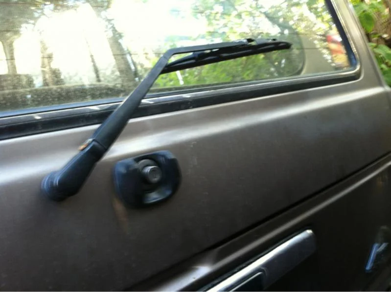

I installed wiper arms from a 97 4runner and 17" wipers. The arms have better pressure and the newer hook type attachment for the wipers. Then used one from a 80 series for the rear.
Good idea!
I just bought some 20" rain-x blades and popped them on for both DS and PS. They don't chatter, nor does the extra blade surface seem to cause an issue with my linkage.
I'll get a pic of the rear at end of weak when I'm home but it looks the same as the original except for the wiper attachment. Direct bolt on. As for wipers I bought some new Michelin hybrids that I'm a fan of so far.
Here's a pic of the rear wiper arm from an 80 series.

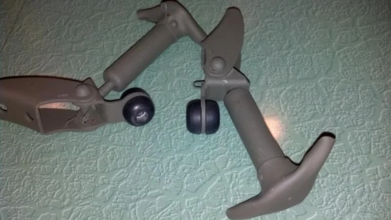

Replaced the dry rotted, hard-as-a-rock rubber bumpers on the hood to apron latches on my 40 with 4 rubber feet from an old PC tower and some small screws and nuts I had here already... Cost: free-ish. Time: 10 minutes.

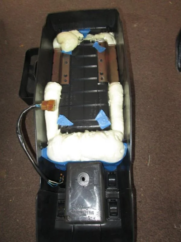

Sound dampening for center consol
Just added some spray foam insulation to the center consol to help get rid of the cheap hollow plastic feel and sound.
I drilled 4 holes in the bottom of the lid and sprayed it in. I used masking tape to mask off some of the holes and prevent the insulation from getting into the switch area on the bottom. Keep some acetone and rags around to clean up the mess as the foam expands. If i did this again, I would get the water based cleanup version.
I'm pleased with the result. The consol has a more solid, less flimsy feel when opening a closing the lid. It also reduces a bit of the noise from items inside rattling around.
Cheers
Good thinking^^^^

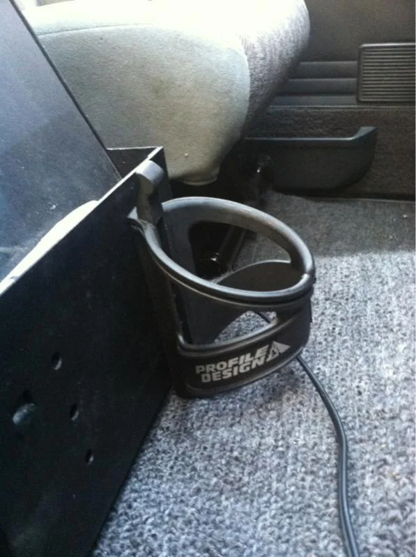

I pulled my stock console out and replaced it with a metal toolbox, but I currently am lacking a cup holder so my best mod under $50 is a roll of duct tape:
Then again it's a trail rig, I have a welder and a grinder so most of my mods are under $50.

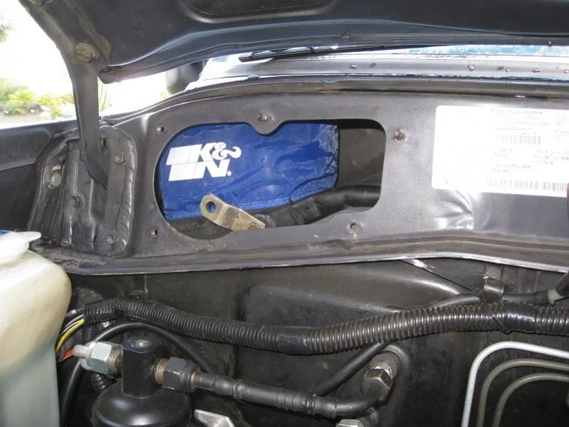

Cool find
Screen for the cabin air intake to keep bugs, leaves, vermin, dust, and insects out of your HVAC system.
$20 - K&N Drycharger Part #22-2020PL. It also comes in red.
Fits perfectly!
That is such a great idea man,after cleaning my HVAC intake i was thinking what to cover it with now i know what to get.:cheers:

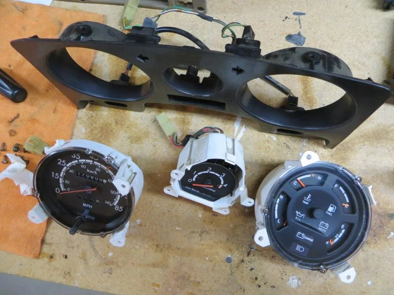

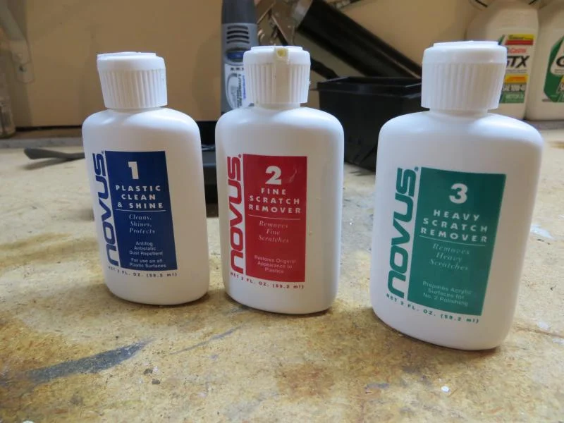

My "new" gauges
I took my dash apart recently to replace a bunch of the bulbs. While I had the gauge cluster out I decided to try to clean the plastic gauge covers. They were badly scratched and very cloudy from ~ 30 years of abuse and cleaning. My tach was so bad I could barely see thru it. I tried a bunch of household cleaners w/o any luck.
I ended up buying and using a Novus product that I had heard about and found on Amazon for $9.00. Starting w/ #3, and ending w/ #1, my gauge covers are now nearly invisible. Total time was < 30 mins. If you are going to pull your gauges for any reason, especially if your are putting in new bulbs, I'd highly recommend this repair. My pic doesn't do them justice...

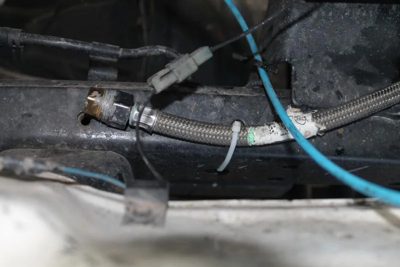

$11.00 replaced the petcock on the radiator with 3/8 compression x 1/4 mpt fitting. To that attached a braided steel faucet line with a 1/2 square plug. Now draining the radiator is easy as can be with zero mess. Thanks to Kevin at Wagon Gear for the idea.
My issue with using a water supply line intended for use in a house is durability. I see many of these lines fail, especially hot water supply lines in my line of work. These are not high quality SS braided lines we see on vehicles. Most are crappy Chinese junk!
These lines are made for temps that never exceed 135 degrees, but yes, at higher pressure than our cooling systems run at. I like the idea, would maybe make a set up with good materials, but would be leery of these in my vehicle.
Doug
Only time will tell if there is a problem. I'm guessing that with the small amount of pressure and location that it will be fine. I have a collection of the hoses so if that were to be a failure point I have many more as replacements.
The same idea could be made with a barbed fitting and any number of automotive intended hoses in any length or diameter desired.
