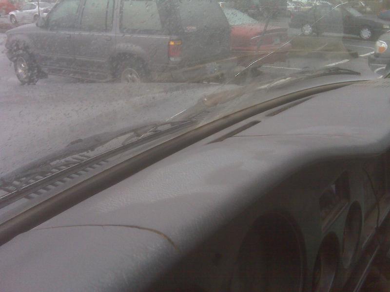

Cracked dash quick and dirty fix, sanded the dash with 80 grit, filled the cracks with silicone, masked and sprayed with bedliner in a can. Not too pretty but better than before I think.
