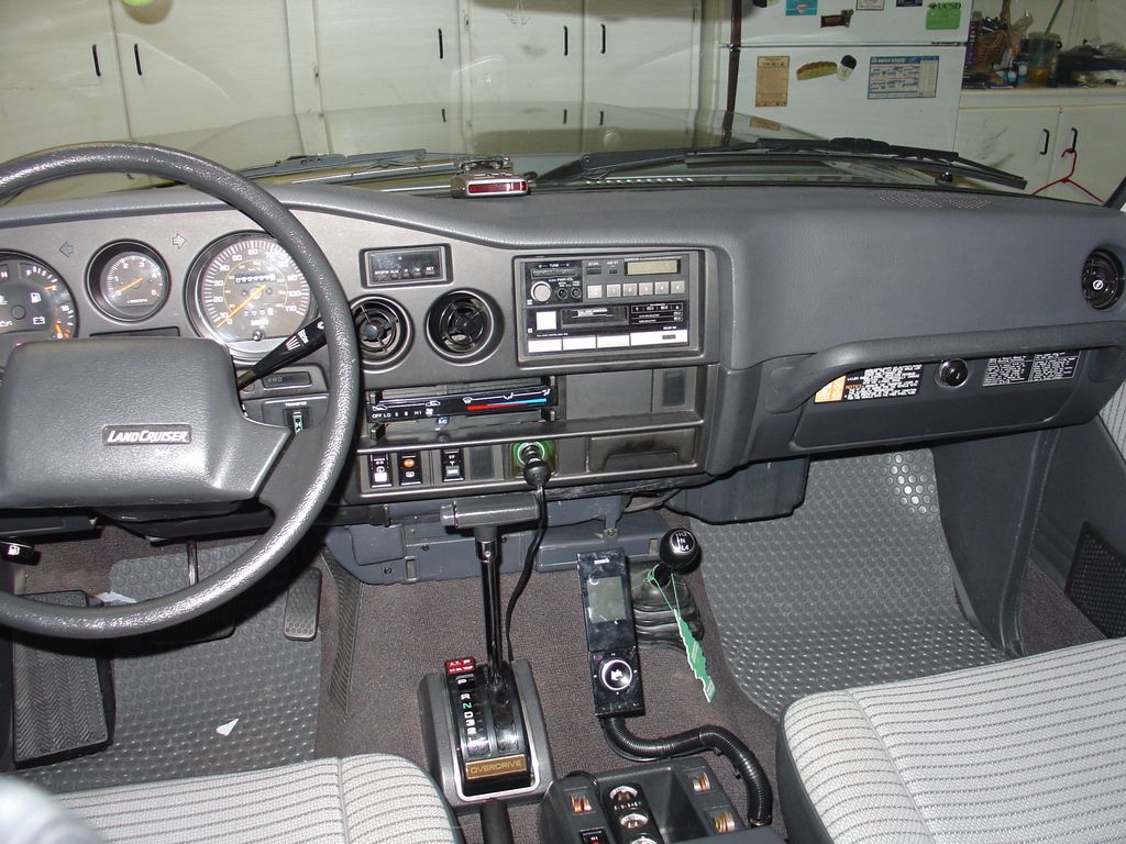

one cig lighter into three...
I picked up this three hole cig. lighter jack that fits perfectly in the console hole in the FJ62. I bought it at a T/A truck stop. I put velcro on one side and attached it to the side of the hole. This one has leds that show low, med, high charge. You just plug it into the dash, run the cord under the shifter boot, then tuck the extra underneath the lighter jack. It fits perfect and gives you room to stash your phone while charging. Not pictured - I also bought the Cobra 110 inverter that will plug right into one of those jacks and charge my laptop also. Here is a picture of the setup.

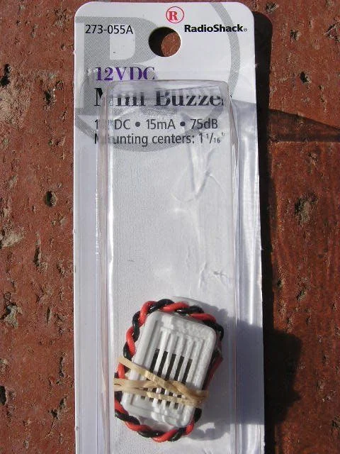

I did it again!! I left my lights on after driving through a daylight headlight section of road. When I got back to the car the battery was DEAD.
I charged it up overnight and then drove to Radio Shack, I purchased a Mini 12v buzzer (Part# 273000055)(NEW PART # 2730059). This is a very small less than 1 in (2.5 cm) box with two wires (black and red) coming out of it. My '82 has the old type glass fuses. '83 and later have the blade type (I believe).
Pulled the headlight (left) fuse and pushed it back in with the red wire between the fuse and the holder. Then I took out the Gauge fuse and did the same with the black wire.
Now if the ignition is in the ON or Acc. position and the headlights are on there is no buzzer. However, if you turn the ignition to OFF and the headlights are on you get a 75 db buzzer telling you to TURN OFF THE LIGHTS!!!!!
The cost of the buzzer is a whopping $3.29. They have fancy 2 tone buzzers and chimes if you want to spend between $6.00 and $9.00.
This is a super easy mod that will save you a lot of agrivation.

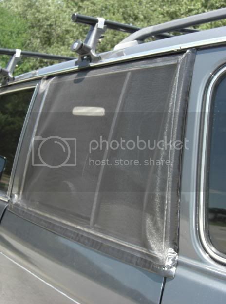

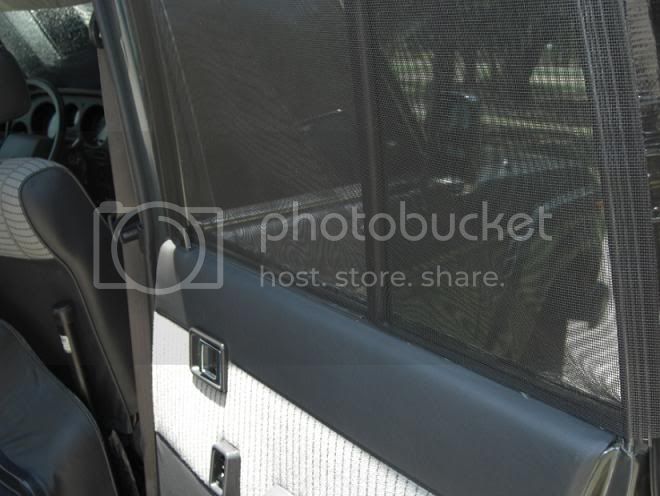

Cheap window screens (appr $15)... Keep the bugs/dirt/debri out while snoozing (or 'cruising') with the windows down. I put these together about a year ago, used them a couple of times and store 'em behind the cargo panels. The construction, generic as it is, has held up over time.
1 - 36"x84" fiberglass screen (makes 2 window screens)
1 - 1/2"x10' magnetic tape
1 - 2" duck tape
1 - roll of fishing line
Cut the fiberglass screen in half endwise. Make a template of the window, fold the screen over the template with one end meeting the bottom of the template and the other end hanging 3" below (cut the excess). Cut the sides around the template leaving 1/4" overhang (the top should be the fold and the bottom remains open). Sew the side layers together with fishing line and seal with duck tape. Cut magnetic tape the length of the template bottom and tape it to the lowest hanging end (leave 1/4" overhang). Fold the screen/magnet over itself, sew it closed and seal with duck tape. Open your door, slide the screen over your window frame, close the door and chill bug free...
The magnet running the length of the screen secures it to the door and the double screen layer does a good job of keeping out bugs.
