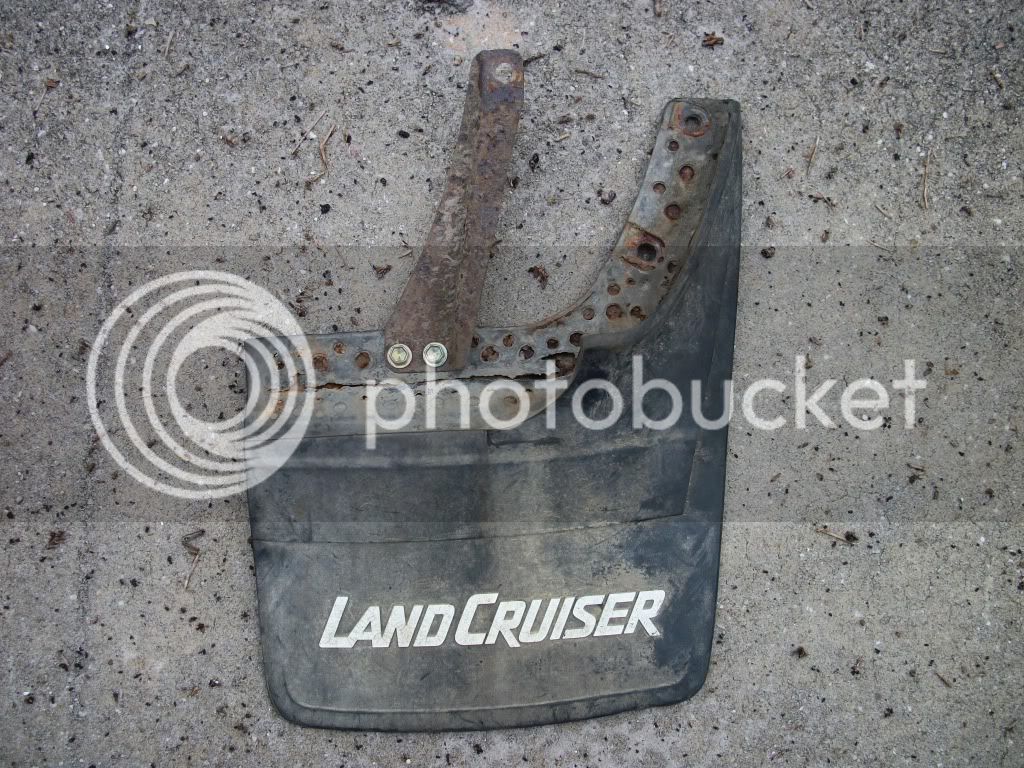

1. Refurbished mud flaps - $3.77 can of Krylon Fusion semi-flat black spray paint from wally-world, $1.50 bottle of gold enamel model paint from craft store.
Before:
After:
Those look great! How did you prep before paint? I wonder how they will hold up long-term? How long have you had them painted?
Only prep was a thorough cleaning. I've had them on for about a week...so far, so good. I've used this same paint to refurbish the wiper cowl on my '05 F150 King Ranch. It's been over a year since I've done that, and it still looks like I just painted it.

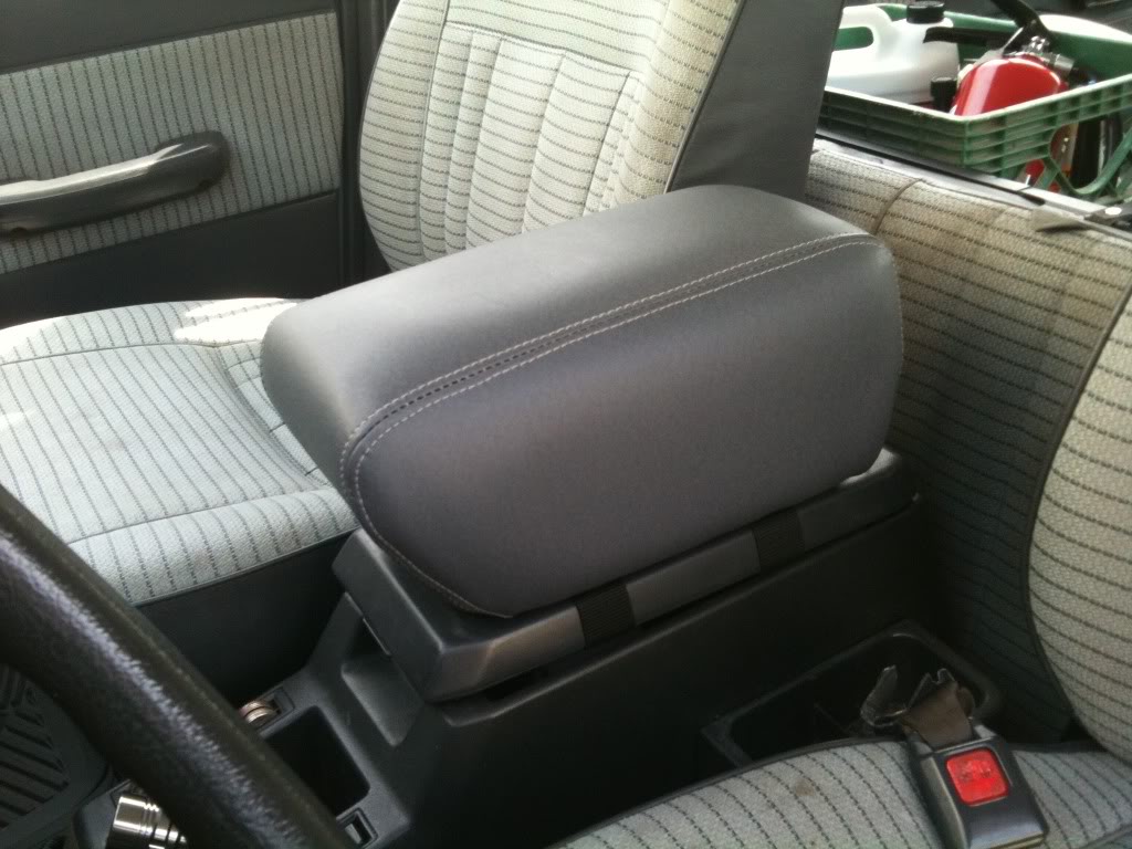

Here's my solution to the awkwardly low OEM center console/arm rest. It's definitely improved my posture:
DC88FJ62- I would be worried about slamming on the brakes and haveing that fire extinguisher coming at my head :doh: more than I would be about a a quick release mount. They fit good under you front seat and is pretty easy to get to

Anyone know where to get Krylon Fusion semi-flat black spray paint online? No local stores seem to carry this stuff...
They look good now, but honestly, give them 6 months and they are going to look worse than before. Chances are that paint is not flexible when dry; it's going to flake off everywhere, it's not going to stand up to the elements.
Run to the store and pick up some rubbing compound and turtle wax, should cost you about $15 tops. Start off with the rubbing compound, scrubbing in circular motions for about 10-15min, then skip to the turtle wax to buff it up. It should clean up to look brand new looking. As for the "LandCruiser" decal, I would suggest applying paint by hand with a brush (ends up being thicker than spray). Having the Land Cruiser badging being thicker rubber, the letters themselves will see next to no flexing and should stay painted.
You can use the rubbing compound/polish on all your taillights, marker lights, signal lights, and any other rubber on the vehicle. All the compounds are doing is acting as an abrasive and removing a slight layer revealing new rubber/plastic.
I bought it from Wal-mart, they had several colors available.
I hand painted the letters using Testor's enamel paint for model cars. It's also easier than trying to mask around the lettering.
