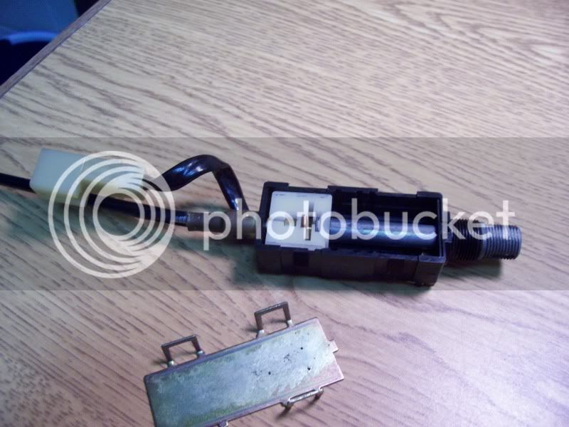

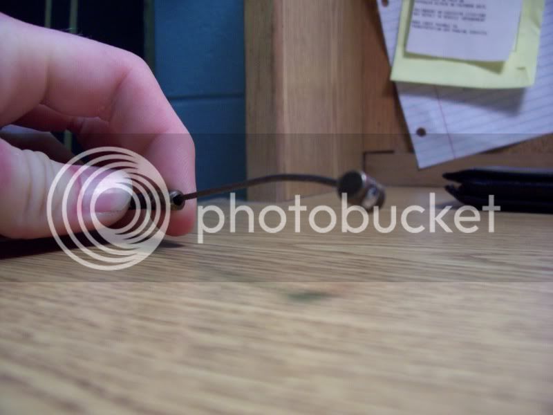

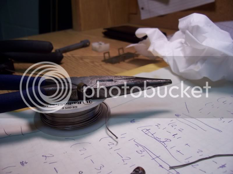

Rebuild your choke cable.
Price - $10.85
Time - 1 hr.
Difficulty - 3/10
My choke cable had been snapping and was really hard to pull. The old plastic coating had cracked off and was kinked in some places. I ordered up some new cable and conduit from flander's classic cables. The stock cable is .047". I ordered 6 ft. of 1x19 stranded cable at .36 cents a foot. As for the conduit, Flander's noted that the nylon lined cable was slicker, so I ordered 2 meters at $2.31 per.
First remove the choke assembly.
Cut off the shrink wrap to get to here. Pry up the covers' tabs with a small screwdriver and remove. Nothing will jump out.

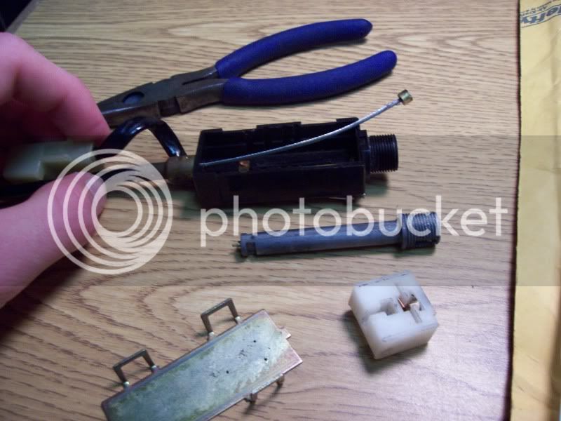

Now remove the white plastic block. Two small springs and ball bearings are compressed on the sides of the block. They are not super strong, but they will try to come out. They are there to give the clicking feeling when the choke is pulled.
Now get your soldering gun warming...

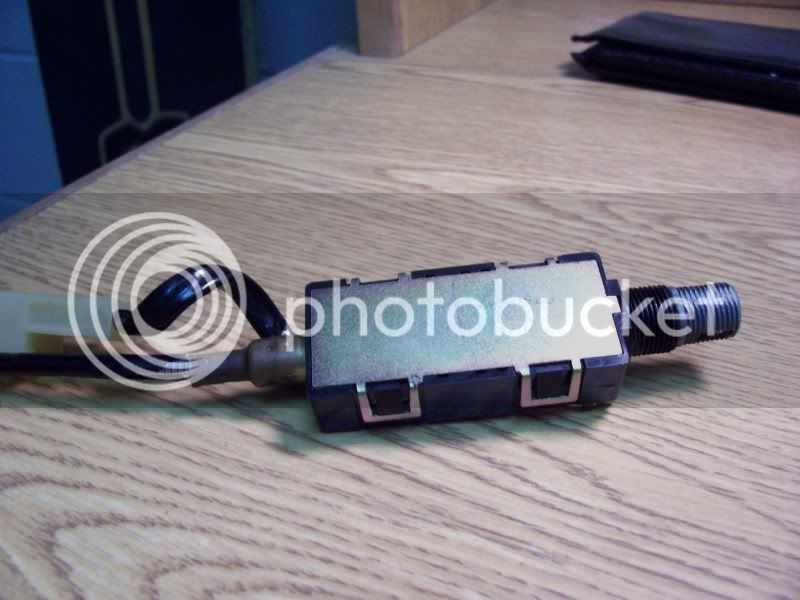

Heat up the solder and remove the barrels on the ends. Save them to put on the new cable.
Somewhere in these steps you must remove the old conduit from the clicking/mechanical terminal. Mine happened to pop out under compression when I went to push the choke in one day. Crimp the new conduit in it's place, and solder on the barrels onto your new cable. Before your done, wrap the housing in electrical tape to prevent shorting between the metal dash and the external terminals.
The new cable is so smooth you can hardly tell if it's even attached to anything.

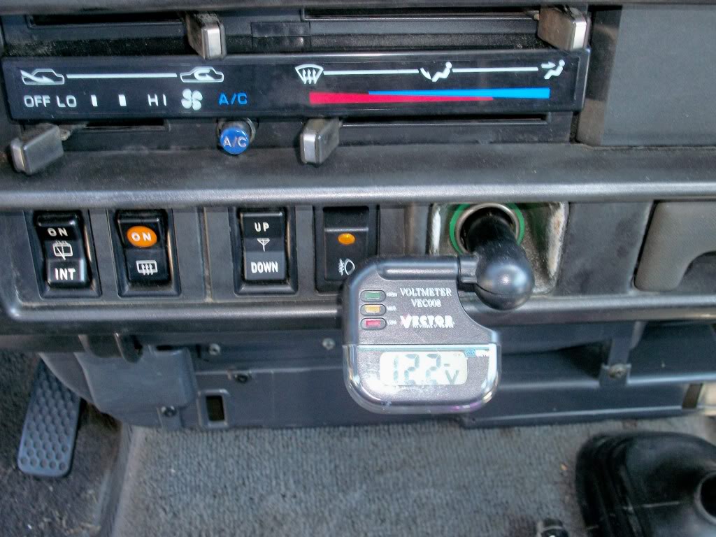

1. Refurbished mud flaps - $3.77 can of Krylon Fusion semi-flat black spray paint from wally-world, $1.50 bottle of gold enamel model paint from craft store.
Before:
After:
I also did the bumper caps:
2. Clear turn signal lenses - $30.87 shipped from ebay

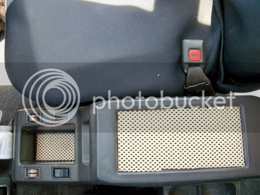

3. Drawer liners cut to fit inside of console, console lid & front tray - free, had leftovers from kitchen remodel
4. Digital voltmeter - around $15.00 from Autozone, I think. I've had it a few years in other vehicles. It's backlit, so you can see it at night :clap:.
5. Re-wiring the side markers to work with the running lights and turn signals - free - had the wire and connectors on hand. Do a search...works great!

[Quote 3. Drawer liners cut to fit inside of console, console lid & front tray - free, had leftovers from kitchen remodel
QUOTE]
Only problem with this picture is that if I left 18cents in my console in DC, some crack head would smash out my several hundred dollar window and bust up the interior for that kind of loot!
Seriosly, storing pennies in the rig?
Were you the guy the other day in front of me at McDonalds that took 20 minutes counting out exact change?:D
I liked the liner idea, I did the same thing with extra waffle mat material, attached it with velcro so that I can pull them out and clean out all the crumbs (maybe once a year )
I also pulled out my ashtray and painted the inside of it with that rubber dip paint, I keep my change in there and it does rattle around.
QUOTE]
That crackhead would hit the lottery if he hit my truck...those aren't pennies my friend, but quarters!:eek: You're lookin at $3.75. Actually, it's $6 now cause I filled up the other 2 slots.
Like the velcro idea BTW.
