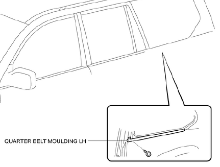

@Scat Adams How did you remove the screw for the rear quarter panel trim?
Pic of trim shows the hole that looks like it's for a screw. It's behind the glass though.
https://photos.app.goo.gl/9bFxlSUiEw1iHGVu1
The FSM also indicates there's a screw. FSM tells you to take apart the whole inside...
@teejnut I just did mine as well and it wasn't too complicated to get to the bolt. You need to remove some of the trim around the window and on the c pillar . I put some pictures on the "what did you do with your 120 today?" thread a few weeks back of what you need to do.
Sorry! That picture doesn't really tell the whole story I guess. There are a bunch of clips on the panels around the window from what I remember and you just have to pull them off, some are more stubborn and I was worried about the airbag but you don't actually touch it. IF I would have thought to break it off I might have gone that route :doh:
Haha I even followed that picture you posted and still couldn't figure it out. Oh well.
So it looks like I just need to remove the weather seal and then pull out that one panel only?
@GonzoShinyPants from my experience once the torx is removed you just need to pull up on the trim piece, I used my hands and definitely bent the chrome trim piece in the process. There are clips on it that are holding on pretty well.

I still need to swap out the rear quarter panel moldings. Seems like the proper way is to remove the rear quarter panel glass :(

@teejnut I thought others either cut the screw or were able to remove the inside trim to get to the screw and pull the moulding up and out. Hmmm
Yeah those are the two options it seems. I'll probably try removing the trim to get to the glass just haven't made the time. The screw is behind the glass on the side closest tonthe side door.
