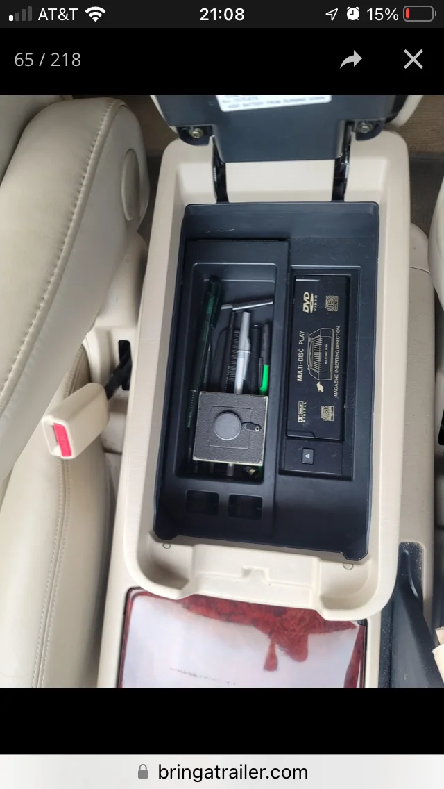

@BenCC I saw this tray on an auction vehicle recently (on bringattailer). I’ve never seen this OEM personally but maybe it exists? If not, it could be a nice complement to the CD/DVD changer replacement.
I believe that's a factory part. There is one in my 2005 LC.
This should be the Toyota part number, but might be NLA:
5882360030​

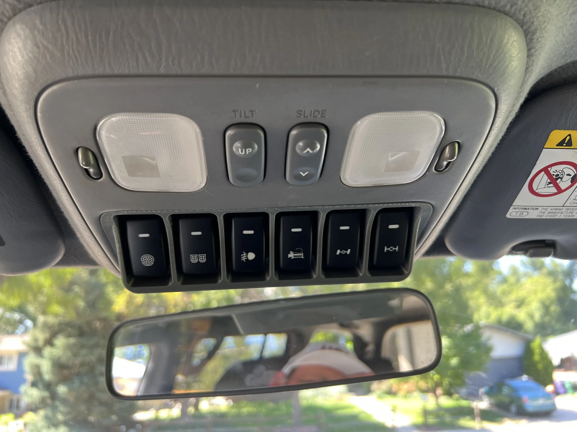

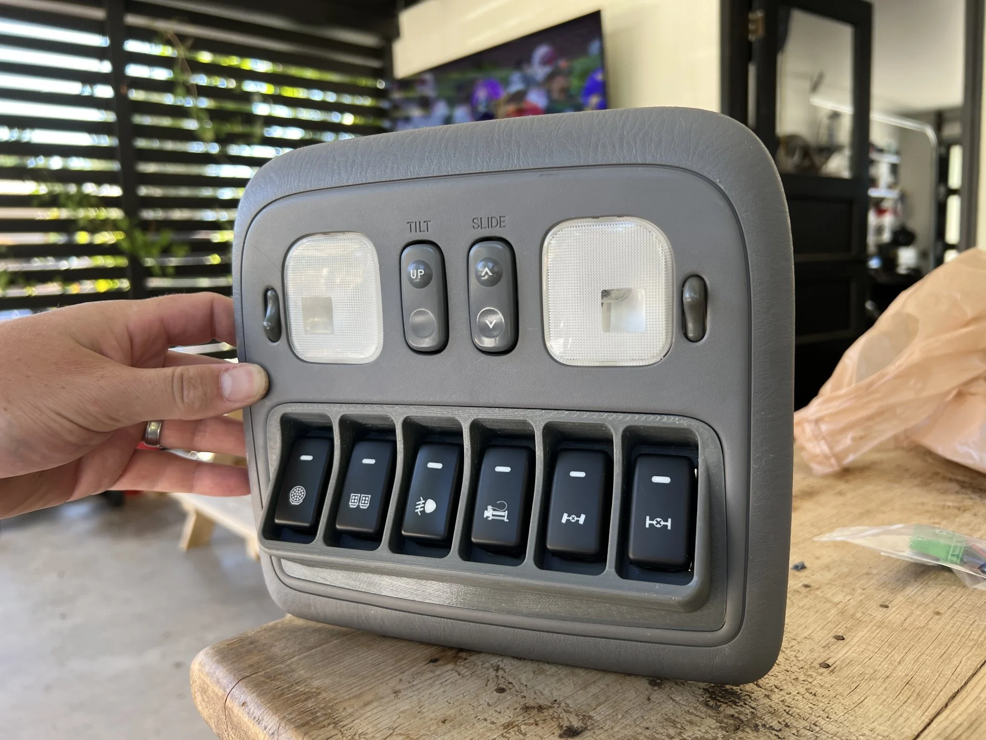

The hole size in your mount is standard carling size. I have fit tall skinny Toyota size switch in a Carling hole by simply wrapping the outer edge of the switch in one layer of Tessa tape. It made the switch fit snuggly and not rattle at all.
Thanks for the insight, I will go this direction first.
Of course, wrap it in tape. My lack of innovation is appalling.
Mine required a layer of 3M double sided mounting tape and tessa tape, but they are in their positions nice and snug.

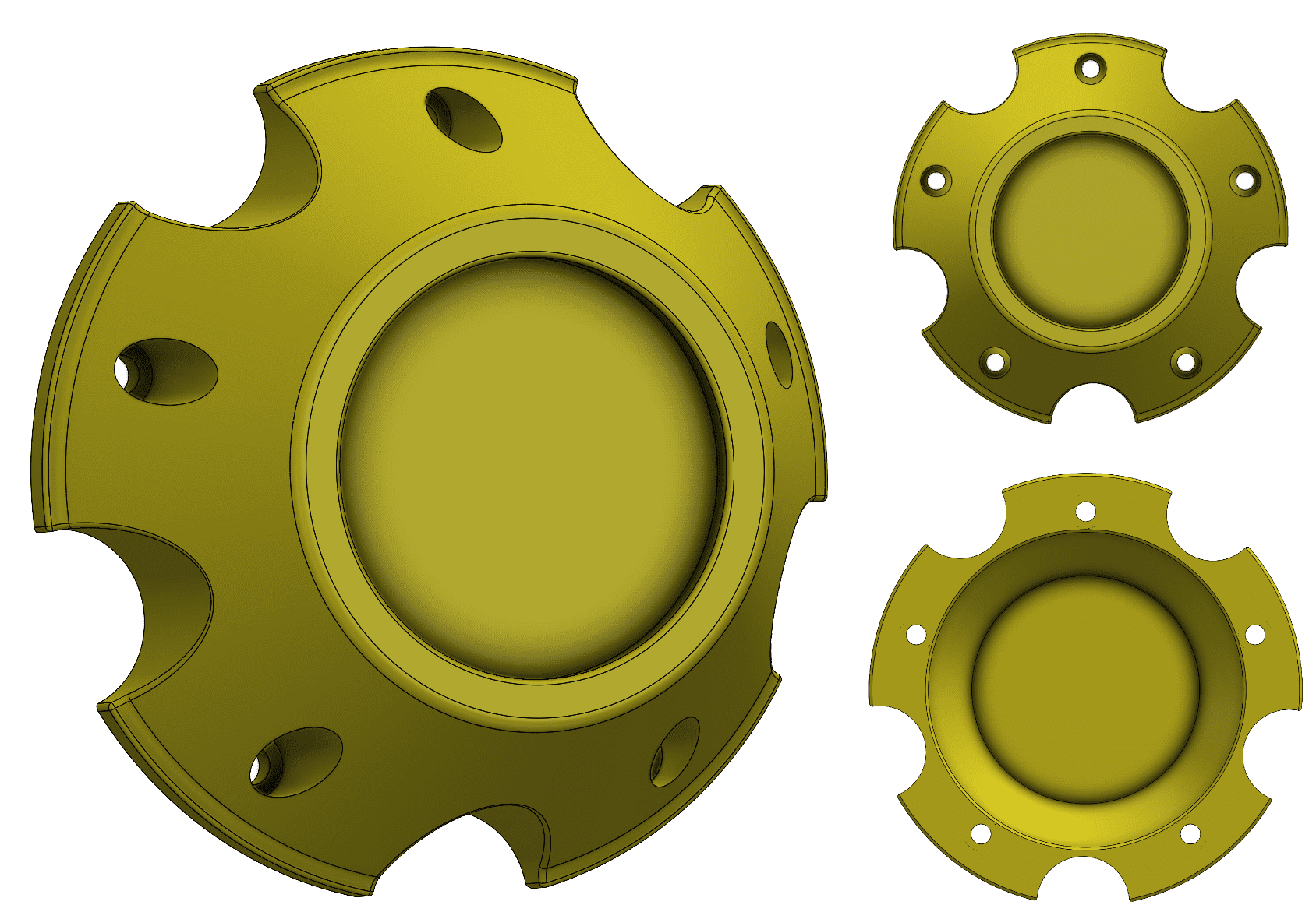

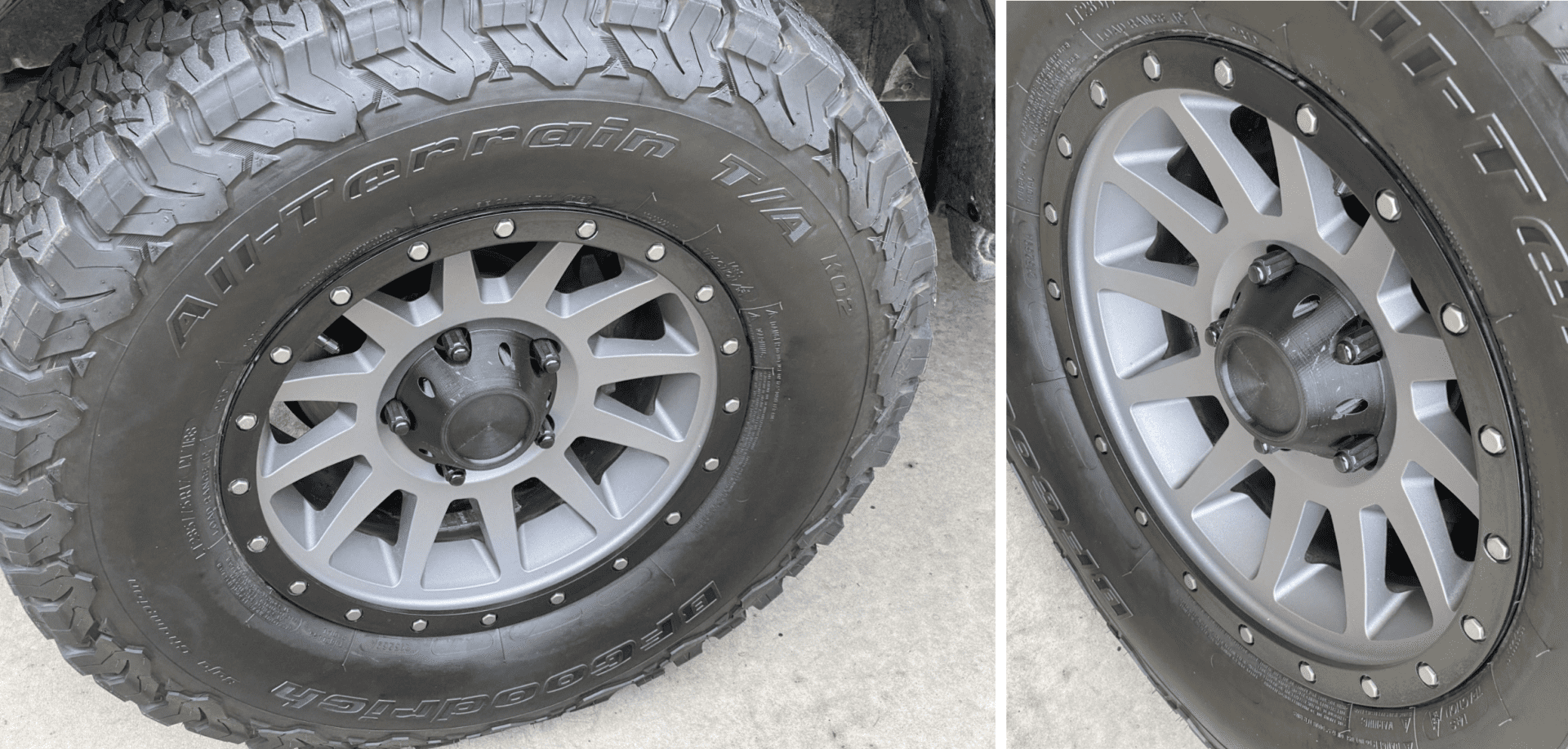

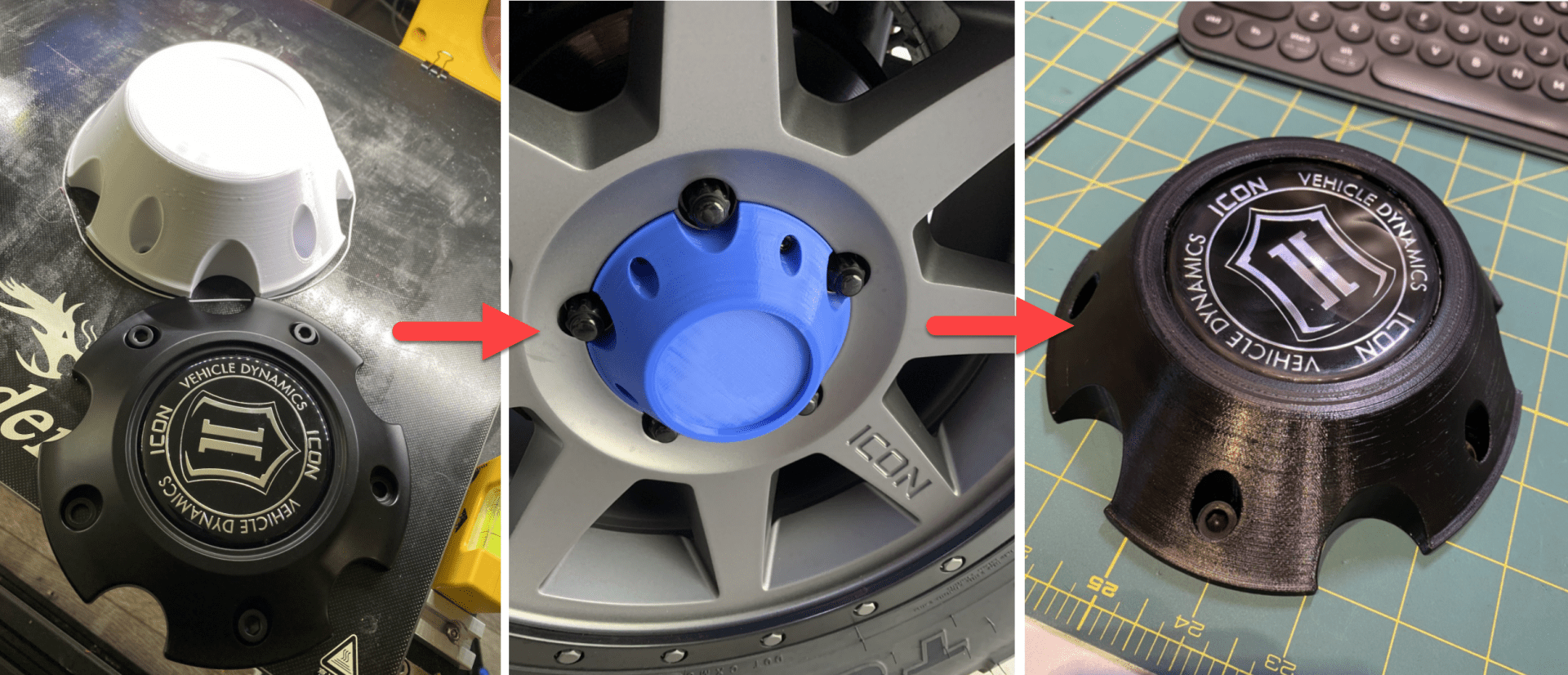

Make 37 Icon Compression/Rebounds Wheel Caps
1 Overview of the Final Product
Photo credit to @larryt.
2 Introduction
The caps work on Icon Compression/Rebounds wheels. Thanks to @Dparo. He mailed his wheel cap to me. With a couple of iterations, M37 finally has all its dimensions fitted with the wheel. You can reuse the sticker from the original caps.
3 Purchase
$100 for a set of four caps plus shipping.
PM for Direct Paypal Payment.
I am interested in purchasing a set of these M37 caps. I just had some ICONS installed on my 2003 LX and the front two wheels need this solution to cover the hub. Please let me know how to purchase.
