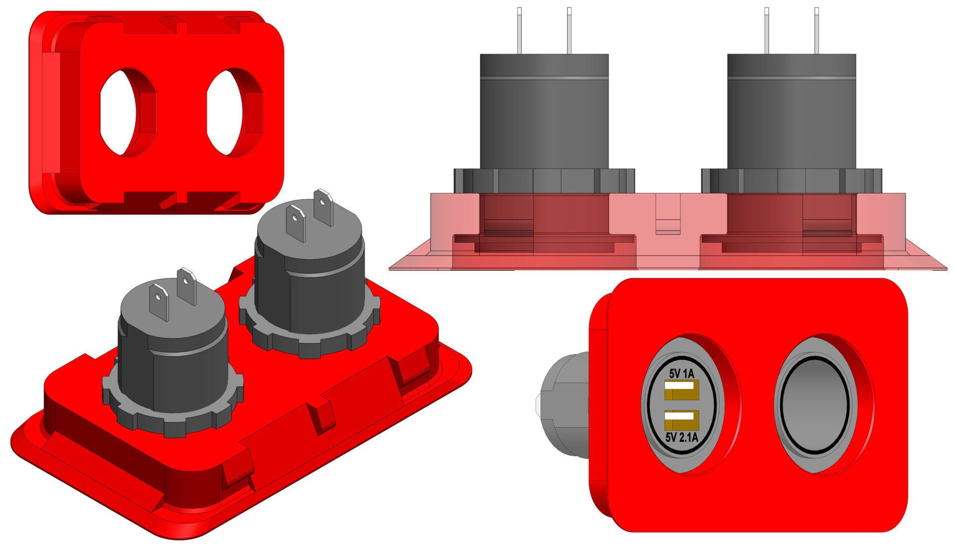

Note: Make7 V1 mounts two 12V socket devices, such as
12V Socket
USB Extension
USB Charger 2.1 A
USB Charger 4.8A

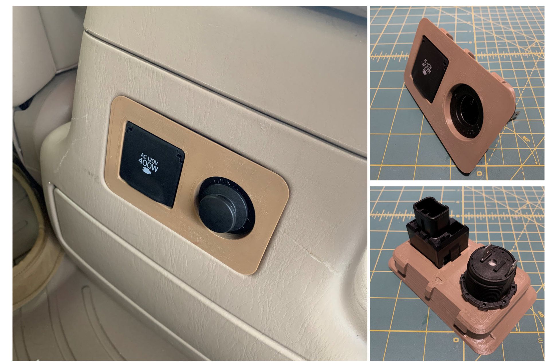

This mount it to replace the blank panel or the radio control unit at the back of the center console. It mounts two car socket devices.

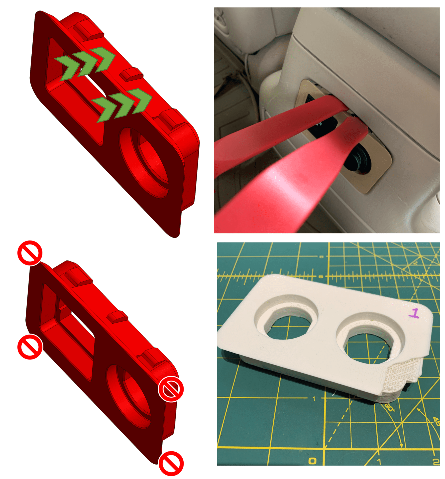

Note: The following figure shows how you remove the mount and how not to.

Stupid question maybe, but where are you getting power for the 12v outlets? I plan on getting one of these to add some usb ports but I also want to find some power under there to tap into for my two headrest monitors. Are you tapping into existing wiring? Or are you running wiring with an add-a-fuse or something?

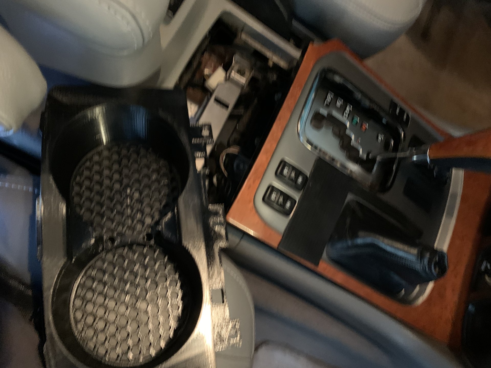

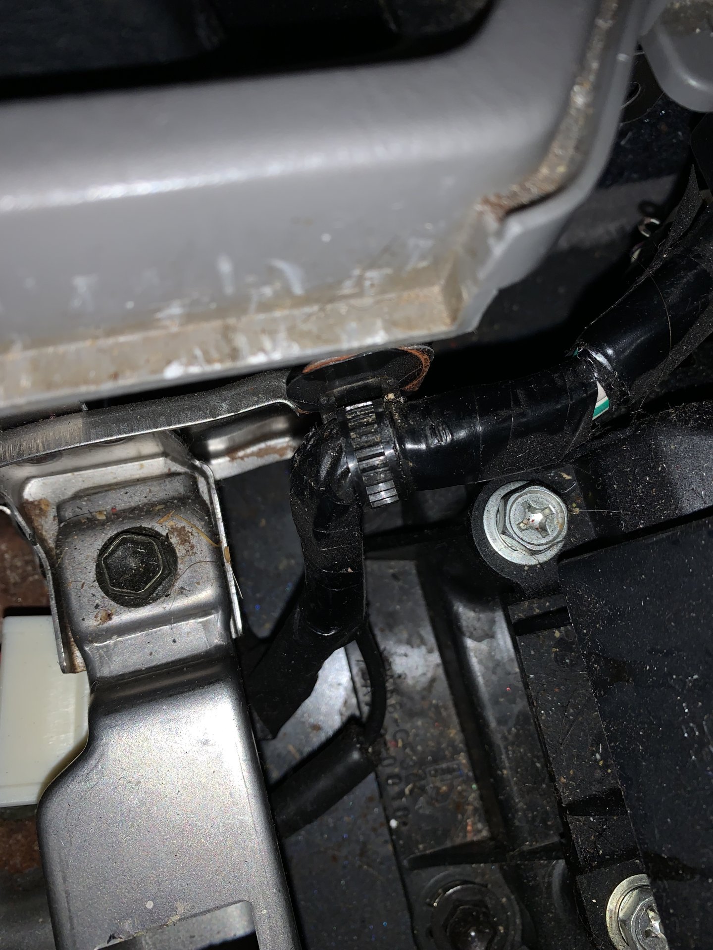

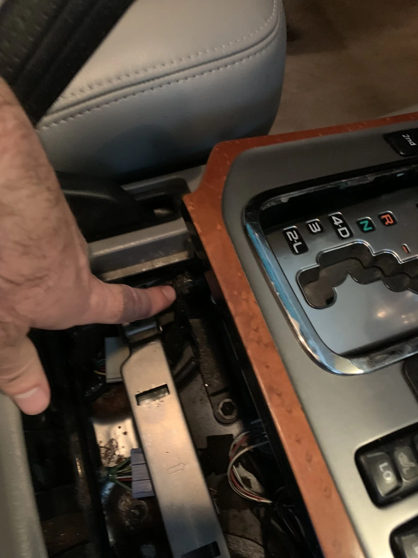

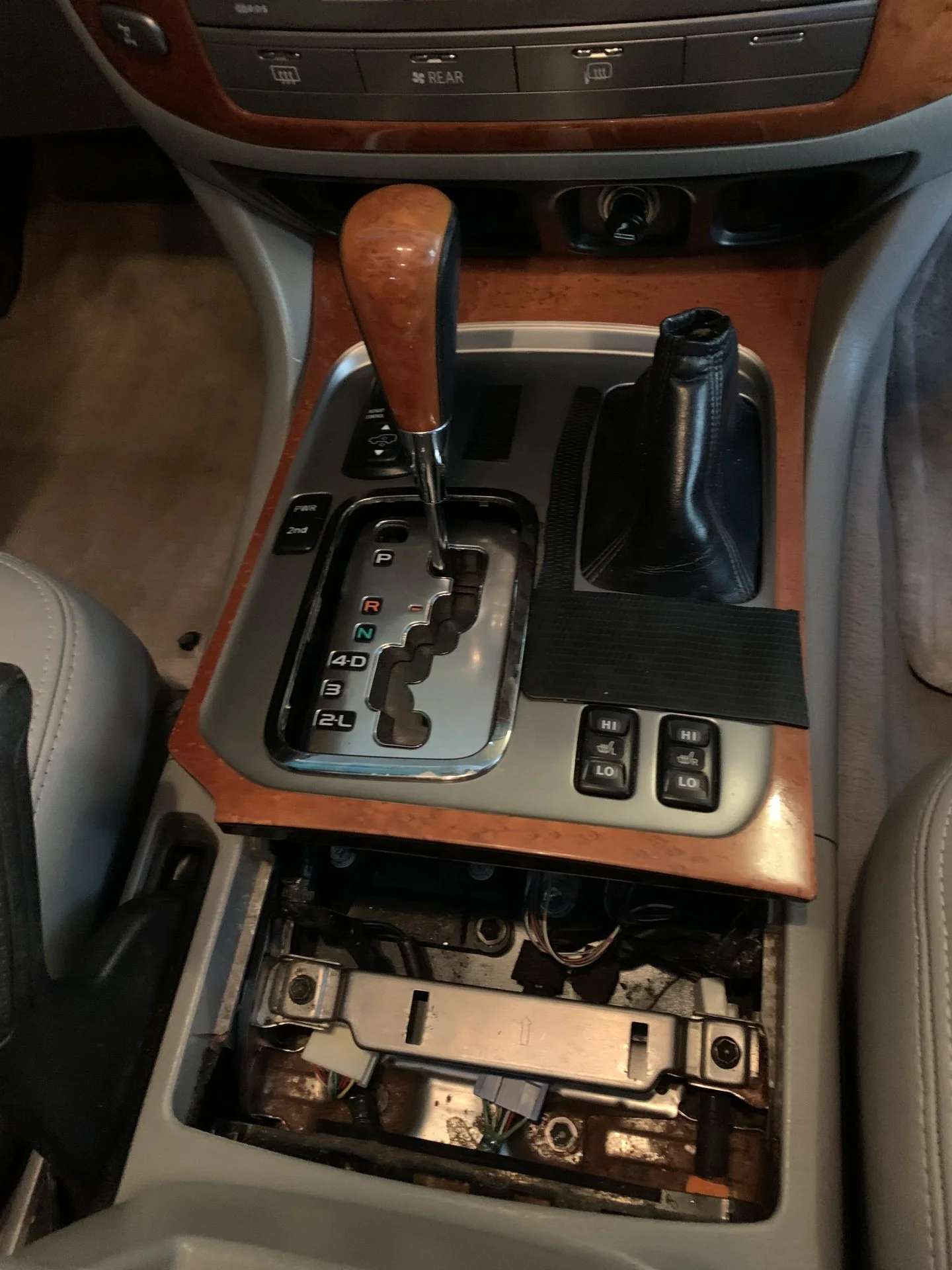

Ben…or everyone. I’ve been trying to install the cup holder in my 2006 LX 470 and have run into a problem. There is wiring on the drivers side/by the e-brake that is not allowing the cup holder to install. Has anyone else run into this? How do I resolve this issue? I have a CD changer in the center console…is wiring for cd changer?
This was a clip. The cupholder fit once the clip for the wiring was released. I'm curious, is this exclusive to an LX 470 or maybe specific years? Another question, if others have installed this cupholder and have run into this same issue what they did with the wiring? Seems to me you'd either have to leave the wiring dangling or create a new way to fasten it lower in order to install the cupholder.
