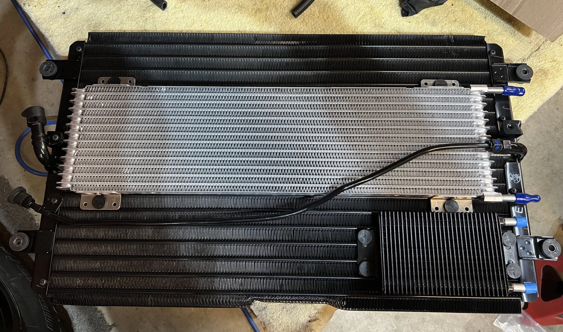

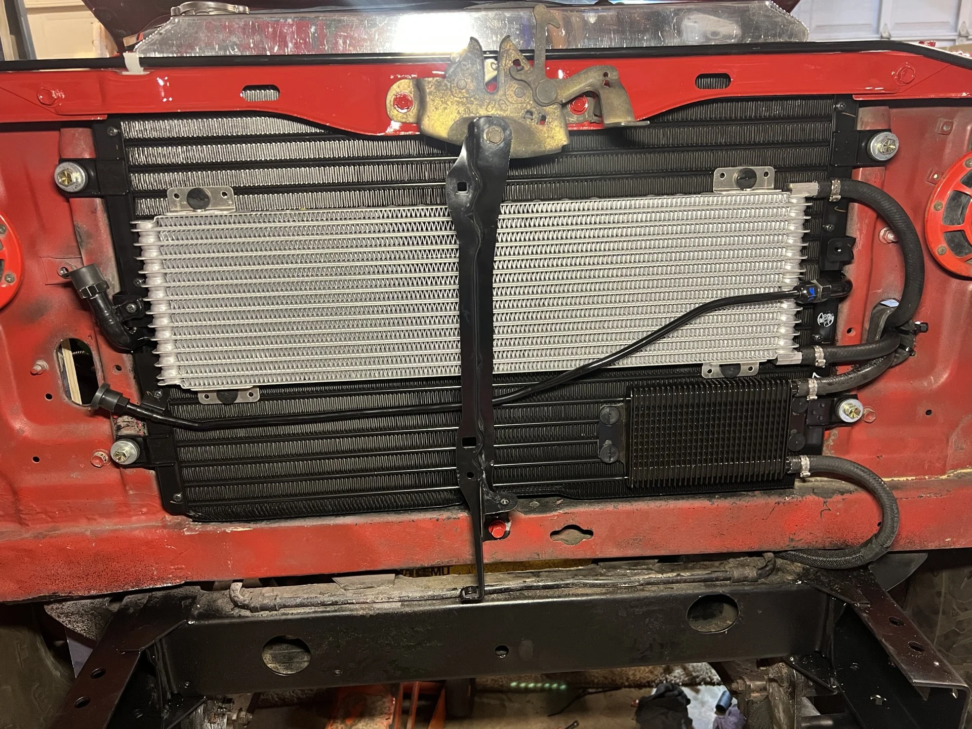

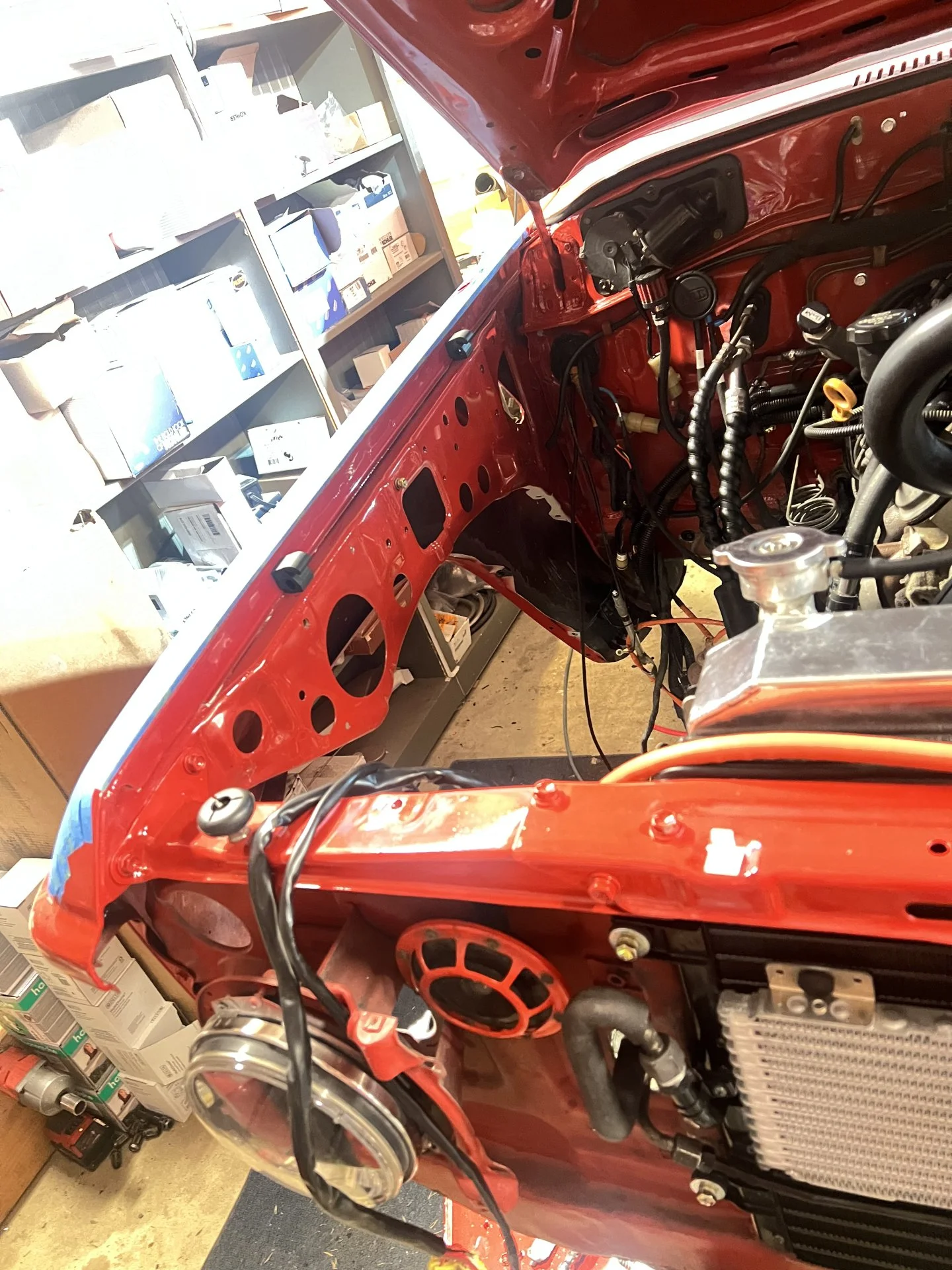

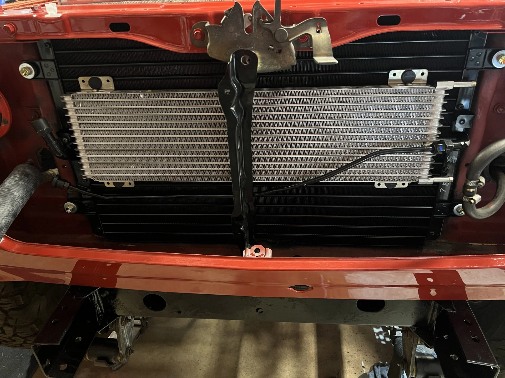

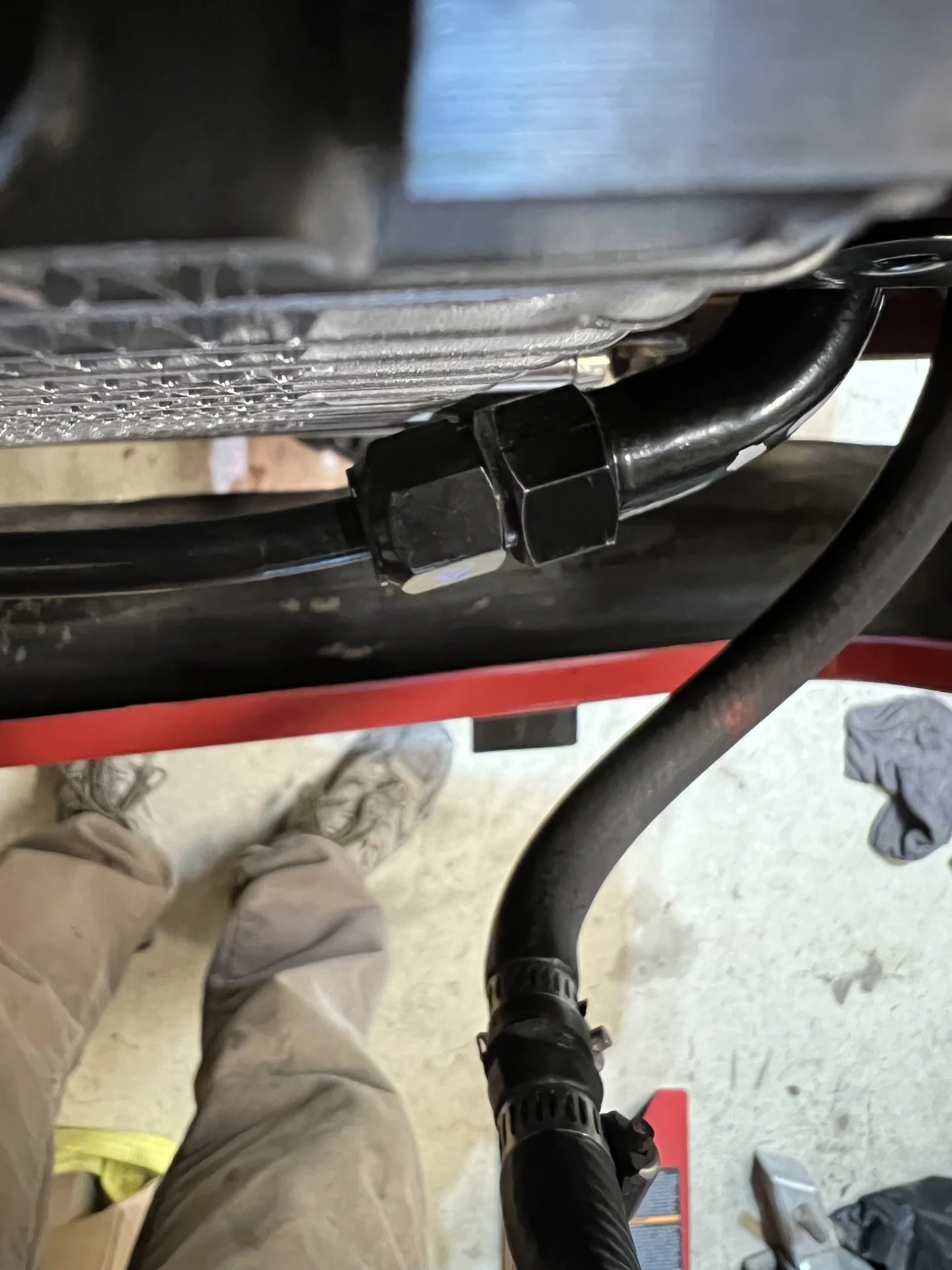

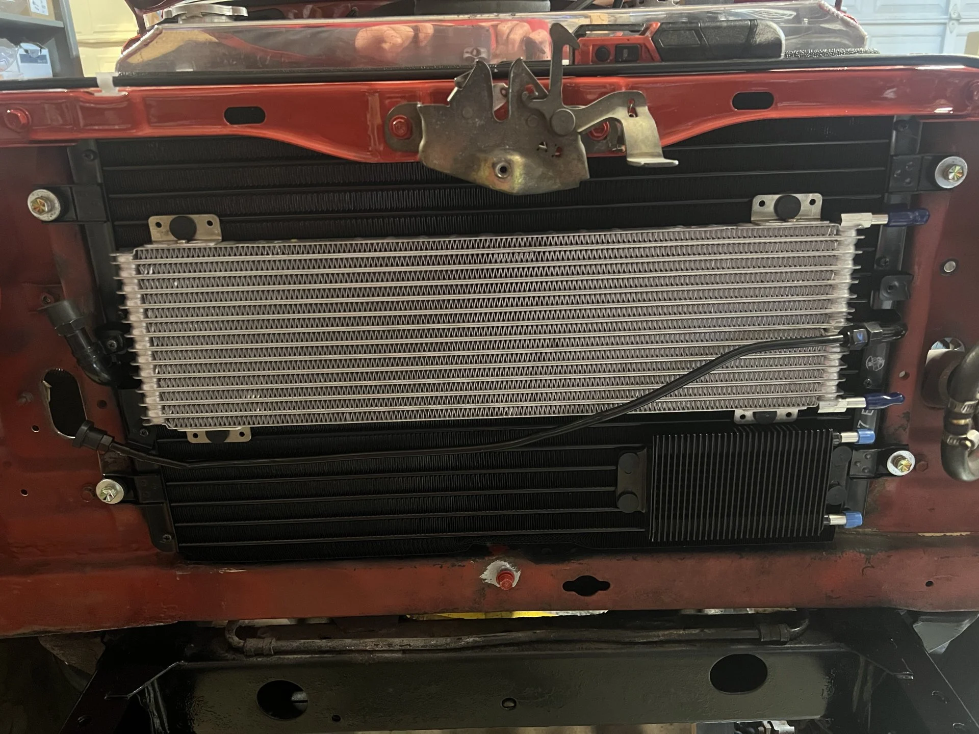

Mounted the new trans cooler and power steering cooler to the condenser today!
I know, I know...I used those crummy little plastic ties to mount them directly to the condenser... :crybaby: . I really didn't have another option. The size of the coolers made it impossible to make proper mounting brackets. I have very little clearance as it is. I had to bend the line in front of the condenser into a new shape to make it fit. It was hitting the center brace for the grill / hood latch mechanism.
Everything feels sturdy and it should be fine...the last one was mounted this way for the last 150k miles.
If it seems like I'm trying to convince myself, it's because I am! :hmm:
Unfortunately, I forgot to take a picture with both coolers mounted and the front brace, but here it is with just the transmission cooler mounted:
Very little clearance in a few spots - I actually had to bend the condenser outlet tube out a bit to get it to fit under it:

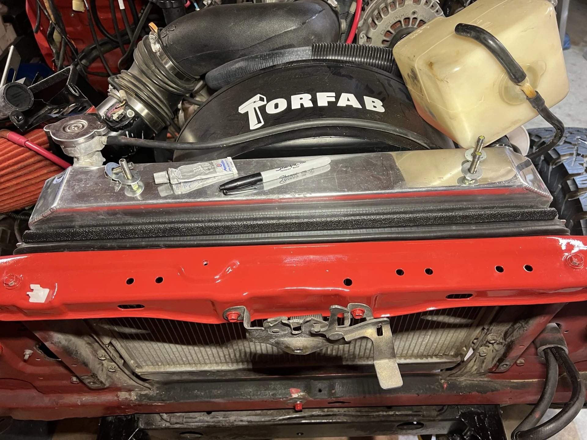

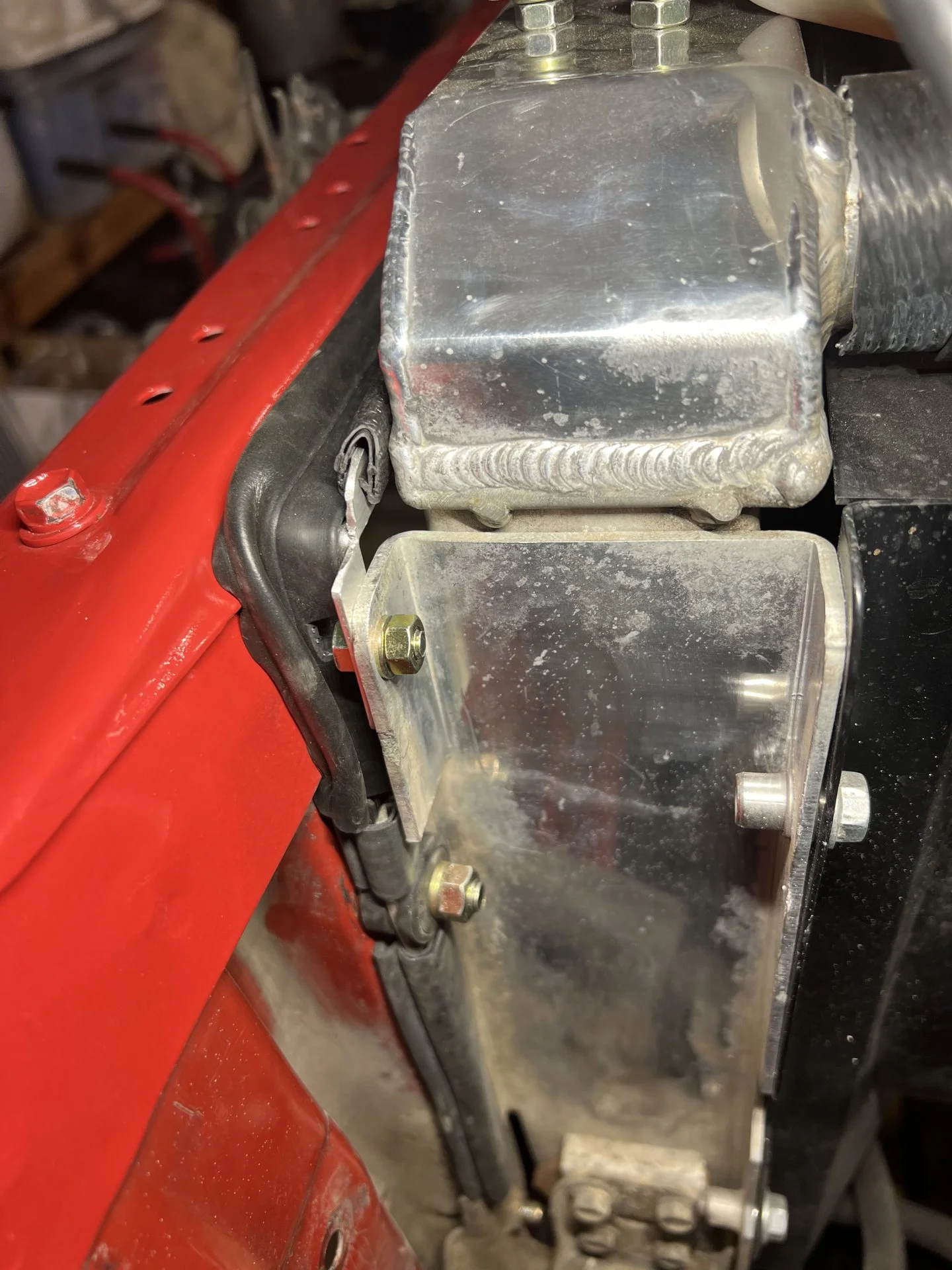

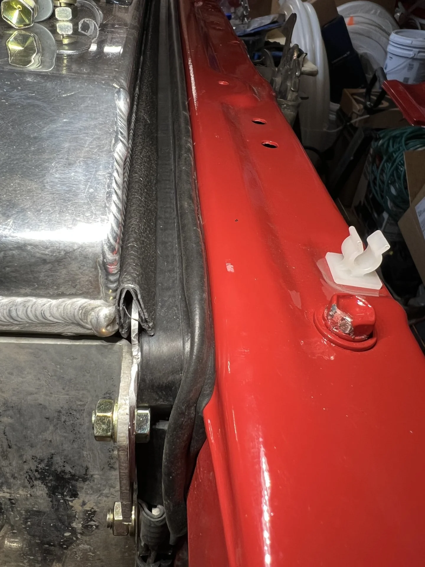

I added some weatherstripping around the radiator and fan shroud to help prevent short-circuiting of hot air in the engine compartment. It actually took a lot longer than it should have! Came out nice though.
There is still a gap at the bottom of the radiator, but I left this so any water that comes through has a place to drain.

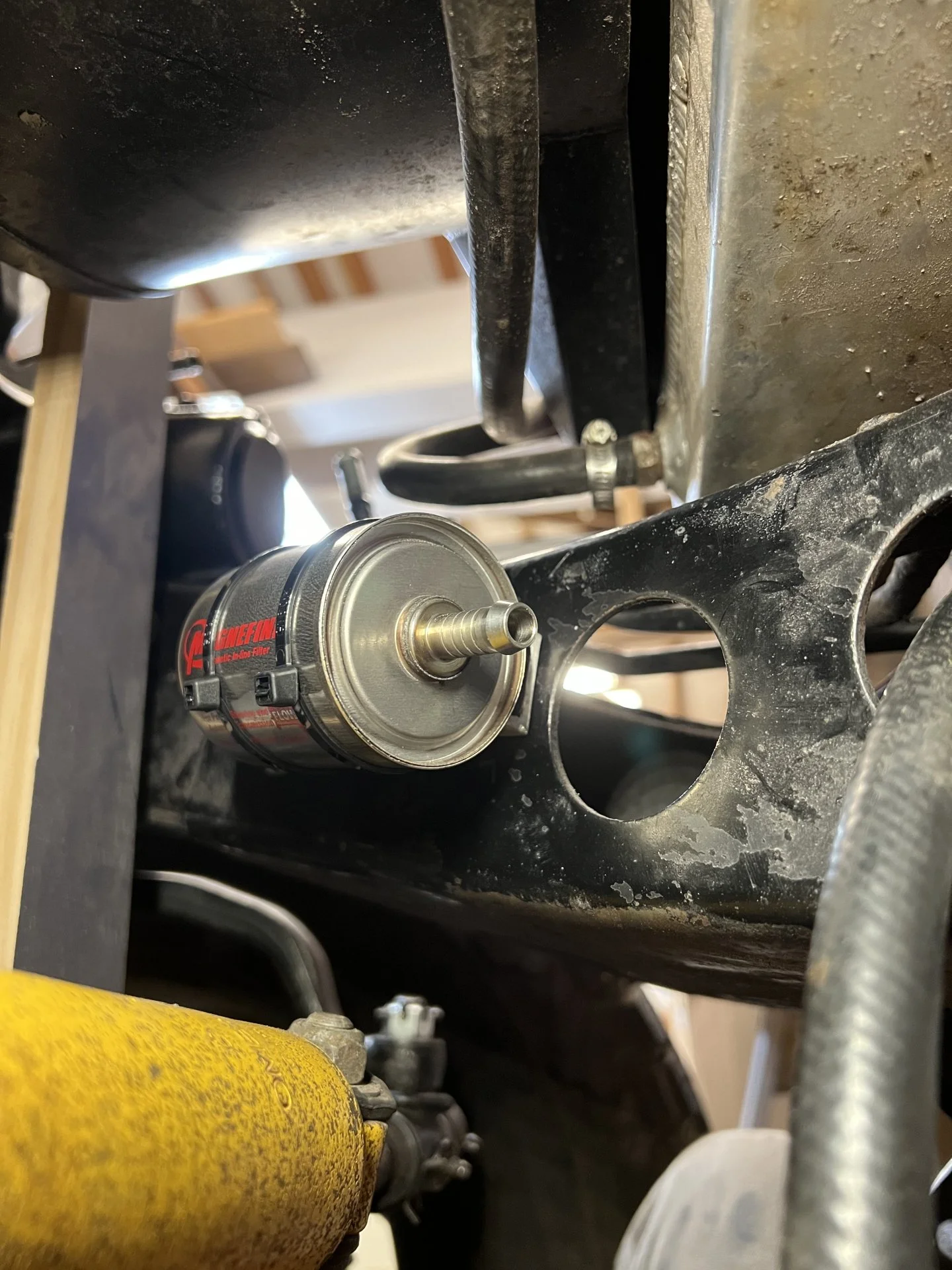

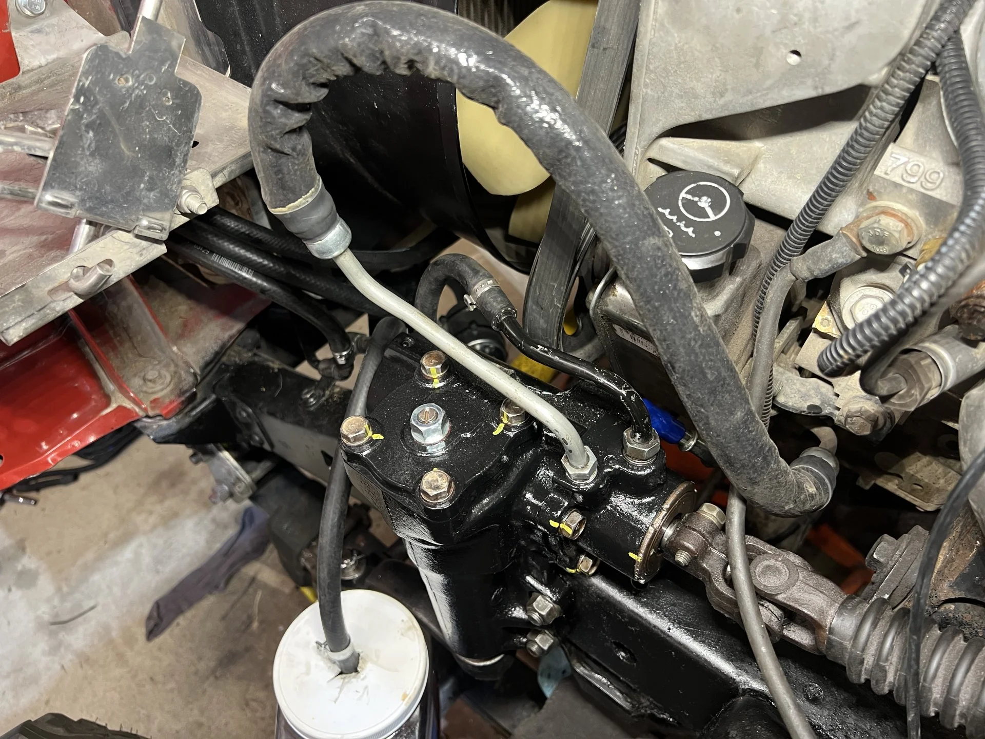

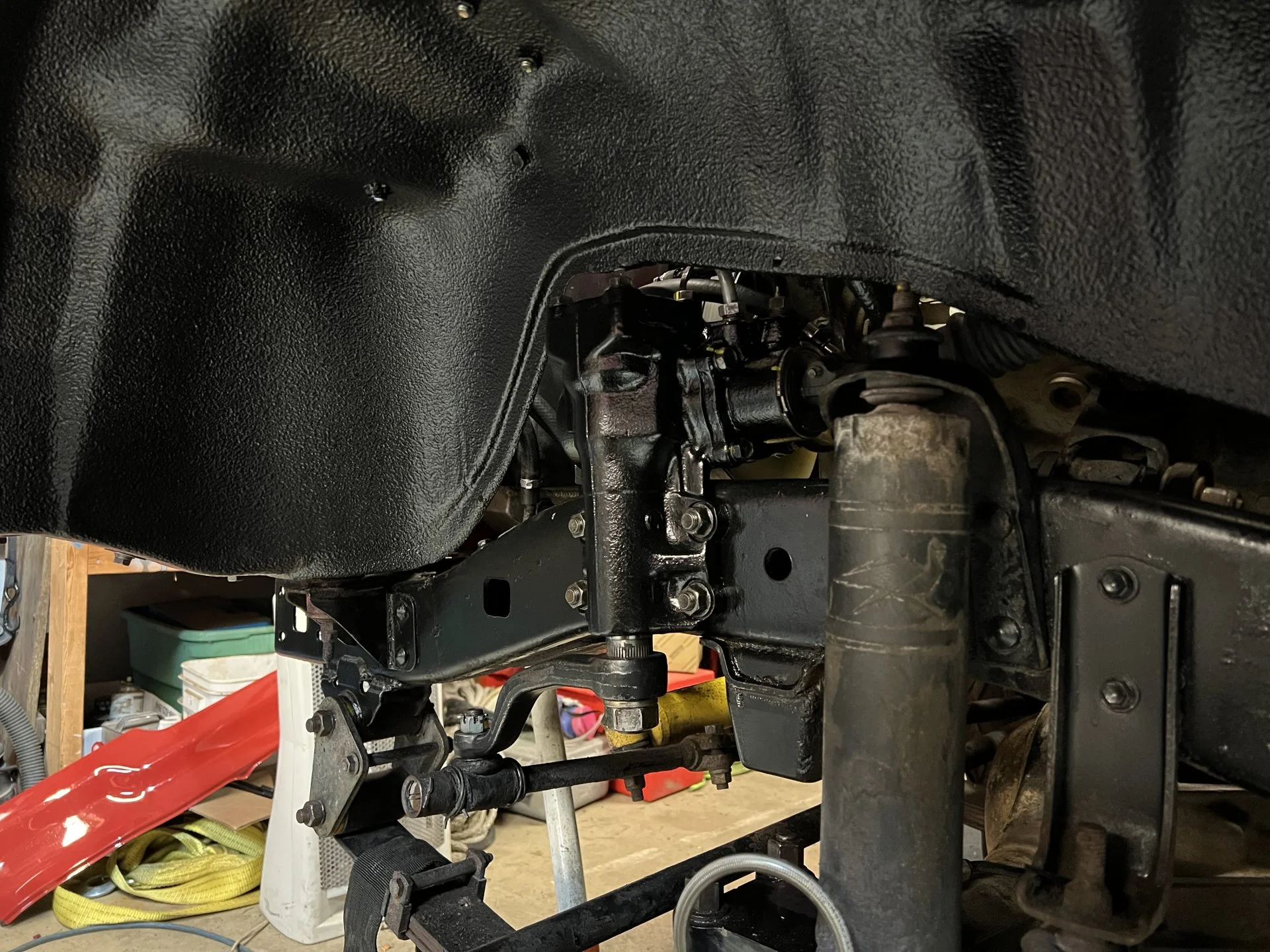

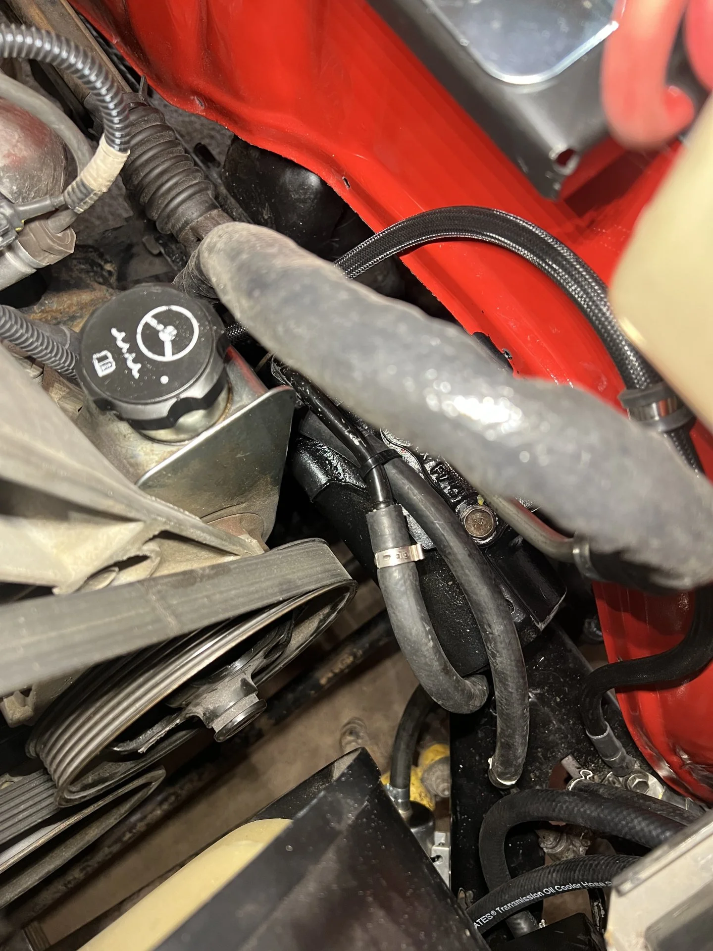

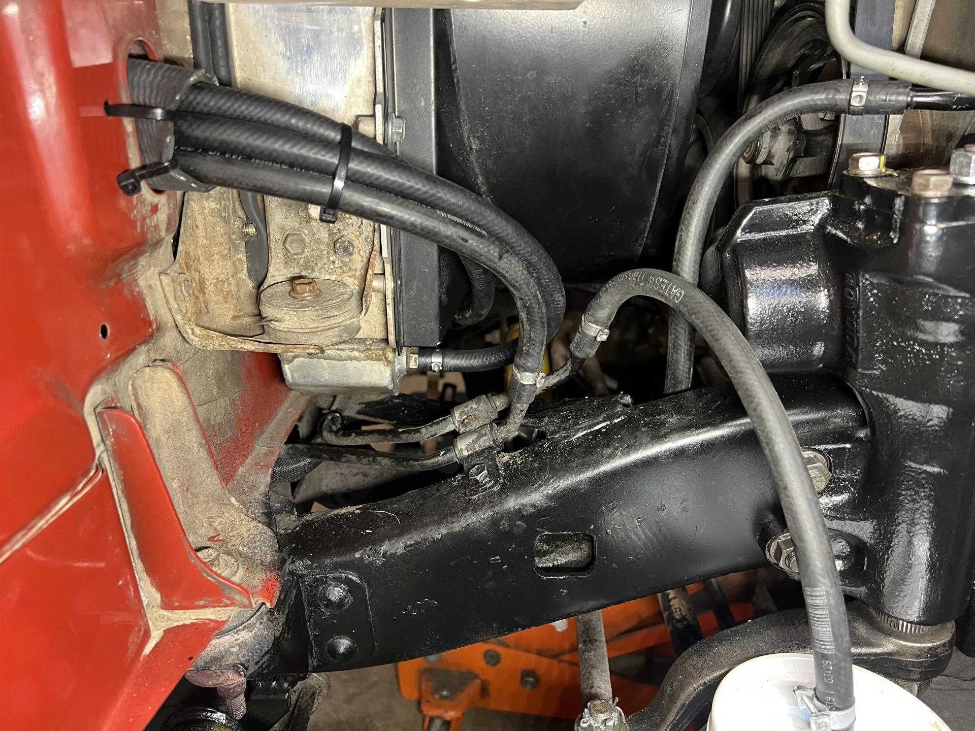

Finished the install of the transmission and power steering cooler lines. I am happy with how they turned out. I wish they were fancy AN lines, but this was the budget option and they came out nice.

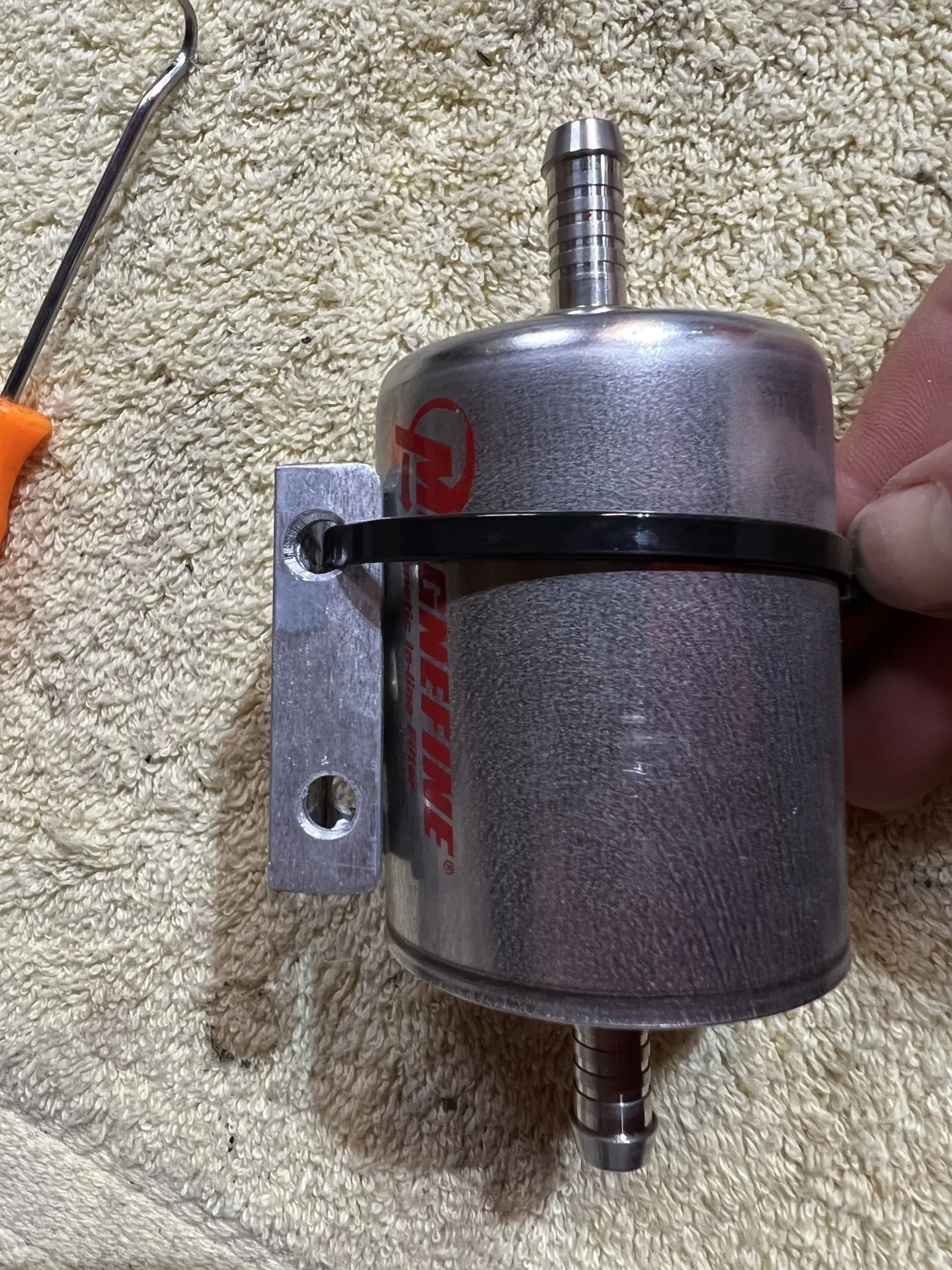

I made a small mount for the Magnefine in-line filter for the PS system. It is mounted on the frame rail brace on the drivers side. I used zip ties, so I can easily remove it/replace it when the time comes.
I still need to finish bleeding the PS system, but I need to pick up some more fluid to do so.

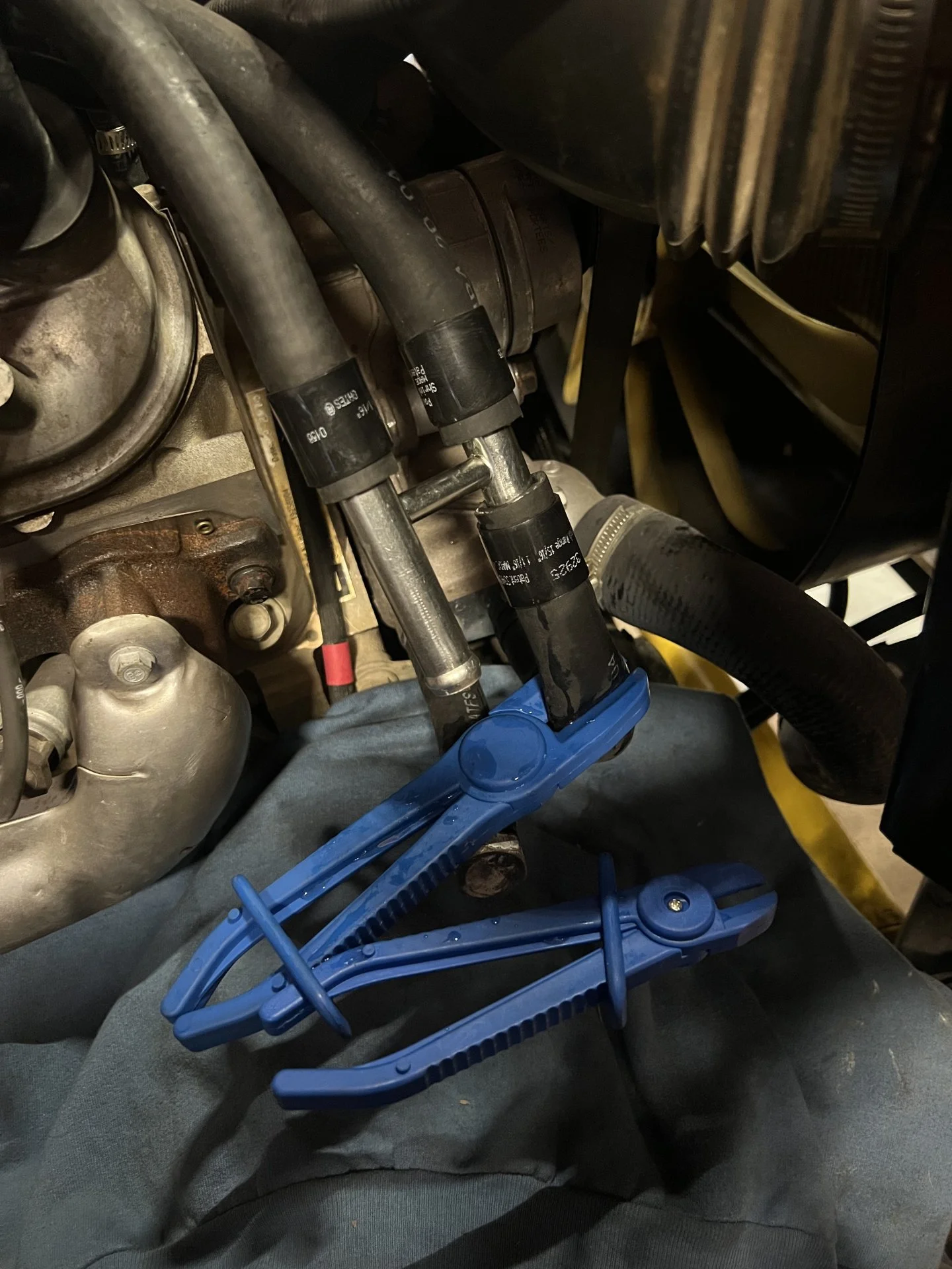

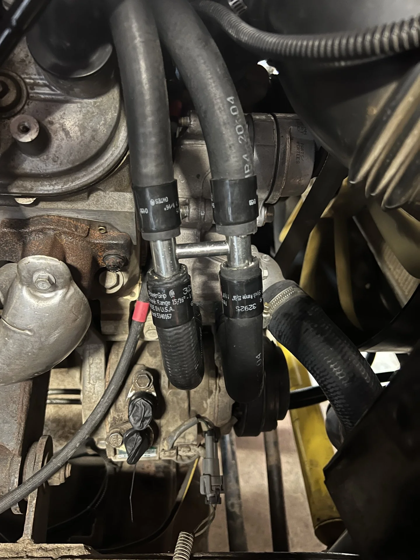

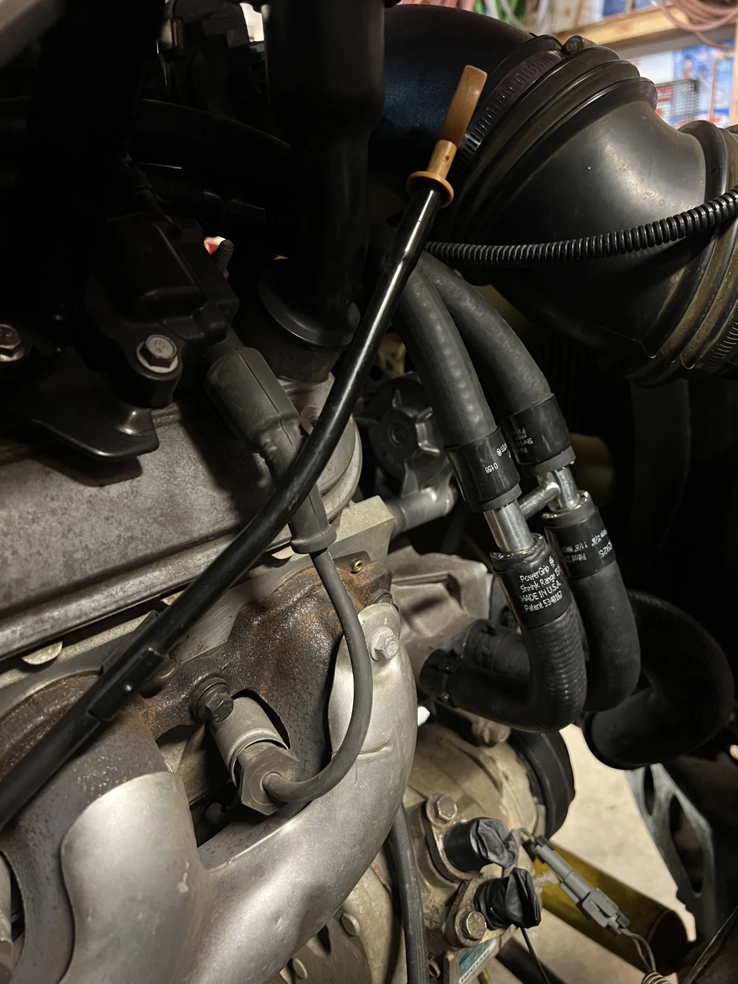

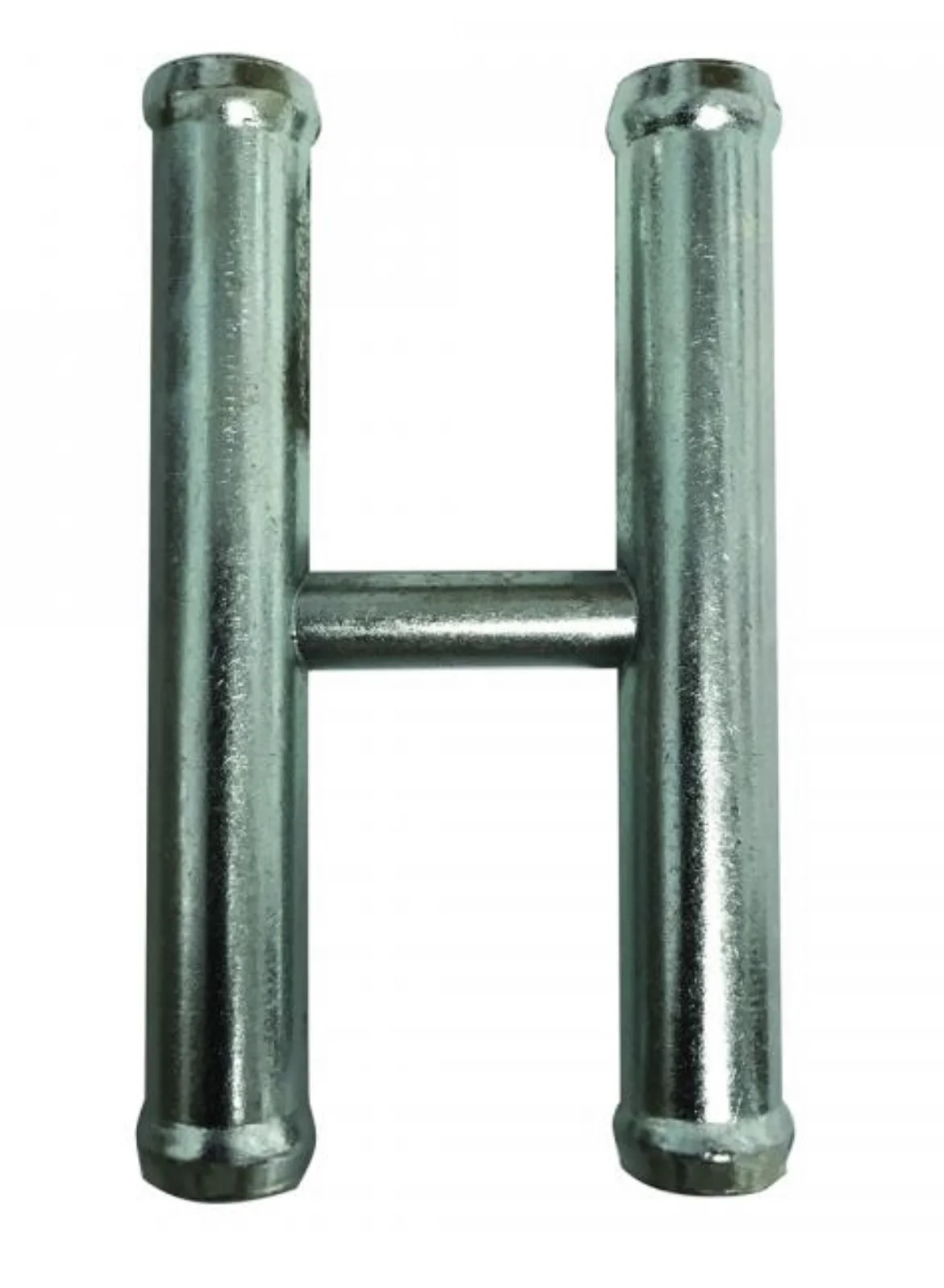

I plumbed in an ‘H’ into the heater circuit today. It’s been something I have been going back and forth on, but ultimately decided I’d do it while I had great access with the fender off.
With the LS family of engines there should be some flow through the heater circuit at all times. This allows the engine to run a little cooler. From what I understand, it’s because the thermostat uses some of this coolant to know how much to open…I could be wrong on that though. With the nature of the Toyota heater valve, if the heater is off, there is no flow through the circuit.
This should drop my temps a little (not that they were very high) but I’m curious to see if this makes a difference. I already had the ‘H’ since I had been planning on doing this a few years ago and never got around to it.
The only downside will be a very slight decrease in heater function and a few more possible leak points. I’ll be sure to update in the future with the performance difference (if any).
I used some of these hose pliers to prevent all the coolant from leaking out. Worked pretty well - I think I only lost a few cups total.
Here is the ‘H’ pipe I used from Vintage Air:

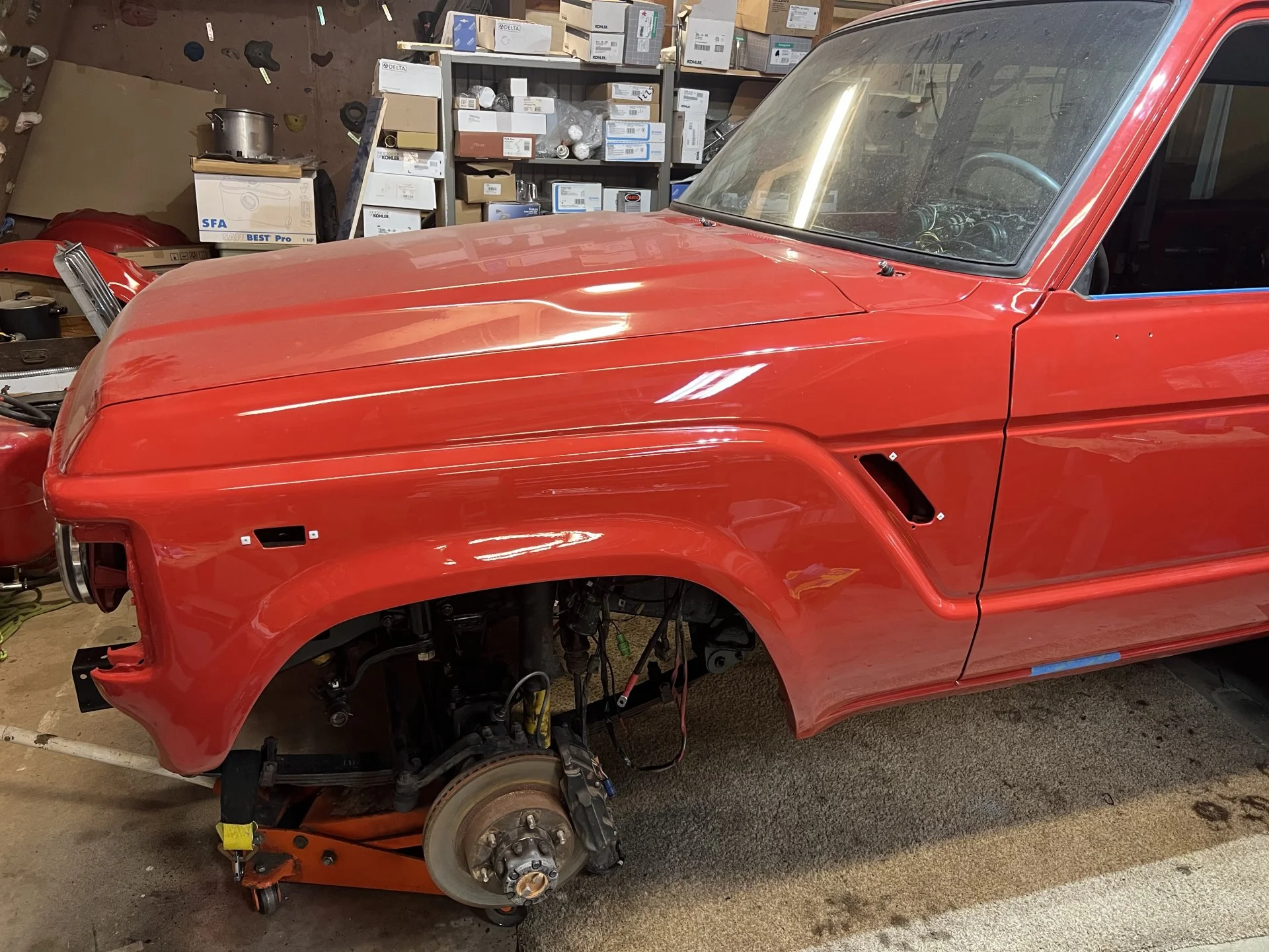

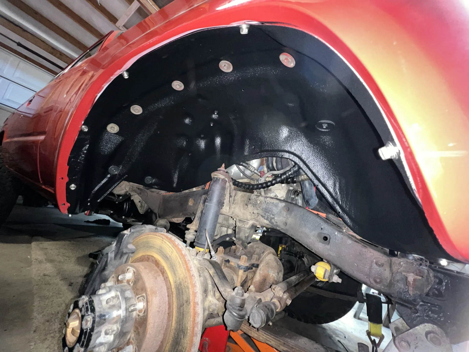

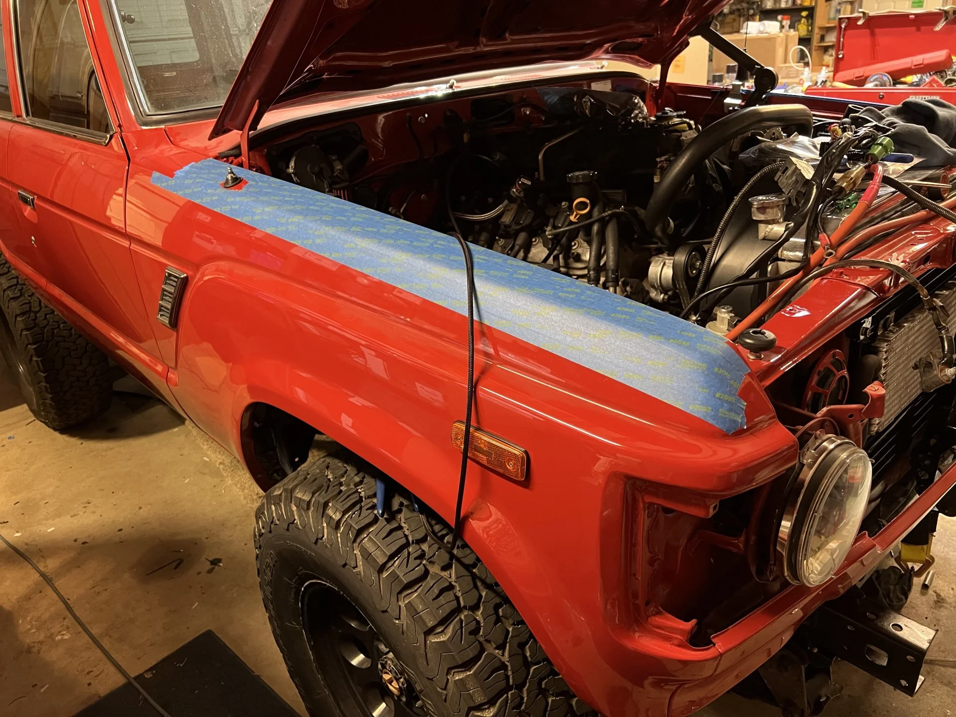

I'm slowly but steadily making progress on the Bean. I picked up a few bottles of Amsoil Synthetic Power Steering Fluid and filled/bled the system. With the PS system buttoned up, I put the driver's side fender on. Finally some forward motion!! I also installed the inner fender and that Raptor coating makes it look sharp!
I still need to put the fender aprons on, but unfortunately they are very red, so I need to get more material to make some more.

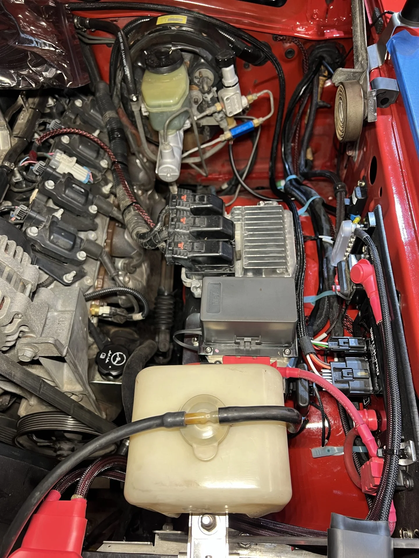

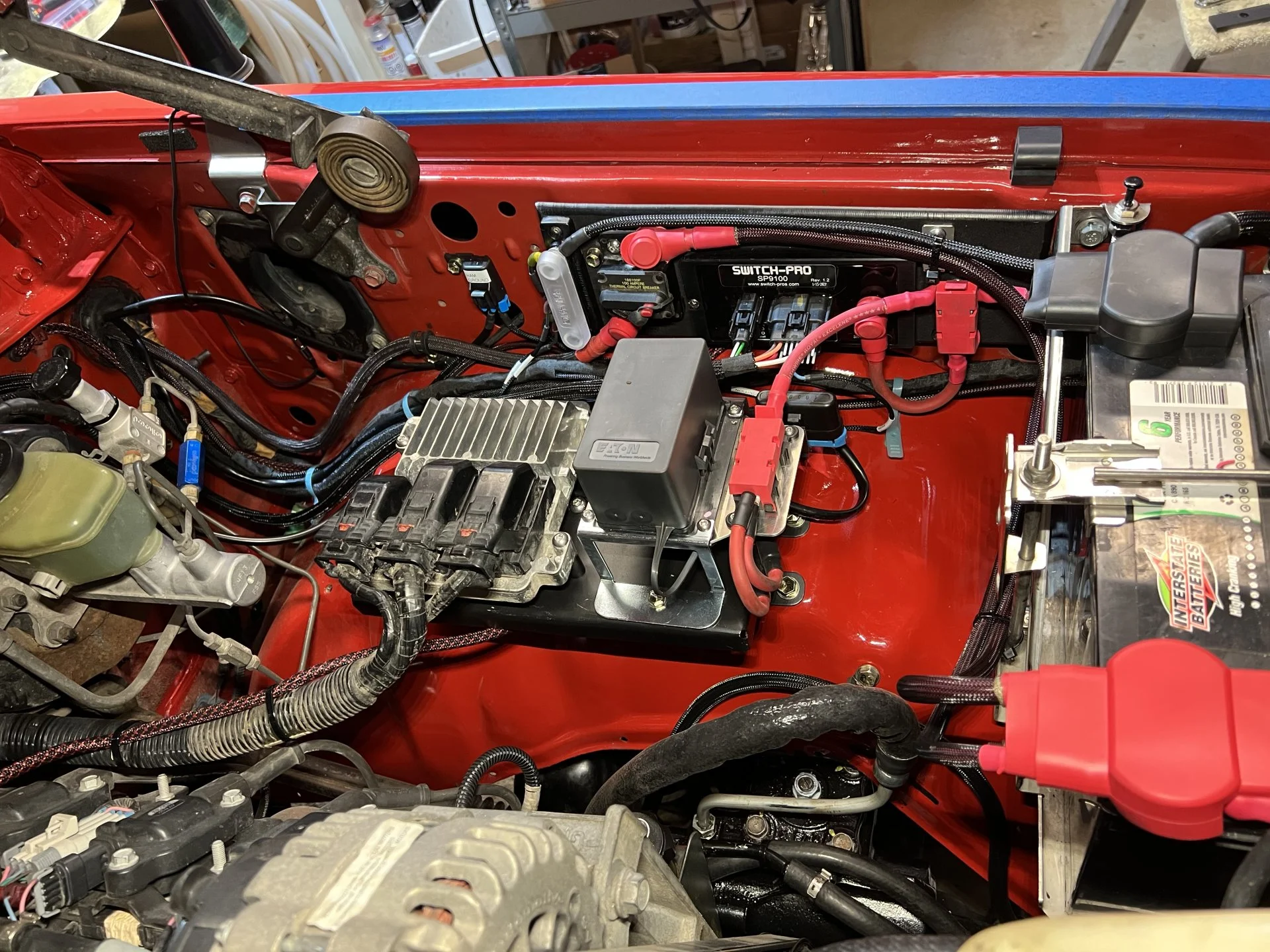

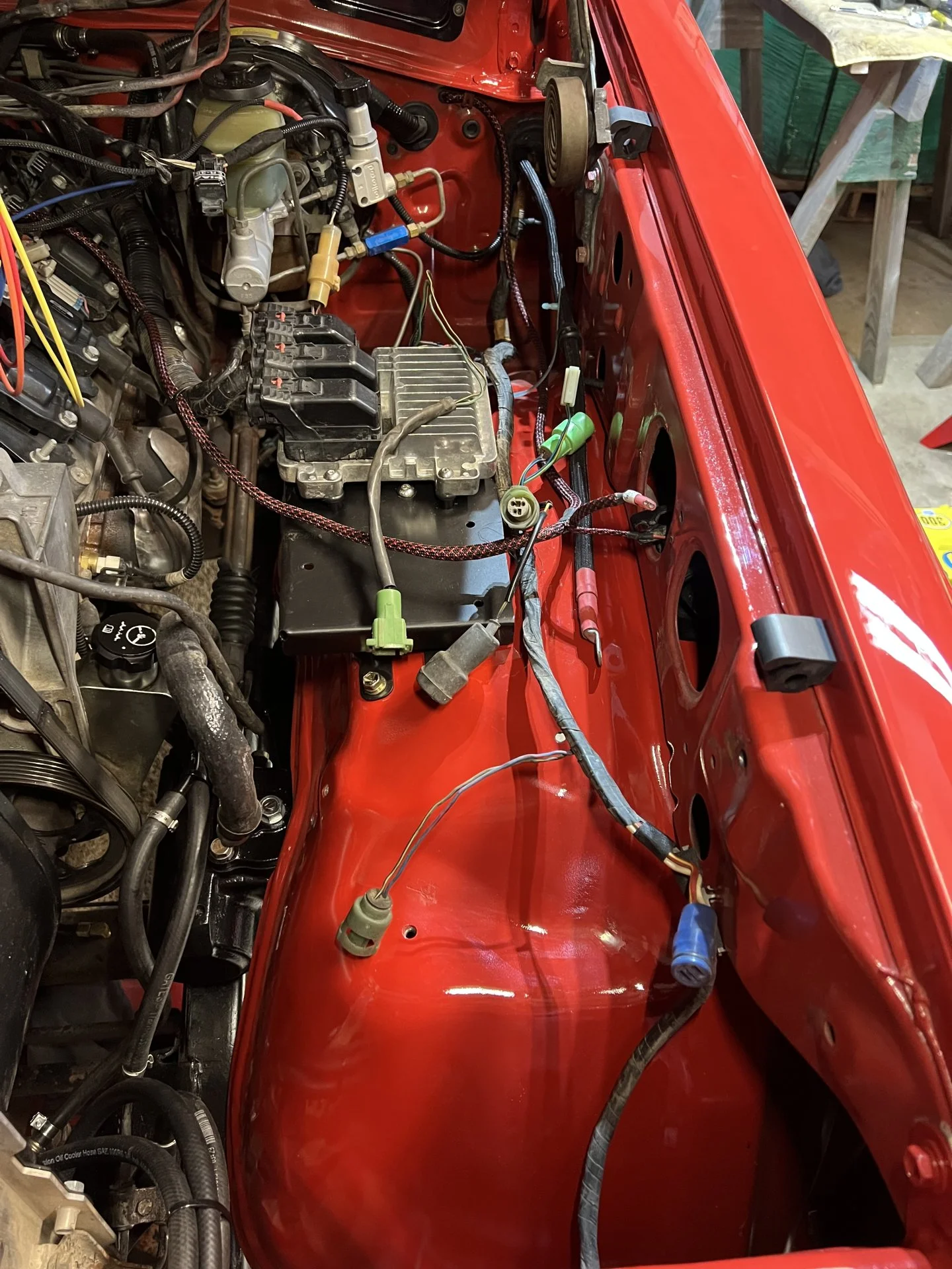

With the fender on, I got to work re-installing the ECU brackets, which I had painted this past fall. I reinstalled the ECU on the brackets and made sure there was enough room for the new Bussmann fuse box I will be adding. Previously the transmission control module sat in this spot, but the 'new' 6L80 has a built in computer, so the old TCM was removed.

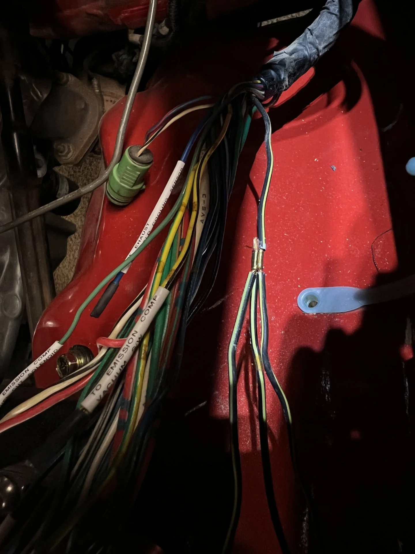

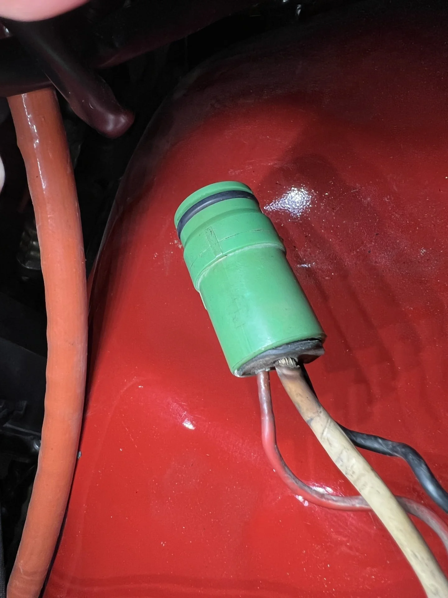

For a while now, I have been wanting to clean up some of the old wiring that went to the 2F. There were a lot of connectors whose purpose were unknown.
Here is an example of the original wire harness and the messy connectors.
There were either 6 or 7 connectors that I was able to get rid of...these were mostly for the emissions computer and I was able to use the wire diagram from the FSM and my multimeter to confirm that they were no longer needed. One of the connectors was for the 2F AC idle-up function as well. I wanted to get rid of these connectors, but I hate dead wires in wiring harnesses because my future self can never remember what they went to or why they were cut. I decided to label the wires before wrapping them back into the harness. I reused the black wire with a yellow stripe for triggering a few relays in my Bussmann box...the BY wire goes to the engine fuse in the interior fusebox and will be hot when the truck is on.
In the picture below, you can see the 'dead' wires cut and labeled. You can also see the BY wire with the factor splice. I cut this wire before the splice and am using it to trigger some relays when the ignition turns on.

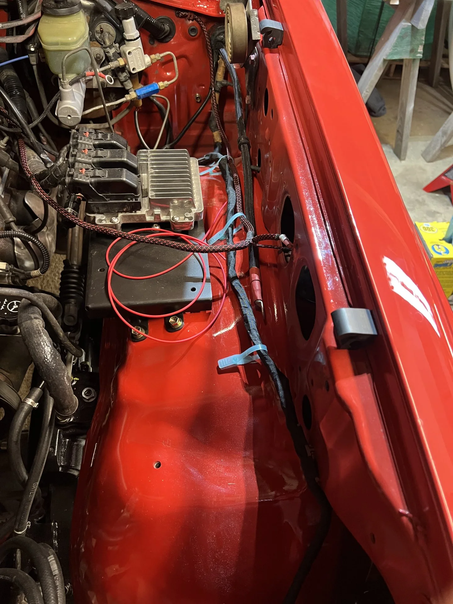

Here's the wire harness all cleaned up and wrapped up with some Tesa tape. Much better!

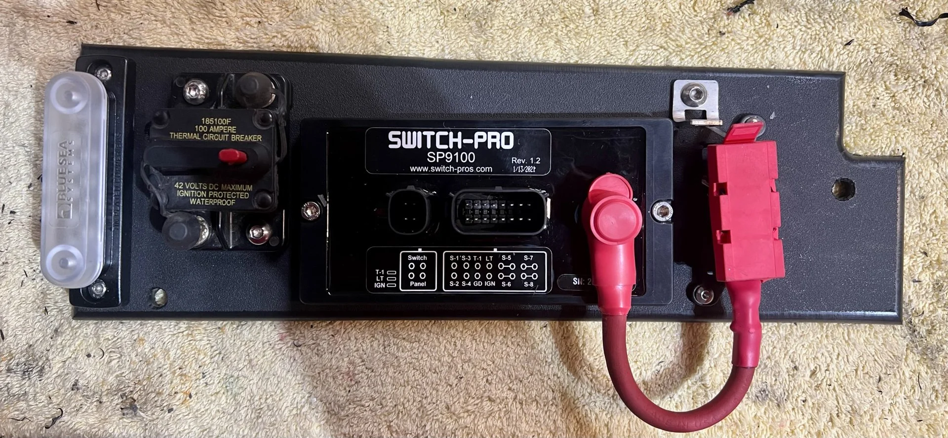

With the HAM antenna out of the way, I started working on a panel to mount some of my accessory equipment. This includes a SwitchPro and fuse, a circuit breaker for the rear power and a ground buss-bar. I also mounted the Bussmann fusebox next to the ECM.
I used existing holes to mount a panel that the equipment is mounted to. I used Starboard plastic from the local plastic shop. I was able to find remnants for a few bucks! Here it is:
Here are a few shots of it all installed. It was a lot of work to wire it all! It's nowhere near fully wired, but I have a good jump on it! It is way overkill and a little too complex. If I ever did this again, I would find a way to make the truck much simpler. Luckily I created a really detailed wire diagram, so I am able to follow that and will have that in the future if I ever need to troubleshoot or add to the system.

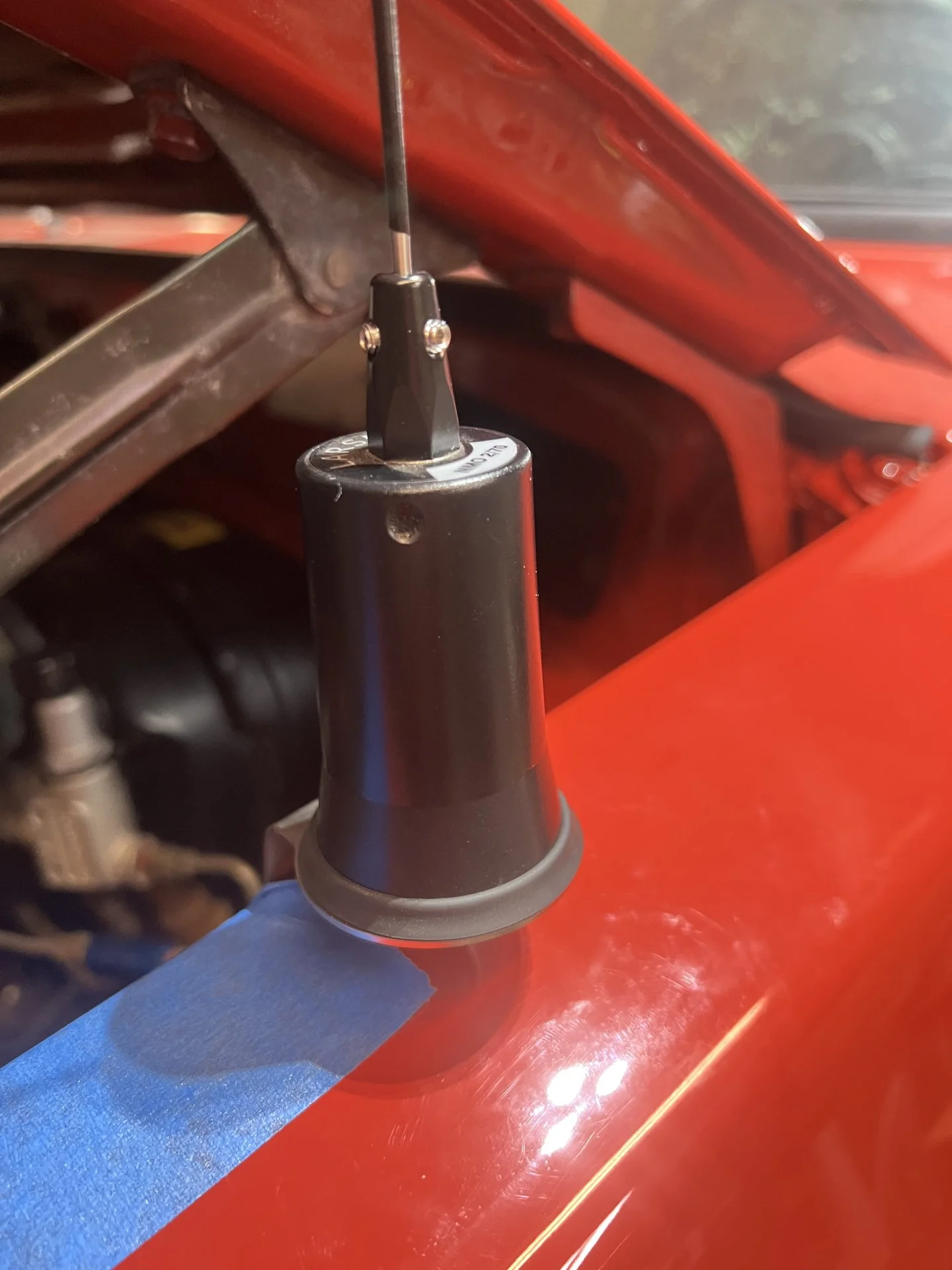

Next order of business...for whatever reason...was to fabricate the mount for my HAM antenna. Not sure why this came next, but it did.
It came out pretty nice and I was able to use the existing hole for the hood spring to mount it. I'm trying my best to use existing holes for mounting accessories.

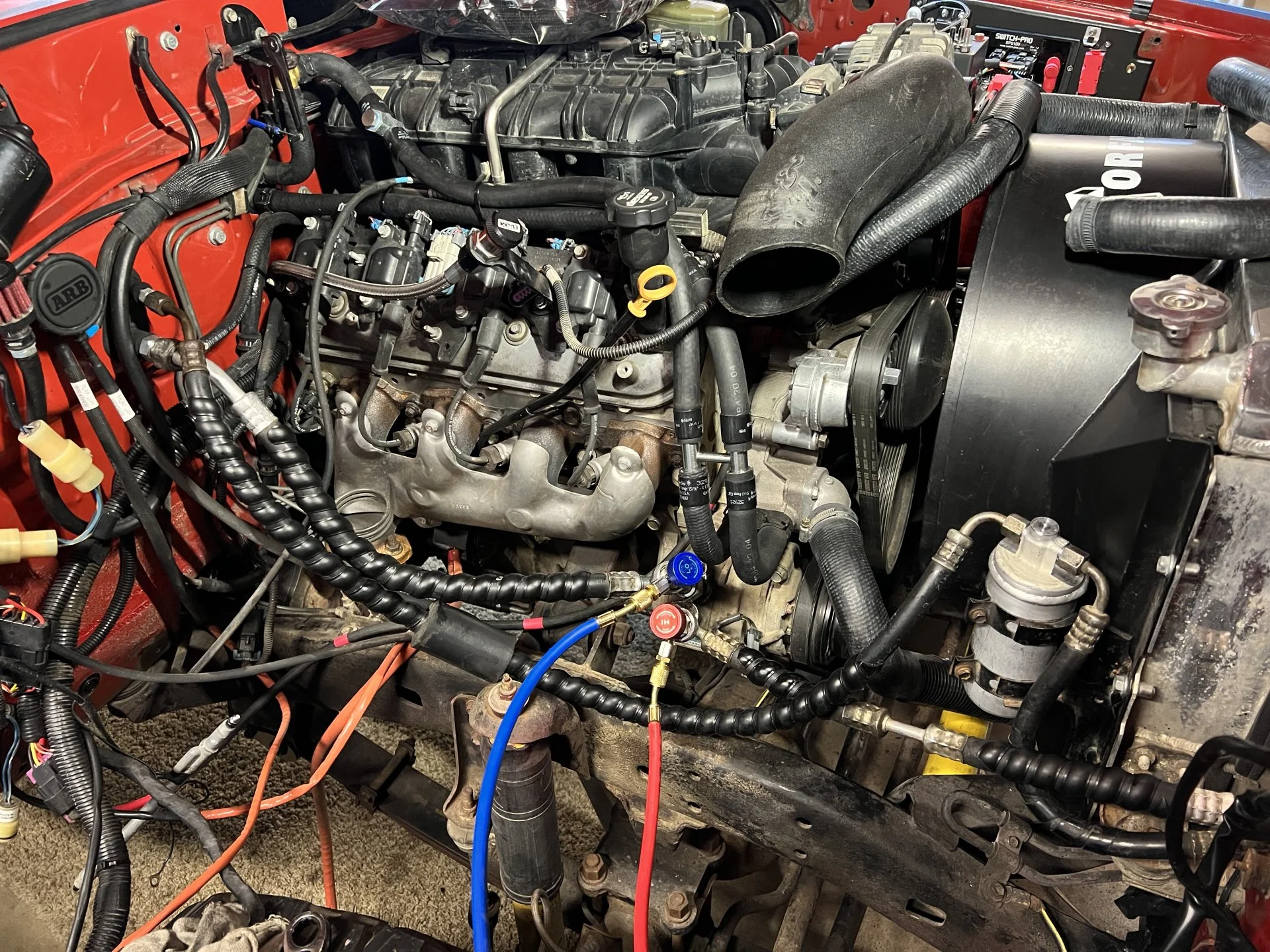

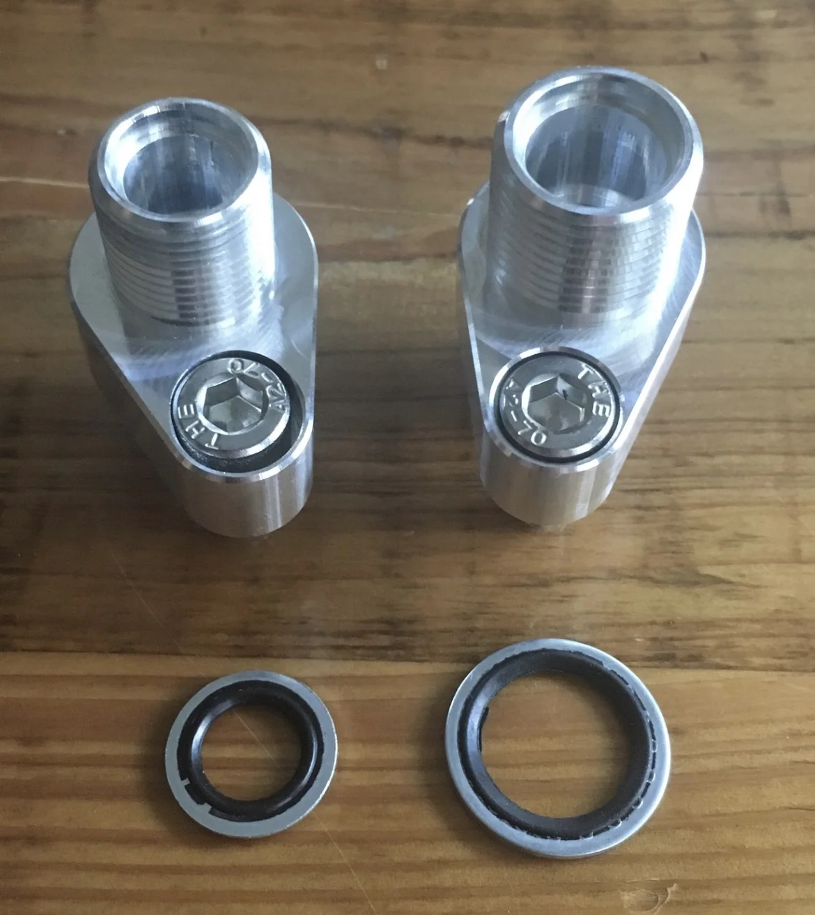

Been working on some random interior wiring this last week and had the time to pressure test the AC system. My brother has a set of decent gauges he let me borrow and he also had an adapter to hook the gauges up to a nitrogen tank. I took the opportunity to pressure test the system before vacuuming it down and I’m glad I did!
I thought I had a small leak because I didn’t have much refrigerant in the system, but I figured I had taken care of it when I replaced most of the system…When I pressurized to ~75psi, the hose adapter on the compressor started leaking pretty badly. I was able to scramble and find a new set of rubber impregnated aluminum rings at NAPA. They had to order them from a full kit which was a bummer, but they were able to get them next day. I got those installed today and charged the system to 125psi. I’ll leave it for the next day or so, but so far there are no leaks!
Here’s a picture of similar compressor hose adapters. These are the seals that were leaking.
The system hooked up and being pressure tested:

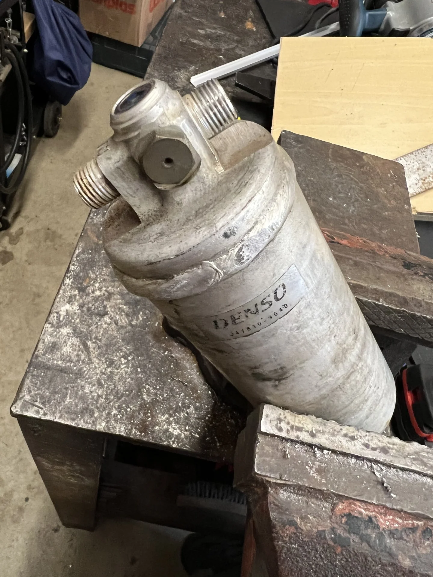

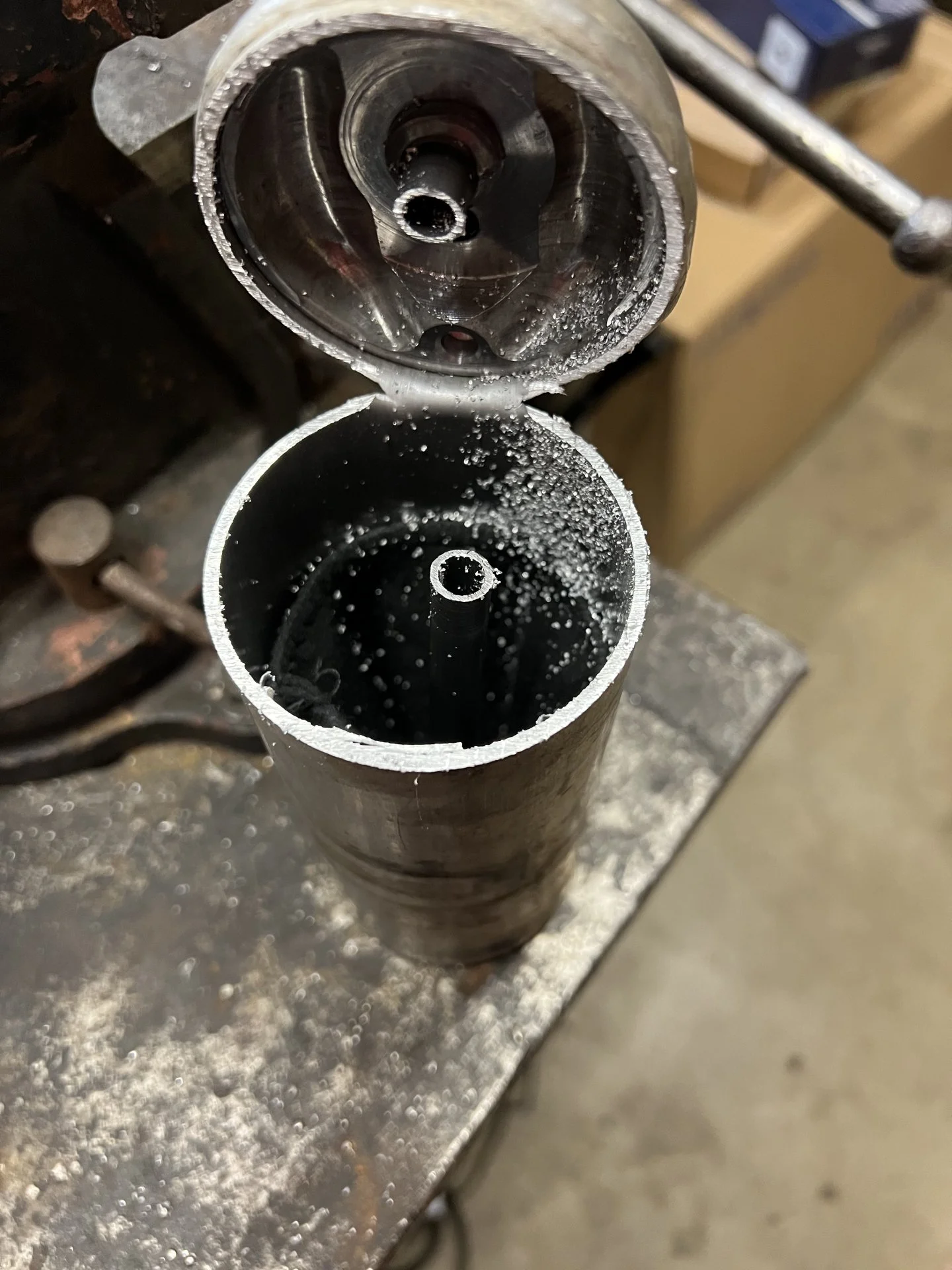

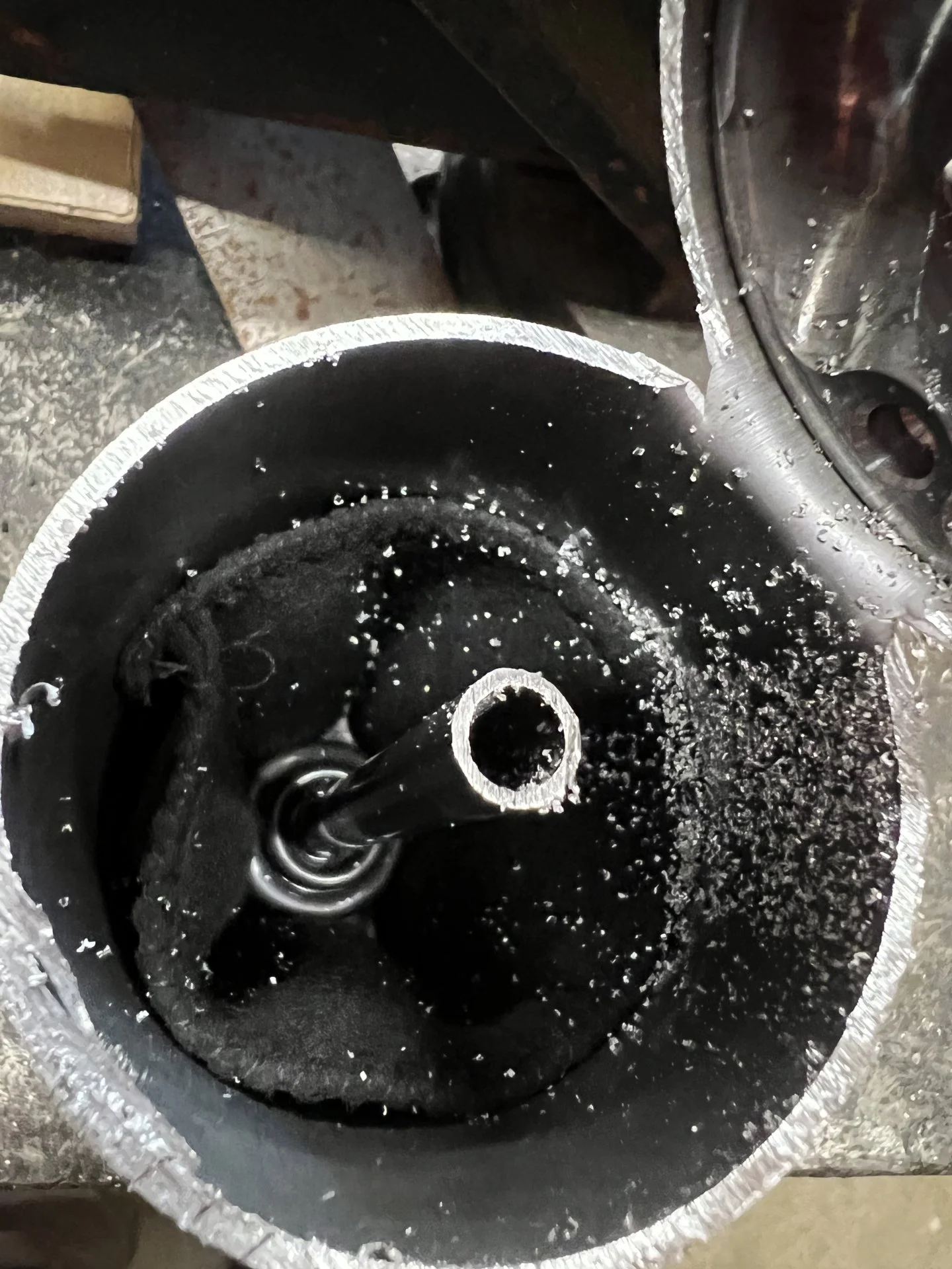

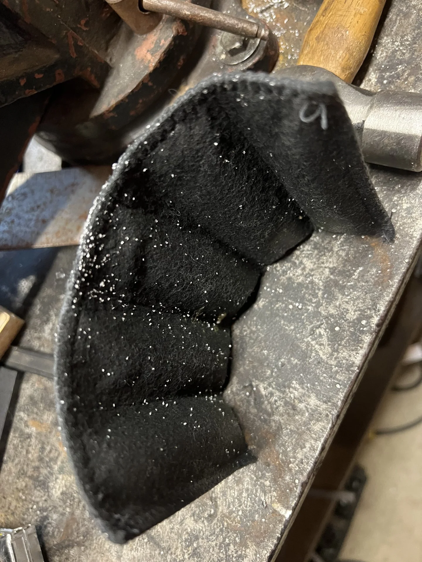

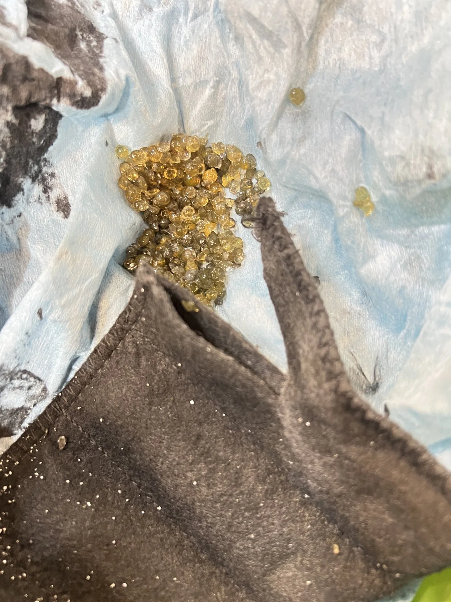

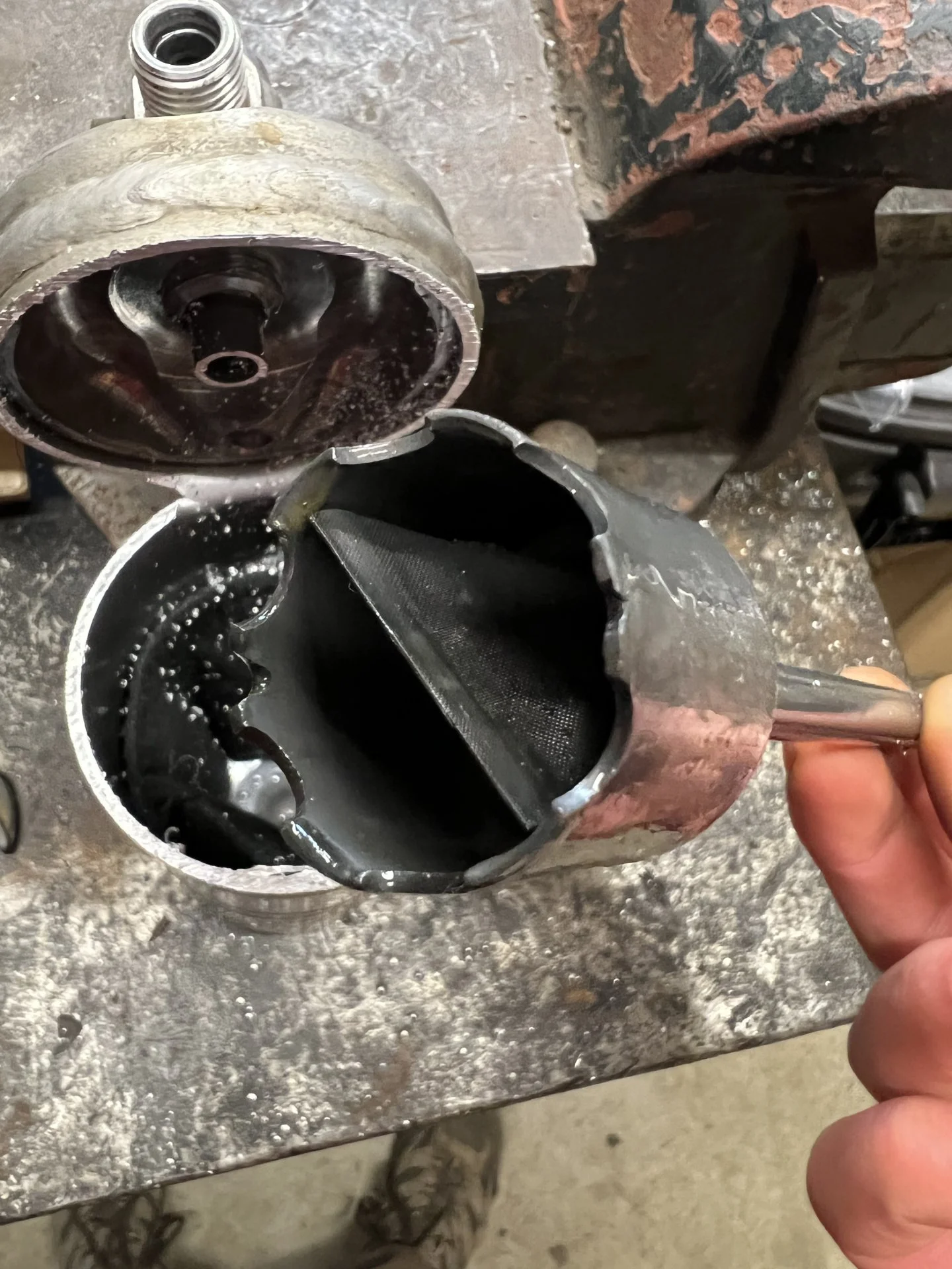

I got curious and decided to cut open my old drier unit. I was wondering how it worked and what the internals looked like:
So the refrigerant goes in after it passes through the condenser. It’s mostly liquid. It goes through the inlet and comes into contact with the desiccant (the black fabric pouch) before it passes through a small screen and up the tube to the outlet.
Below is the small filter screen at the bottom of the exit tube:
Here is the bag that holds the desiccant and the desiccant itself.
Kind of fun to see what these parts actually look like inside.

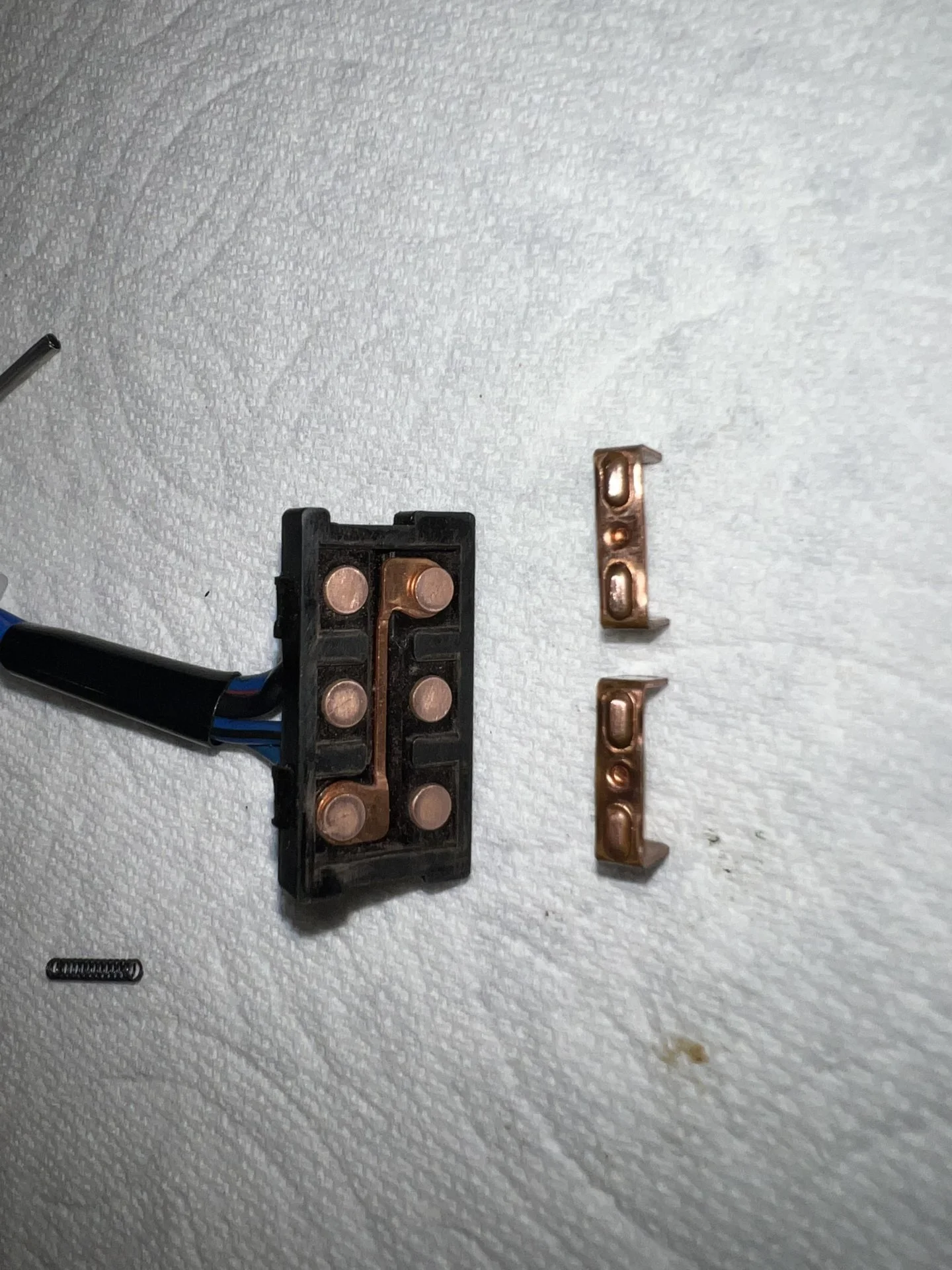

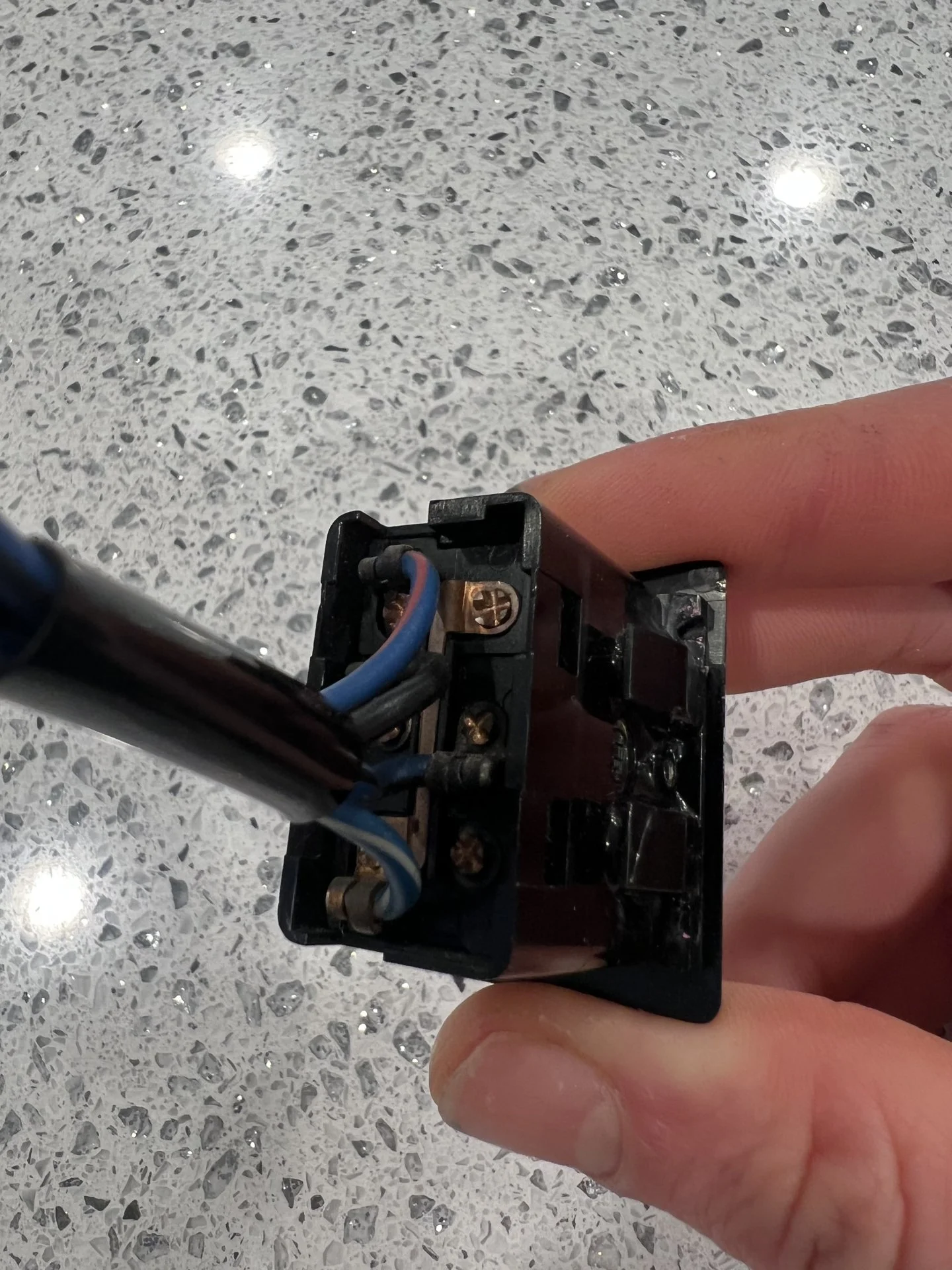

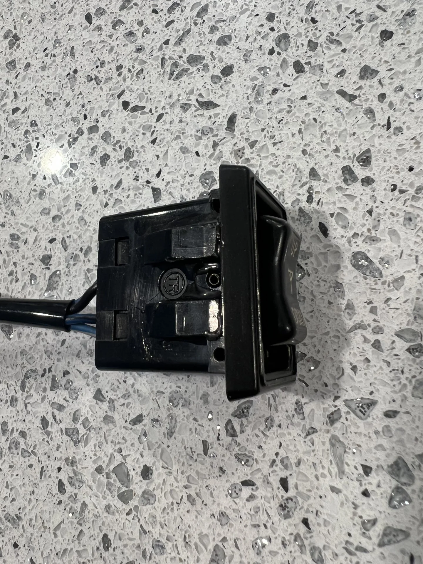

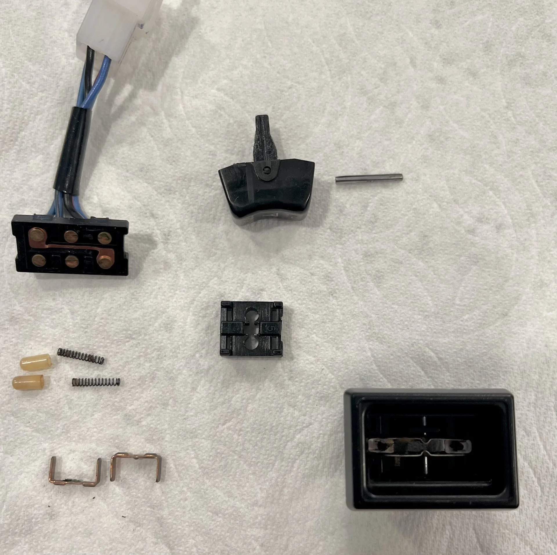

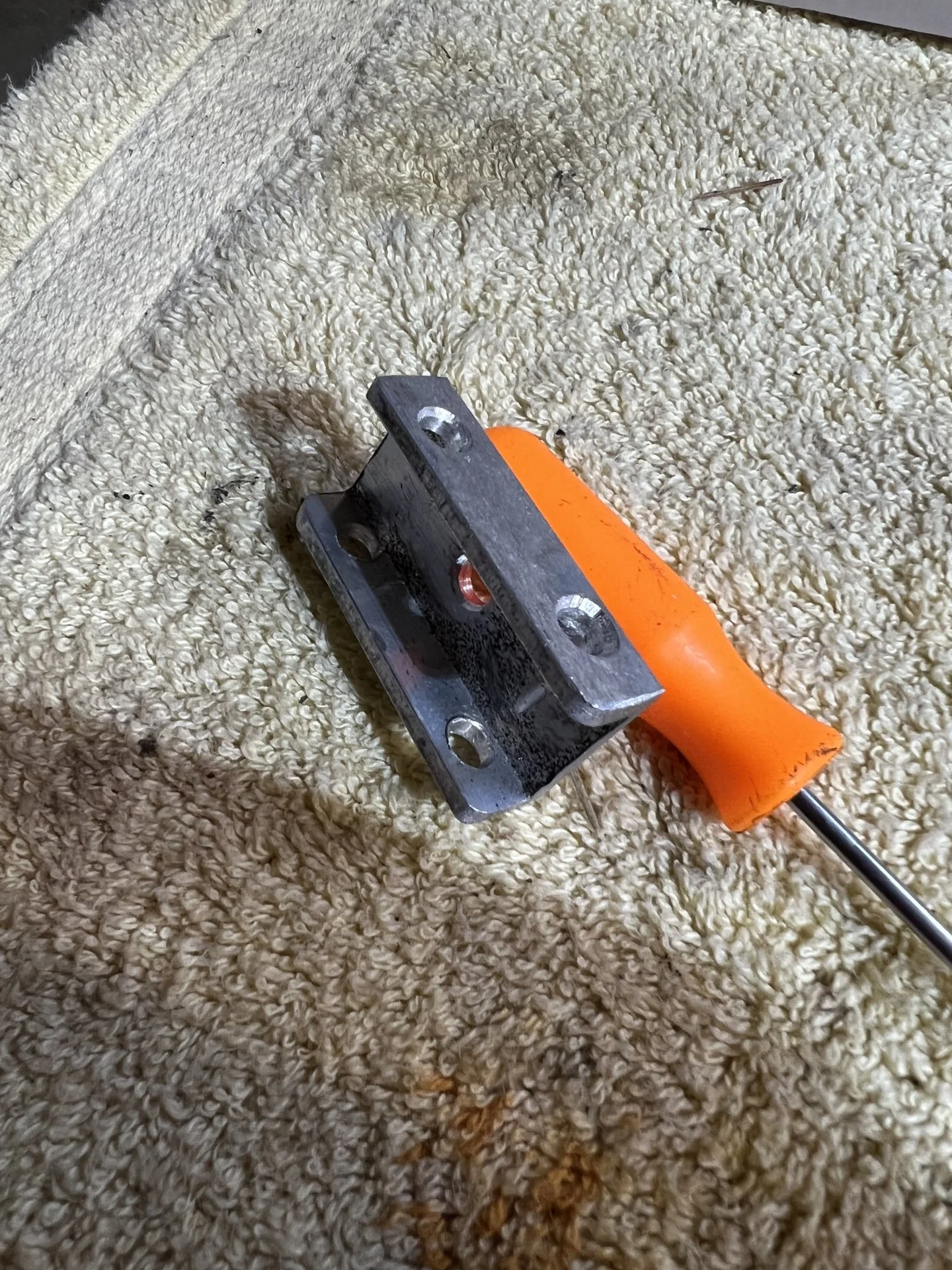

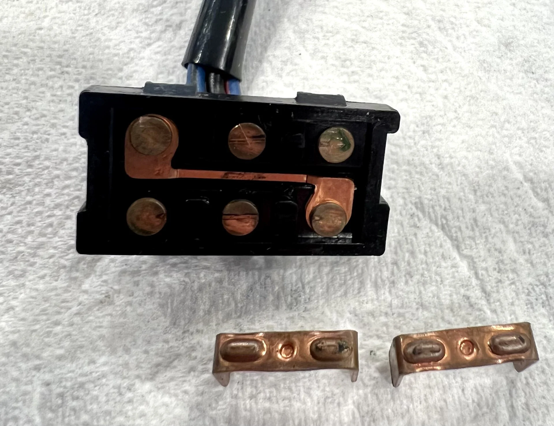

I found that my prized FJ60 antenna switch was not working when I checked continuity through my multimeter. I was able to take it apart and clean the contacts. Works like new now!
Here is what it looks like inside:
All taken apart:
Dirty Contacts:
Clean Contacts:
Everything is back together and ready for another 30yrs of service! 🤞

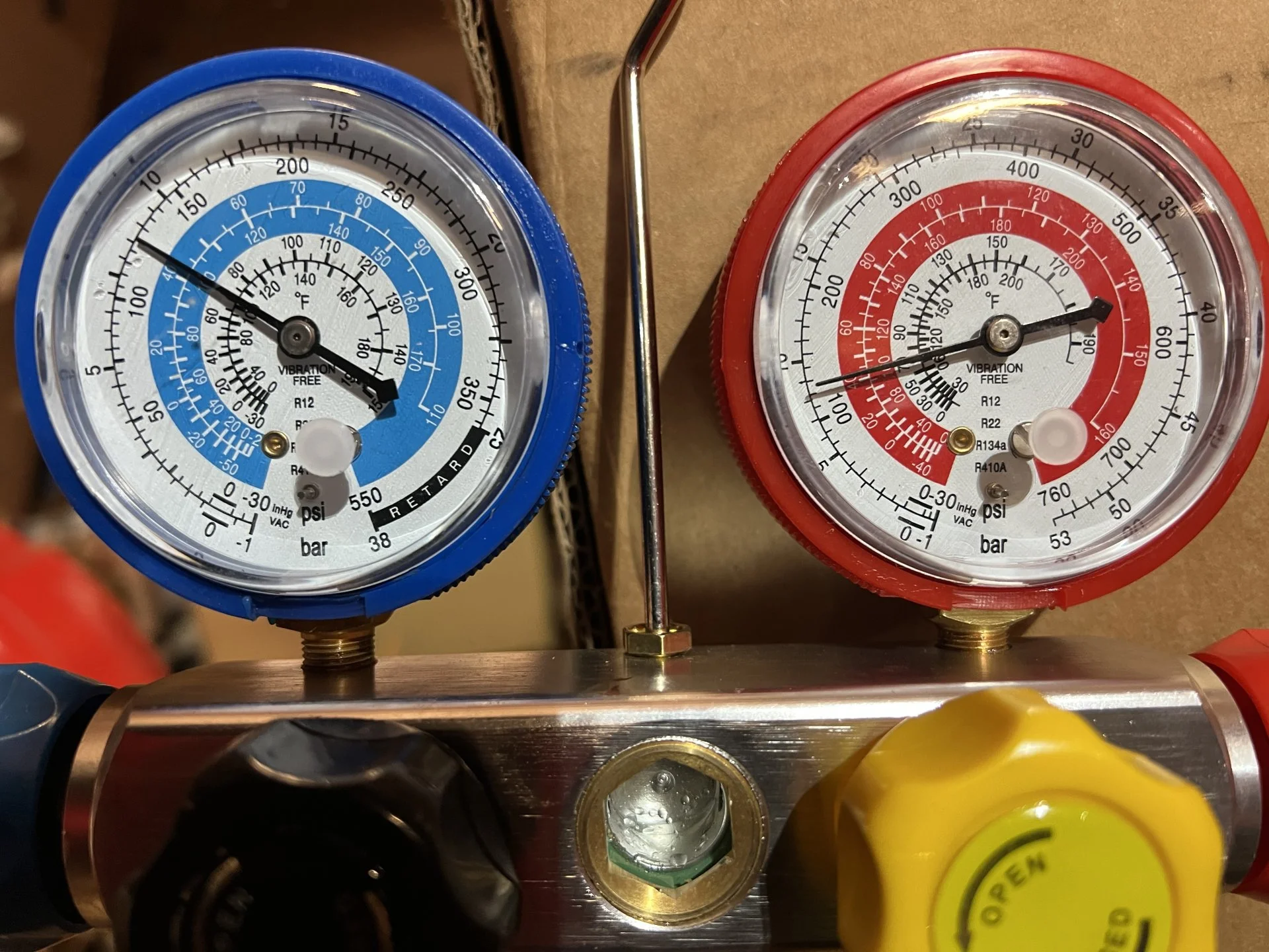

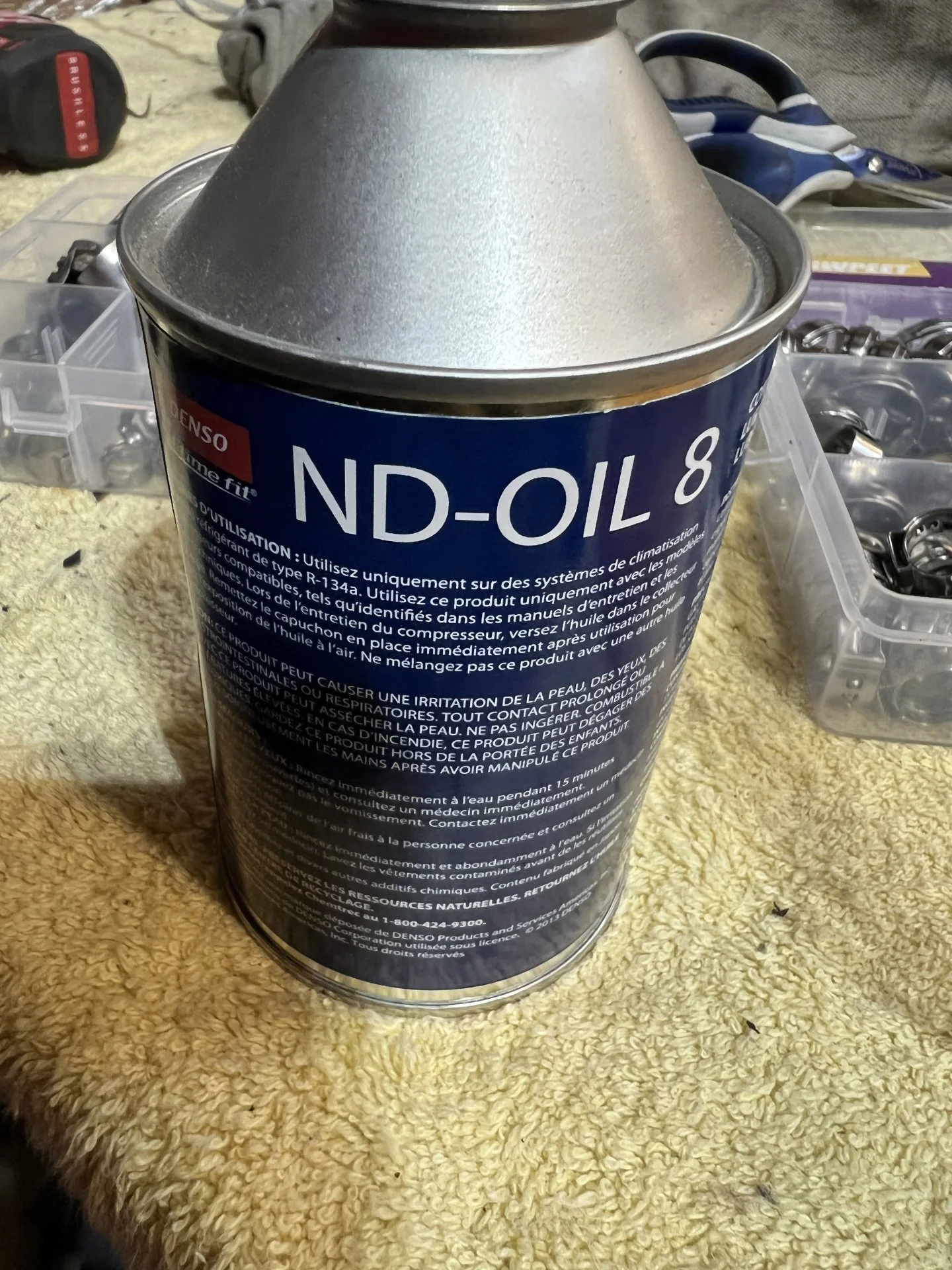

First off, the AC system held the 150psi nitrogen charge for a few days and I decided to leave it charged instead of vacuuming the system. The nitrogen was dry (from a bottle), so I don't think it added any moisture to the system. Also, I will be able to easily see how well the system is sealed when I go to charge it in a few months...it should still be at around 150psi when I go to charge it. I will vacuum it down really well before charging.
As for oil and amounts, I used 7oz of Denso ND-Oil 8. I think I bought this off of Amazon.
I ended up getting 4oz of oil out of my compressor when I emptied it, but only put 3.5oz back in...below are the oil amounts that I used.
The stock FJ60 system uses 5.2oz - 6.2oz (or something close to that). My system is stock except for the compressor, which is slightly larger. I decided to use 7oz total in the system. I got some if this info from this How To LS Swap thread, and some of it I pieced together from various threads and the R-134a conversion TSB.
ND-Oil 8 Volumes:
  • Compressor: 3.5oz
  • Air Drier: 2.0oz
  • Evaporator: 0.75oz
  • Condenser: 0.75oz
    • Total - 7.0oz

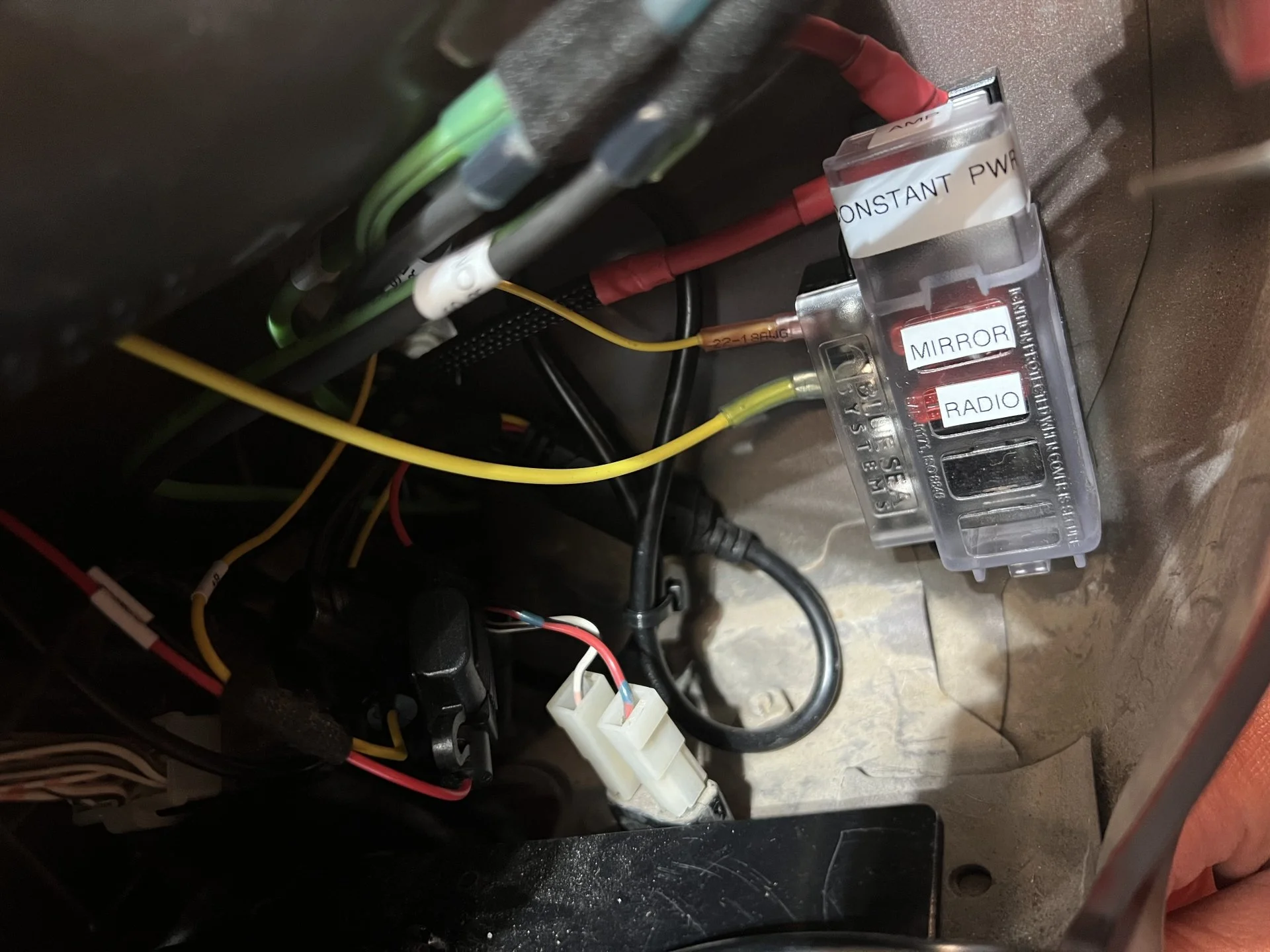

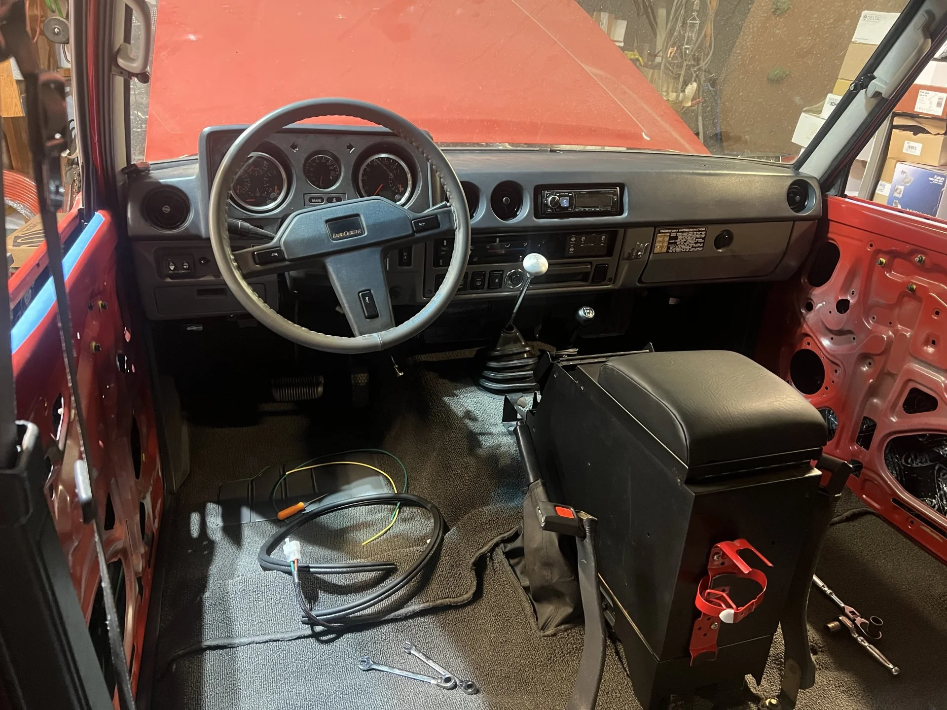

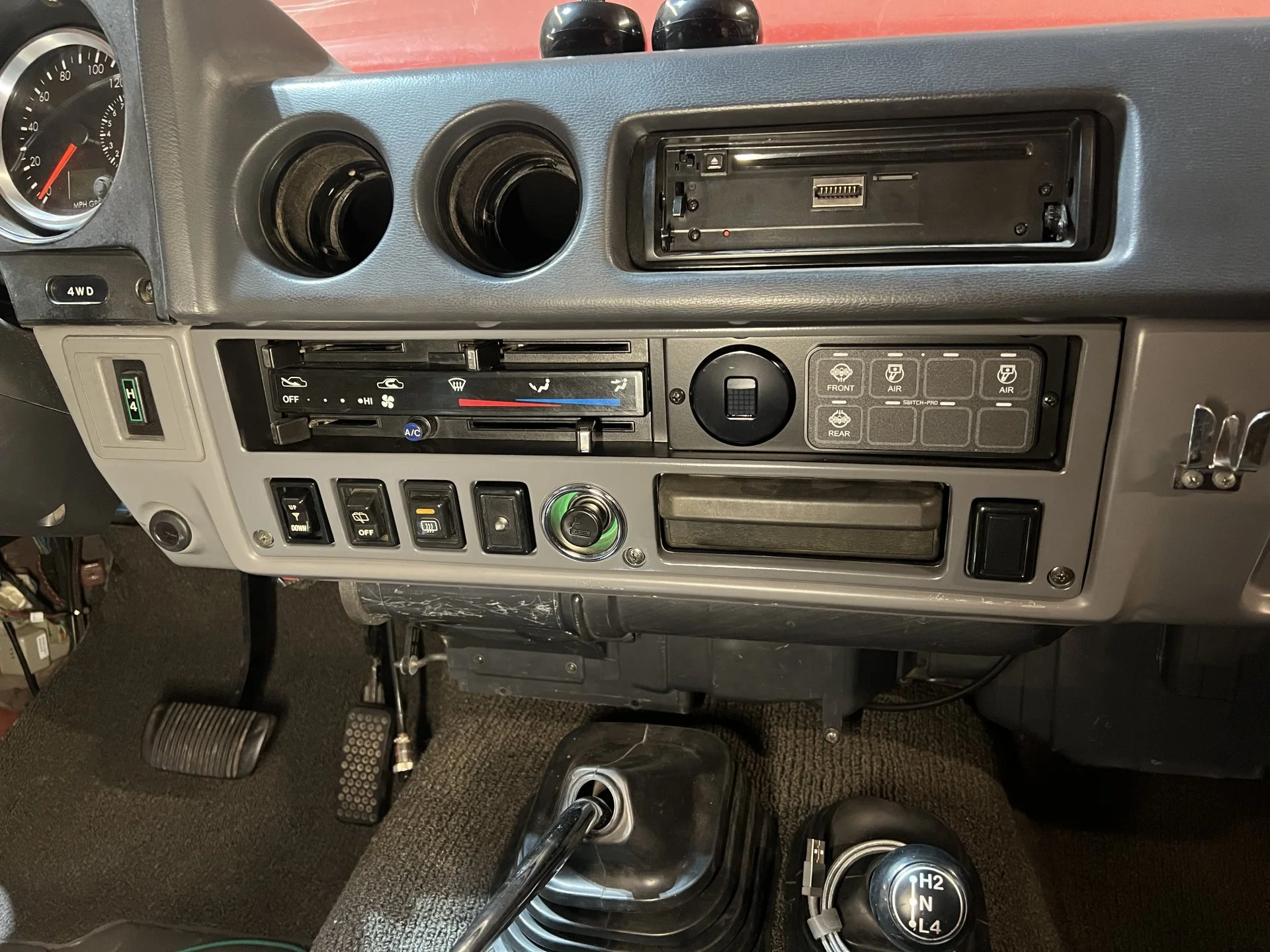

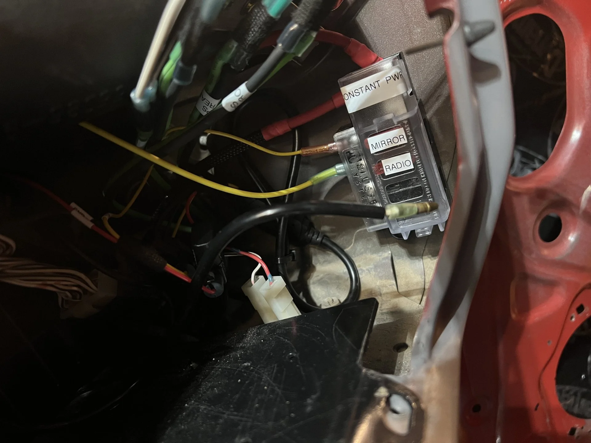

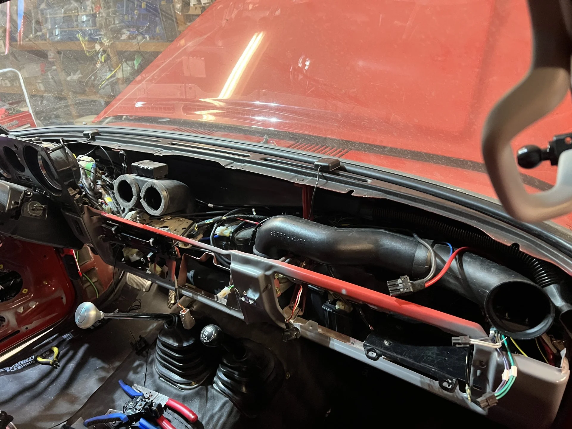

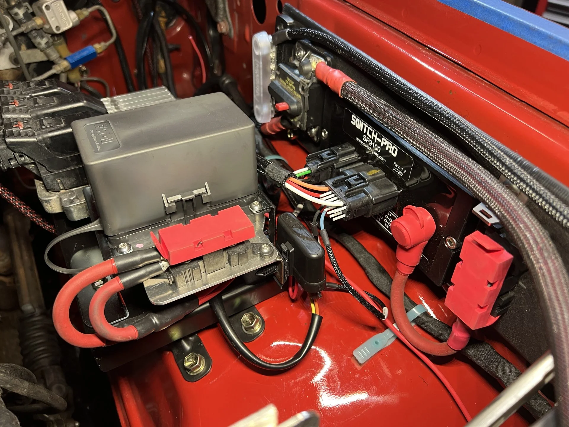

Next, I started working on some interior bits and pieces. I added a small fuse box to the right of the glovebox for some constant power needs. This fusebox feeds constant power to the amp, the radio and my mirror. I like where I put this because it is hidden, but easily accessible if you take the glovebox out.
I also finished the wiring for the seat motors & heaters, my HAM radio, USBs and SwitchPro. I ended up redoing a bit of messy wiring that was in the dash as well. I got a little carried away and this ended up taking longer than expected.
I also got a little carried away with putting things back together inside...I ended up fully installing the dash, the front and mid carpet section, the new body seals (these are the molding/seals that attach to the body in the doorways), intirior trim, seatbelts and the center console. I was going to wait to install all this until I had made sure all my electrical was working but once I got started, it was hard to stop!

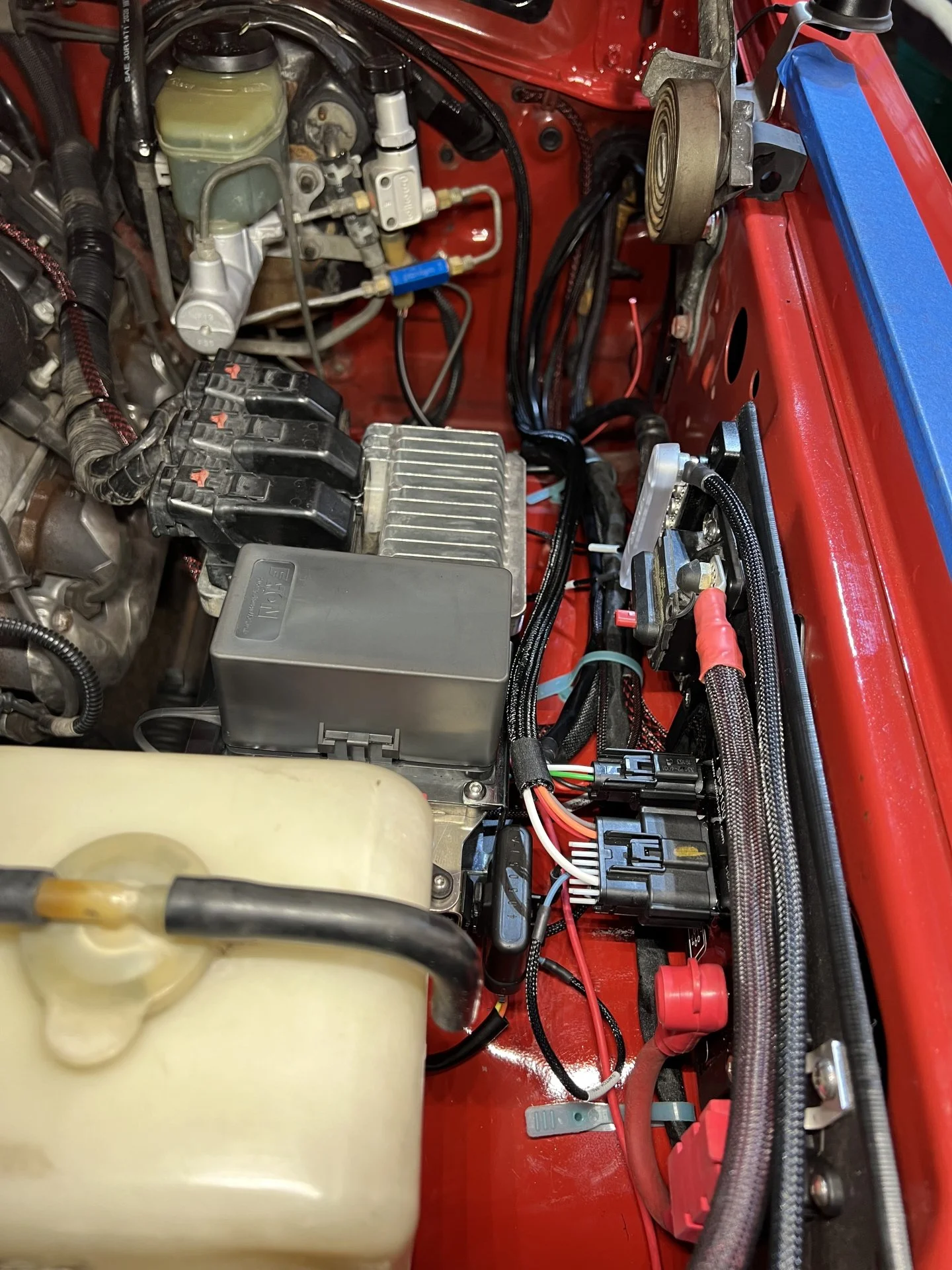

After the interior activity, I started finishing up with the wiring on the driver's side of the engine bay. Making this complicated mess of wiring look clean is not an easy task!
I also made some new battery cables (positive and negative). I think I'm pretty much finished up with the driver's side of the engine bay 🥳
Here are the ground cables for the driver's side battery - I did a small cable to the fender where it picks up another cable to the frame and then another to the engine block. I will do the exact same thing for the passenger side battery. This is all 2awg marine cable.

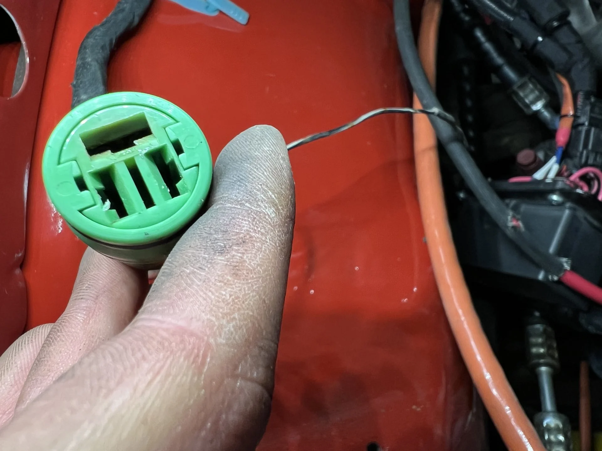

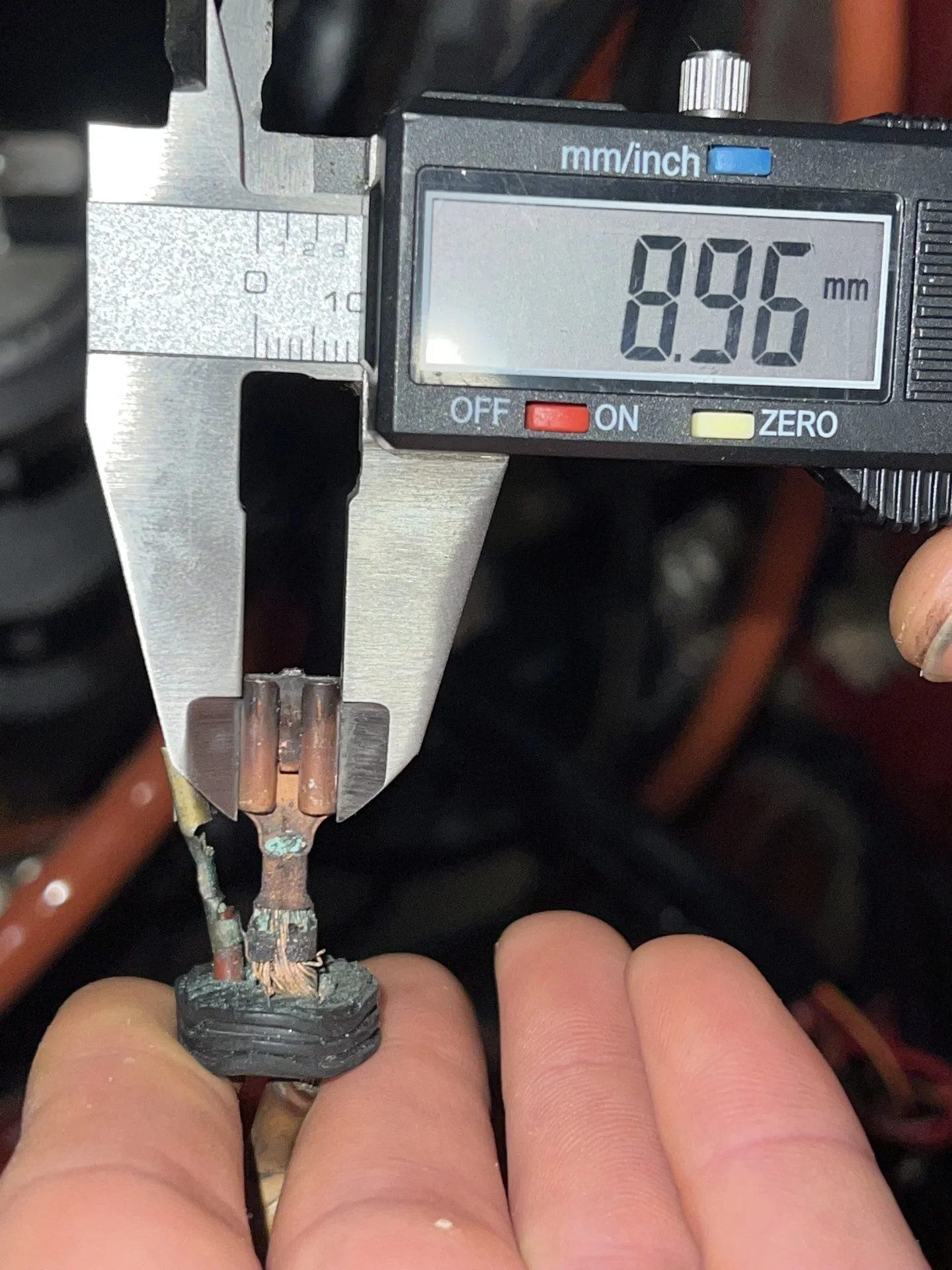

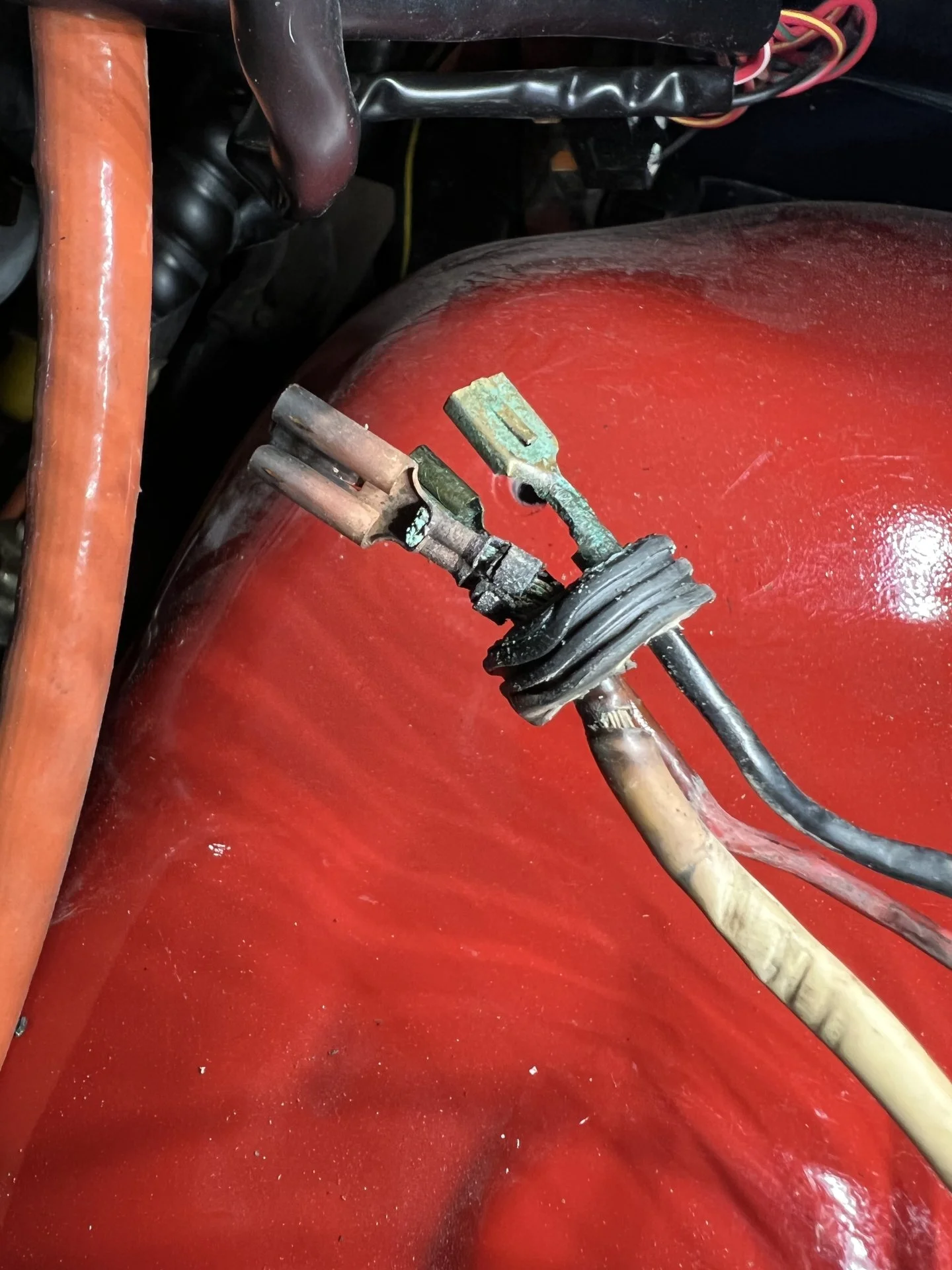

I also found this little treat today... This is the harness side of the fusible link. I noticed that the white wire sheath was discolored and looked a bit burnt. Then I noticed that the sheath was cut. I removed the connector from the terminal to find that the wire was mangled/frayed and the terminal is almost black! The other two terminals have some decent corrosion as well. I think this is a 7.9mm female terminal and the wire is between 12 & 10awg but if someone could confirm that, I would appreciate it! I believe the other two are just standard 0.25 female terminals. I'm not sure what could have caused this, but I'm glad it didn't catch fire!!
