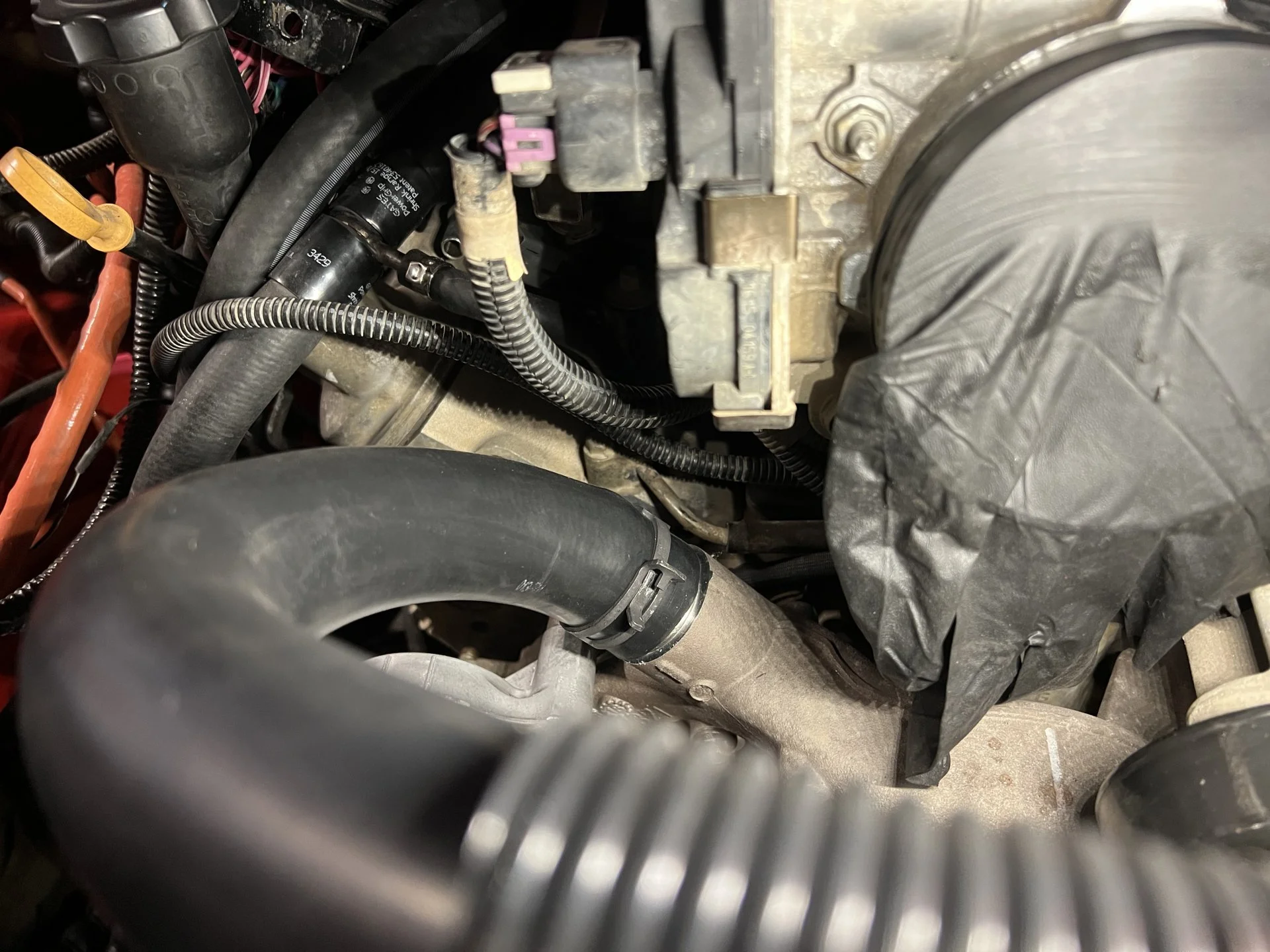

Had some time this weekend and was able to install the new upper radiator hose. The previous one was nice because it was a single hose that was cut down...no need for a coupling. The issue was that it was just slightly the wrong shape on the pump end, so it was kinking pretty badly. The other issue was that my radiator opening is 1.5" and the old hose was 1.25". I was able to stretch it over the radiator opening, but it was tight and I had to cut it off any time I wanted to disconnect it.
The kink in the old hose:
The new setup is two separate hoses - one is a long snaking hose that is 1.25" diameter. This is cut down to fit. The second hose is a 1.5" 90deg elbow (also slightly cut down). I used a nice aluminum reducer to connect the hoses together.
The 1.25" diameter hose:
The new hose has a better curvature that shouldn't kink.
