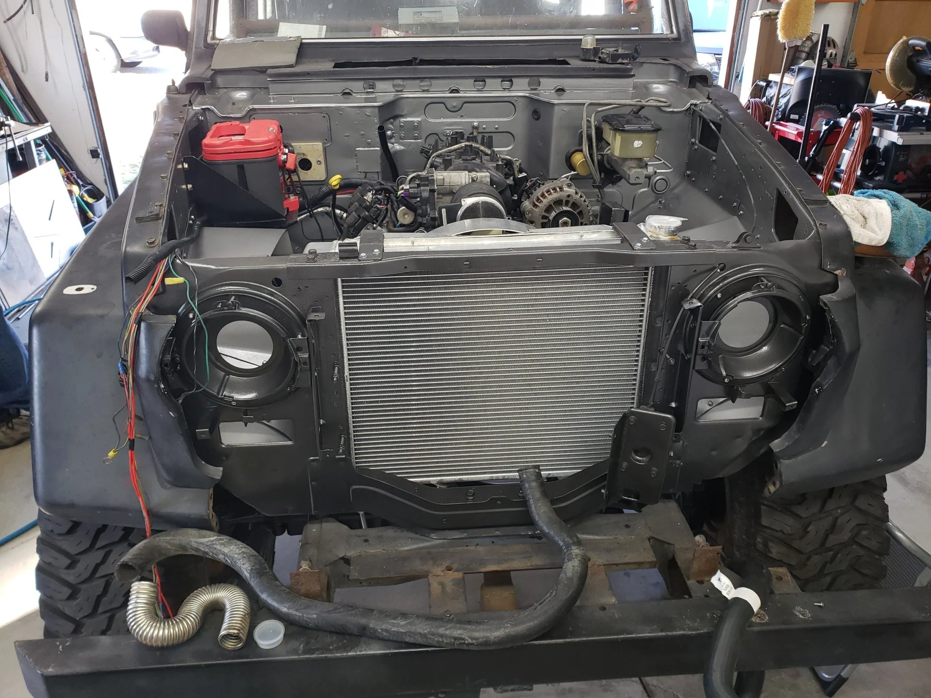

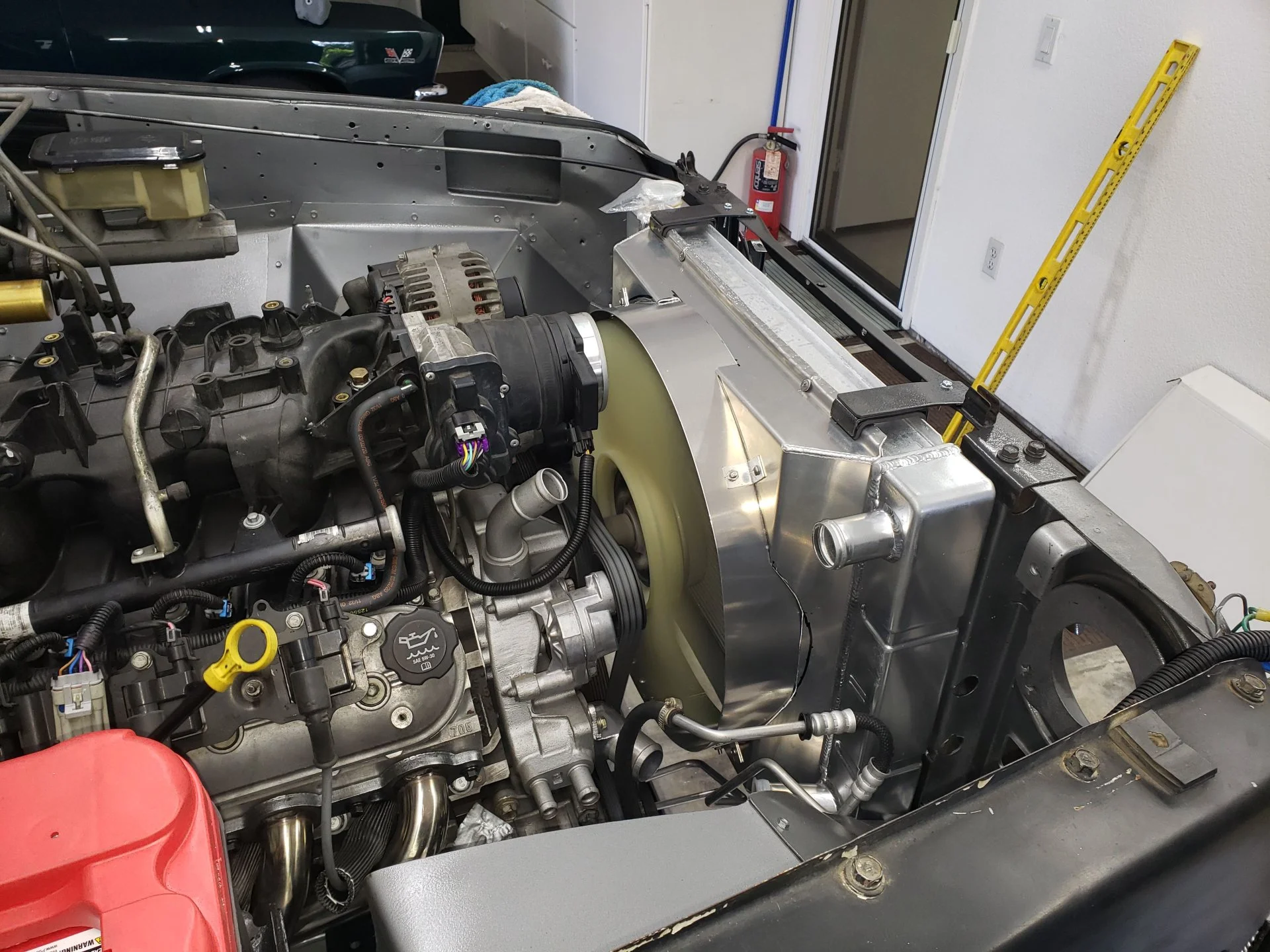

This is what I got. It is a double pass and the single is like $179 or there abouts. At the bottom has the links to the shroud kits. Keep in mind this does not have a trans cooler. I prefer an external anyway. My transmission has been very happy with that setup. Honestly I think the internal inside a radiator actually warms the trans up more than it needs to go.
I got the 26 inch radiator and I was able to fill in the whole space with the core. The 60 might even be able to fit a bigger radiator, not too familiar with them.
If I had means to TIG or the time to TIG I would maybe suggest that for better looks, but this setup is working really well.
This is with condenser and trans cooler.

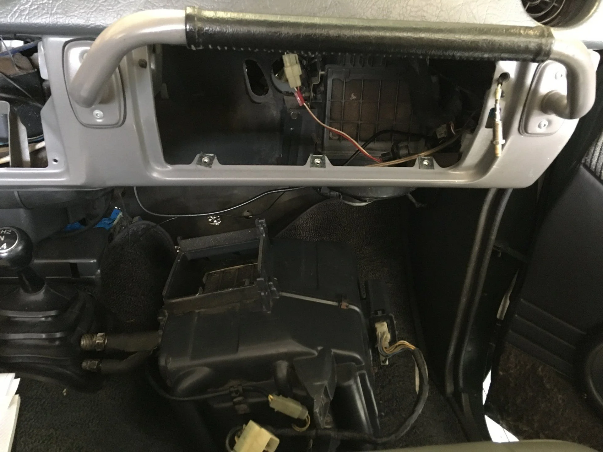

Whether or not you are going to change your Evaporator or not, youll need to remove it. You can do this with only removing your glove box. Heres a good thread on it:
Once removed, mark all of the electrical connectors in there so you remember to connect all of them. Its easy to forget one and youll spend an hour wondering why your compressor isnt kicking on with the dash button being pressed.
Once the lower evaporator is removed you can either replace it with the new parts or clean out all the dirt and leaves from it. Before putting it back in add 2 oz of PAG46 oil with dye to one ports and blow it into the evaporator.
(not recommended) Then youll remove a resistor from the Amplifier shown in this link here:
(recommended) You can also bypass the Toyota Amplifier completely and wire the AC to work to mirror the GM system, but its a little bit more work involved and using the toyota stuff is much easier. And much less work. Controlling the AC with the ECM or PCM is a much bettter move than using the 35 year old board that is the amplifier, and it will be all self contained. Later on in the thread I’ll show you how to bypass the Toyota ac system to work with the GM pcm to control ac idle up and e fans, if you are using a Gen 3 pcm.
Its here in post #79
Get your Evaporator reassembled and reinstalled into your dash and make sure to reconnect the plugs.

Once everything is connected (dont connect the PCM yet) go inside your truck and remove the driver side kick panel. I went ahead and completely removed the emissions control box and like 10 runs of unused wires. Be sure to double check the Wiring diagram posted in the following post to be sure it is safe to remove the wires. When you terminate a wire use the marine heat shrink on the exposed wire end, heat it to shrink and squeeze the glue for a good bond.
After you remove the emissions control box youll have a nice convenient bracket available and a large empty space against the wall behind it. Youll use this space for 3 relays for cruise control a little later and a dakota digital tach box if youre keeping your stock tach.
Dont be intimidated when youre looking at a view that looks like this...
Next Youll need to run the cluster of wires through your old clutch master cyl hole and into the cab of the truck. If you angle the Gas pedal plug just right it will fit through the clutch hole. You will need to depin the OBD2 plug to get the wires through though. Just take pics of the back of it and use your handy delphi tool to do it and repin it once the wires are through.
Mount your obd2 plug next to your hood release on the bracket. Then if your harness came with a check engine light you can either just use that one, or piggyback off of the wiring for that light up to your now unused choke light. I just cut and spliced the wires with the open barrel crimps up near the bulb. Terminate the old wires with marine heat shrink. From here you will want to take the strongest rubbing alcohol you can get and rub the words CHOKE off of the choke light housing. Then contact Mo Faraz for a dry transfer decal with the OEM toyota engine graphic and the word CHECK. I measured this with calipers to guarantee that they fit before he designed them.This will now be your check engine light.

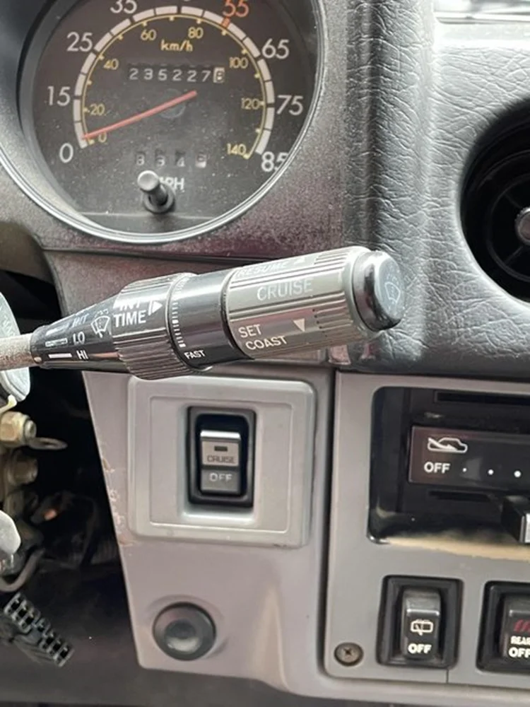

If none of these tickle your fancy you can use the setup i built using all 1980s era toyota parts. I havent seen this done anywhere online in any 60s yet so youll be one of the few to have it!
I dont have too many photos of these because i was originally not planning on posting this here, because its kind of a lot to get it to work.
Theres a few ways to do this and get the same result.
The 2 big things you are trying to figure out is the hazard switch orientation and the intermittent wiper function relays. The 60 and the corolla have horizontal hazard switches, the 2nd gen pick up and 1st gen 4runner use vertical hazard switches.
There are early and late intermittent wiper stalks out there too. The earlier ones use an external box to house the relays to make the intermittent wipers work. The later ones have the relays and cb built into the stalk itself.
You are essentially trying to make all of this stuff work together...

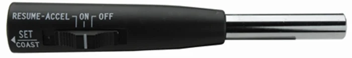

Easiest way to do it would be to buy a 1982 -1985 corolla combo switch assembly with cruise. This will have the cruise stalk already installed and the proper facing hazard switch. Since this is an earlier stalk, you will need to decide on whether or not you want to run more wires to (and source) a wiper relay box from that car, or graft the circuit board from a later 4runner onto the corolla wiper switch. The wire colors all match between all of these combo switches and the cb is not too difficult to move over, especially if you know someone who can solder a circuit board.
This is the best and cleanest way to do it, and if i could go back this is what i would do if i was to do it again. I didnt find out until later that the corolla had the horizontal hazard switch.. :/ that being said, i havent physically held the corolla combo cluster in my hands so its on you to try that one out. I used 3 different combo switches and merged them all together. It would also be worth checking to see if you can find an 87-89 4runner combo switch with cruise to see if the relays are already built into it. I had trouble finding one of those but theres a chance that the later combo switches with cruise shared the same later intermittent wiper switch design with the relays built into the stalk itself. This would save you a ton time on this if its true.
The actual easiest way to do this is to find a late 1980s 4runner combo switch assembly with the cruise control stalk. The late 1980s 4runner and pickup combo switches have the relays installed already. So youll just move the stalk and base over to your fj60 combo switch and repin the blue connector at the bottom like in the link below. I definitely made this much much harder when i did it on my truck. Doing it with the late 1980s 4runner or pickup combo switch will make it so you dont have to solder any circuit boards or anything. Just look for the combo switches with the larger translucent BLACK cover on the back of them. I put a pic below under where it says "Wiper with relays built in and vertical hazard switch"
If you source all the parts and mail them to me i can swap it all over for you, just pay for shipping if you go this route.
The way I did it was to use my fj60 combo switch and remove the wiper assembly from the center section completely. I then got an early 4runner cruise control/wiper stalk, took the pin out of the arm and removed the arm and wires from it and transplanted it to a late 4runner wiper switch assembly. The wires are all the same between the two. The cruise is two wires that are split off from the wiper wires. Then just attached the early 4runner arm to the late 4runner wiper base and soldered the early 4runner intermittent wiper wires to the late 4runner circuit board that control the intermittent wiper functionality the lines are really easy to trace on the cb and the wire colors are all the same. The rest of the wires were just pinned into the blue connector at the bottom. Unfortunately, while all of the wires are the same, the holes for the screws that hold the wiper part to the center section are not the same, i just used zip ties to secure them together. There are a TON of others on the forum that are doing this same thing, but with just intermittent wipers and no cruise. They have had no issues with the zip ties, and i havent. That said. If i was to do it again id go with the entire corolla combo switch.
Once its all put together, just repin the main plug the same way it was pinned before. The Red and Green solid wires will not be a part of this plug and will be on their own. They are the set coast and accelerate wires. All the other wire colors will match what you had on the fj60 to begin with.
Here is the combo switch before i swapped everything around. I already swapped the Late firstgen 4runner intermittent wiper stalk onto my fj60 combo switch a year or so ago for the wiper function. The image shows the Late firstgen 4runner wiper stalk on the left, fj60 center section in the center, and firstgen 4runner cruise stalk on the right. In the top right is the center section of the early firstgen 4runner combo switch too this is the cluster that i pulled the cruise stalk from. I basically put the stalk and wires from the one on the right onto the base and circuit board of the one on the left. It sounds super complicated, but its really not. Its just kind of complicated to explain via text. On the stalk on the right if you look at the wires youll see a white square plug, thats the wires for the intermittent wipers If you go with an external relay box those will go to it, or youll use those to tie into the CB of the 4runner stalk base
All of your wire colors will be the same, youll just depin them like this
Corolla combo switch, wiper with no relays horizontal hazard switch
Once you are done with this, youll have intermittent wiper functionality of a newer vehicle, your washer squirter, and cruise control set/coast and Accel/resume all on that one stalk. Next youll need an On/Off Switch.
Another thing you can do is just use the 4runner base with the vertical hazard switch and just cut your steering colum plastic clamshell thing. It would make it work but isnt as clean of an install. I couldnt find a clamshell clean enough to try this, but you could also see if a firstgen 4runner clamshell will match the bolt holes for the fj60. With how interchangable all of this stuff is, it wouldnt surprise me if it fit.
