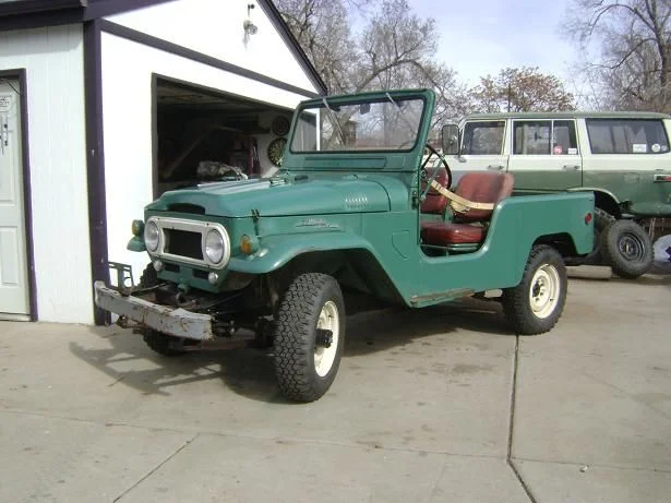

Anyone thought of putting stock size tires on their FJ40 restoration?
Here are some 30" tires.
Somewhere I have pics of the swb sporting the RK3s, I only put them on once and a while, for show. Will not drive on them.

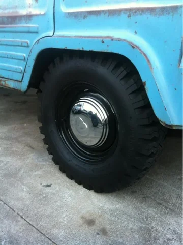

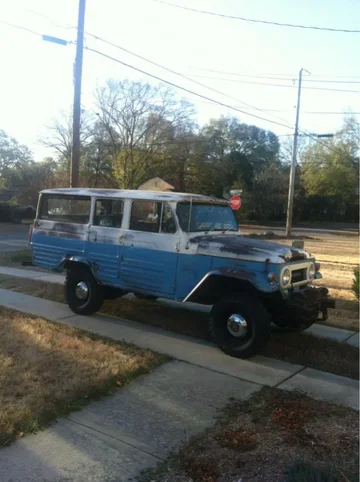

We found a Snow Cruiser, in good condition, from a fellow 'Mudder to match the set that came on our stocker. Came in the mail. Used our rockcrawler to pop the bead and replaced the stem...makes a fine spare.
Stockers are SO sexy.

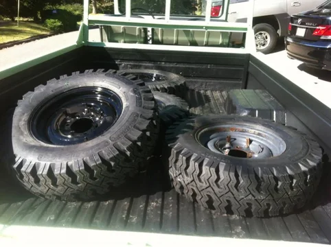

Anyone seen a good pics of an FJ with stock black rims and stock chrome hubcaps? Specter Offroad has both for sale... thinking of splurging. Seems like the classic stock rim is typically grey though?? Thanks for any thoughts.
Look up a couple of posts and you can see the correct black rims and hubcaps for 1968 and older 40 series on our LV.
If you have a 69 and up the wheels would have been grey.

CruiserHWB, Re: black rims from Specter Off Road. New OEM rims from Toyota arrive with a black primer finish. The ones in the picture above were painted Massey Fergusen gray. Somewhere on this site I saw it was a pretty good match to the original gray and is available in spray cans from Tractor Supply, Co.
