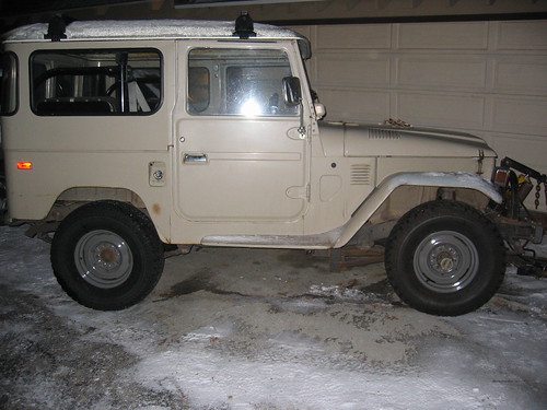

I have 31x10.5's on my stock rims right now and I rub on the drag link at full lock....otherwise, there's no interference on wheel wells, etc. Here's a pic:
Stock tire size setup

Here's a pic with 235x75x15 with stock steel rims:

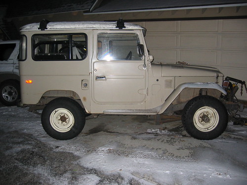

Here's a pic with 31x10.5x15 with stock steelies:
I don't like rubbing on the drag link at full right lock with the 31's, so I'll probably go to a 9.5 with the next set, but I already had the 31's from another rig, so I'll stick with them....
You don't have to rub on the drag link - on the knuckle are the steering limit bolts that limit how far you can turn the tire. I don't have a pic handy, but on the knuckle there are two bolts, one front and one rear, that hit on a bump stop to limit tire rotation in a turn. Adjust this and you won't rub. Pretty simple, and lets you have a wider range of tires.

I agree, I have the stops adusted on my FJ40 that has been restored and I don't have rubbing (31 x 10.5 x 15). They are on the housing front and back of the wheel hub.
