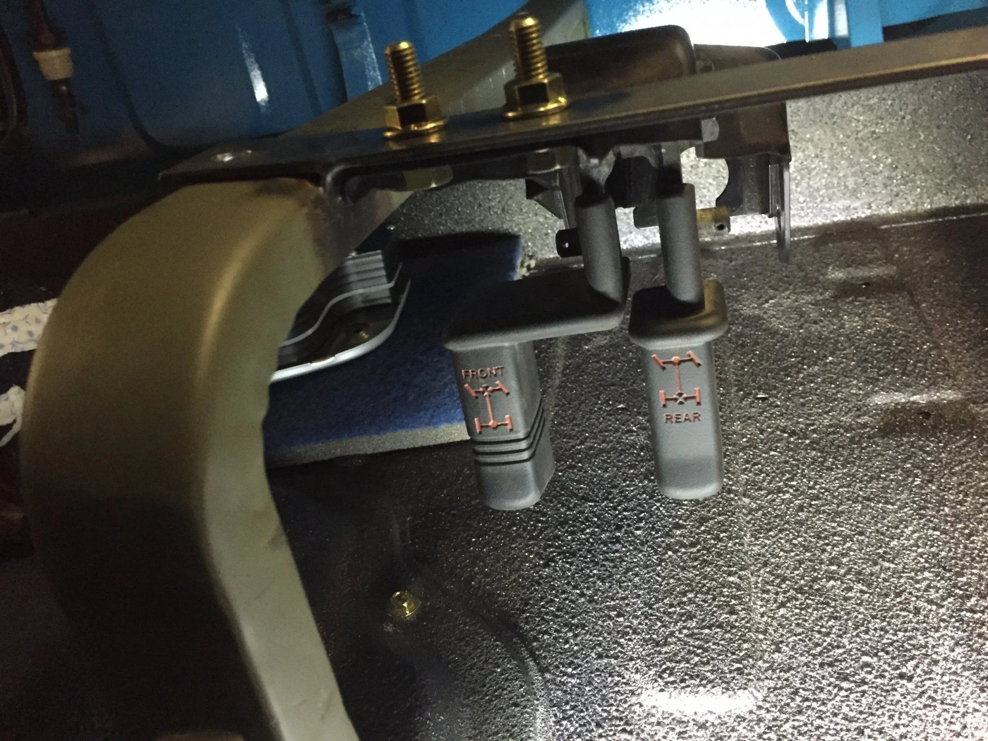

Anyone fitted cable lockers to a 40?

Hey guys just wondering if anyone has fitted cable lockers in their 40 and if yes would love to see a pic of where you mounted the levers etc. I managed to score a set that were on a 61 that I bought for the 12ht!

This is my cable mount location. I used the 70 series cables, levers and bracket.
