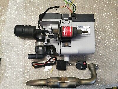

Really pleased with the Webasto kit I got, it is a used/rebuilt unit that included wiring, a remote fob, exhaust and silencer, air intake filter, and fuel pump. Cost me $430 USD shipped, which is a far cry from the $1200-1600 I normally see for new units. I debated whether or not I should get one for over a year, but with semi-regular -20ºF and lower temps every winter and no place to plug in it only made sense.
This is what I got:
