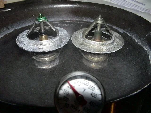

Rare that a new OEM Tstat would be defective but you can test it by placing it into a pan of water on a stove with a meat thermometer to check the water temps, watch to see if it opens fully as the water heats up (should open ~10+mm @ 95C/203F)
New OEM Tstat on left, Old OEM Tstat on right. Note the gap is wider on the new Tstat @ ~203'F
The old Tstat in the photo did open but not as much and not as quickly as the new one
I’ll pull it and check!

@mindcrash : You could leave the Tstat out and go for a drive to check where the temps go ie: the engine should run too cool (less than ~190F) without the Tstat.
IMO/IME there's any question about the Tstat (function) might as well replace it.
