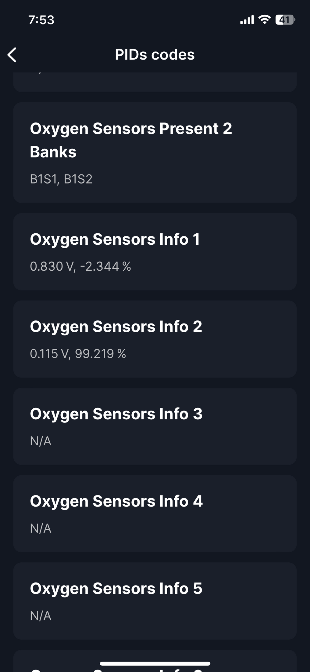

Your data screenshot does not mean much as one would need to see live data. Sensor 2 is what you need to be looking at for a clogged CAT. Voltage readings should be steady and not fluctuate like sensor 1.

To clarify, I did mean a bluetooth OBD2 gauge with an app on my phone to view realtime data is what I used. Yes, coolant temp went over 233 F. I've driven it approx 6 miles since filling the rest of the tank with good gas. Let it idle in the driveway and even then, revving the engine caused coolant temp to shoot up to 217 F.
