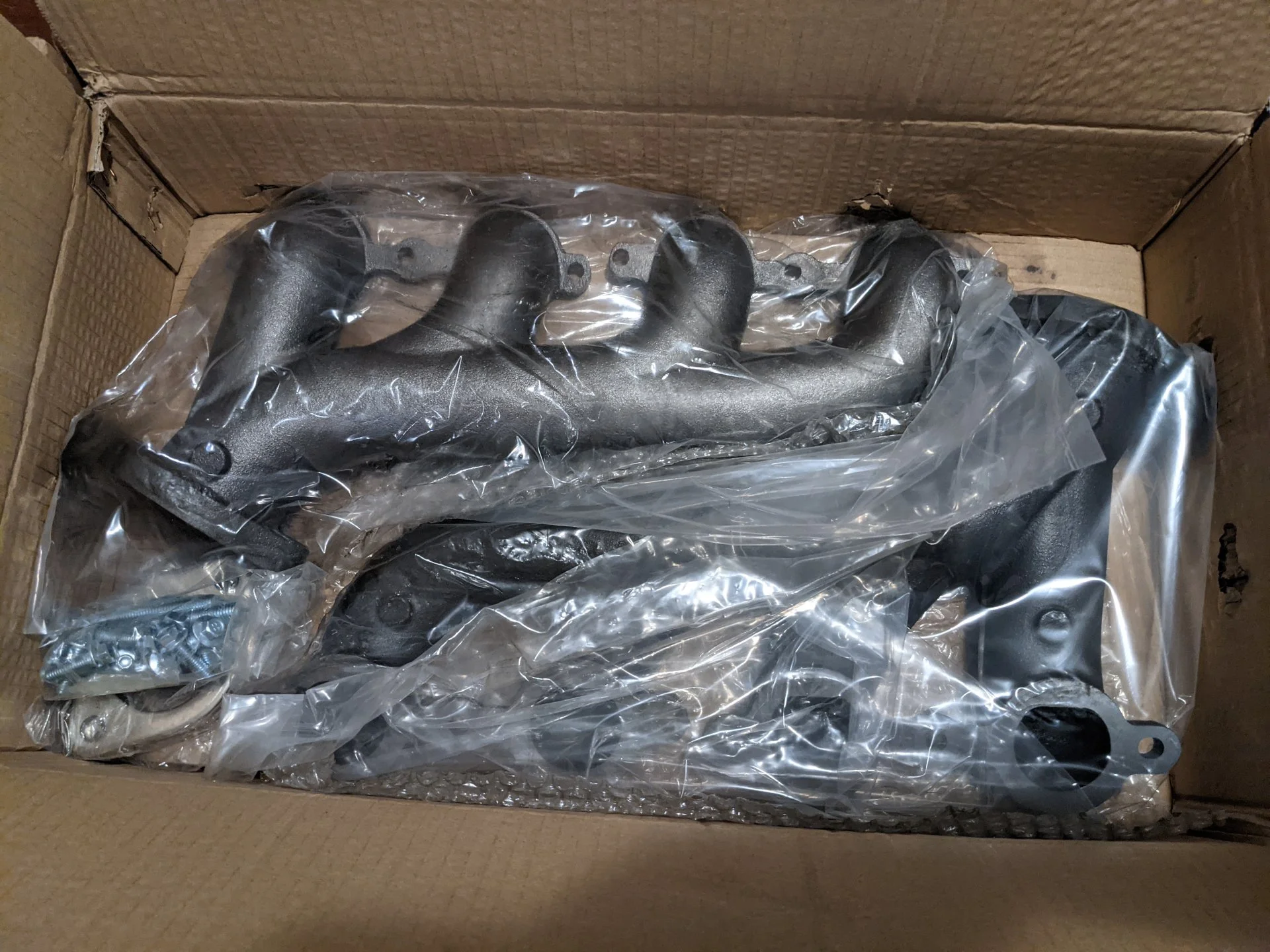

Ordered my exhaust manifolds and gaskets from Summit today. I went with universal swap manifolds to hopefully clear the frame rails.

Well exhaust manifolds arrived today. Looking good on all fronts as long as I can get the adapter sorted. Hoping to get ahold of Marks on 1/17 when they are back in the office.
