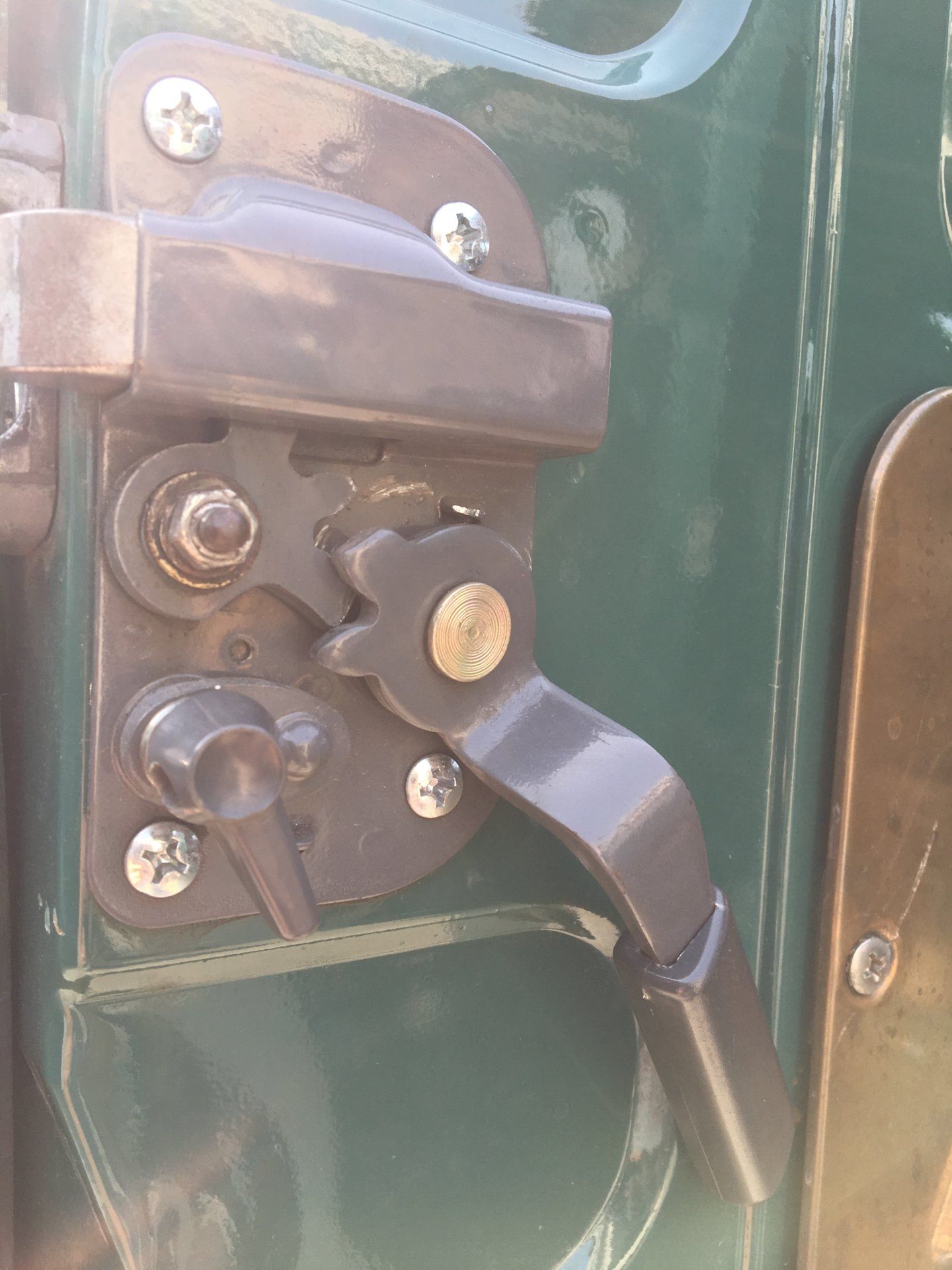

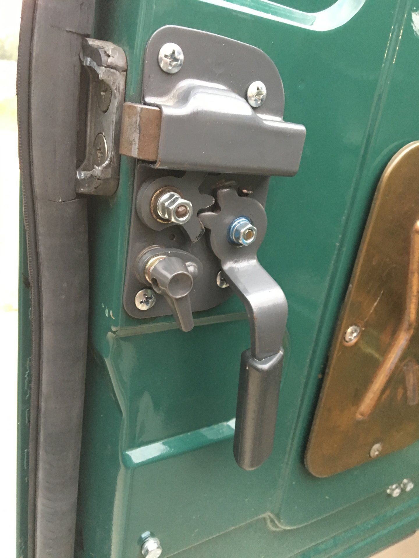

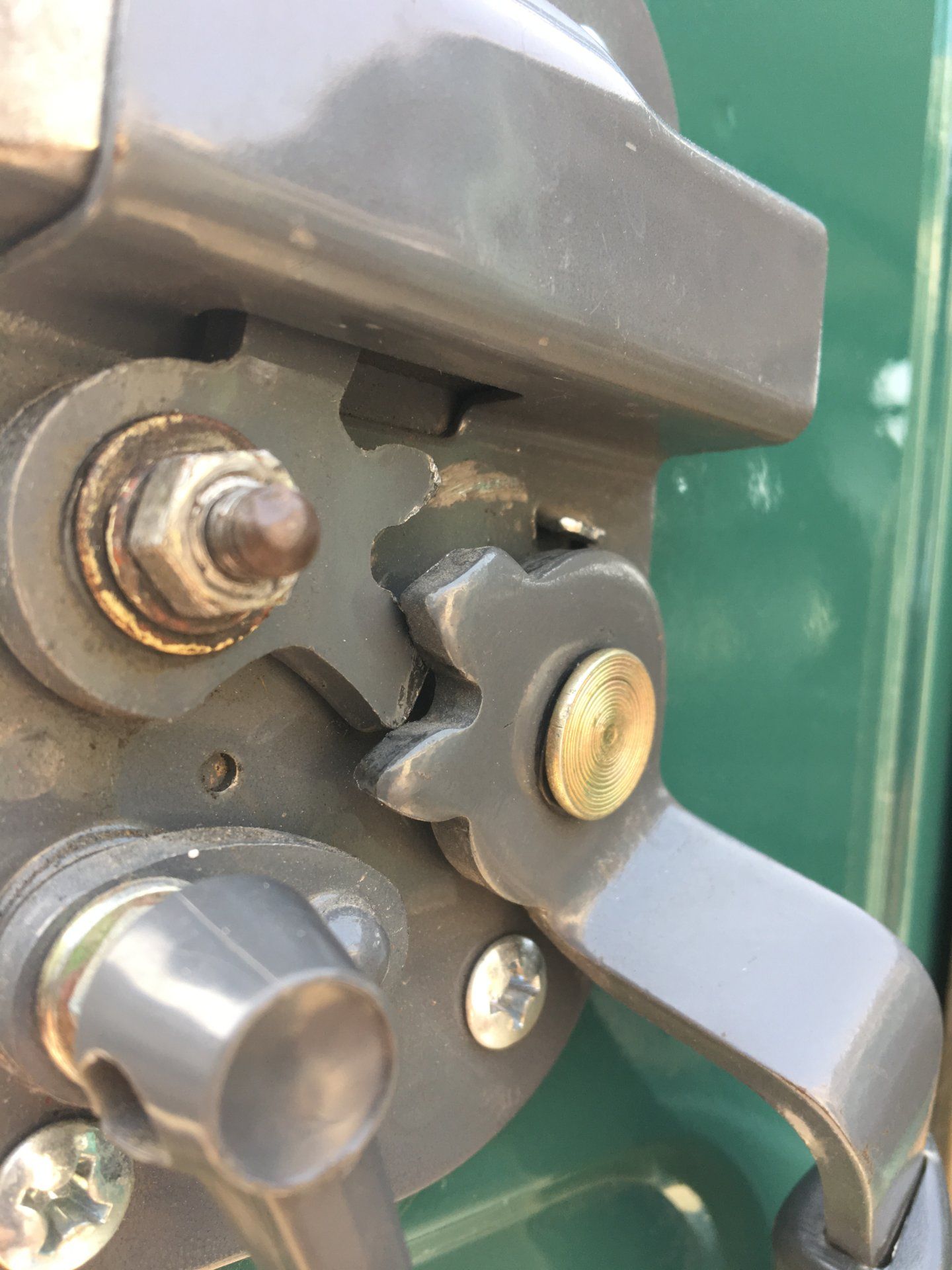

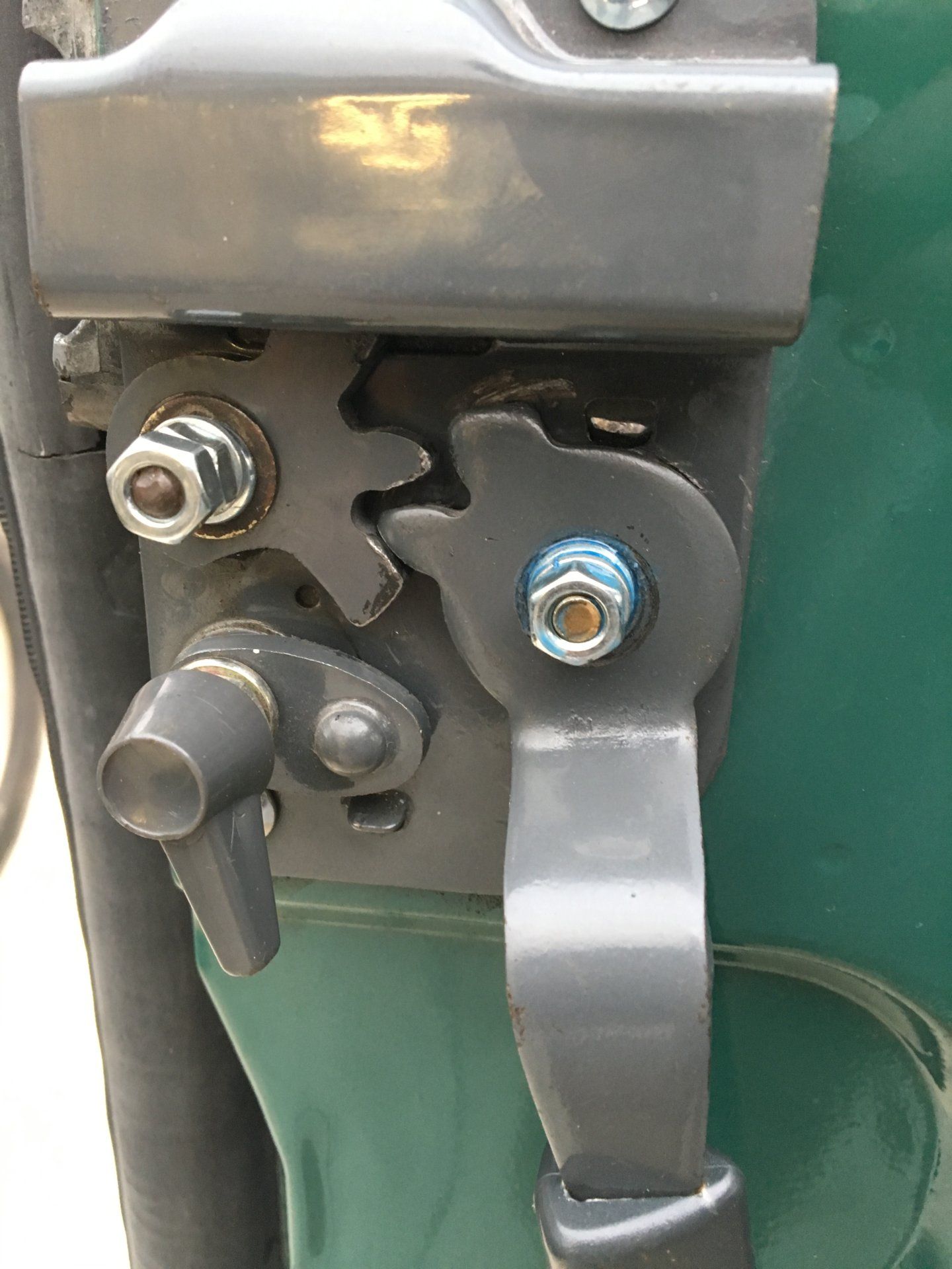

This is how I fixed my door latch. I actually just ground and
punched the original pin out, ground it a little, put it back in the hole and held it down tight then hit it with the mig a couple of times. Came out very tight and operated fine. The only reason that I changed it out was that the plastic handle was torn.

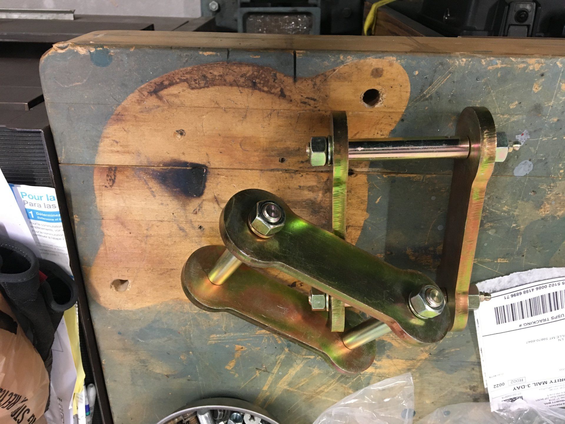

On another note, the add a leaf for the rear helped out a little. Unfortunately it still bottomed out when I have it loaded down with gear and the family. Further research has lead me to get some longer shackles again, apparently the Skyjacker leaf packs need the longer shackles to accommodate full flex of the springs. While I was loaded for the last trip I checked everything out, the springs were not sagging or flattened out at all, they just need more room to flex.
Aside from relocating the rear spring hanger, shackles seem to be the next best solution.

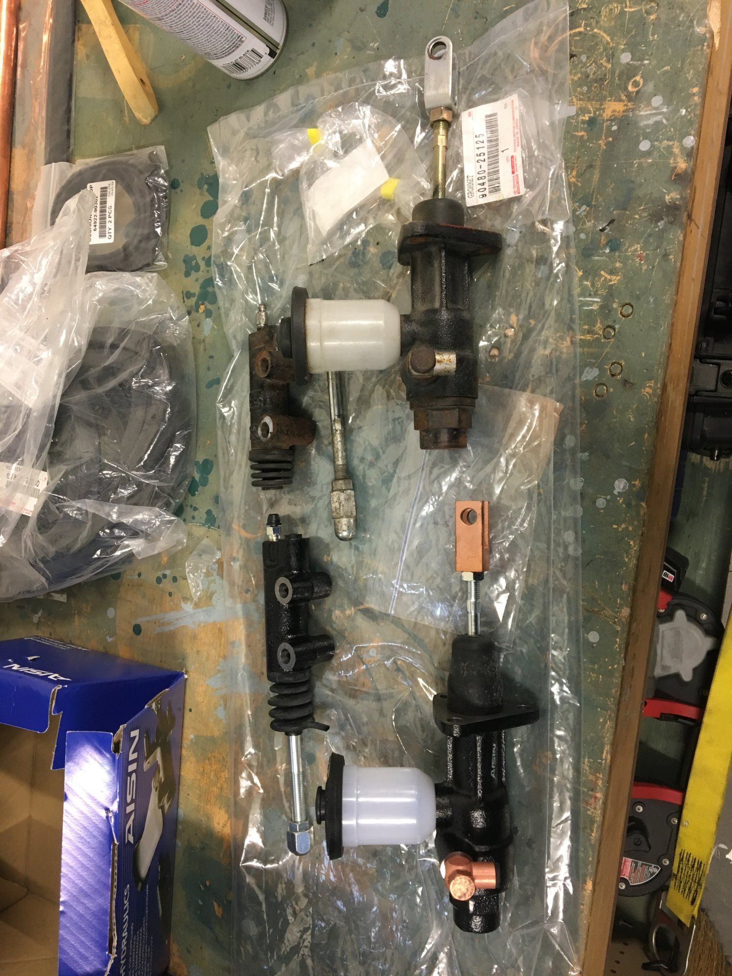

Today I replaced the clutch master and slave.

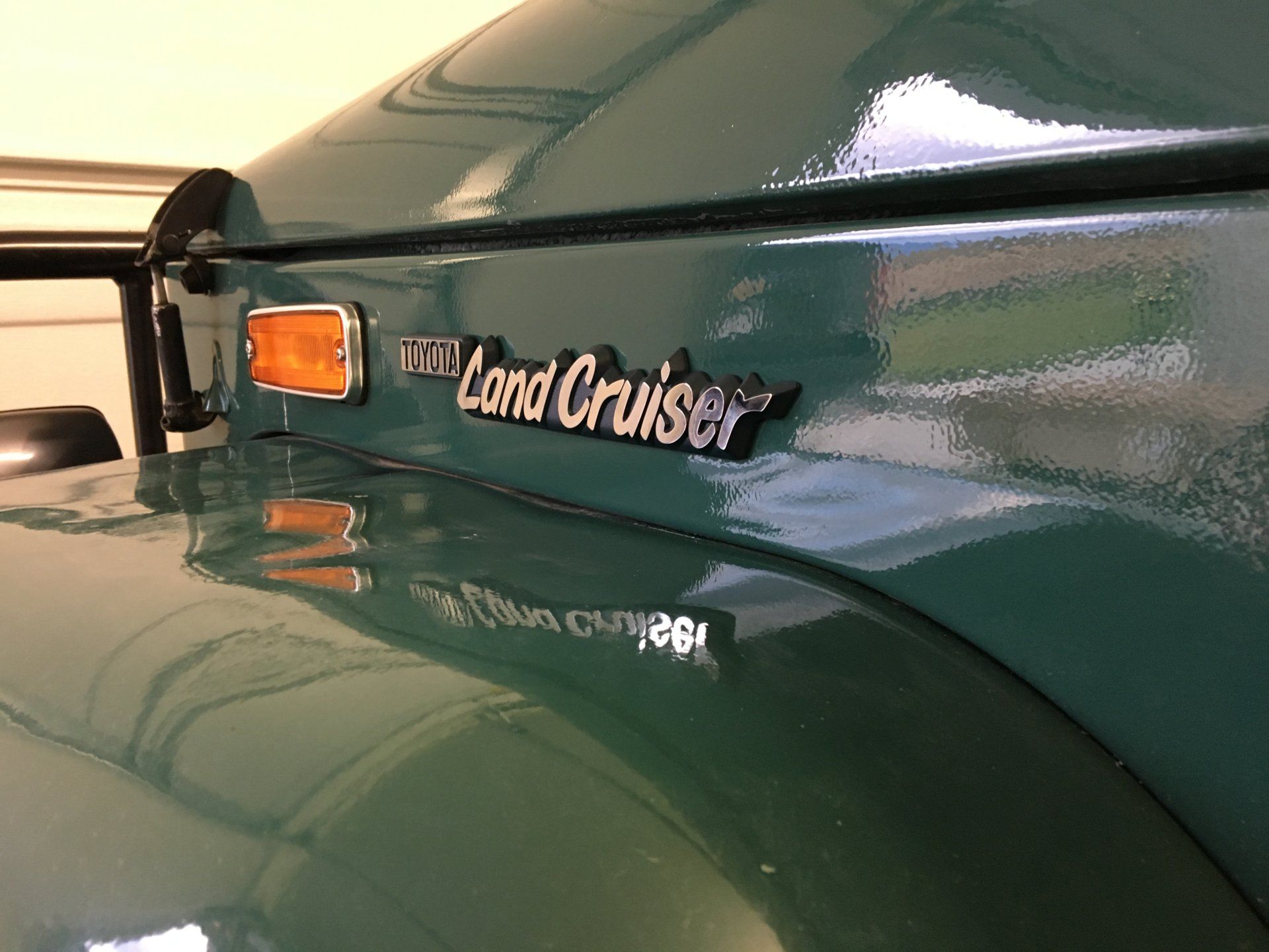

Fender apron emblems went on a couple days ago.
Next is the rear hatch weatherstripping and some longer shackles for the rear.

I squeezed some time in on Saturday evening to get some stuff done, replaced the rear shackles (again), finished the rear hatch weatherstripping, and gave it an overall check.
Spent Monday roaming around the mountains to see how it handles with the longer shackles.
So far it rides perfect now, no noticeable vibrations from 0-65mph, in fact it rides so smooth at 65 that I didn’t notice I was cruising that fast. Hit some forest service roads to give the suspension a workout, not a problem to complain about!

What kind of shackles are those in a couple posts up? Are they 1” longer than stock? @rkymtnflyfisher
Those shackles are about 4 3/4” pin to pin, they gave a little extra room for the Skyjacker lift to flex out.
Thanks, so they are Skyjacker shackles?
No, I’m sorry, I’m not sure of the brand. They appear to be the Man-A-Fre dog bone shackles.
They are not from Skyjacker though, I picked them up in the classified section a couple of weeks ago.
I have a set of 5 1/4 anti inversion shackles if you’re looking for longer ones.
