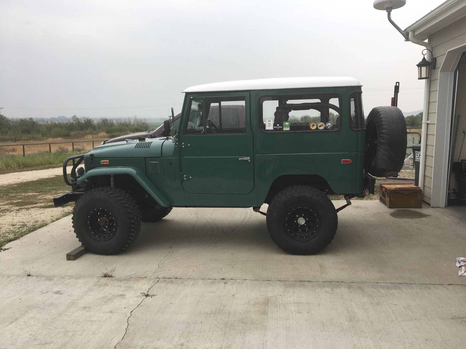

So the story behind the work on the 40 yesterday.
After adding all the steel back that was eaten away by the rust monster, installing the rear swing out beer cooler carrier, the fold and tumble in the back and the weight of 2 teenage kids, I had overloaded the rear leaf springs.
I went with the quick fix a few months ago of adding longer shackles, well that turned out to be a disaster waiting to happen. I created a few other problems by changing the geometry of the driveline, it looked good though.
So after talking with @orangefj45 on the phone he walked me back to what the problem really was, and more importantly how to fix it. Correctly.
After buying the new house, moving (still unpacking), driving across the US to Maryland for 2 weeks, and working every day, I didn't have much time to spare to work on the 40. Well after beating up on the 4Runner on Sunday my wife has had enough of me using that to explore the mountains, sweet, now I can fix my 40 without hearing any grief. (New tires coming for the 4Runner)
Yesterday I pulled both leaf springs from the rear and installed a new add-a-leaf from Skyjacker, the install went about as expected, the hardest part was lining the pin back up into the hole on the spring perch on the rear axle. Other than that it was straight forward.
So far the shackle angle looks a 100X better, loaded the kids in the back and it still looks great, rides about the same as it always has, and doesn't bottom out on the frame when loaded. I plan on loading it up this weekend and going fishing for a full day, food, beer, ice, tools, gear, chairs, family, the whole nine yards. Time to test it out.
I want to thank Georg for not trying to sell me parts, instead he took the time to gather info from me and told me how to fix my problems the right way. Thanks again.

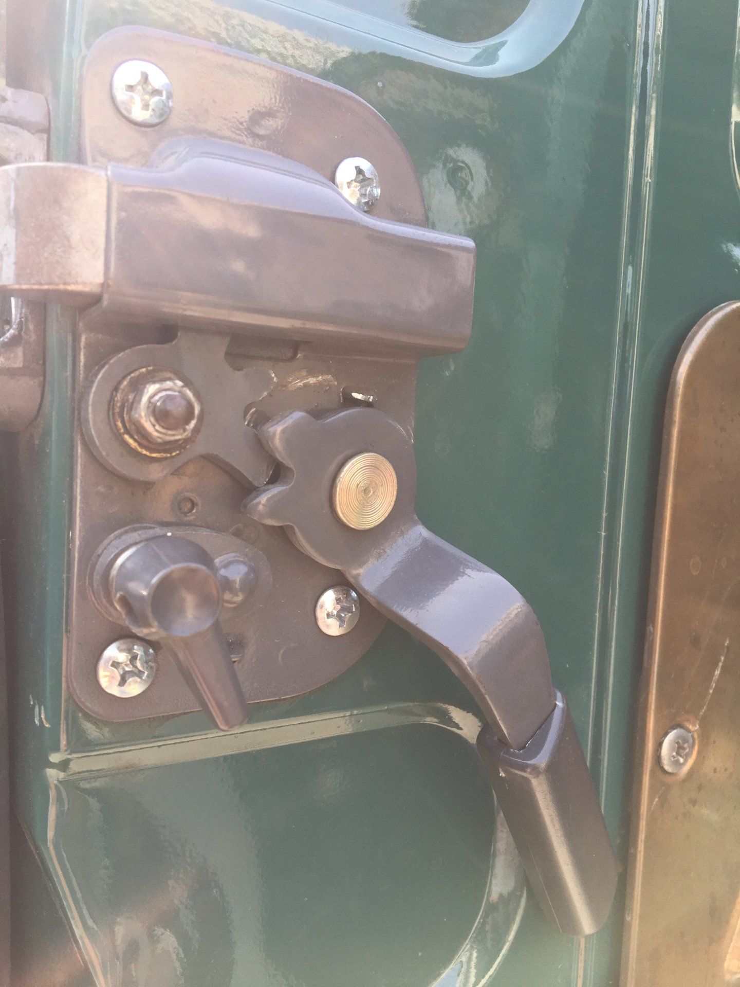

Had the same problem with my latches - Just take them off and weld the washer on the pivot pin on back of the latch. Will tighten it up reaal nicee!
