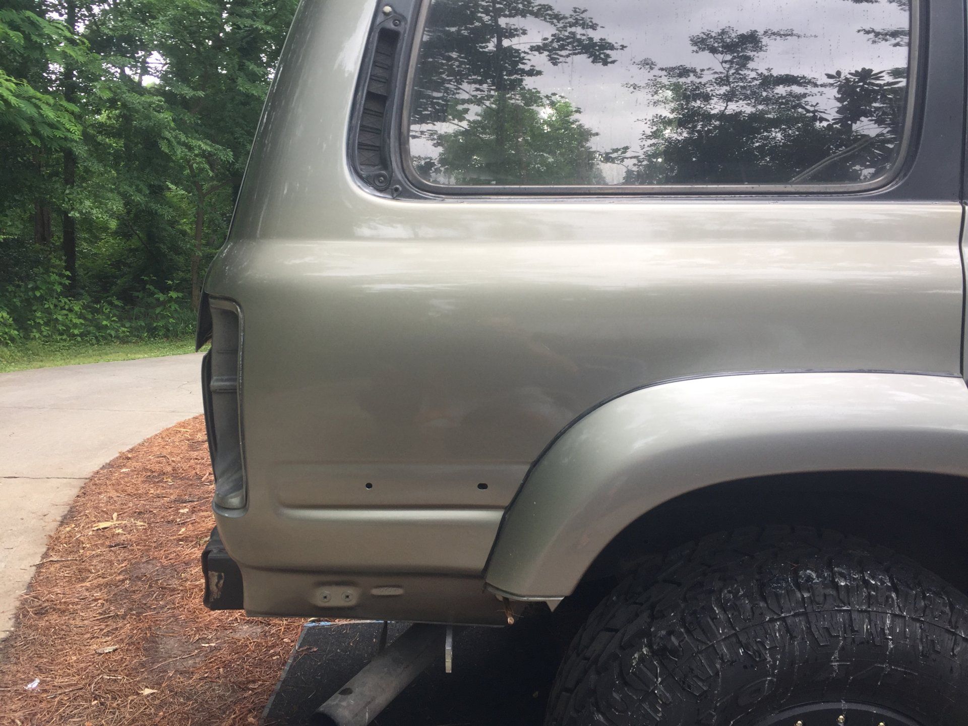

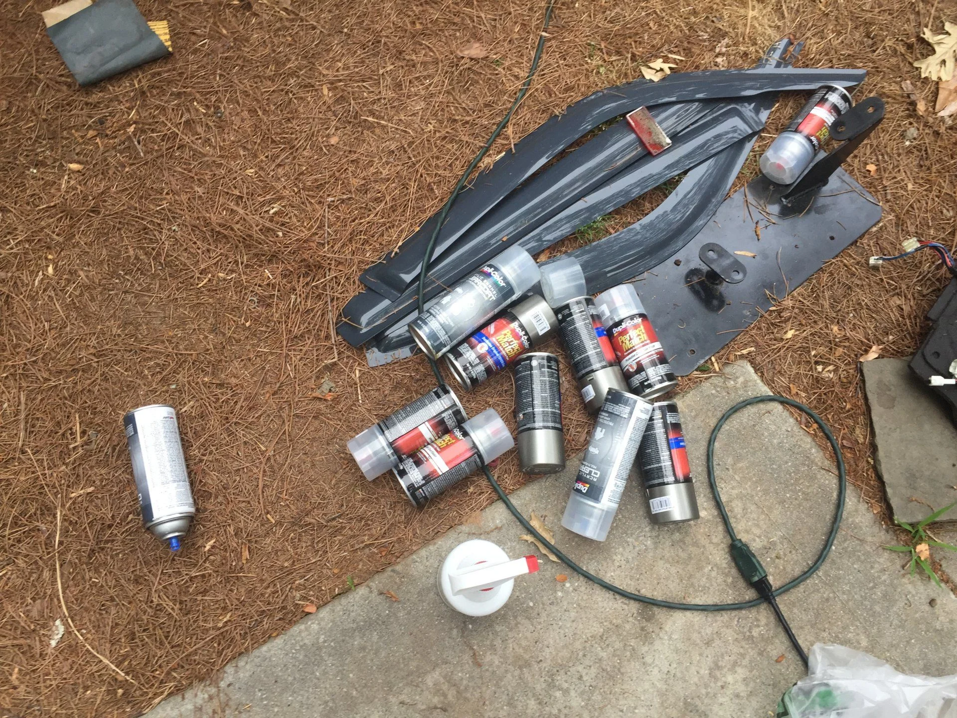

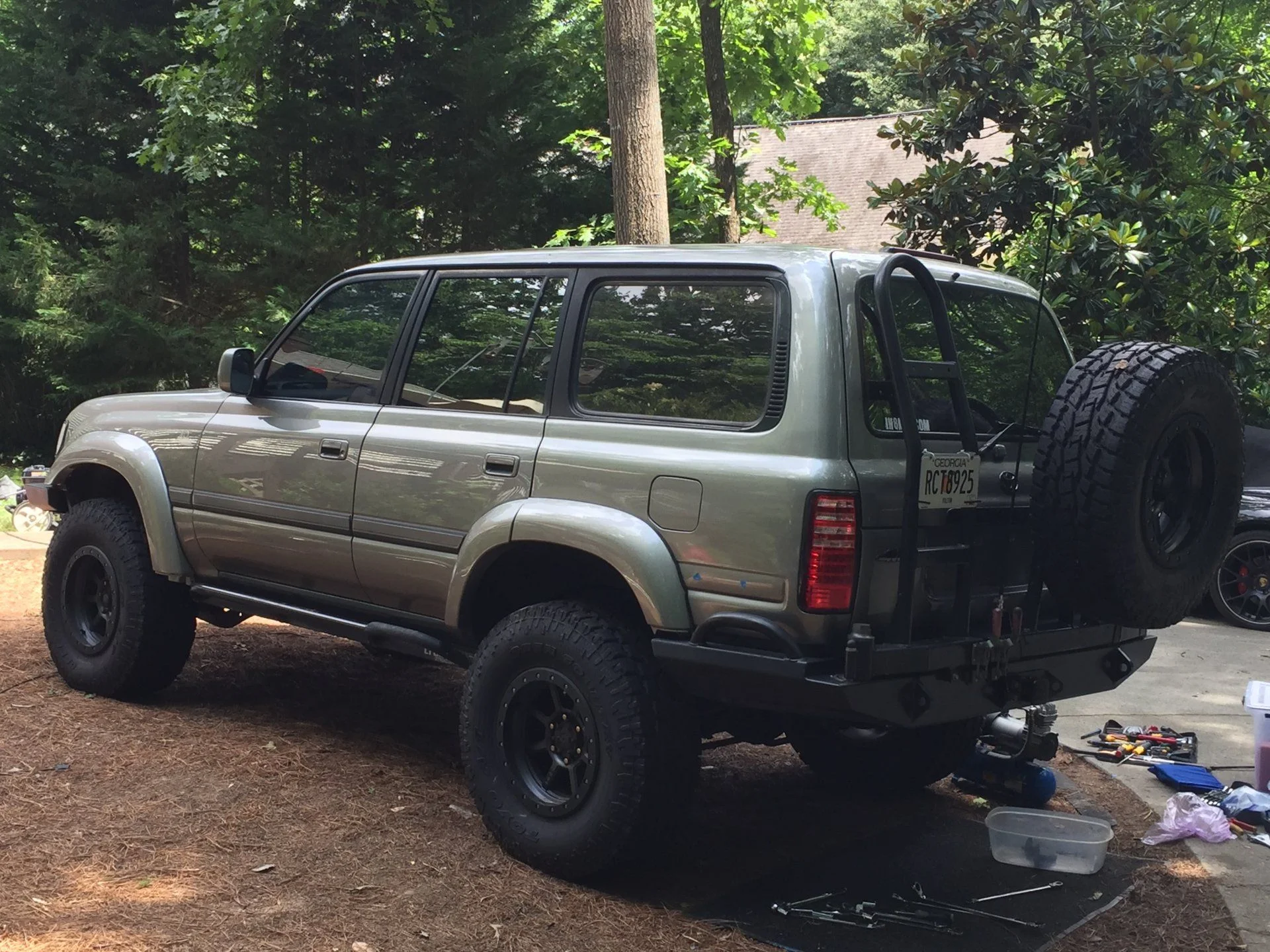

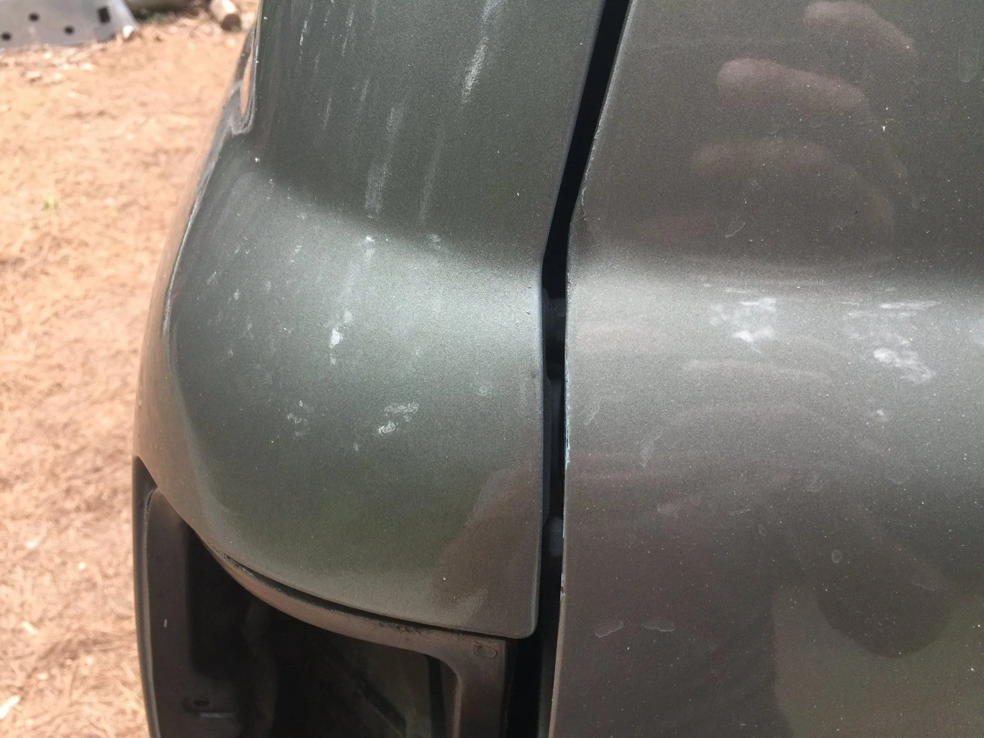

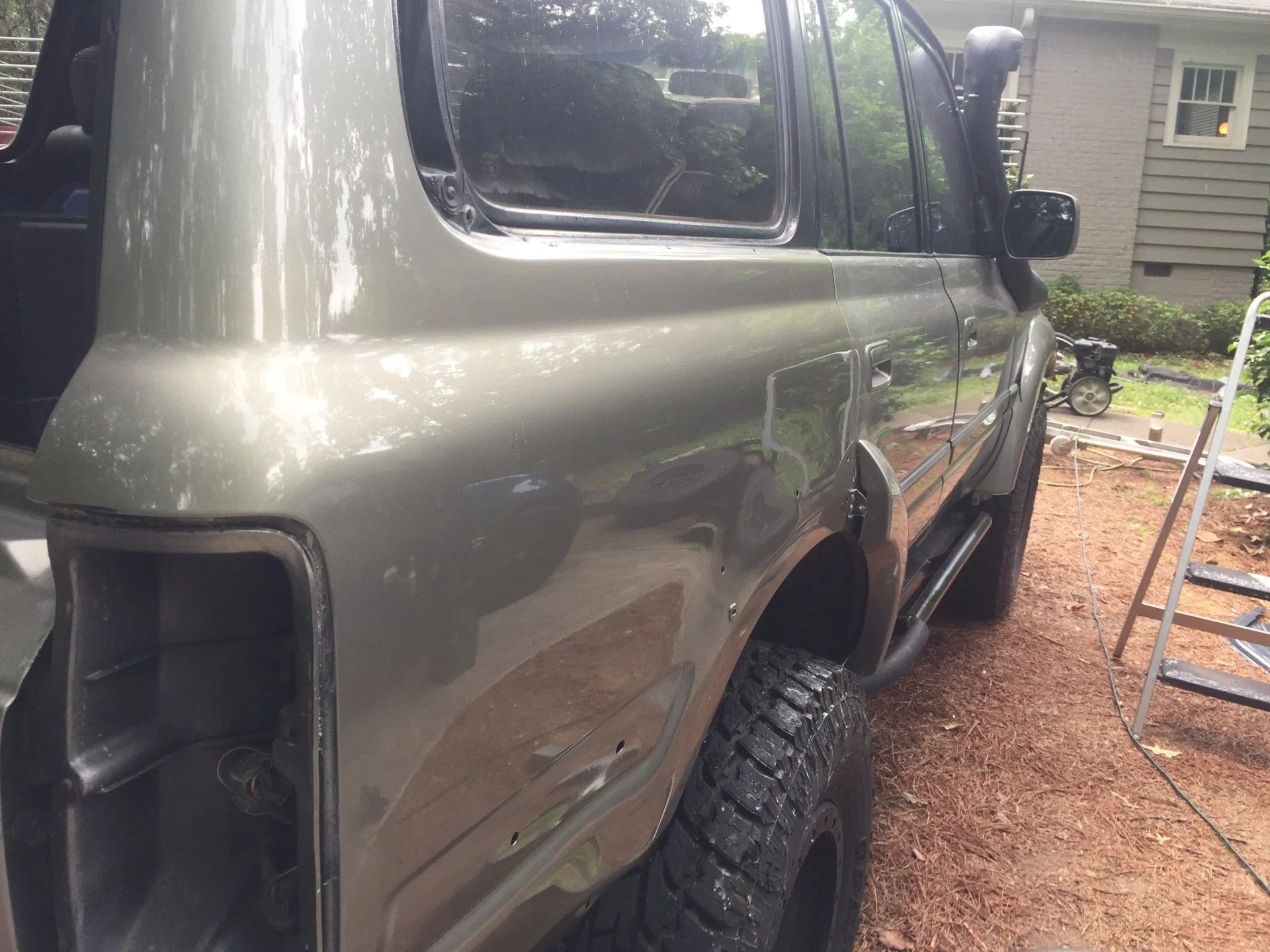

Despite the birds, the bugs, the dust, the trees, the occasional cloud burst and my general incompetence the painting portion is done. Going the rattle can route was oddly satisfying. The outcome is quite good. Im actually very pleased with it. Had I paid 5 grand for a paint job with this outcome, I would have of course s*** a brick but for $200 I really can't complain. The paint match is very very close. The only thing left to do is polish the crap out of the clear coat so the reflections all go in the same direction being that its a pearl metallic color. Ill wait 2 or three days for the clear coat to fully cure and I will have at it before reassembly.
Everybody likes photos of garbage :flipoff2:

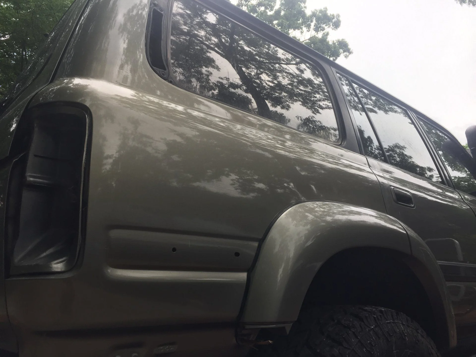

Closeup of old and new panel

Id say thats pretty darn close. So to anyone who wants to repaint their truck, I say go for it. Be diligent about sanding between coats and just keep spraying. I did 3 coats of primer, 4 coats of color and 4 coats of clear. I think thats thick enough. Now its time to add some Alabama pin striping :hillbilly:

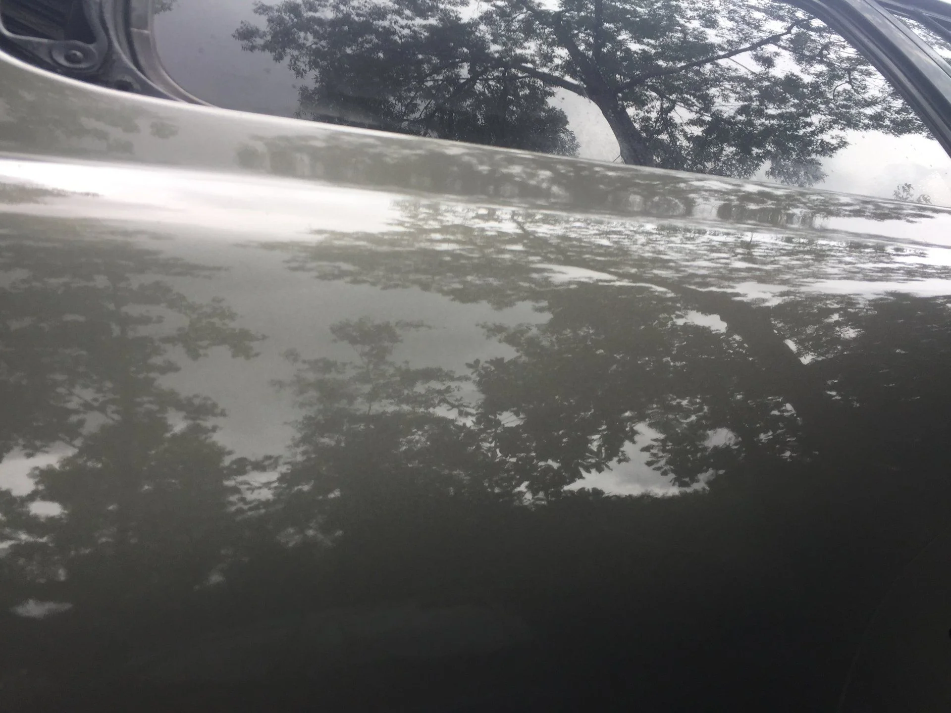

So the day has come where I finish with my Duplicolor Rattle Can Challenge. I bust out the 1000 grit then the 2000 grit followed by 4000 grit sanding. Then I start polishing AND GOD DAMMIT IT TURNED OUT GOOD!! The problem is that it turned out too good. I never thought that I would ever say that. It looks better than the neighboring original panels. So what do I do? Redo the rest of the truck? Or drink more beers and see if I can find my usual IDGAF hat to put on.
Either way. Today I will toot my own horn so Fu***NG loud that people will get annoyed. I do realize its a mortal sin but Im gonna keep on tootin!!!
IM THE RATTLE CAN KING OF THE WORLD!!! :flipoff2: Suck it Krylon!!

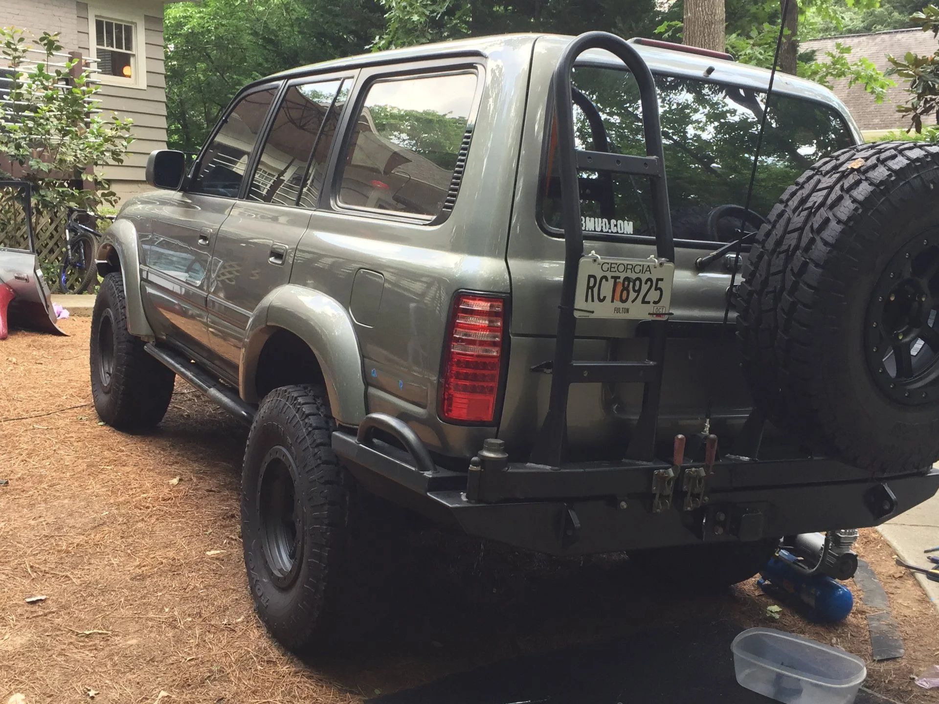

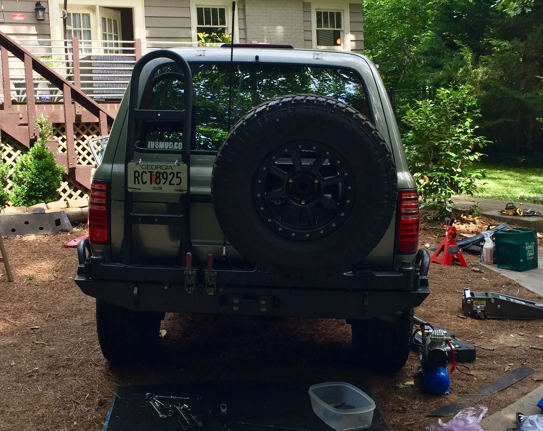

Do you ever have those days where you have a part that you want to bolt on but some parts require two people? Well, I had such a day today. My arms are too puny to mount the Slee bumper by myself. I have better things to do like mounting a bumper than going to the gym so I got creative. First I took all safety precautions. Got my best work boots, laid down in the dirt while dragging the bumper on top of me before doing the lift. I am pleased to report no injuries except a few scrapes and bruises. The bumper is back on :hillbilly:

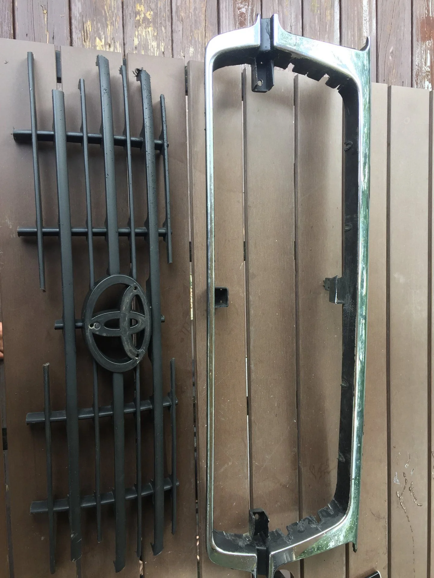

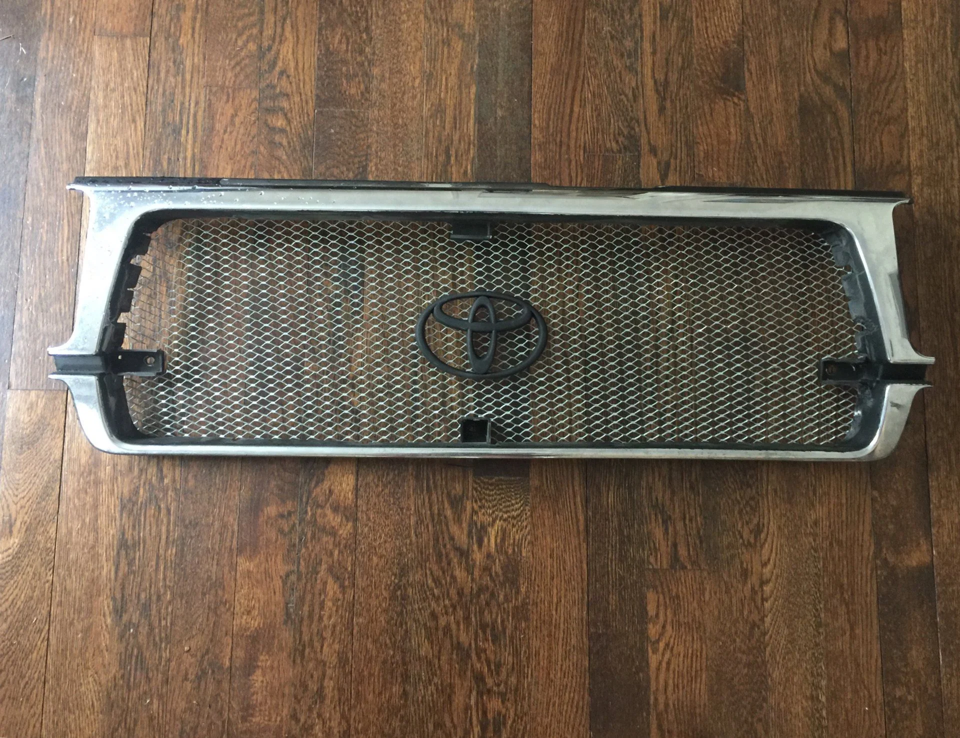

So I saw this ugly ass cruiser all smelly and crappy and gave it a home. I fed her gave her a makeover and now she's beautiful. Now the damn thing wants more :crybaby: She wants a facelift again. So here it starts. This is such a pain in the ass process but I learned a lot from doing the Satoshi grill mod the last time around.
First the cuts:
full
Well, so thats where I am now. Next is fiberglassing the holes followed by bondo then primer etc etc.

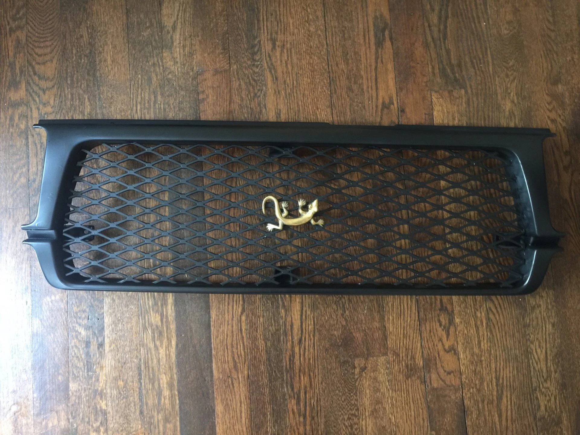

Decided to make the grill a bit more substantial. I did not like the soft mesh and I especially did not like seeing the tabs. I remembered not so fondly one day in the hills in PA in a 1972 Bronco when a branch pierced the radiator. So off to the Metal Supermarket I went and found something that was sharp, difficult to work with and stout. Ofcourse the regular cutting implements were entirely ineffective so out came the grinder. A bit of fiberglass and bondo later it was ready for primer and paint.
Here is the almost finished result.

I like this one much better. Definitely looks tougher and matches the style of the LC better than your previous version.
Is that one of those rubber fishing lures in the center?
