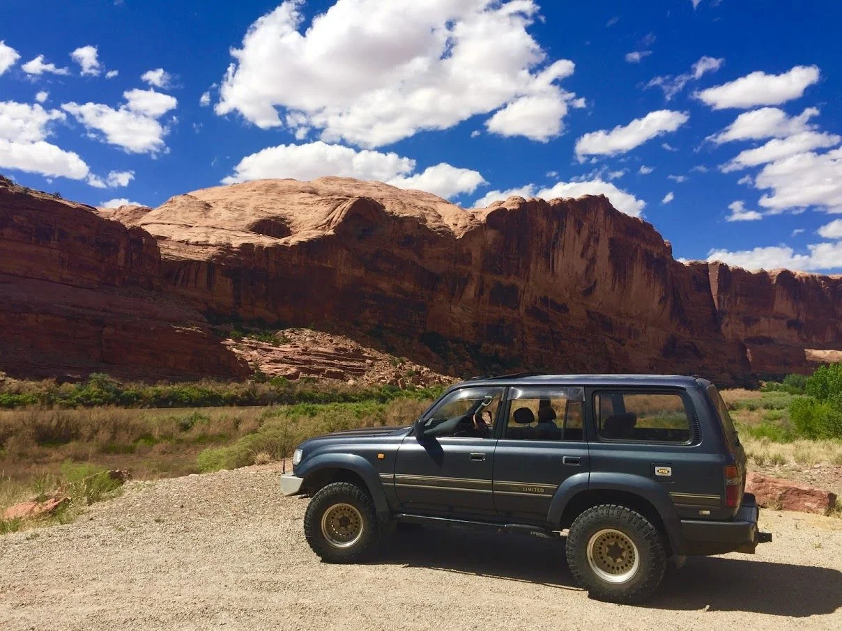

This was the first time I laid my eyes on the cruiser:
full
Ugly as hell. Pin striping all over. The interior was abysmal. No carpet, a slight funk. Faded paint. Peeling clear coat. I fell in love with this damn thing. Mechanically this cruiser was fantastic. Cosmetically it was a total piece of s***.

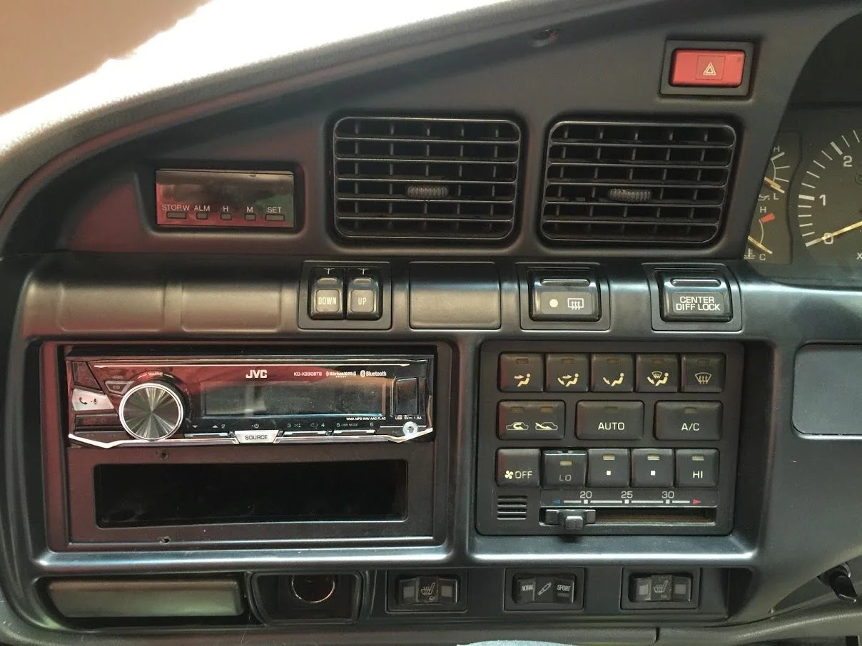

I can live without AC. I can live with whatever that smell was. I can live with Ugly. But I can not drive that many miles without tunes. I use spotify and needed a deck that I can pair with my phone for music and talking. a quick google search yielded several stereo shops in Vancouver. So day one - rip out the dash and install stereo:
full
I got a cheap JVC unit that would pair with the phone. I knew that I will be switching it out with a double din unit in the future. So now that I have tunes and communications sorted, I could make my way back to the South. I will post links to those in the table of contents.

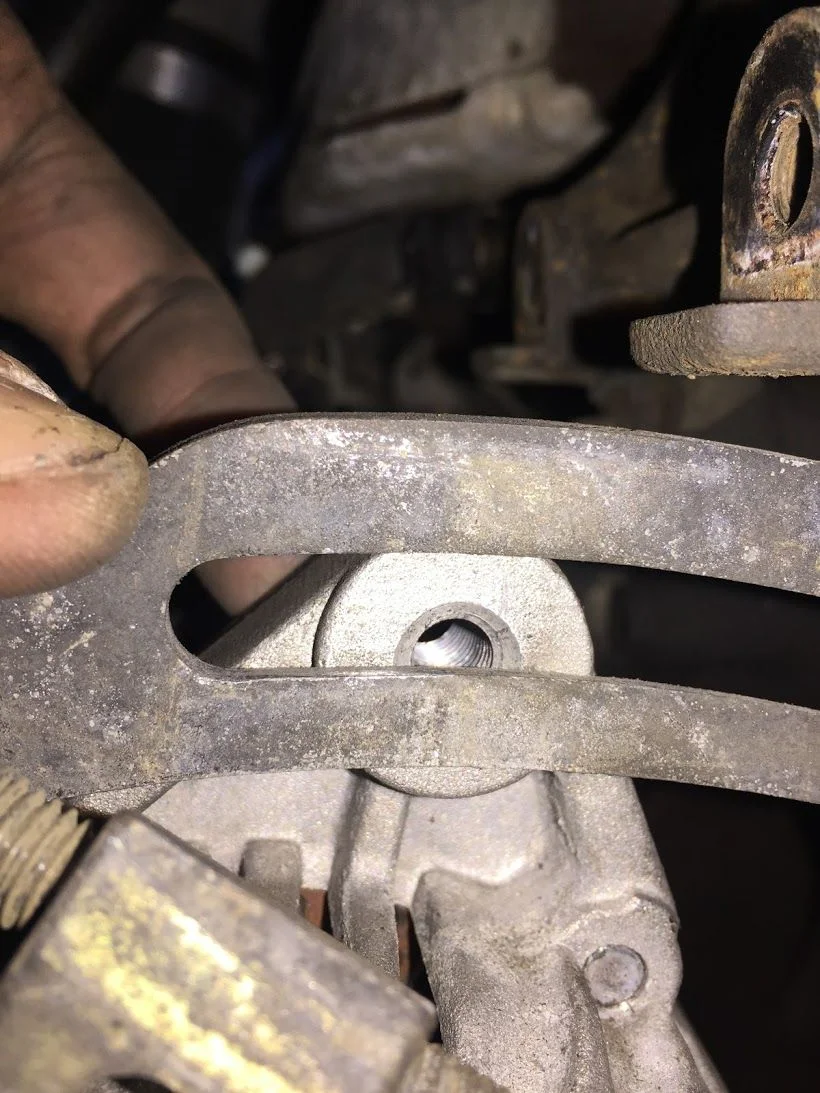

Everyone that has known me has at one point or another accused me of being a dumbass. Why? Because I do dumbassed things like wash the engine compartment. The cruiser had a double battery for the 24v starter so at the time I did not even know that I had killed my alternator. My dash lit up like a Christmas tree. Of course I did not know what that meant at the time. Then one day I was at the supermarket and was ready to go home and I turned the key and all i got was "click" Dead battery. It took quite a while from when I washed it to the batteries getting drained. Got a jump and drove home and diagnose the problem via ih8mud. Confirmed, alternator is screwed.
The good Canadians on this site informed me that I can use the alternator from a Toyota Tercel. Off to eBay I went where I spotted a 140amp high output alternator. So I got it. It sat side by side with my old alternator and looked the same so I switched the pulleys and proceeded to install it. Then came this:
full
Mother******!! Time for some modification. An hour later everything functioned again and all is good in the world once again.

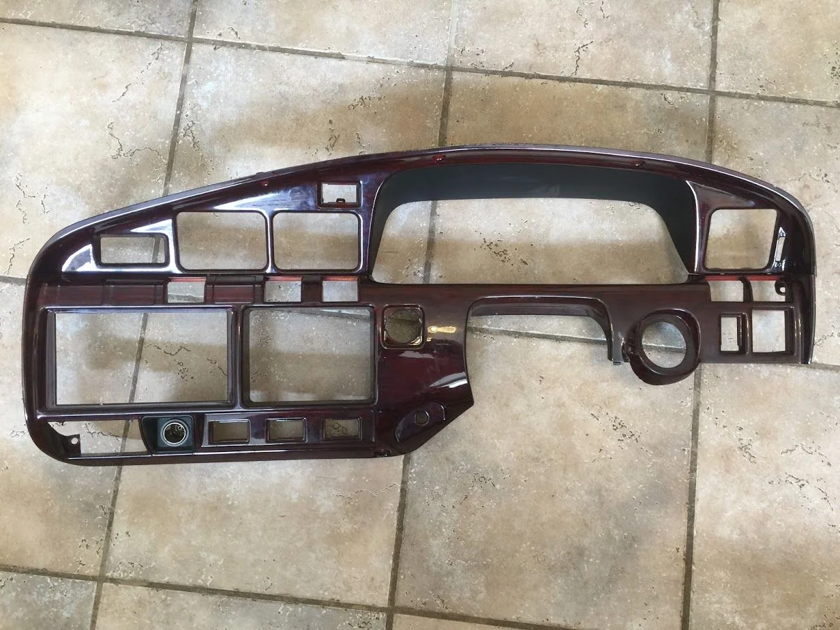

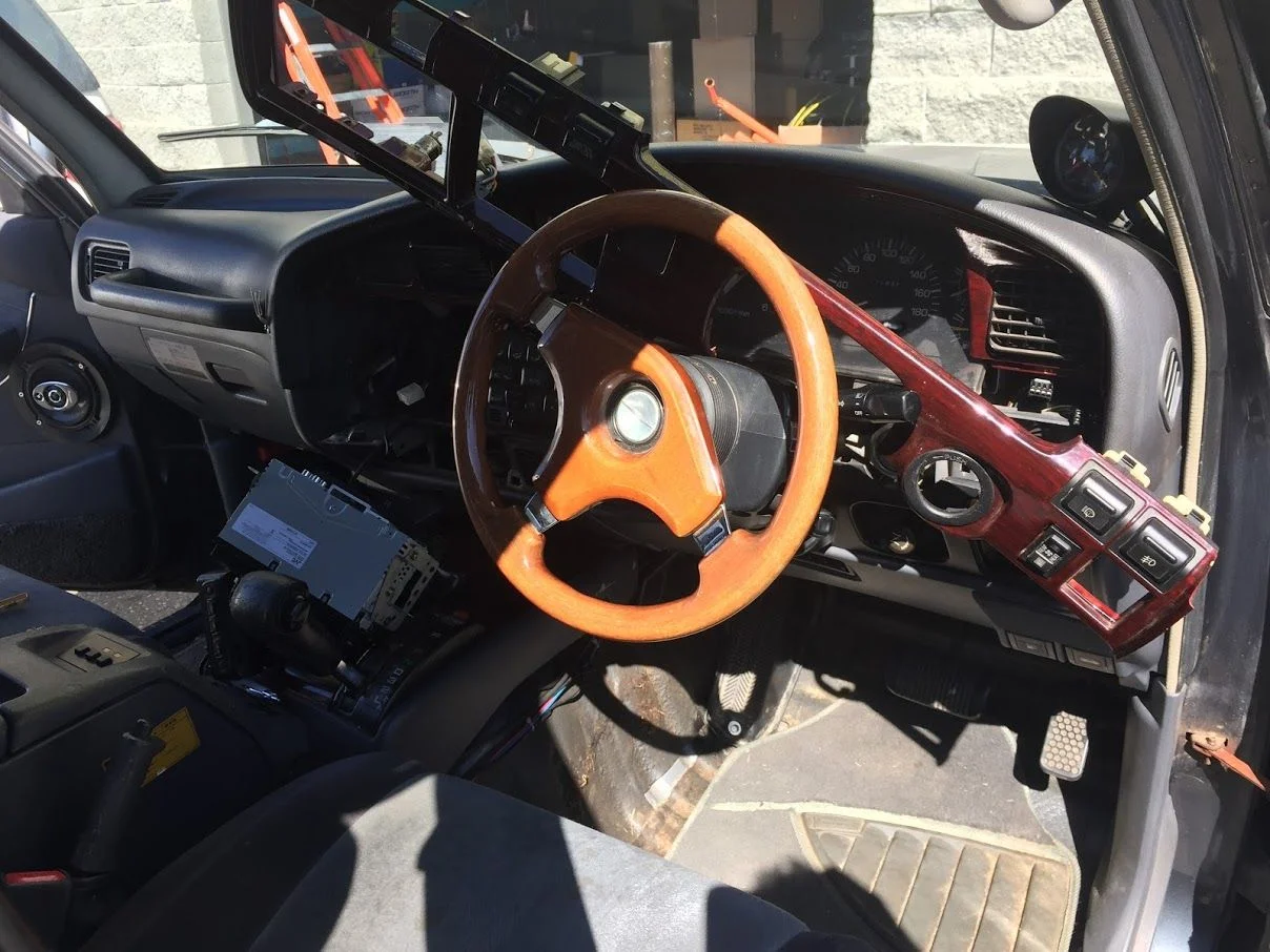

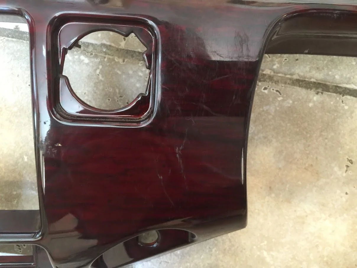

2 previous owners ago, the dude decided that the black dash in the toyota was simply too nice looking and proceeded to paint it red followed by a dooky brown. While the brown was still wet this artsy fartsy mother****** decided to use a brush to simulate wood grain. then he slathered the whole thing in polyurethane and called it quits. The poly was so thick that none of the switches and inserts would fit properly. I wanted it all to go back to black. A s*** ton of sanding priming and spraying later, I was back to what Mr. Toyoda had intended.
full
full
Back to black and everything fits and functions like its supposed to except for that damn "Lo"button because broken tab :devil::

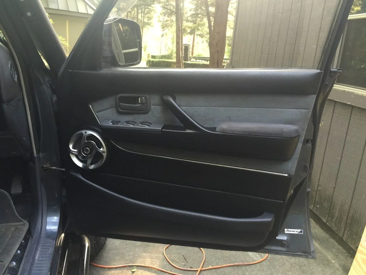

So there I was with a fully functional cruiser. Ugly as hell but fully functional. This cruiser was called the Land Cruiser VX Limited Bed Cruiser edition. Im like WTF is a bed Cruiser?? Shag carpeting is what. Most of you guys have a bit of carpeting on the bottom of the door cards. I had full blown shag carpeting. Filthy sticky 25 year old shag carpets. The interior of the cruiser was this blue just like an early 90s Chrysler Town & Country minivan. A remnant of the 80s deplorable aesthetics. That was the next thing I needed to change. I started experimenting with the door cards. This is the first iteration:
full
Looks good but I wanted better speakers in the future and the stock location just did not have the depth to put anything decent in there. But this will do for now. So now I am that guy with the butt ugly cruiser with mismatched door cards, peeling paint and an eyesore of a silver bumper that would blind oncoming traffic in the sun.

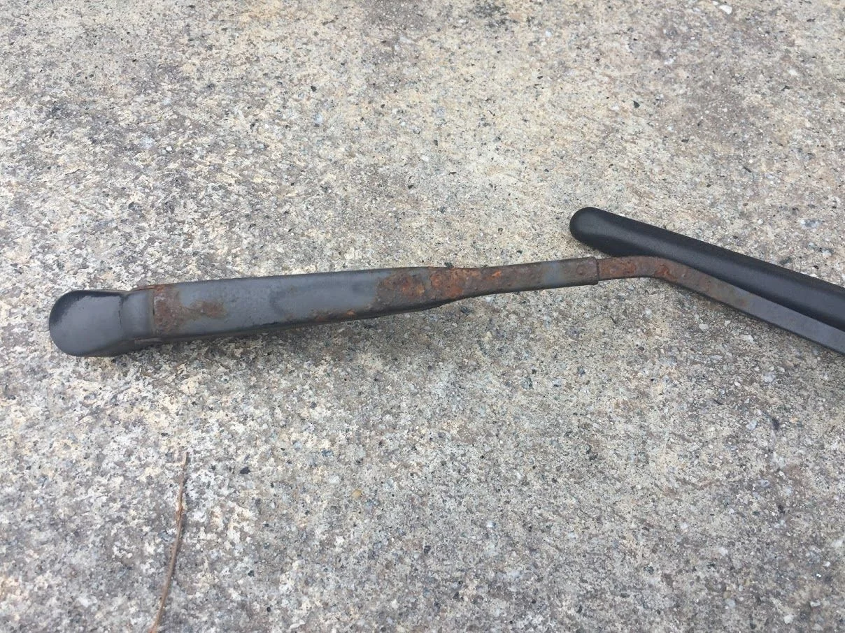

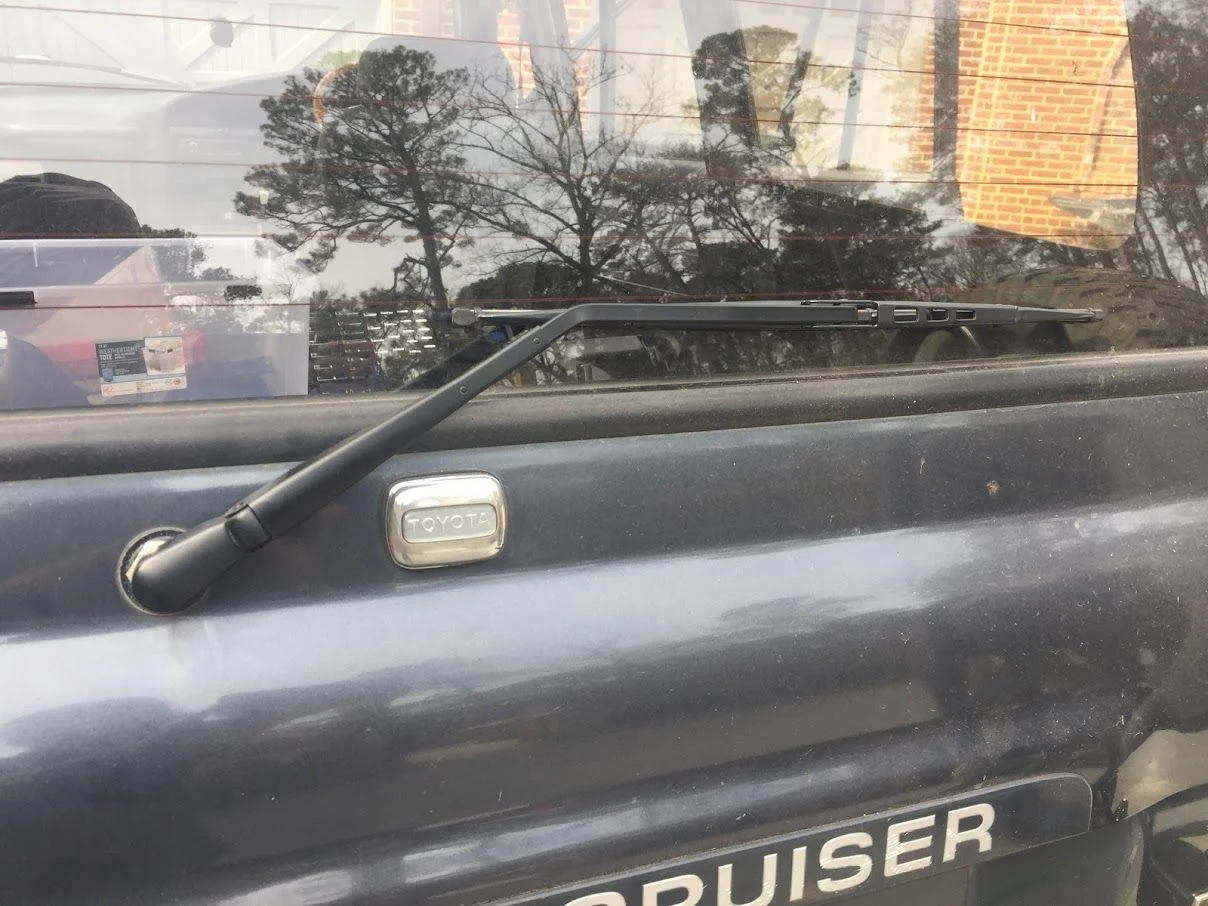

Then a whole bunch of stuff happened with leaks through the windshield and sunroof etc etc and fast forward to the fixing of some rust spots like my wipers:
I went out and got new wipers and came home to put them on and of course I get nailed with RHD syndrome yet again. I need the mirror image of the wipers I got. So now Im back to sanding etc and spraying etc.
Before:
full
After:
full

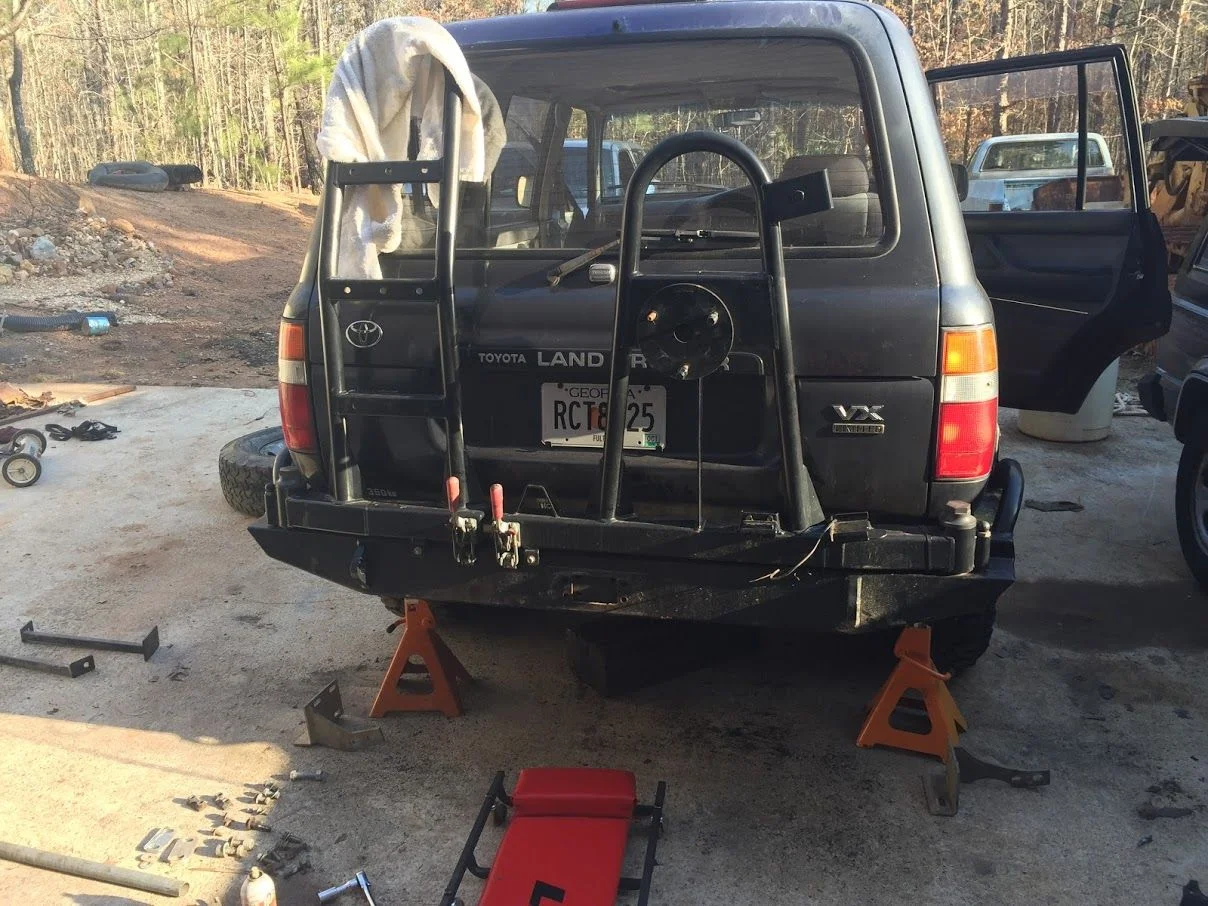

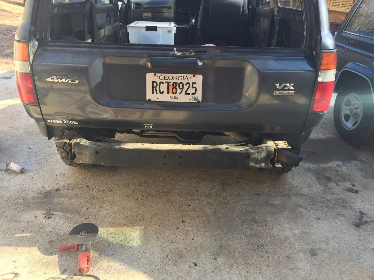

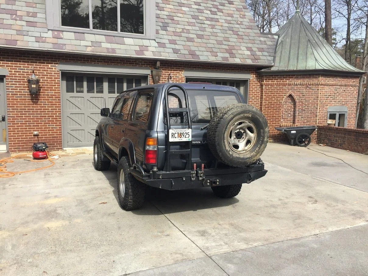

This is where I will piss off a bunch of people here. There was this ad on craigslist on Sale dual swing out bumpers for $500. I responded so damn quick telling them I had cash in hand and waited. I thought it must be a scam as did everyone else that posted the ad on here. Guess what? It was not. Thats right bitches. I snagged me a Slee bumper for $500 :flipoff2::flipoff2::flipoff2:
Cut out the hole for the hitch receiver:
full
And new to me bumper:
full
Then took off the tire crap winch thingamajig from underneath the rig and voila!!
full

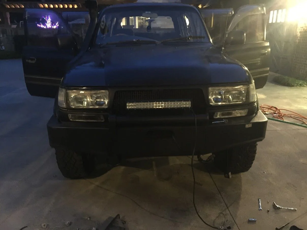

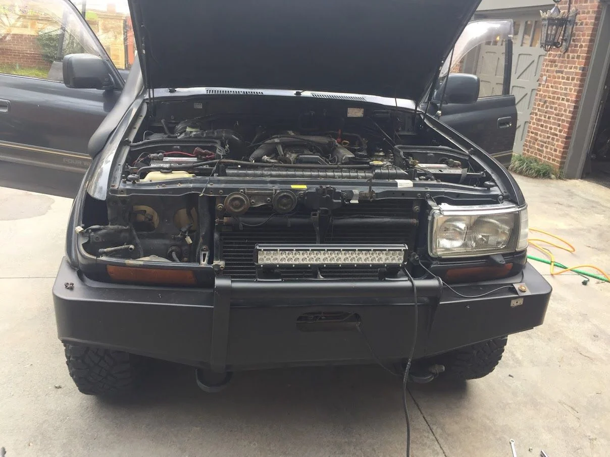

Now the cruiser has a real nice ass! But the face was still busted so it was time for a bit of surgery. First was to change the color of the bumper to black:
full
Then it was time to tackle the lights and blinkers. I saw this Satoshi mod. Loved it. Went ahead and did it. I don't need to give a step by step cause there are plenty of threads on that already. Yes I am aware its an underexposed pic but its the only one I got:
full
Oh and I temporarily plastidipped the peeling hood.

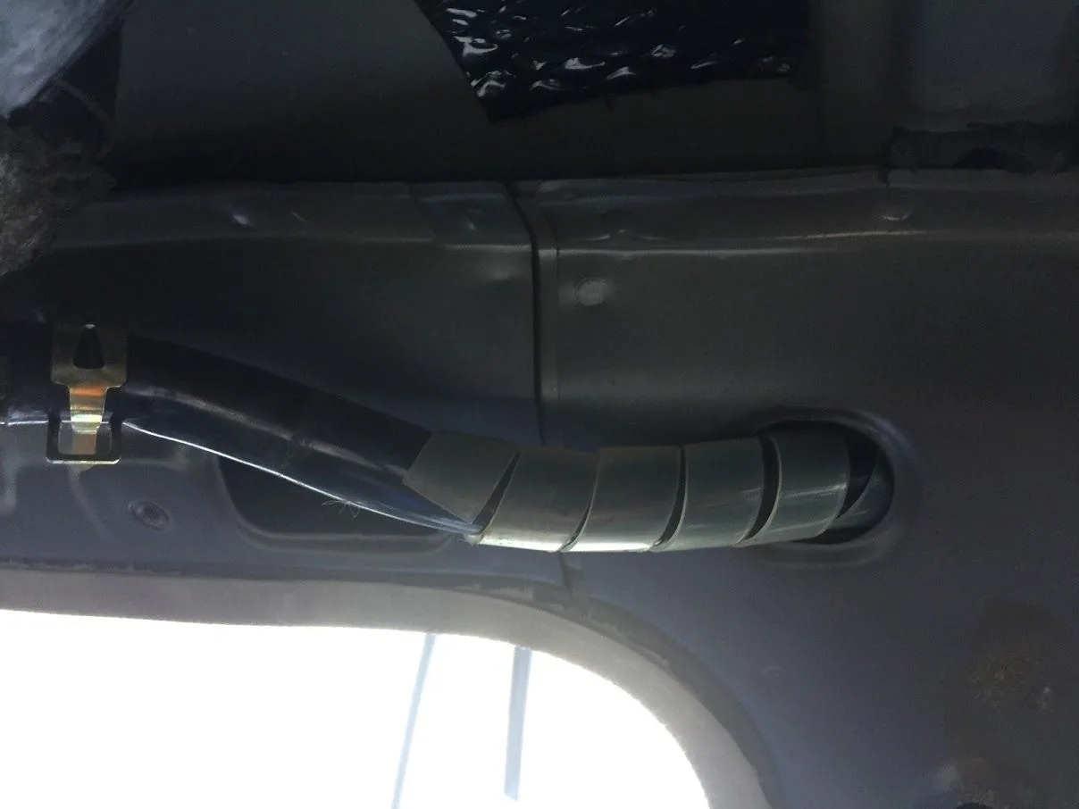

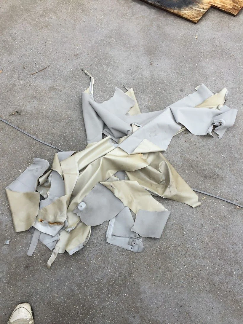

Then there was this episode with my headliner:
full

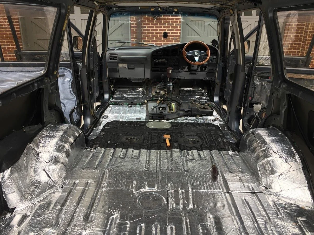

The reason for that is that I really need to get to my sunroof to fix the damn leaks. I really wanted to put in new carpeting because the damn car was loud and there was a ton of heat transfer from the front and transmission.
With the drain hoses replaced and stabilized it was time for interior beautification.
full

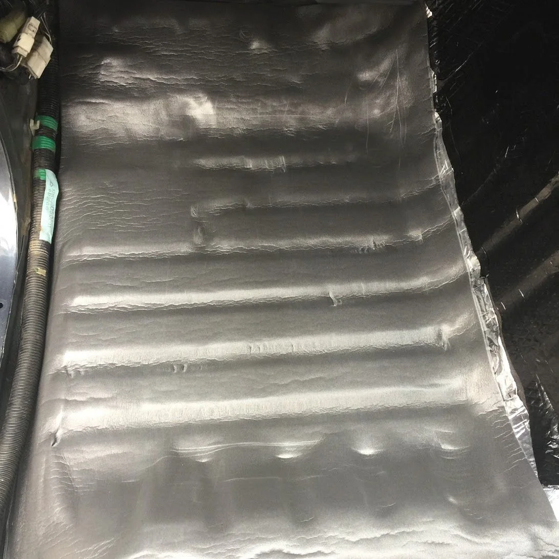

The insulation and dampening phase:
full
Thermo decoupler to keep the heat out:
full

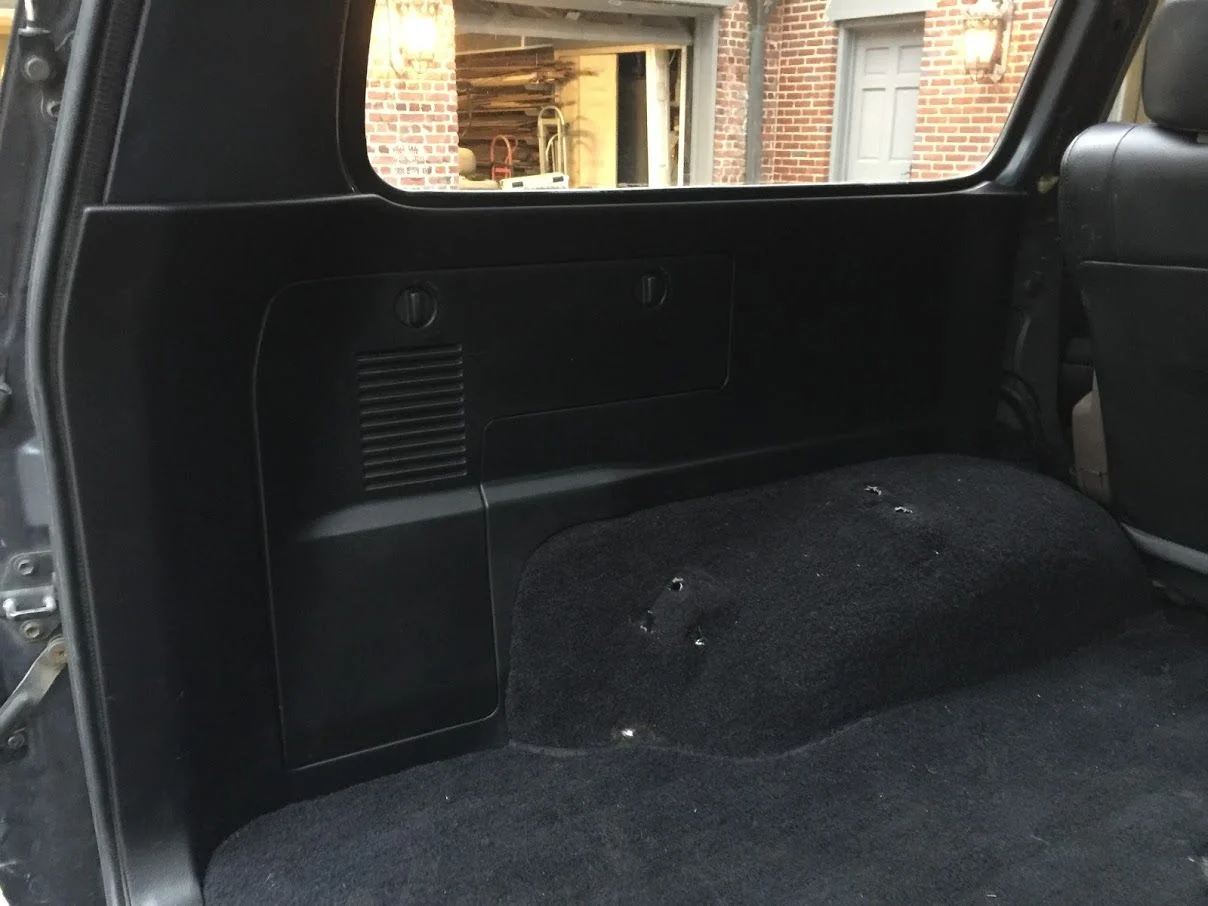

And then there was carpeting and recoloring of panels. Everything black.
full

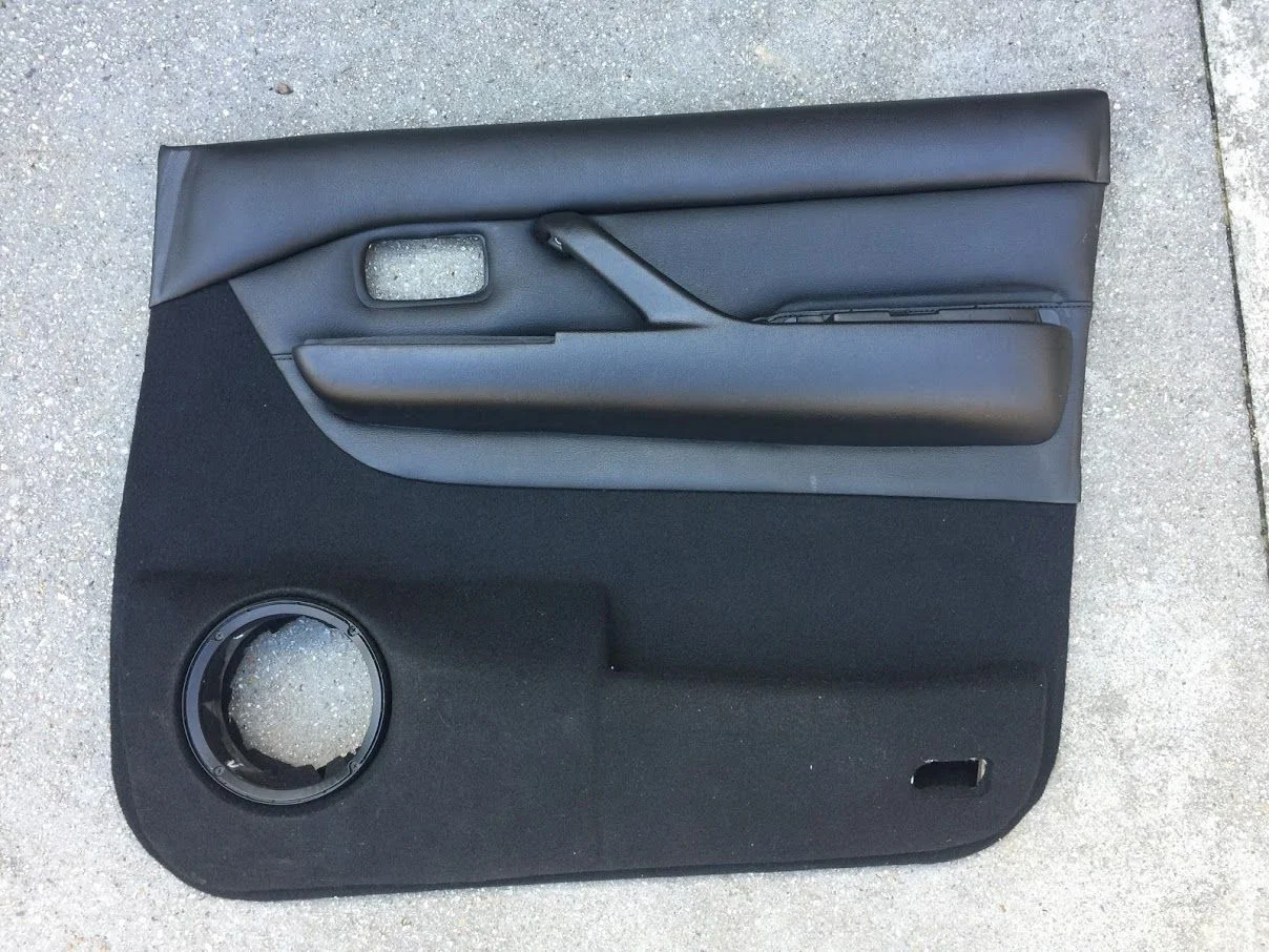

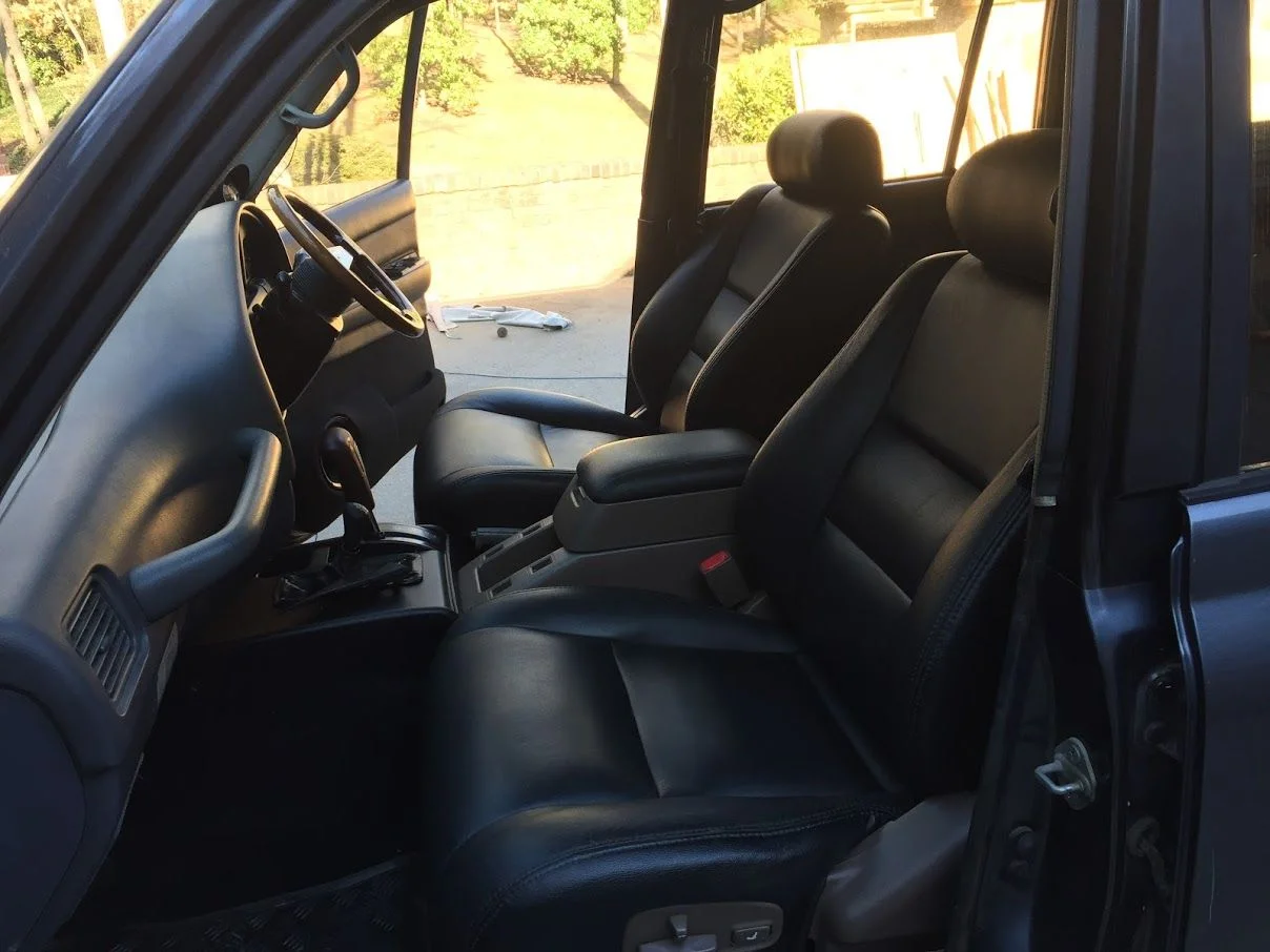

And now it was time to add a few luxuries. I removed the old manual seats and got seats from an FJ80. Reupholstred it black so I can feel the heat and burn my ass in the hot summer sun.
full
Also redid the door cards to match the seats and have space for proper speakers which I do not yet have.
full
full
full
