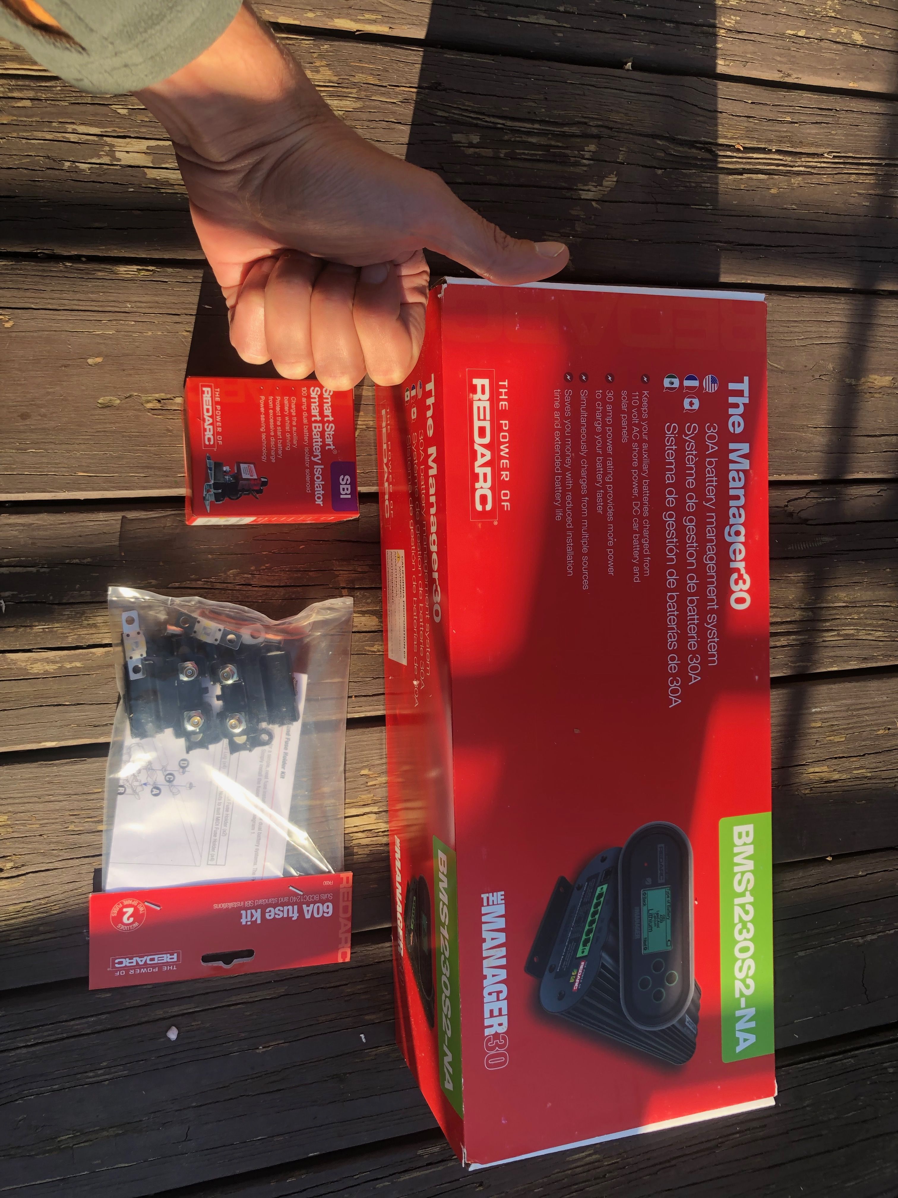

Today is a happy day. After bugging Craig from Redarc for 2 years straight I finally received a USA model Redarc manager 30. Its quite a remarkable piece of equipment that deserves its own writeup. UPS finally delivered a box:

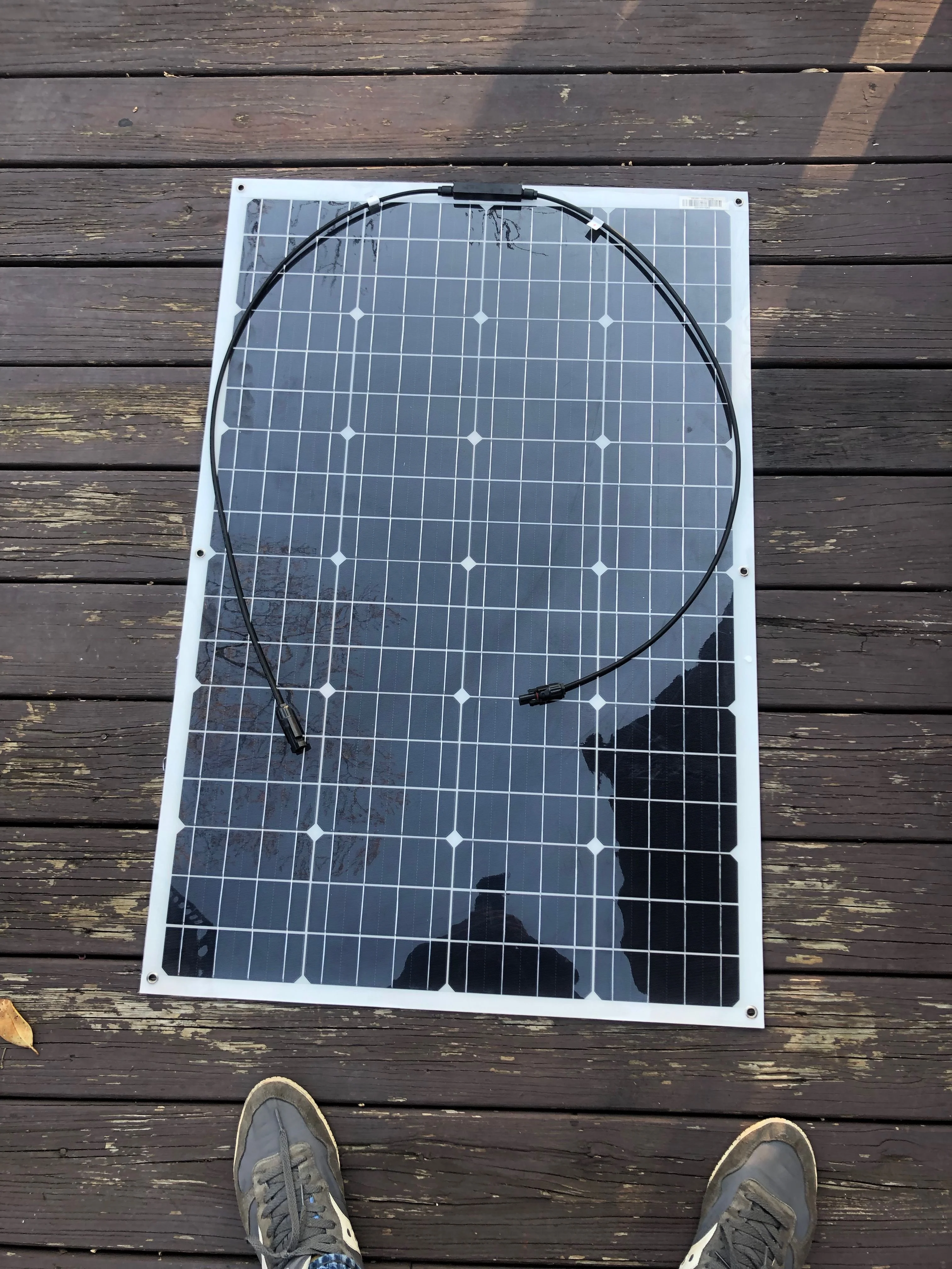

Finally I can mount the Solar panel to the RTT:

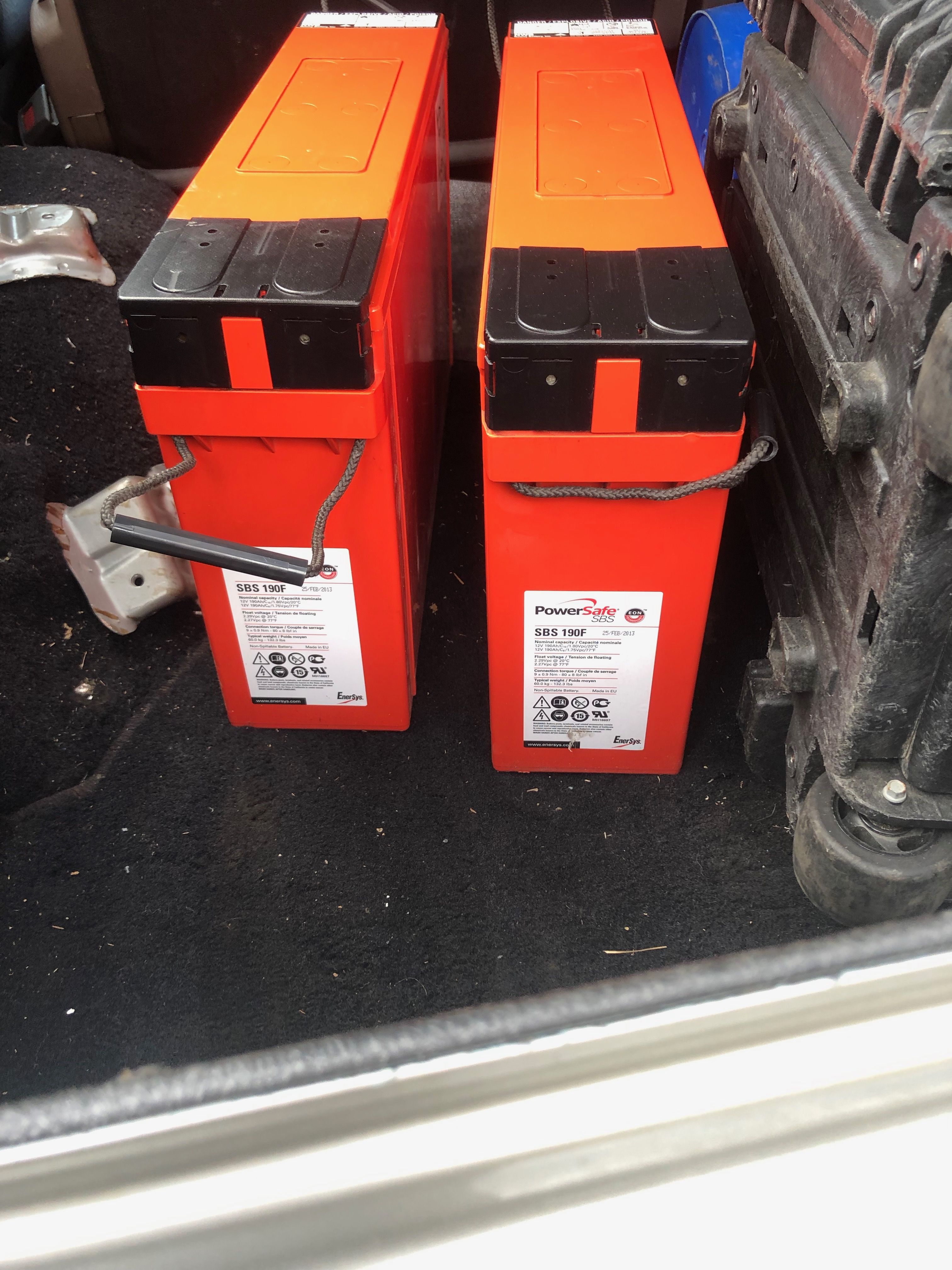

I have been thinking about the battery situation for a long time. For a while I had my mind set on LiFePo4 batteries but they only accept a charge between 32F and 113F. Outside of that range it will not charge. Being that I like to play in the dessert and in the snow it wound up not making much sense. The whole point of adding solar is for it to charge while parked. Plus the cost is very high on those things. Instead I went with these. I may have over done it just a tiny little bit:hillbilly: 190AH per unit. The form factor is great and takes almost no space. I wonder how much power is too much?
full
I finally got the combiners for the solar panels as well as various fuses etc and decided to ghetto rig the entire system on the deck just to see what goes where and what kind of wiring i will need. This is in preparation for mounting solutions within the vehicle which I will most likely start tomorrow.
At first the Manager 30 seems complicated but it surprisingly straightforward to hook up. To program it, you don't even need the manual. Just follow the prompts on screen. And after that, the thing just works and does its thing. Whats cool is that even if you are plugged in it will take all the juice produced by the solar panel and put it into the battery. They call it green energy priority.
The Manager 30 is a lot of things:
1. Its a DC to DC battery charger, meaning it charges the aux battery when your main battery is full
2. It houses an inverter so that you can plug in the vehicle to shore power and it converts the 110v to 12v just like an RV.
3. Its a battery isolator so it will not leave your stating battery to low to leave you stranded.
4. Has a built in high quality MPPT solar controller
5. It has an automatic load disconnect controller. I will add non critical loads to this.
6. Its a great Battery monitor and management system.
While the price is on the higher side for the item, when you look t the above combined, it becomes very affordable and way easier than buying all the separate components.
I for one, can't wait to get this thing in the vehicle for the next trip.
