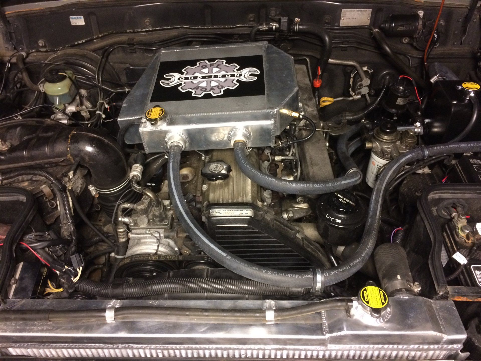

So I am a happy man today because I can go back to being an a$$hole on the streets again. The cruiser was a slow vehicle. It had issues keeping up with vehicles that speed up in front it. You know the feeling. But no more. The little cruiser got a few upgrades as well as a psi bump. The turbo whines and whines and whines. Its the only kind of whining I encourage. Any other whining gets slapped. Then there is the WOOOOOOSH! That ever so glorious sound of air being sucked into the engine. Oh and I no longer need to stare at the EGT gauge. I hate that fun killer of a gauge.

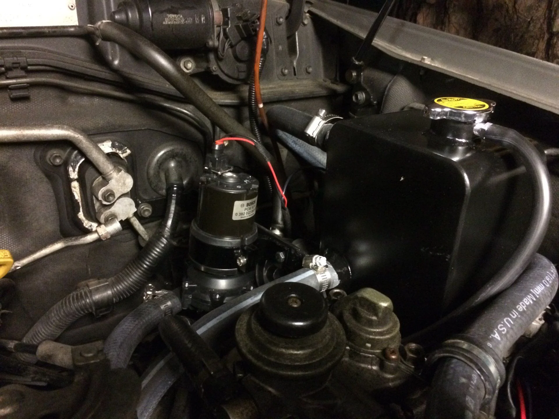

Rob at Odd Iron Offroad has a good mantra. He says every diesel needs a turbo and every turbo needs an intercooler. He fabled up a nice piece of kit including an external reservoir for additional coolant capacity. All aluminum, beautiful fab work. He also added a new custom aluminum radiator as well as a trans cooler.
I finally know what it feels like to go 90 on the interstate in the cruiser and have plenty of juice left under my foot for being an a$$. It feels like a whole new vehicle. Before when I approached long hills, one eye would be glued to the egt gauge and eventually I would have to let off the throttle and be relegated to the right lane. Thats all history. Even driving like a complete douchy a$$ the temps never went above 900 farenheit. I am completely and totally satisfied. Rob is a true master at what he does!!!!! If you have a diesel Toyota and you are anywhere in the Southeast, definitely give Odd Iron Offroad a call. You will not regret it.

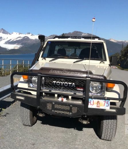

Another one of Odd Iron's designs. The Intercooler is in the ARB brushbar. (where the winch would normally be located)

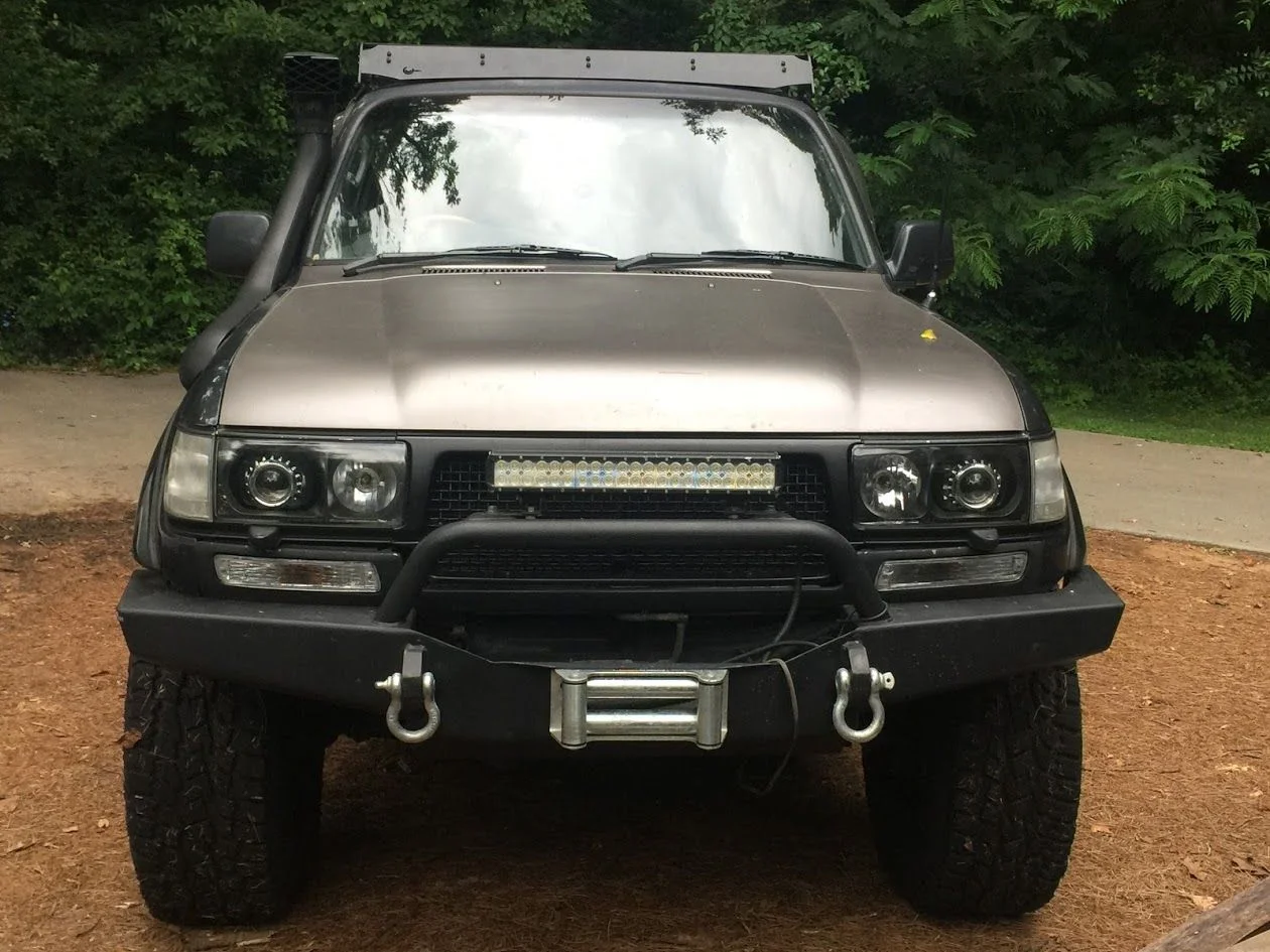

what lights did you buy to do the conversion, and did you reuse the oem housing and just replace the front cover to plastic?
Those are Depo Lights with the clear glass lens. The outside "reflectors were converted to a projector HID system by the retrofit source. I used a E46 shroud for the projectors. Because this is a JDM model the inner reflectors are fog lights. I converted those to massively bright FU*K You lights especially for people driving with their high beams on. I basically put in the brightest set of LEDs that the retrofit source had available.
The conversion was a pain in the ass involving baking in oven, grinding and epoxy but it has been very very worth it. I had a lot of difficulty driving at night in the rain with the old lights. Now I have no more issues. I love the fact that the projectors can be aimed perfectly.
Just make sure you get the one for the correct model year. The lights are shaped differently for the early models and changed in 95.
I'm pretty sure only the LX450's had slightly different shaped headlights, all 80 series Toyota's should use the same headlights.
