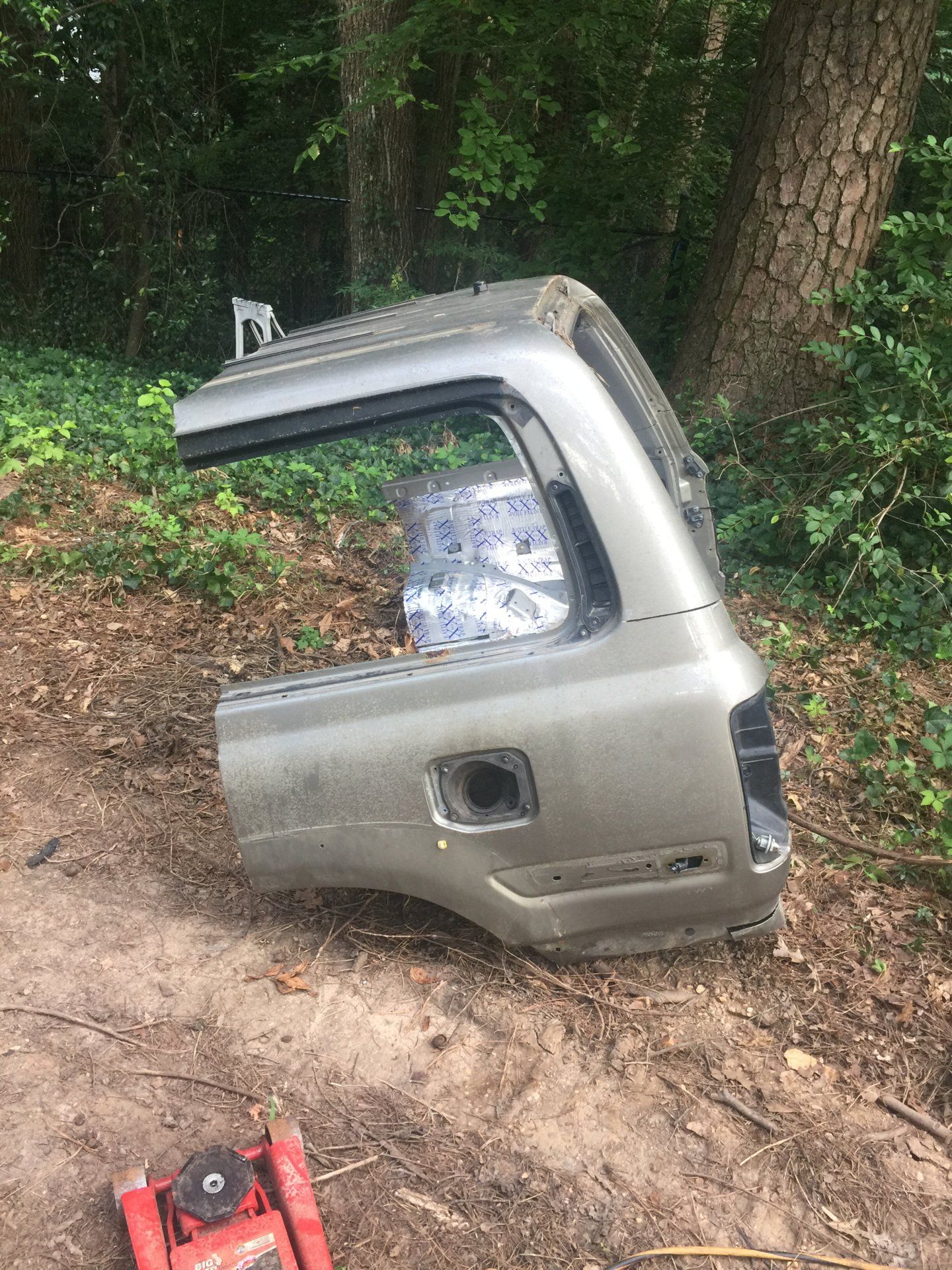

Remember when I talked about the disease that creeps up on us that turns our vehicles into never ending projects even though just last week you said it was done even though you are completely lying to yourself because you are addicted to tinkering and buying s*** for your cruiser - dammit - I should have just gone with strippers and heroin. At least that would have been somewhat manageable. Why? Because in the cruiser world; must upgrade and always tinker addiction I have just done the equivalent of an overdose but not quite the golden shot. Im still alive and for some strange reason my wife has not attempted to kill me yet or at least not that I know of. Maybe Im just a really tough bastard. Like Hercules tough, that even a wife can't kill. Or maybe she just does not approve of me being on hookers and heroin. I don't know. So what have I been up to you ask? Long story short. Here is a sneak peak. And for a little while you will get nothing else :flipoff2:
full
Well that escalated quickly!
That is all that is left? you shipped the rest off?
Wow, I've seen a couple chopped 80's. Can't wait to see more of your project.
