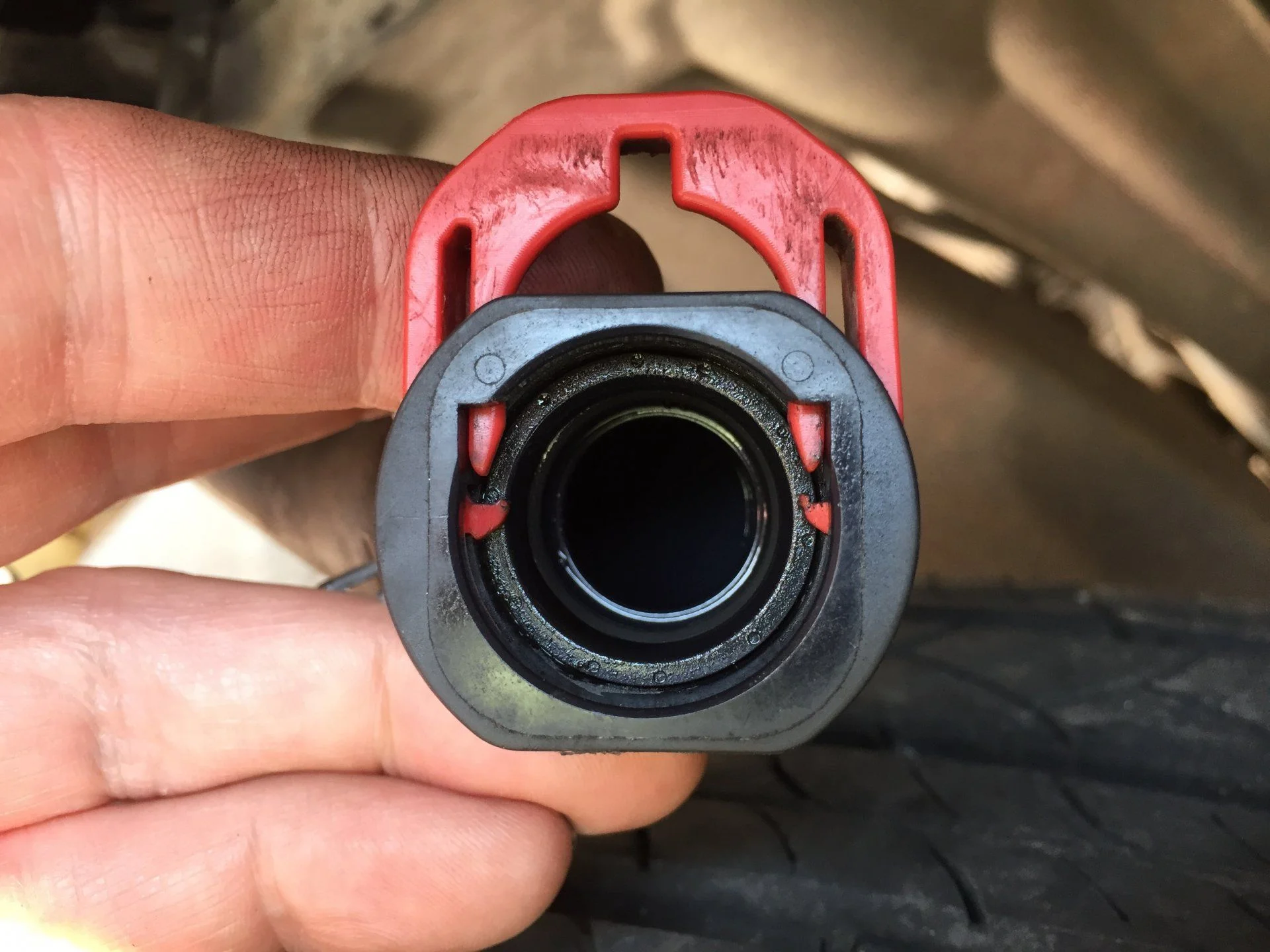

The job was pretty straight forward (I've done it before on my 100), but I did struggle trying to re-connect the fill hose to the reservoir.
For the benefit of others, here is how the red clip should look before re-installing the hose. Mine had slipped off and it took me a while to figure out how it was supposed to fit.
you disconnected the fill hose in order to drain the reservoir?
Where is the filter?
Yes, it was easier to insert my pump hose to vacuum out the old fluid and pump in the new.

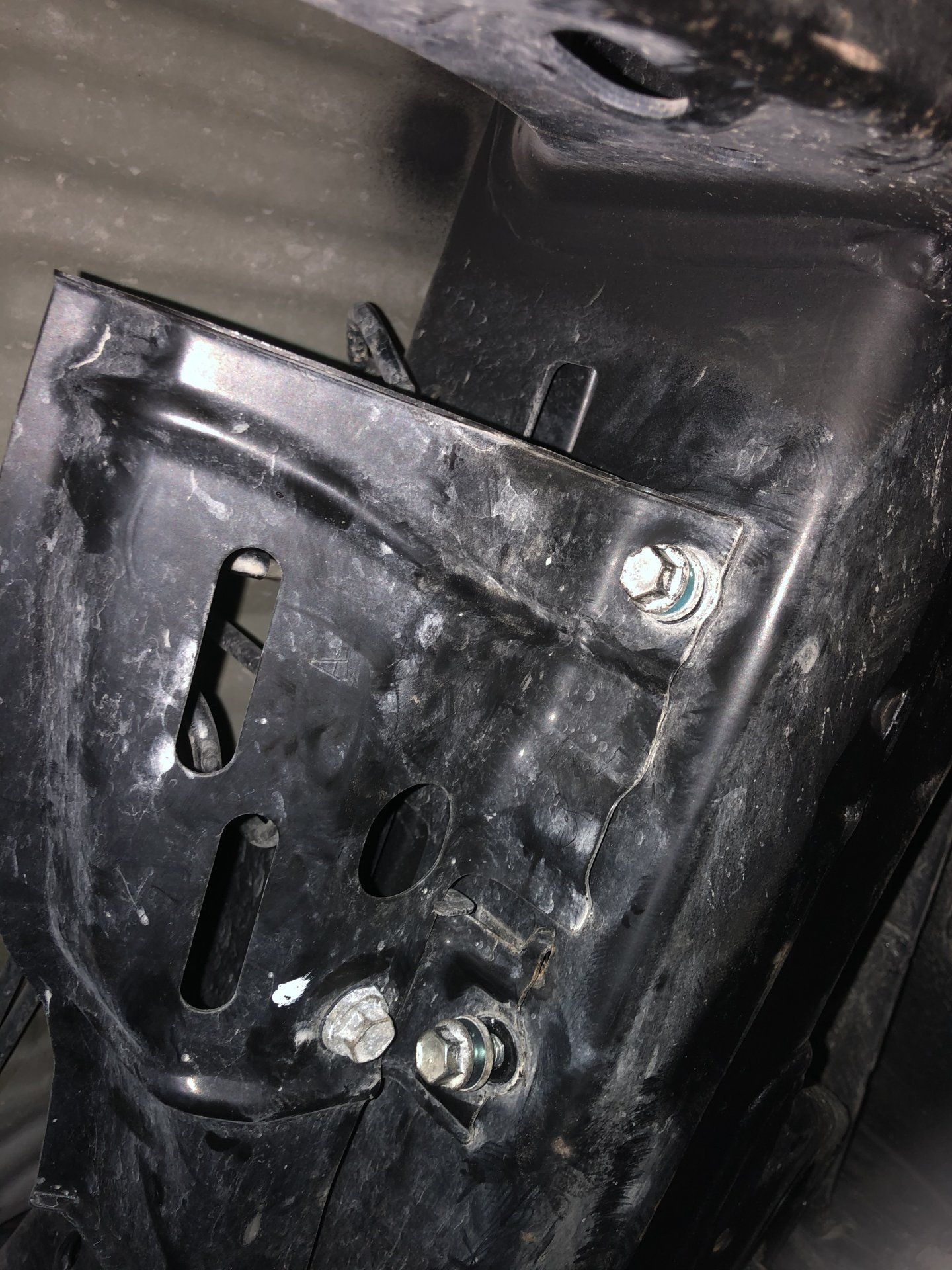

where is the 5th accumulator? It isn't under this plate .
anybody?
Not enough landmarks to get my bearing in your pics. It's on the driver's side, almost dead center.
Innner side of the frame. I think there's 3 10mm bolts homing it on.
Thanks. So I was looking at the wrong side. I was under the truck yesterday when I posted that pic of the pass. side plate. I was painting steel and greasing up the drive shafts getting it ready for some snow and salt and wanted to drain that 5th bleeder real quick.
Just finished bleeding the 5th accumulator. It's right next to the muffler under a metal plate. #12 wrench loosens the 3 bolts on the plate. A ratchet won't fit. I loosened the plate keeping the bolts in place, stuck a #10 wrench on the bleeder with a hose on it and moved the bleeder about 1/8th of a turn. That is about all there is room for. Took out about 1/2 qt. Pulled the pos. cable, added about 1/2 qt, Dropped the jack. Reattached battery. Hit the starter button to wake the car up. Hit it again waited for the pump to stop making a noise. Then Started it up. The system did it's thing. Looks like I gained 1/2" on the back and the front has moved up 1" more after finally bleeding the last accumulator. I'm hoping this will help the ride and handling a little bit better at high speed.
