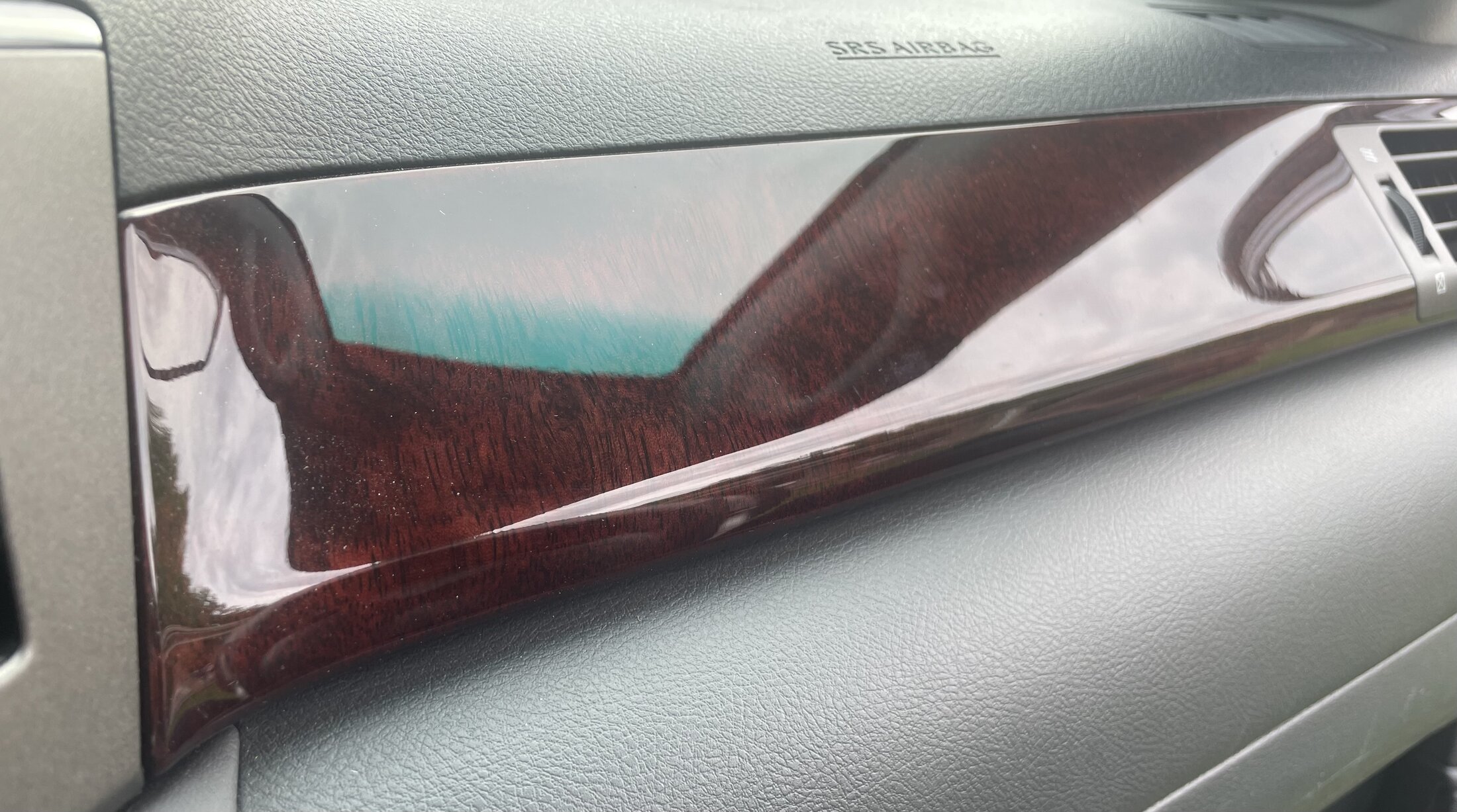

The passenger side wood laminate dash piece started cracking/peeling, so I ordered that from Carmarka. It was significantly cheaper from overseas. $370. Part number 55476-60060.
No before pic, but here is the new OEM piece from Carmarka installed:

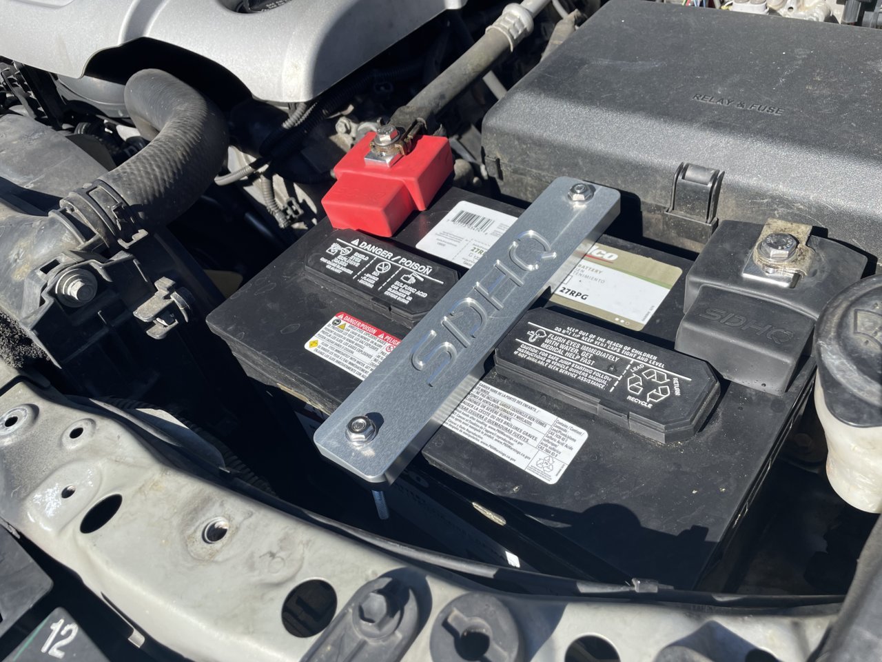

Installed the battery terminal kit from SDHQ…what are y’all using to cover the positive terminal? I don’t like how both of these are exposed. It’s odd to me the kit didn’t come with something that covers the positive terminal.
Those top pieces are left open to attach different electrical components to. I.E. lights, winch, switch panel wiring. We have found no issues or cause of concerns about those being open and allows for a cleaner install when adding different parts to the battery terminals. In some vehicles, the entire terminal is exposed and still no signs of any issues. Please let us know if you have any other questions!!

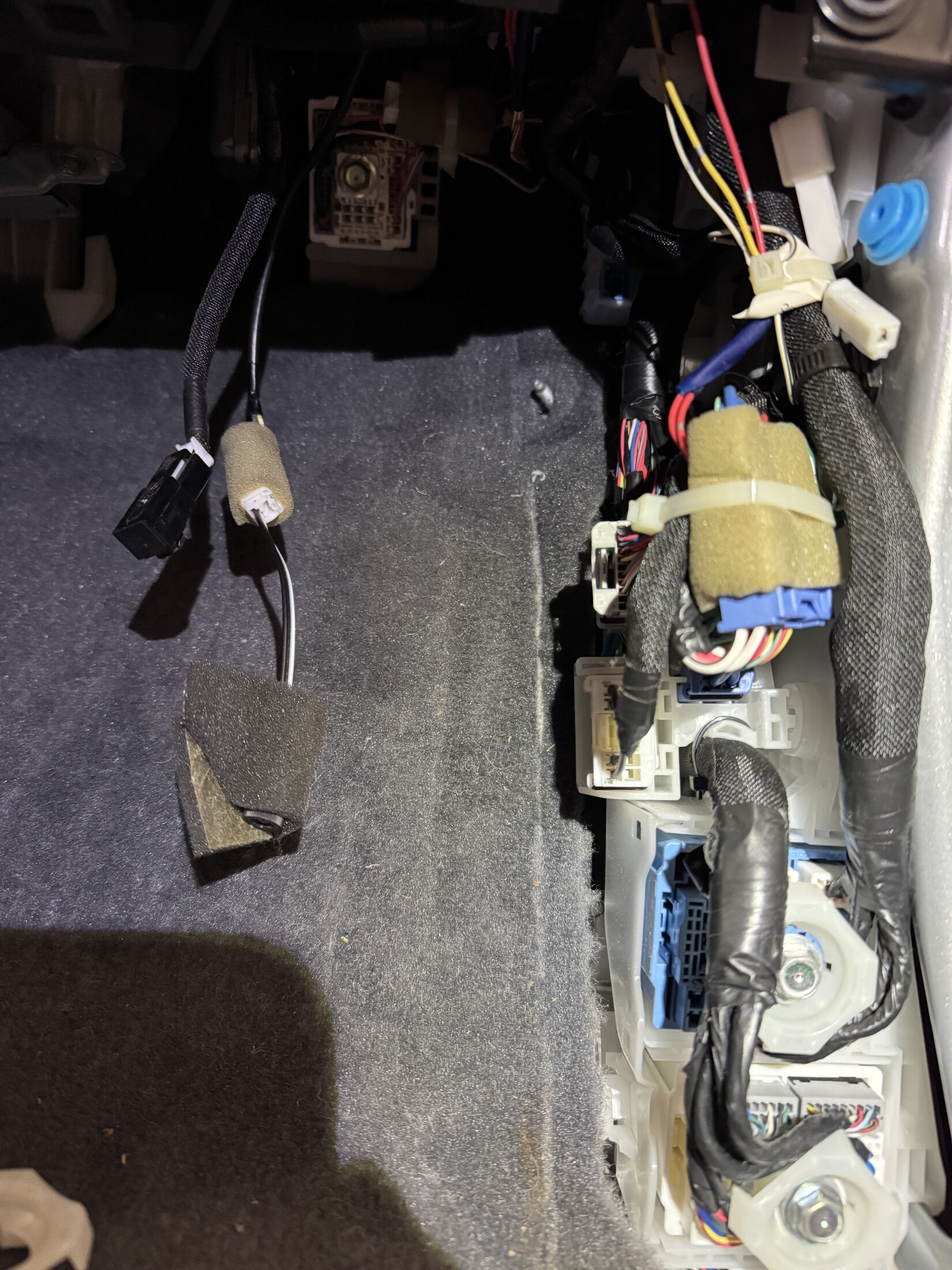

Attempting (and failing) to find where the water is coming in to my LX. Sunroof drains weren’t completely blocked, but after fishing some trimmer line into them and running small amounts of hot water through, they drain faster than before. I took the kick panels apart and checked all the connectors on both sides, and they are dry. 🤷‍♂️
LX showed the typical signs of water ingress with dash lights flickering, losing radio volume, and completely losing headlights (while driving at night, fun).

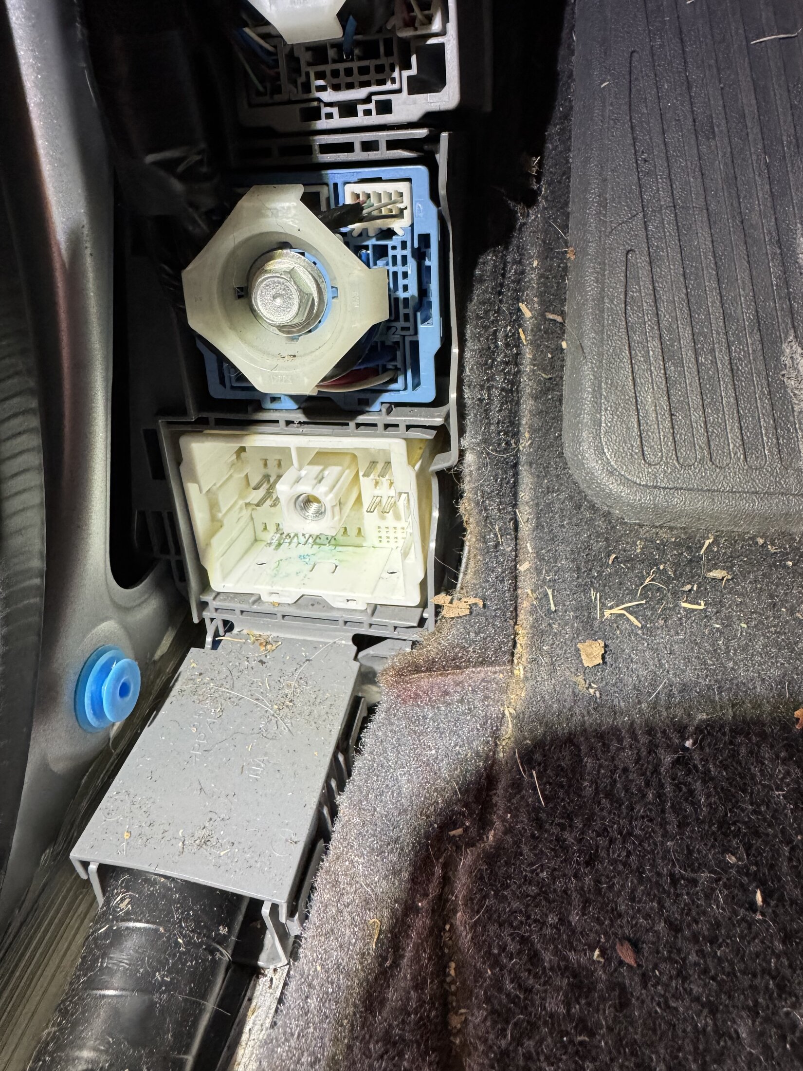

Everything is back but the headlights. These kick panel connectors are clean. Slight amount of discoloration on the bottom connector held by a 10mm bolt on the drivers side. But no moisture I can see anywhere. It did sit overnight outside in 25°F and has been in a 65°F garage for the past few hours while I’ve been working on it.

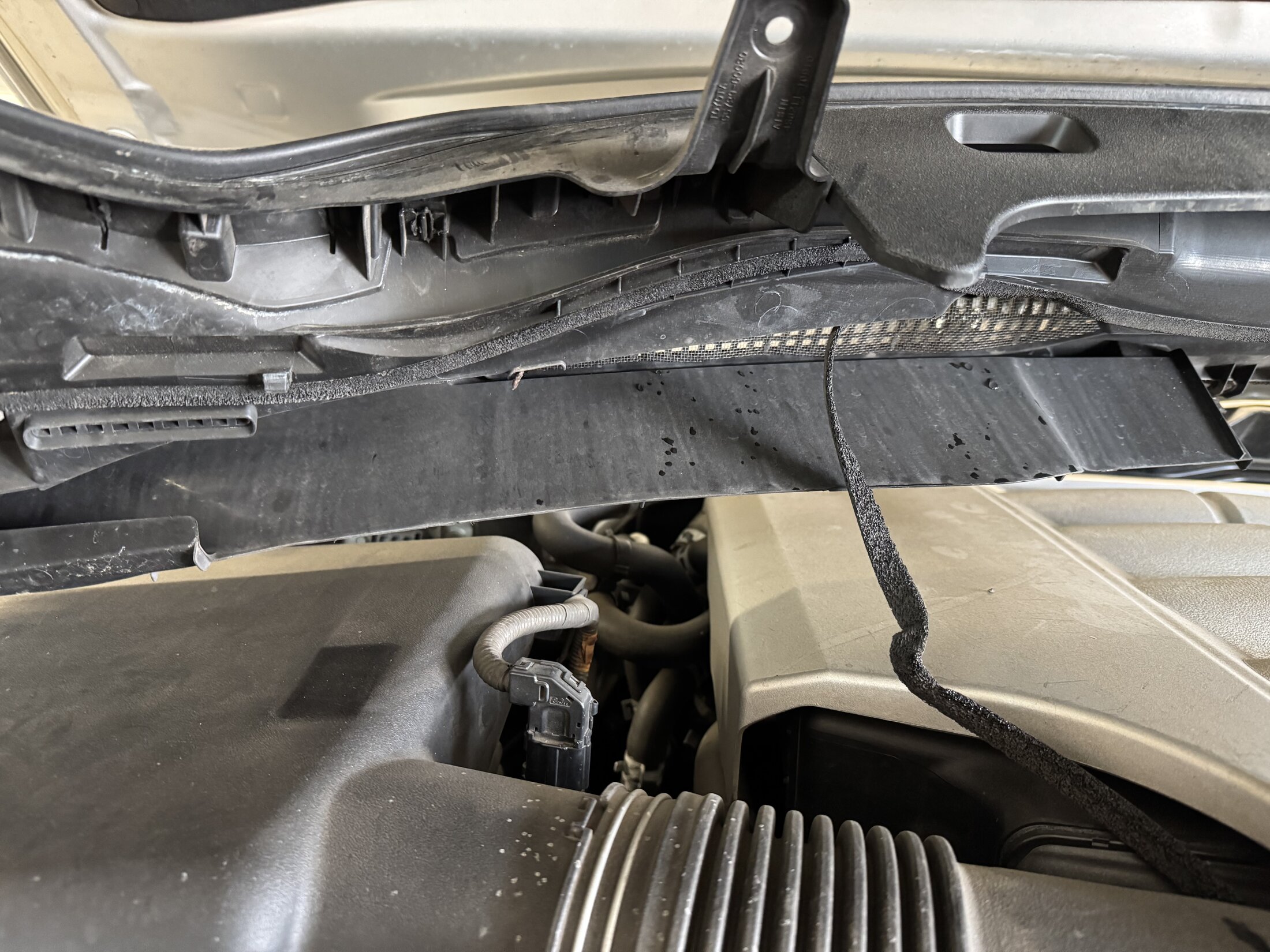

Looks like this foam falling off of my cowl panel might be the issue? It’s right over the cabin air intake. I still can’t find anything wet in the cabin at all. The foam is wet on the end hanging off however. There is a bit of pooled water under the cowl, but it appears to drain properly on both sides.

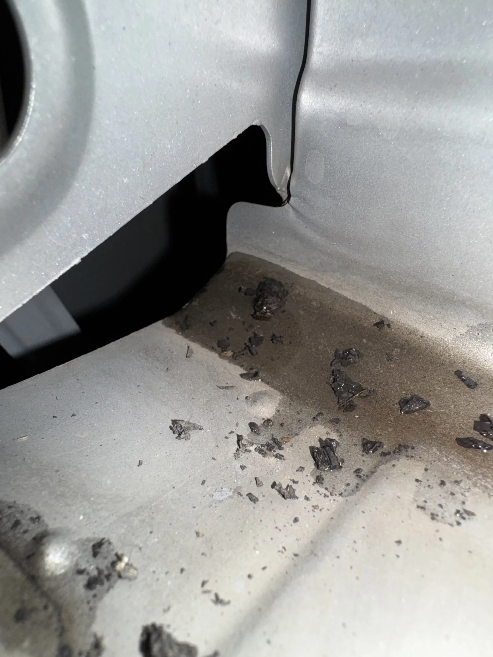

Driver’s side drain under the cowl. Looks like pieces of foam being washed away by the water that gets in under the cowl. Still can’t find how or if it is getting behind the firewall.
This piece was also hanging loosely off the driver’s side of the cowl panel before I removed the cowl:

The green stuff is 100% corrosion of the pins in that connector. Double check that all of the populated holes have the whole male and female portion remaining.

You may not see water but that green stuff would not be in that connector without exposure to water. So maybe not a leak now, but you definitely had something going on in the past.
