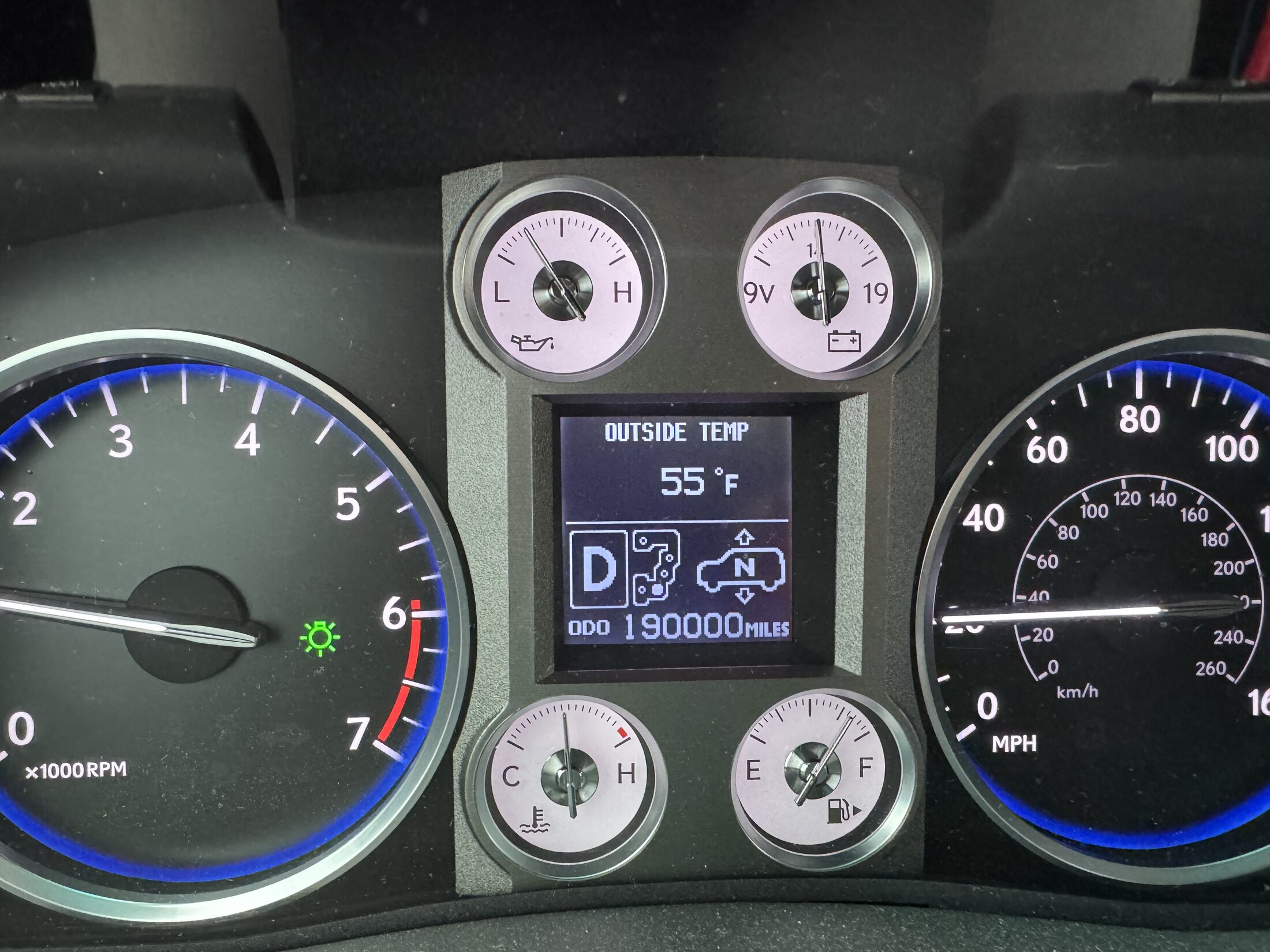

Hit 190000 today

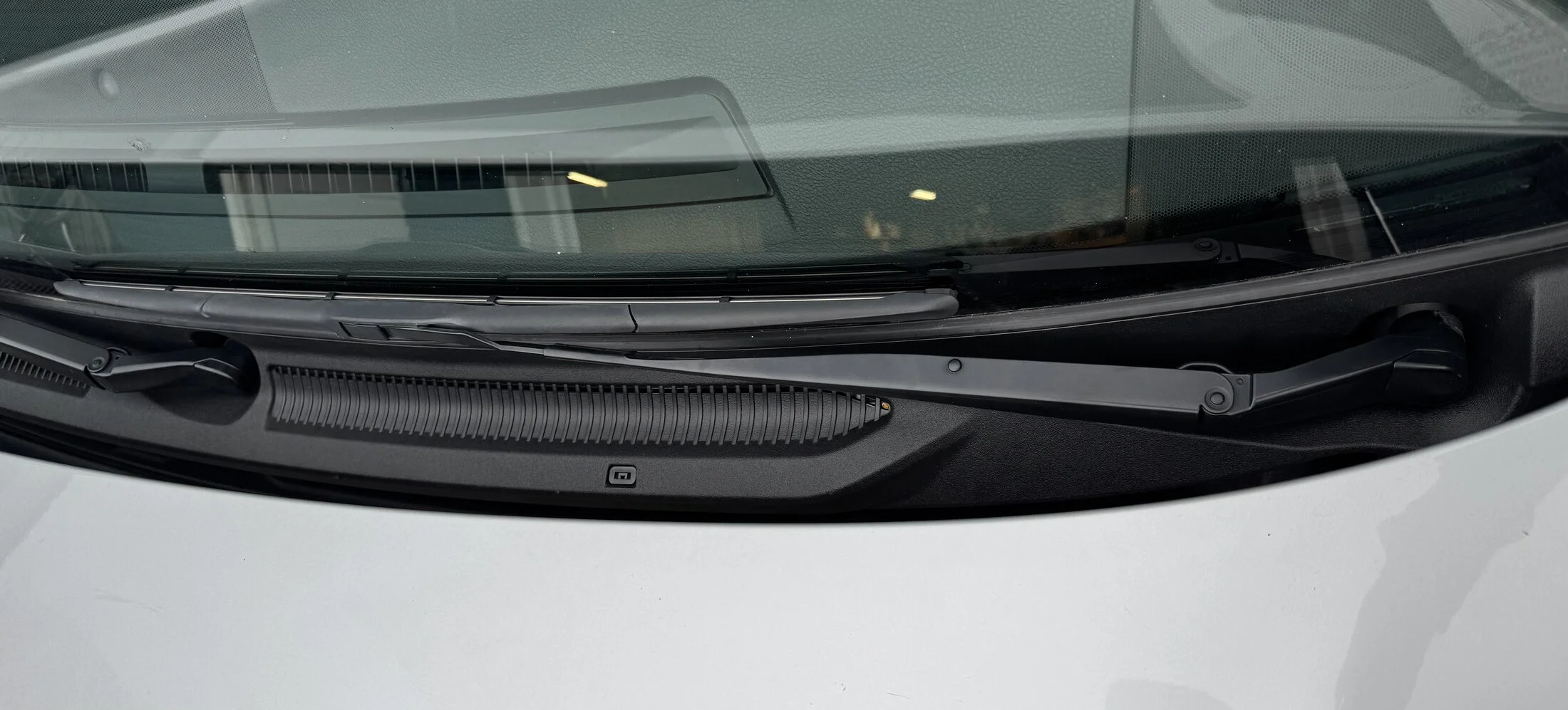

Cowl panel removal and installation WRITE-UP
1 banana job
~30 minutes
It’s so straightforward, I don’t think any pics were needed.
Part needed:
I searched and found the best price at parts.ourismantoyotaofrichmond.com:
55708-60101​
Cowl Grille​
$517.48​
Ok, here’s the process.
1. With the hood closed, pop the small covers off your wiper arms where it mounts on the cowl. This exposes a 14mm nut.
2. Use a couple pieces of painter’s tape on the windshield to mark where exactly the wipers lie against the glass before removing if you want (I didn’t do this, but it may make it easier to put the wipers back in the *exact* same place they were before.
2a. Use a 14mm socket to remove the wiper arms (these go back on very easy).
3. Open the hood. You need to remove the trim pieces that run front to back on the sides of the engine bay. Pull toward the front of the vehicle. It should give, and will move about an inch. Pop the end by the hood latch out from under the inner fender sheet metal. Then gently pull up. You can see how it was fixed to the tabs. You may need to pull forward to the front of the vehicle to fully free the tabs. Set these trim pieces aside; you’ll reinstall them.
4. This exposes 1 plastic screw tab on each side of the cowl panel. Gently turn these counter-clockwise with a Phillips screwdriver. Seriously, if you even let the weight of your screwdriver rest on these screw heads, they will spin but not back out of their plastic housing. Remove both parts of this tab.
5. On the driver’s side of the cowl, pop the wiper fluid hose coming from the fender out of the 90º plastic joint. It pulls right out. DO NOT USE PLIERS.
6. The old cowl will pull straight out toward the front of the vehicle. It really helps to have two people pulling at the time from both sides.
7. You’ll notice when it comes off that there are some black plastic tabs on the cowl under the rubber strip edge that covers the bottom of the windshield. These are what pop into place and make it somewhat difficult to remove.
8. Carefully install the new cowl, lining up the rubber strip of the new one where the rubber strip of your old cowl sat against the windshield (this will be obvious). Center the cowl, and push gently but firmly back toward the windshield (again, two people makes this easier). Just make sure that rubber strip is over the lip of the windshield, and the black tabs are below it. Do not smash them against the windshield. It will pop back into place.
9. Reinstall plastic screw tabs, one on each side of the new cowl.
10. Reinstall your side trim pieces (my wife did this for me; her hands are super small, and she could get them seated on all three tabs on both sides very easily)
11. Close the hood.
12. Reinstall your wipers. Just start the 14mm nut and then lay the wiper out to make sure the blade lies in the right spot on the bottom of the windshield. Torque ‘em down. I just used the GFT method.
And you’re done!

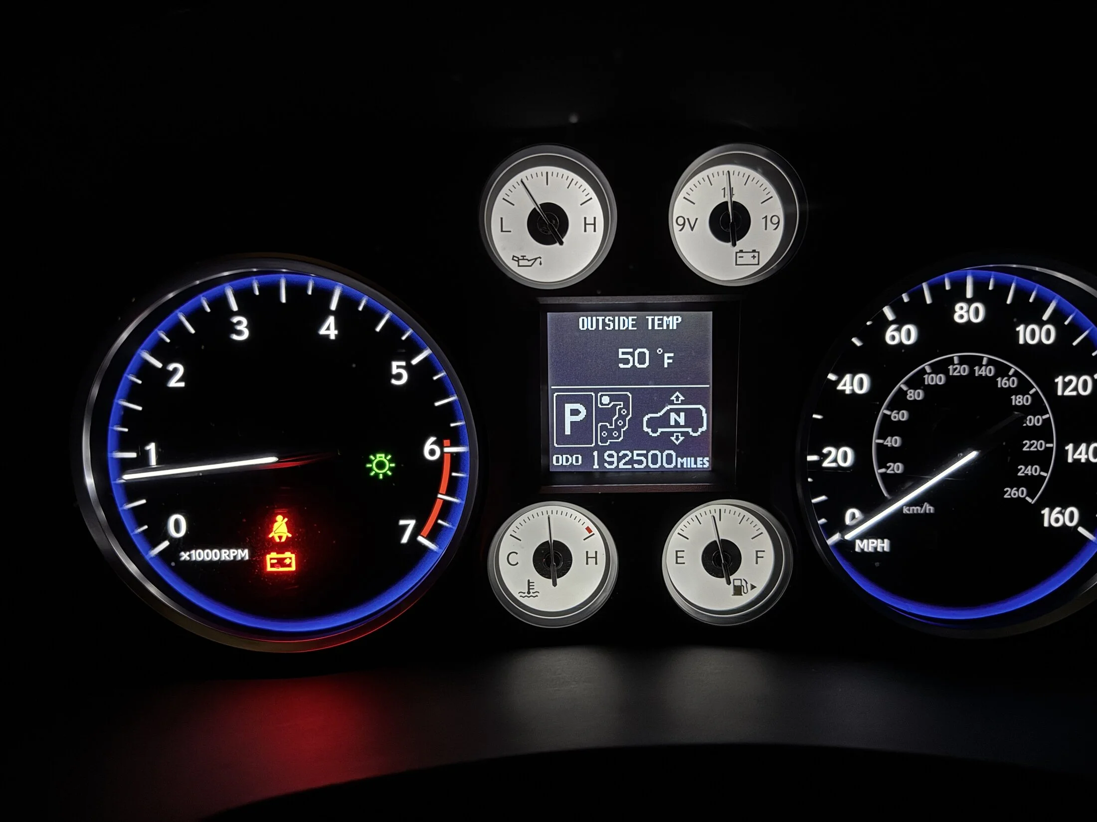

Alternator is installed, everything appears to be good, except now the battery light on the dash won’t turn off. I’m getting 13.8 V while the truck is running and 12.6 V after it sits overnight. Alternator and battery are both new and appear to be working properly. Yet the battery light stays on constantly.
I checked the plug and the charging cable connections at the alternator. Negative battery cable is currently detached. Maybe it just needs to stay disconnected for an extended time. I’ll reconnect it in the morning.
Feels like I’m grasping at straws. This issue sucks. Any ideas?

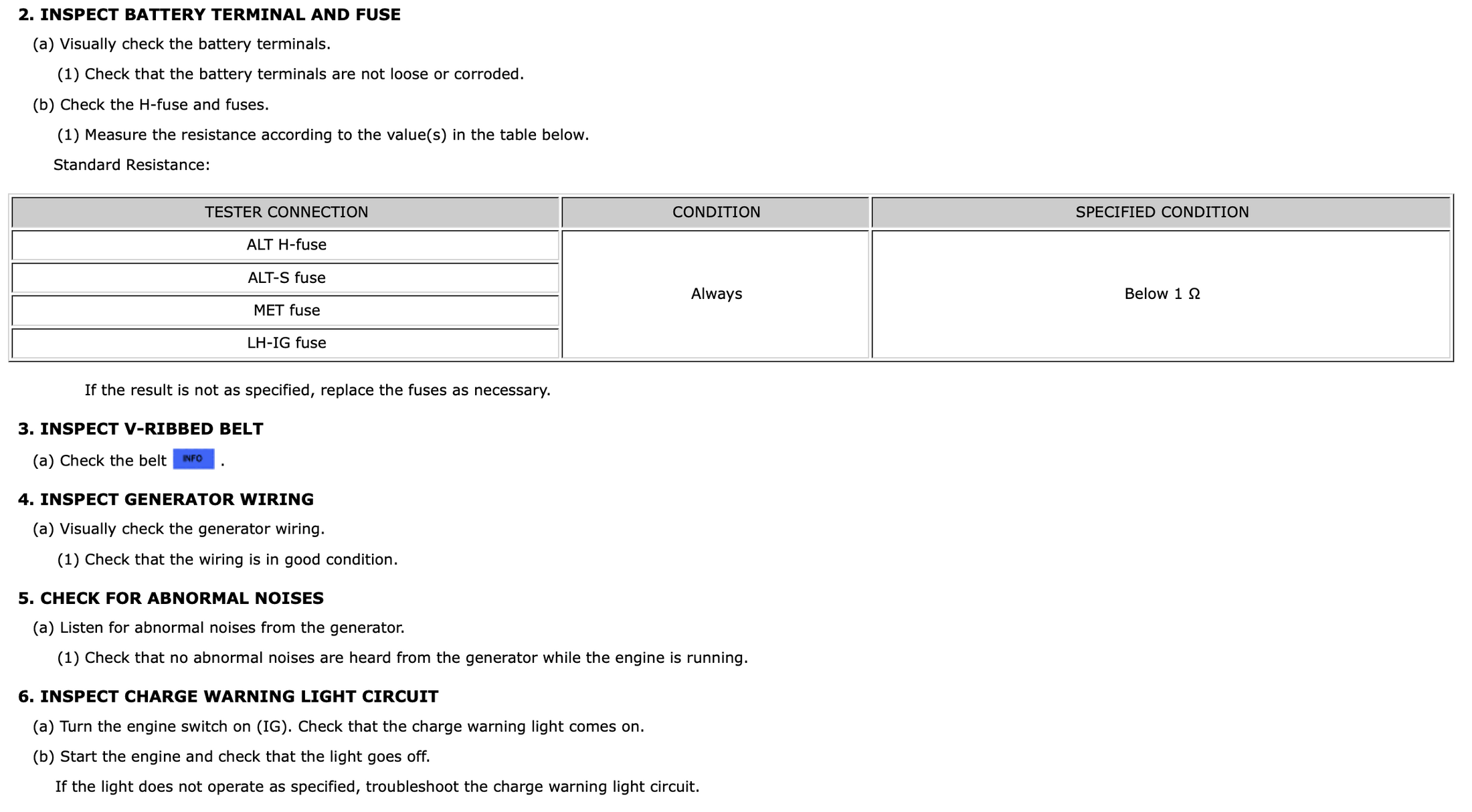

So you have the FSM? Did you follow the troubleshooting for Battery Light On?

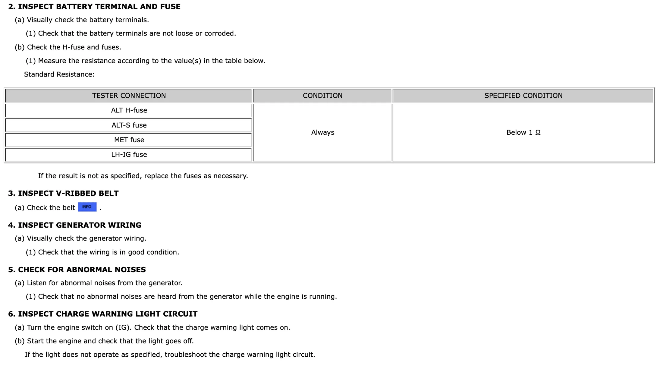

Got this set up with Abyss, and now I'm reading through it. This is super helpful. Thanks to @linuxgod for putting it together and spelling out the steps to get it set up. It looks like I need to check a few things if the charge warning light circuit (battery light) is not operating properly. The below steps are to be performed with the truck running:

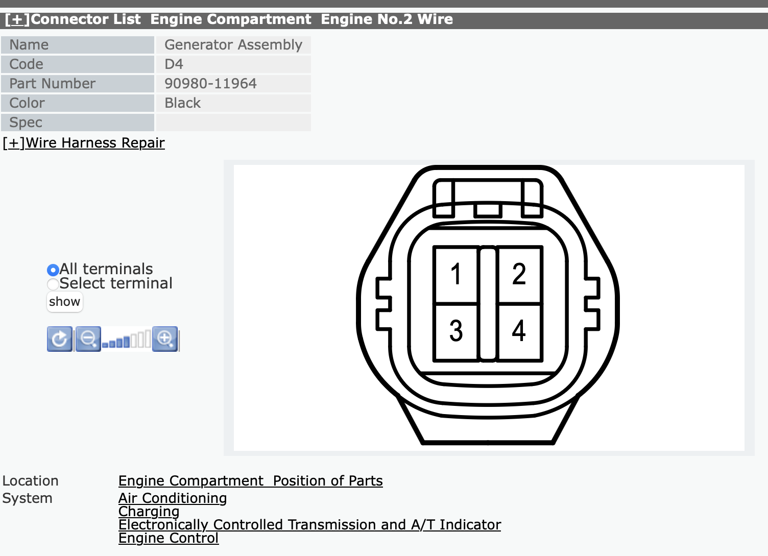

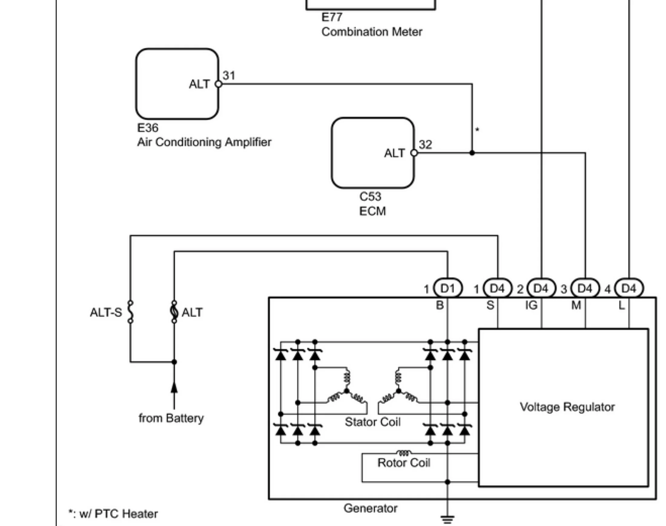

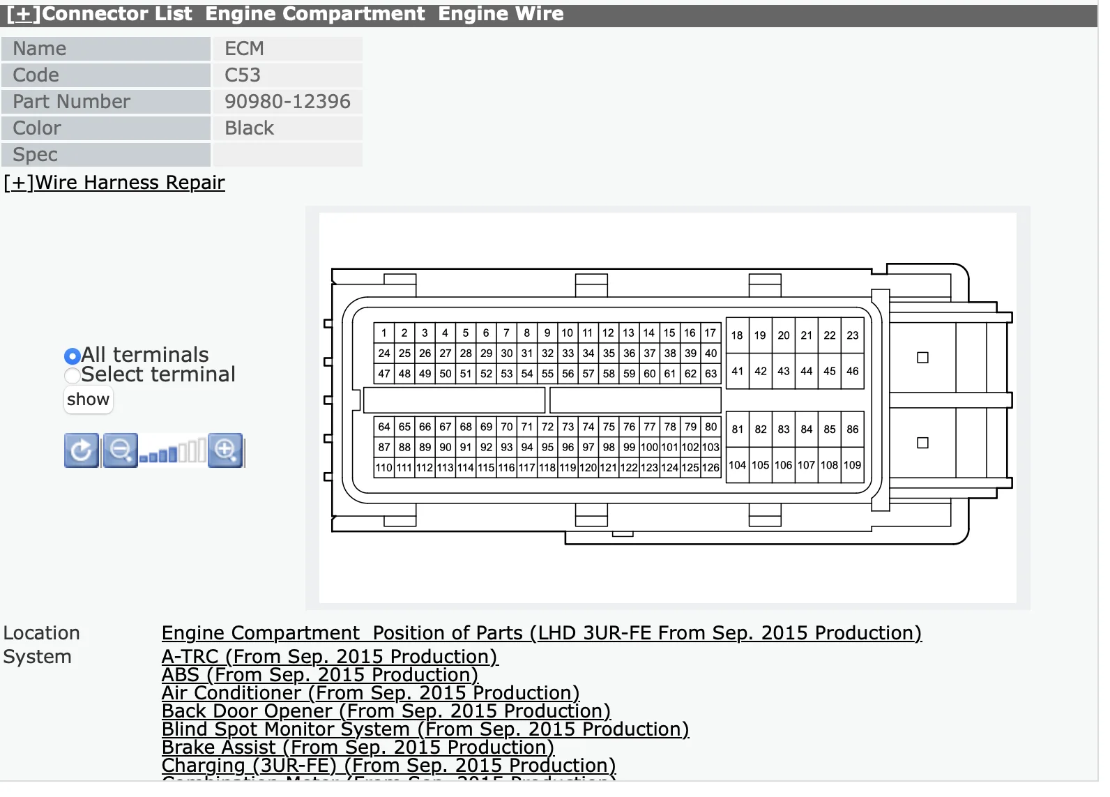

If we pass those tests–which I really think we will with this being a new alternator and all–then it seems I should check resistance in the circuit. It looks like I should check resistance from the #3 pin in the D connector on the alternator and the 32nd pin (or wire?) in the C53 ECM panel. Am I reading this right?
For my own reference when I can actually get to this, here's the connector at the alternator.
...and C53:
If that test fails, I'll probably just replace that part of the wiring harness.

Finally wrapped up the issue with the battery light on the dash. Turns out one of the wires in the plug that goes to the alternator was broken. Replaced, and we’re all good. In summary,
* All the overcharging, burning the headlights out, and radio volume going away were due to a faulty alternator.
* When the new alternator was installed, one of the wires at the plug was broken (probably fat fingered it putting it on the new alternator), so the new alternator was simply not communicating with the truck.
