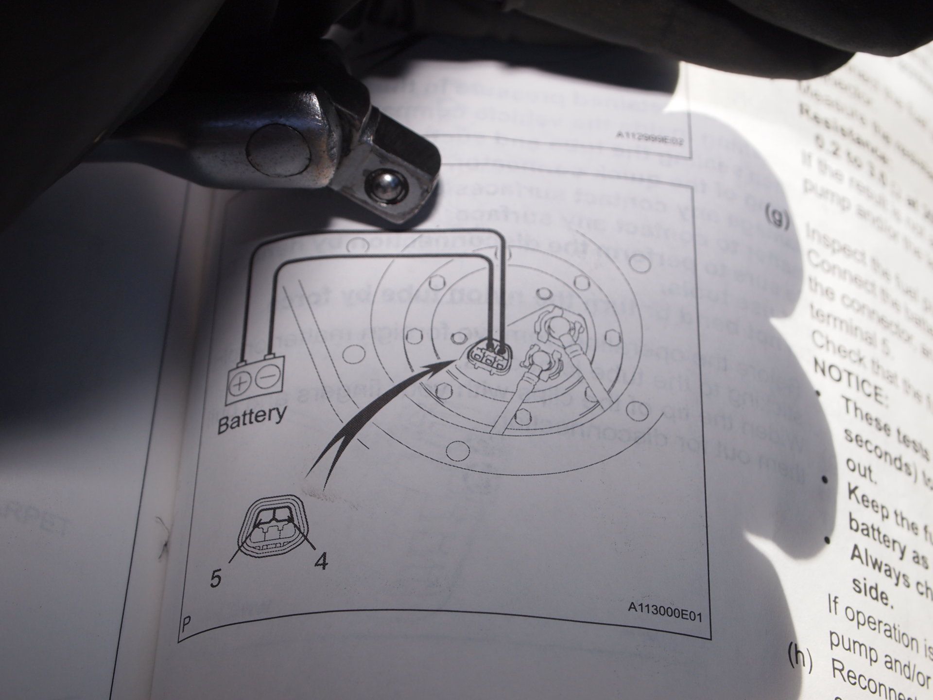

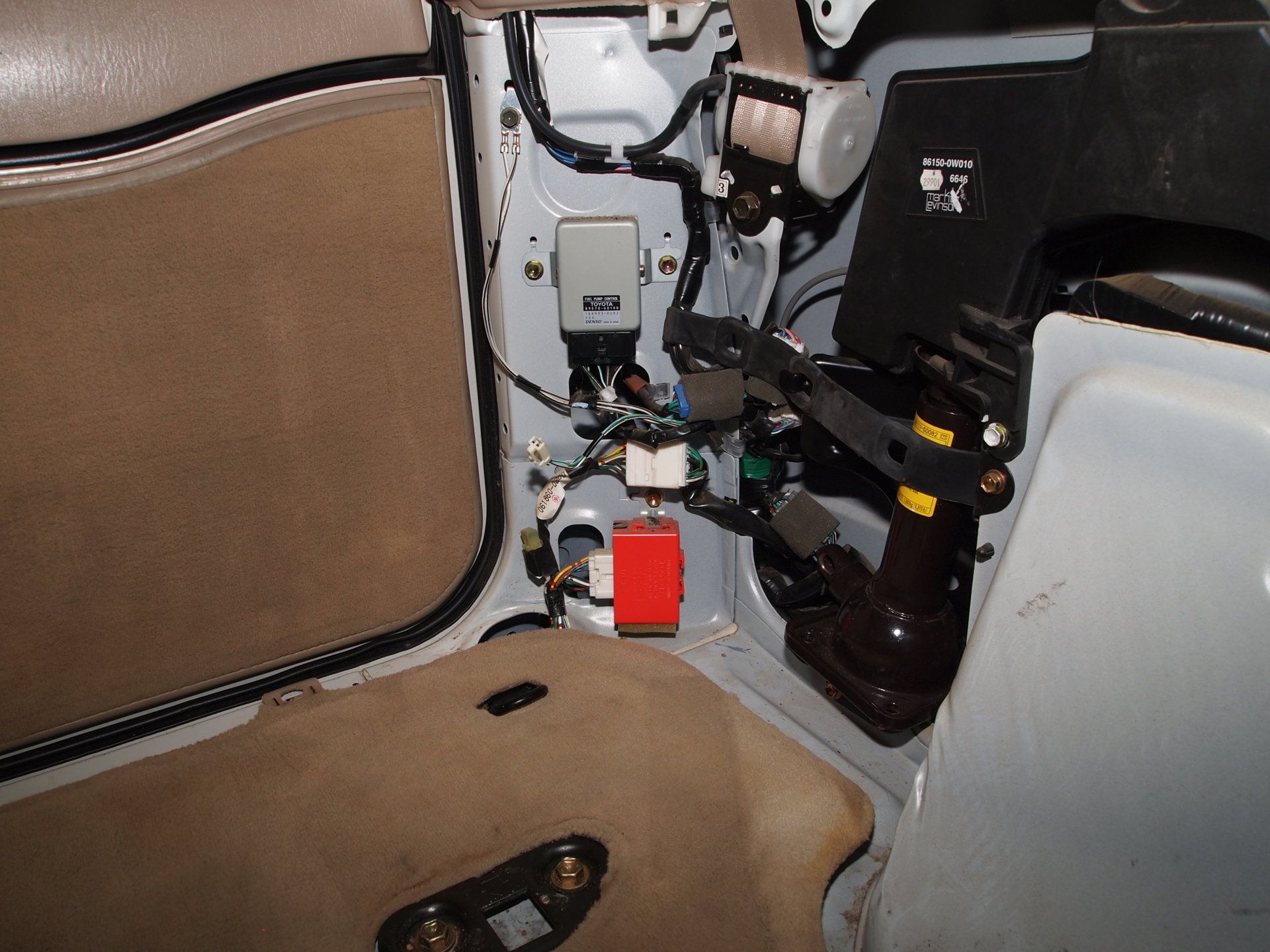

FSM has us disconnect the fuel pump power at that point under DS rear door, when necessary to shut down fuel pressure. You may want to check resistance of wire in both direction from that point. You may find help info here: Draining Fuel from gas tank?

Jumping the fuel pump with 12V battery

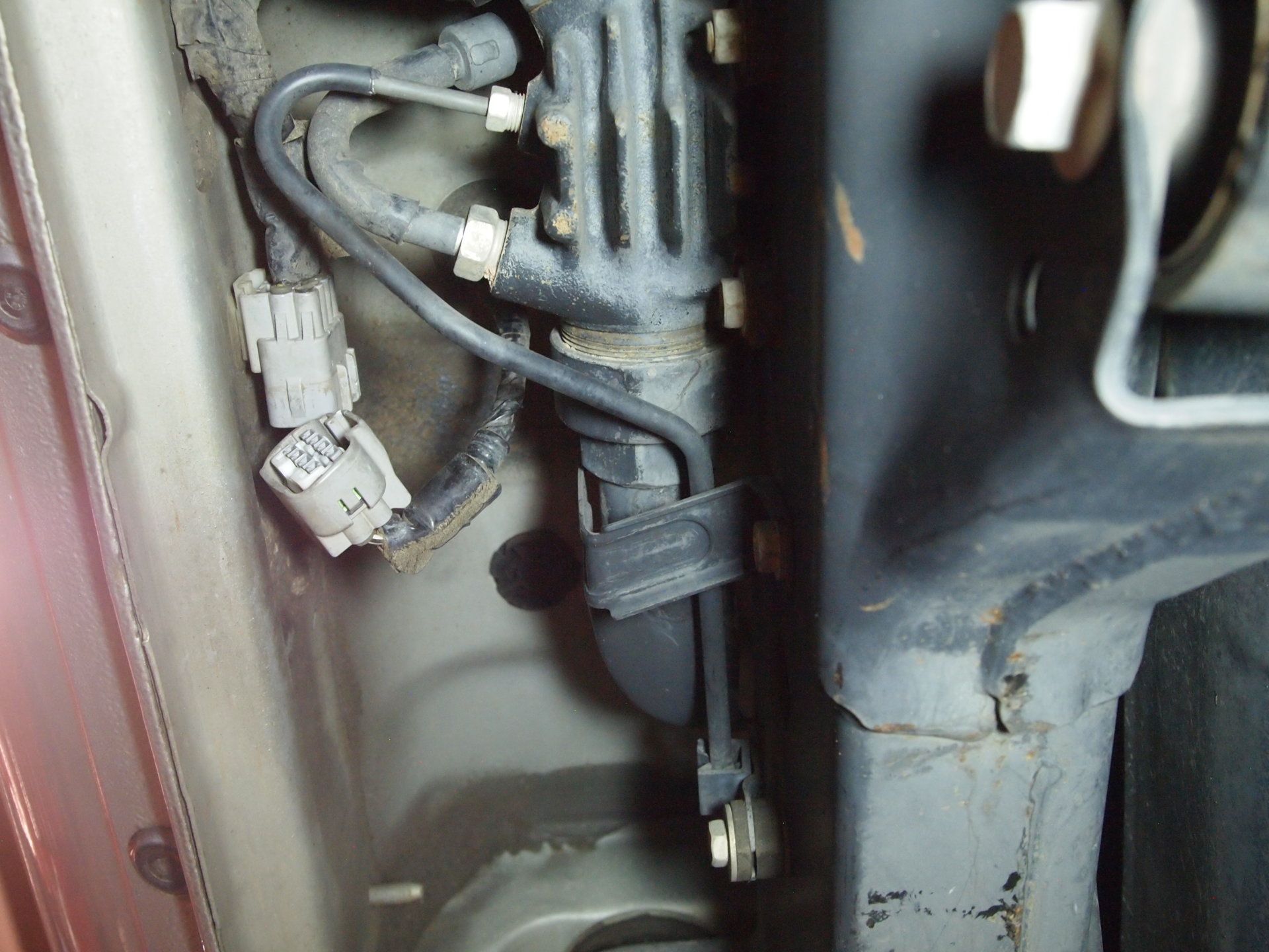

Fuel pump disconnect. Clean and spray DW40 or electric contract cleaner. These are a bear to unplug when dirty.

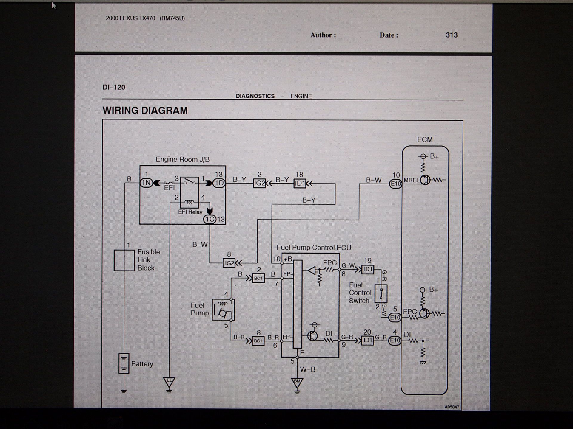

Fuel pump control
Fuel pump disconnect. Clean and spray DW40 or electric contract cleaner. These a are bear to unplug when dirty.
Fuel pump control

CORROSION IN REAR HATCH CONNECTOR SHORT TO GROUND OF FUEL PUMP DURING REAR DEFROSTER OPERATION CAUSED STUMBLED. EXCESSIVE/CONSTANT SHORT TO GROUND CAUSED FUEL PUMP TO MALFUNCTION. CLEAN HARNESS AND CONNECTORS OF CORROSION AND APPLY DI-ELECTRIC GREASE
