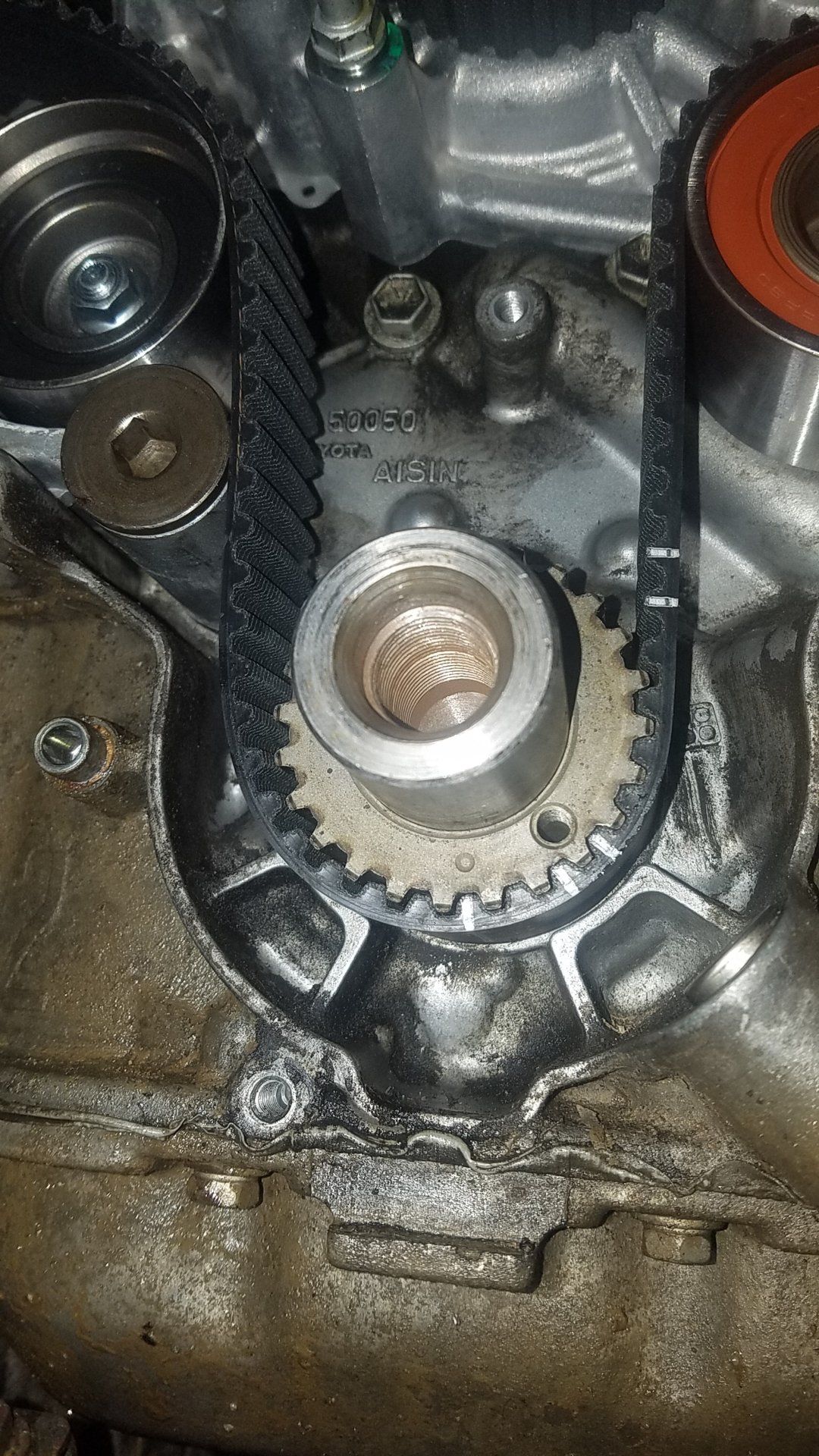

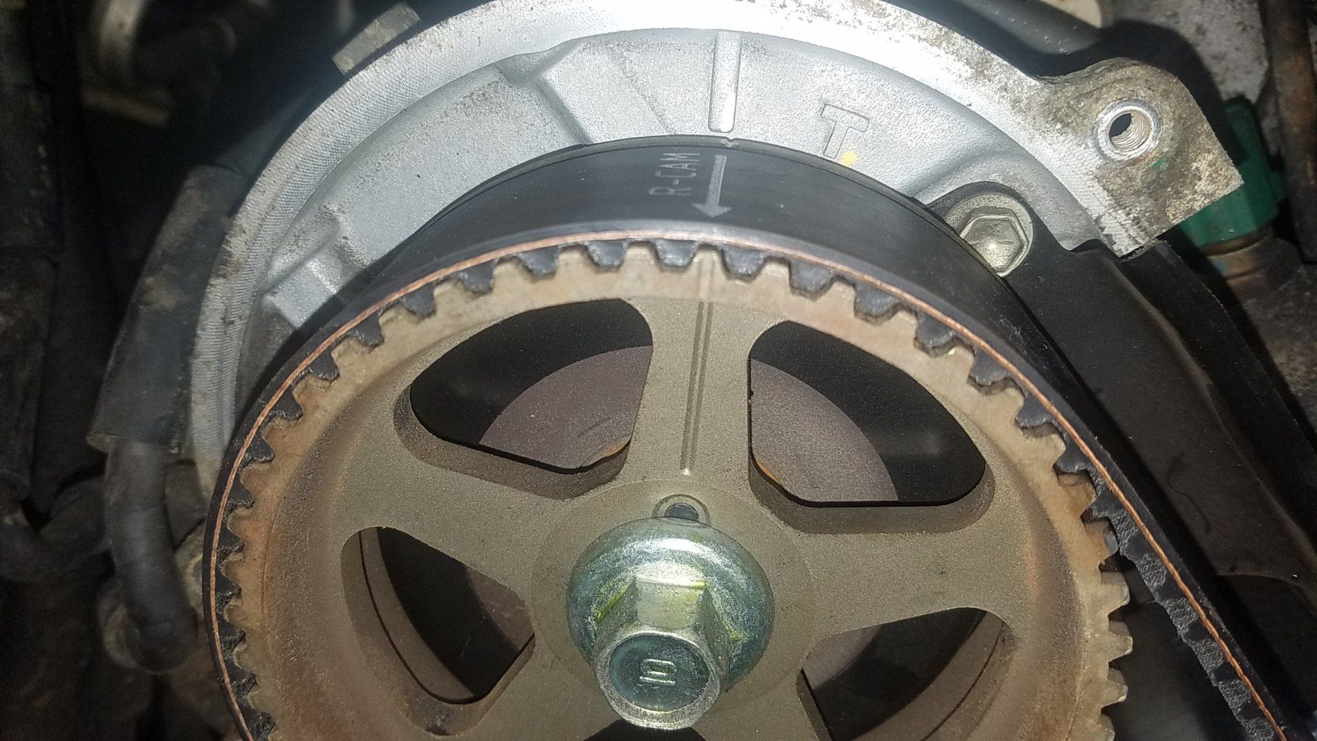

***All fixed*** real time help - should I replace Cam seal and Crank seal? Doing timing belt now

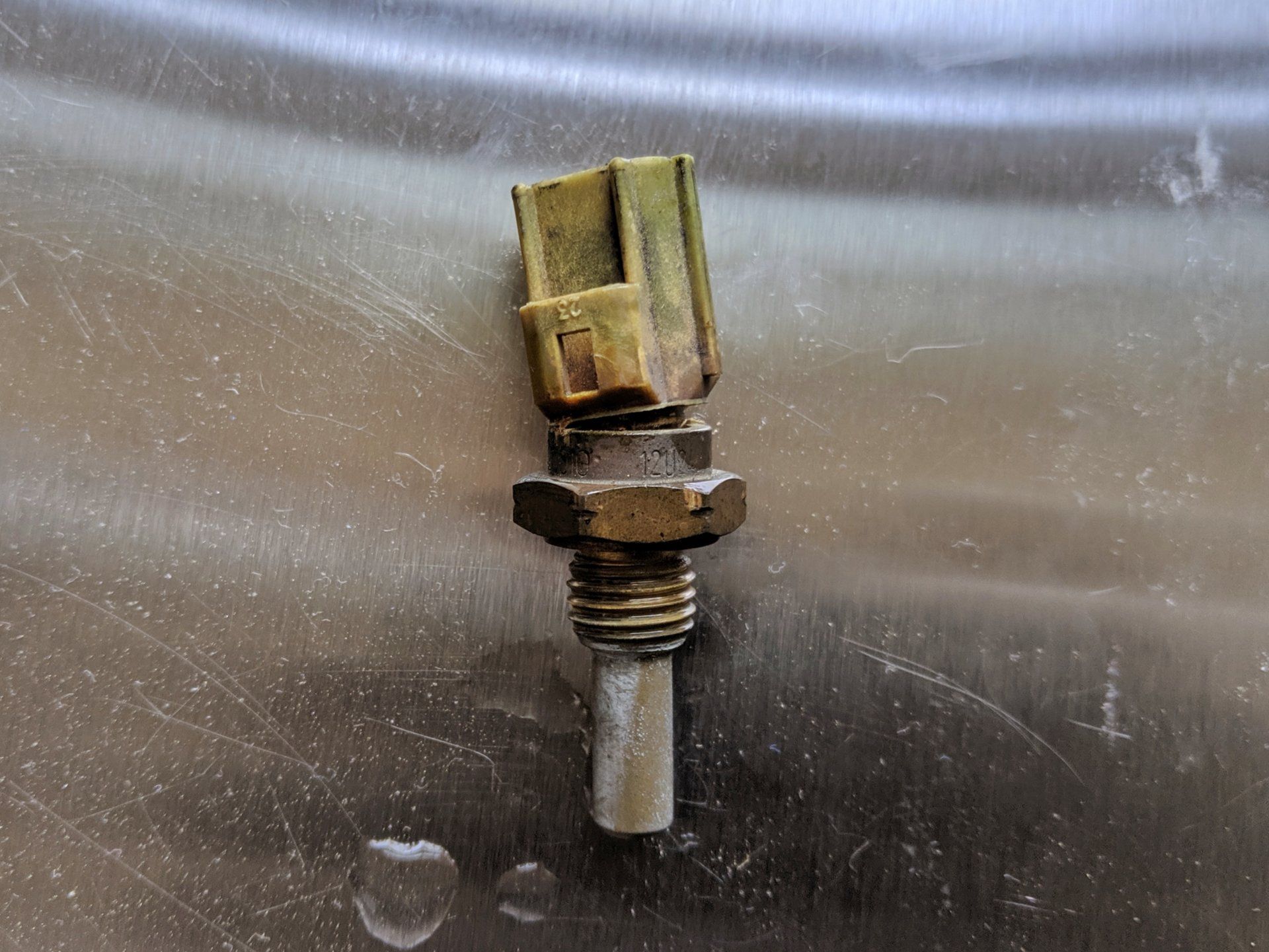

May have found the culprit (though I've said that before) with this coolant sensor.
Cracked and not reading any resistance on its own or in 140° water.
Going to get a new one and see how this saga unfolds.

The sensor was definitely dead and the local dealer with the good prices had one in stock. I installed it and fired right up and then died after a few minutes.
Tried driving around the block and died progressively quicker and quicker, unil it wouldn't start.
