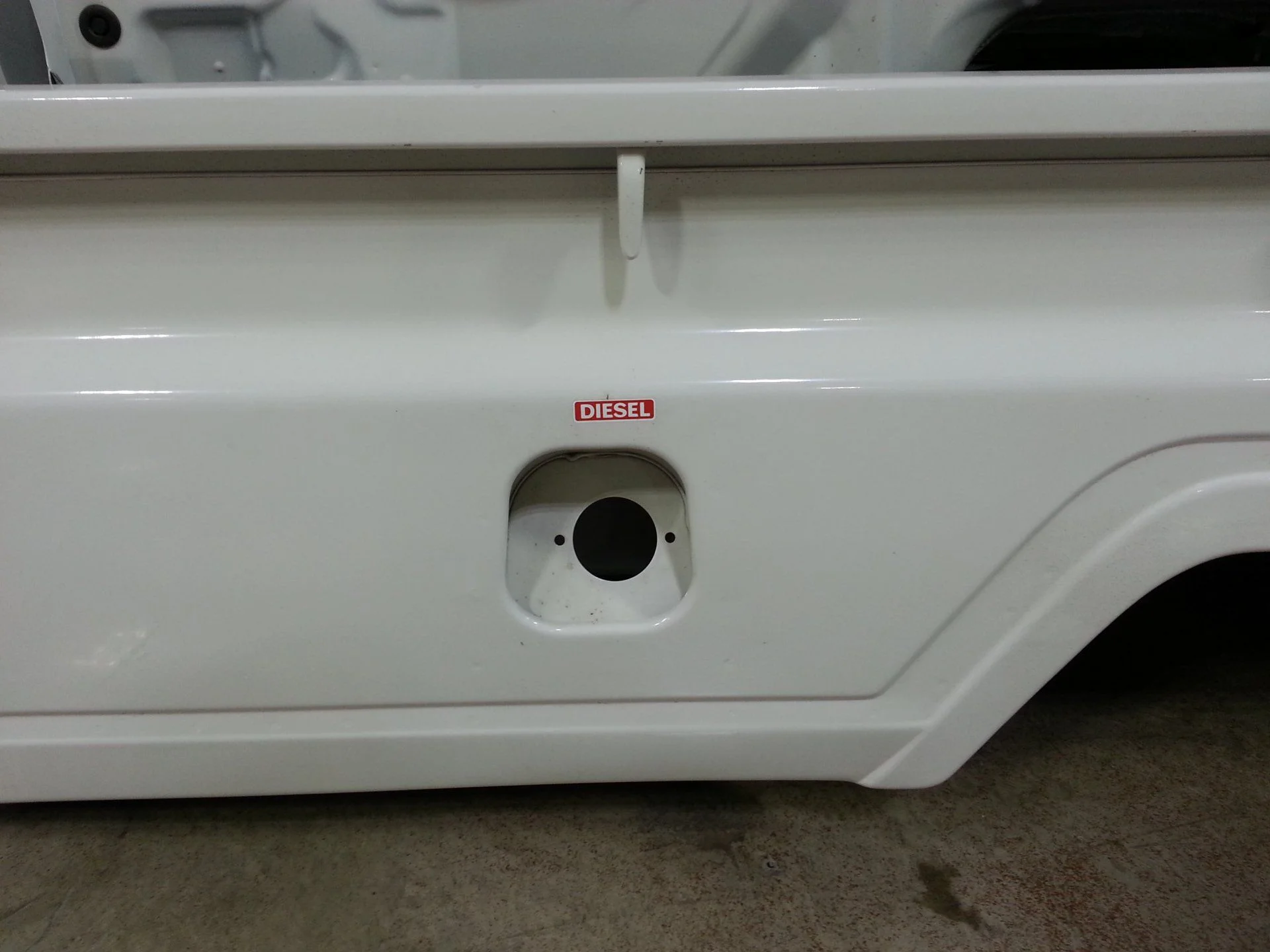

Anybody know where mr T put these diesel stickers?

Maybe put diesel label above filler to avoid drips.

I don’t know if I’ve even seen a 75 or 79 Series truck with fuel doors.
My feeble thoughts ..... I would put it where there is no chance the fuel nozzle or spilled fuel could possibly damage it.
So maybe put it above the cap rather than below, as seen in that image provided.
I zoomed in on the original photo that I took and, assuming you are talking about the beige one, I am not sure that's a Diesel sticker....maybe it is but it appears to be mounted vertically if it is.
I just looked again. It does appear to be a Diesel sticker mounted horizontally but it also appears to only be half of one...."esel".
