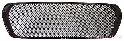

I have a chrome one that I painted black. I used SEM products, and they didn't recommend a primer with the Trim Black product. There are some thin spots on hard edges. If I did it over, if use a primer first. I scuffed with a 3m pad and cleaned with their xxx universal surface cleaner per their instructions.
Did you find a black one or did you buy the chrome one and paint it?
Bought the chrome and painted black. Used a primer+paint can
Sanded it a bit to scuff it up first.

I’m officially a member of the black grill club. Lots of scotch brite pad and then a coat of Fusion plastic paint. Didn’t love it so I did a can of plasti cote premium spray bed liner. Love how it came out.

I bought a chrome grill for around $70 and painted it black. The black grilles definitely run for a premium on ebay.
