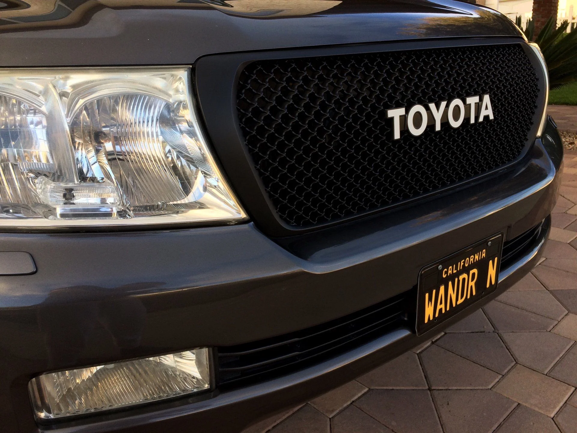

Although the grille I bought was claimed to fit the 08-15, it does not accommodate the camera found on ’13 and later. Modification of the grille and fabrication of a camera mount will be required. I ultimately decided to go without the camera. I covered the connector, and secured it.
Mounting the Toyota emblem to the grille was fairly simple. The emblem does not come with any mounting hardware. I ended up using stainless steel machine screws, external star lock washers, and finishing washers that I flattened with a hammer. Sorry, but I forgot the metric size and length of the screws. They were pretty short. As you can see, I had to take the Dremel to the grille in order to fit the emblem. I placed a little glue gun in the Dremeled slots for a snug fit. Although the picture shows double-sided tape on the back of the emblem, I ended up not using it.
I actually purchased the grille for an '08 LC, but in the interim and after mounting the badge on the grille I got a ’13. So, unknowingly, I had mounted the “TOYOTA” FJ badge in a position that blocks approximately the bottom 1/3 to 1/2 of the Pre-Collision Sensor (PCS), which I think also works with the adaptive cruise control. In that spot the badge looks well centered, but I'm getting an occasional “PCS Unavailable” warning on my display. If I had to do it over, I would drop the badge down a row on the grille, although it will still cover part of the sensor

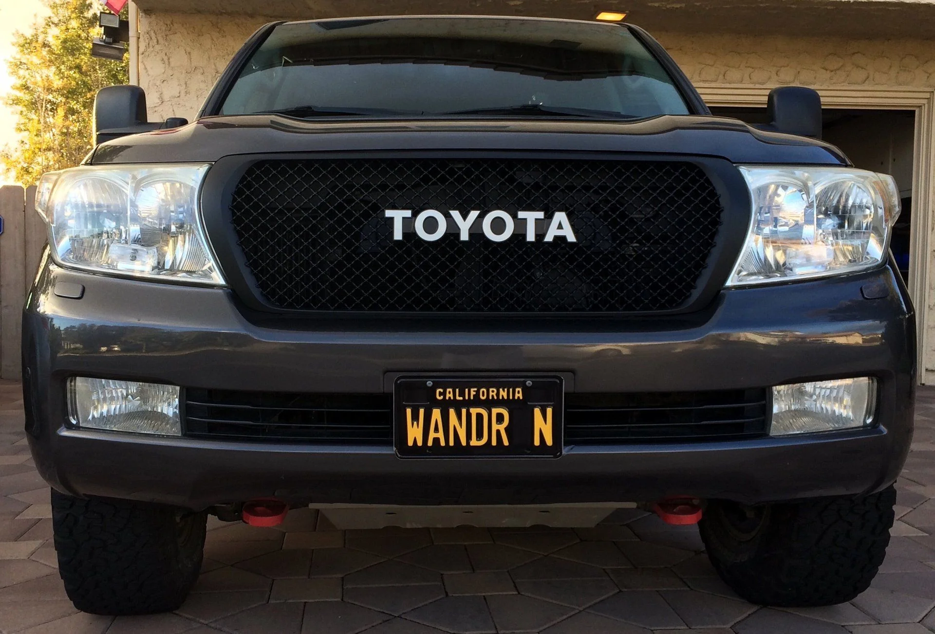

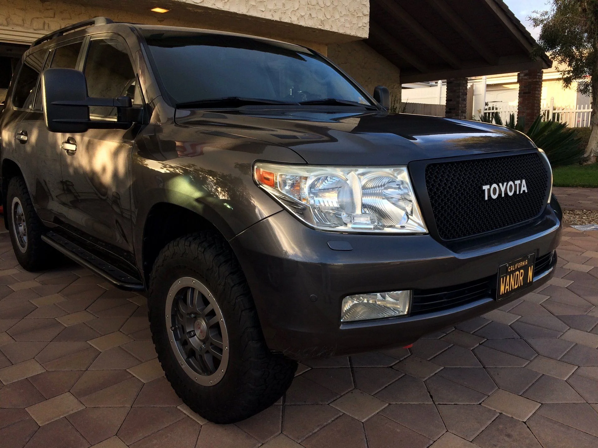

Despite the issue with the PCS, I'm very pleased with how it turned out.

Here is the same grill, but painted flat black & with a larger TOYOTA:
