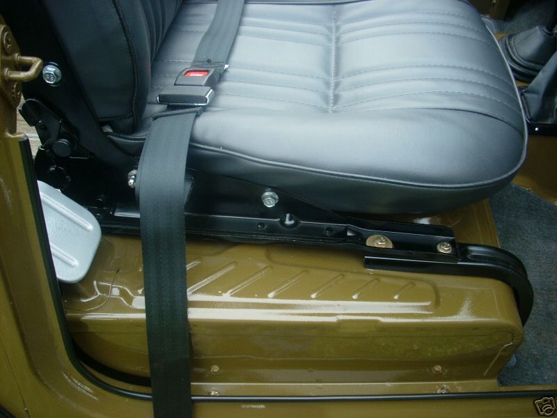

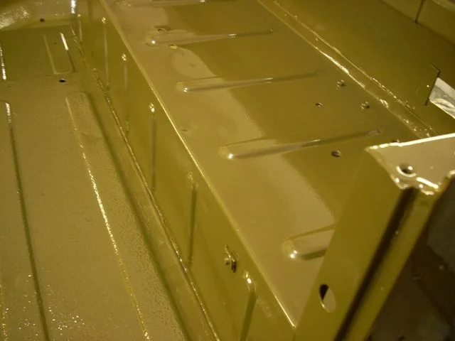

Close up of floor...
Close up of the floor...
Hmmmmm........Hadn't really thought about doing the floors. I have a ton of paint left over and will need to repaint the inside anyway. We'll see how ambitious I get.
The spray looks great. Roller is a ton of wet-sanding. Spraying really gets those tough areas like seams and hinges much better.

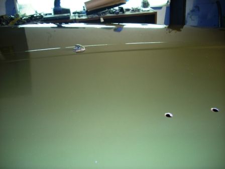

Clear and Buff!
Just got done with the first buff. Looks pretty good. Will need to get some swirl remover on it, but overall a decent finish for ACE paint... :p
