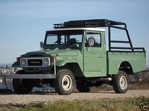

Also, any chance Greek can post a pictue of his Breathe Green 40? I've been looking all over for a picture of a Cruiser painted that color!
ACE Paint
Reading this thread I saw this post from about 9 months ago. Does Ace still sell this paint?
ACE Still carries this line of paint. I had a small batch of 653 OLIVE made up about a month ago.
As far as the Breath Green sample. Well, I am going to paint my rig that color (maybe) but you are in the same boat as me. I have never seen a Breathe Green sample. (at least one that the owner KNOWS its breathe Green)
I have ssen some green rigs on MUD that I think are Breathe but not sure 100%
Let me know when you see one... :)
These are close
Greek:
I've seen both of those pictures, in fact I posted the pic of the green 45 in the "official color code" thread. I think that it probably is Breathe Green. Like you, I'm not 100% certain.
But the 40 is 6h9 "greyish olive," a mid-80's Toyota color, based on information provided by the orwner.
