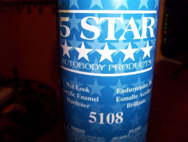

I shot my third and fourth coat but I added some "wet look" hardner. HOLY TOLEDO!!! Man it lays down nice.
The hardner I used is fully compatible and shines it up very nicely. heres a pic... May not even need to shoot clear...
