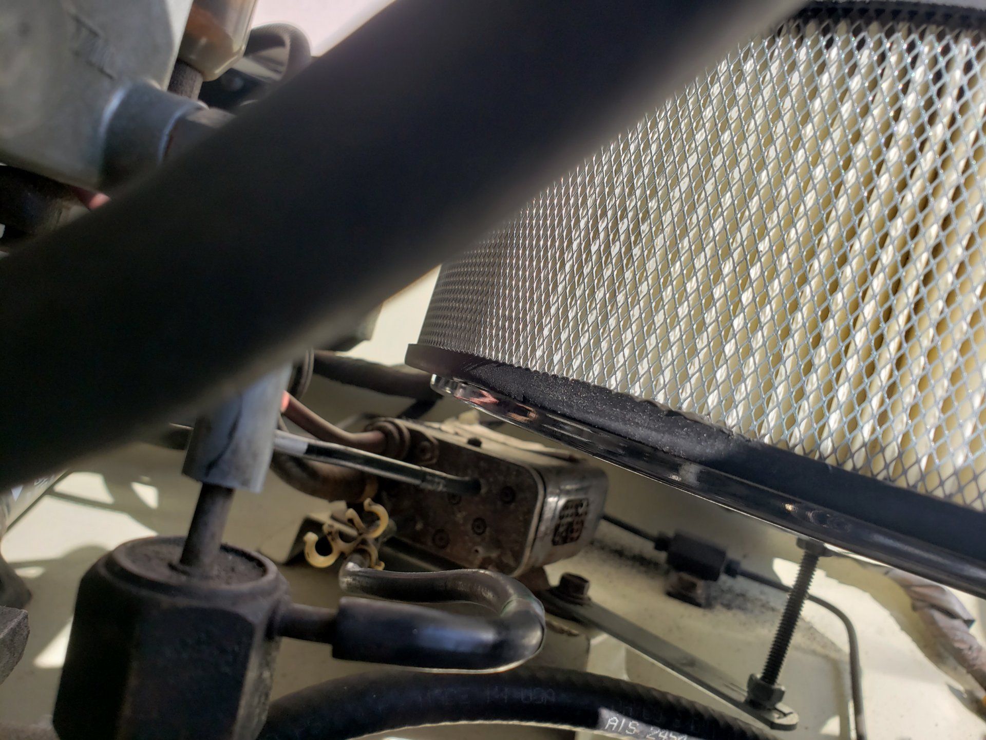

Hi everyone. Got the Aisin carb on! Still need some threaded rod for a new linkage and a line for the dizzy, but it's running great so far! Gotta get a tach to dial it all the way in, but by ear, it's nice and smooth and improved from the Rochester.

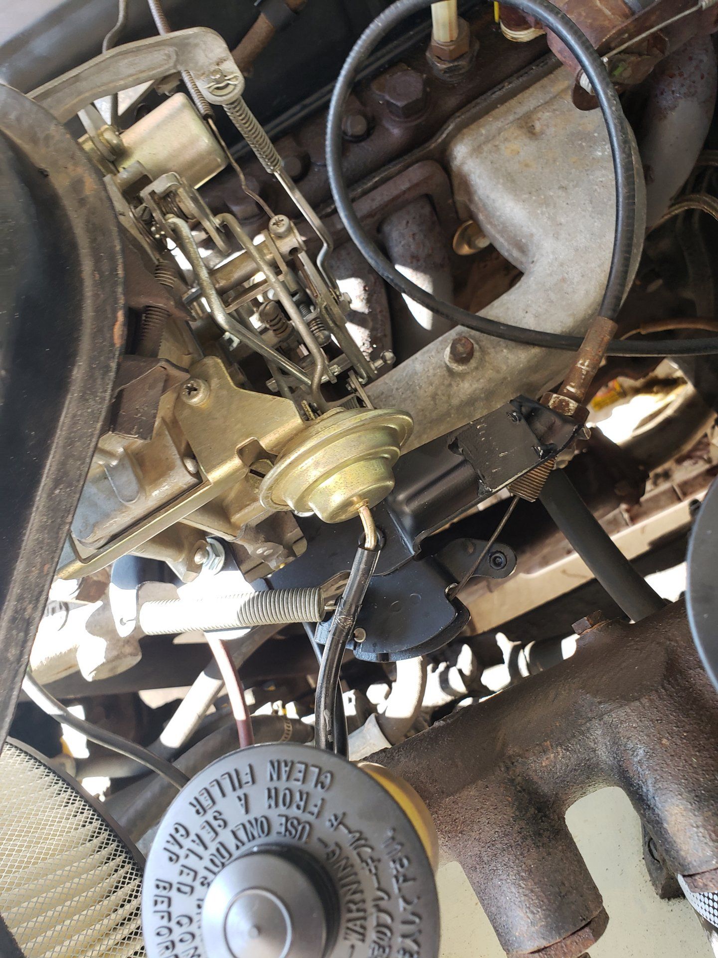

Question...I've been reading old threads and think I know, but is the hose from the diaphragm on the carb to the base of it in the pic correct or should it go to the VSM? I've seen it both ways. I know the one next to the idle screw will go to the dizzy, but does the vacuum advance dizzy negate using the VSM? Do I need to do anything else to the rest of the emmissions stuff?
The canister is still there as is the VSM and there's a line from the VSM to the intake from the PO. Should I remove and cap this line to the intake and unplug the vsm or run things through it? Sorry, I know there is all sorts of desmog info on here but I couldn't make sense of it becuase there are multiple different years and setups. I need just a little help! Thx in "vacuum" advance ; )

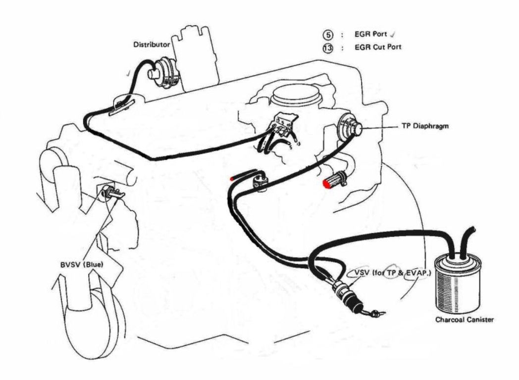

Saw a thread on what appears to be the similar vsv and evap as mine and recommended this, so the evap system is still connected. View attachment 2457904

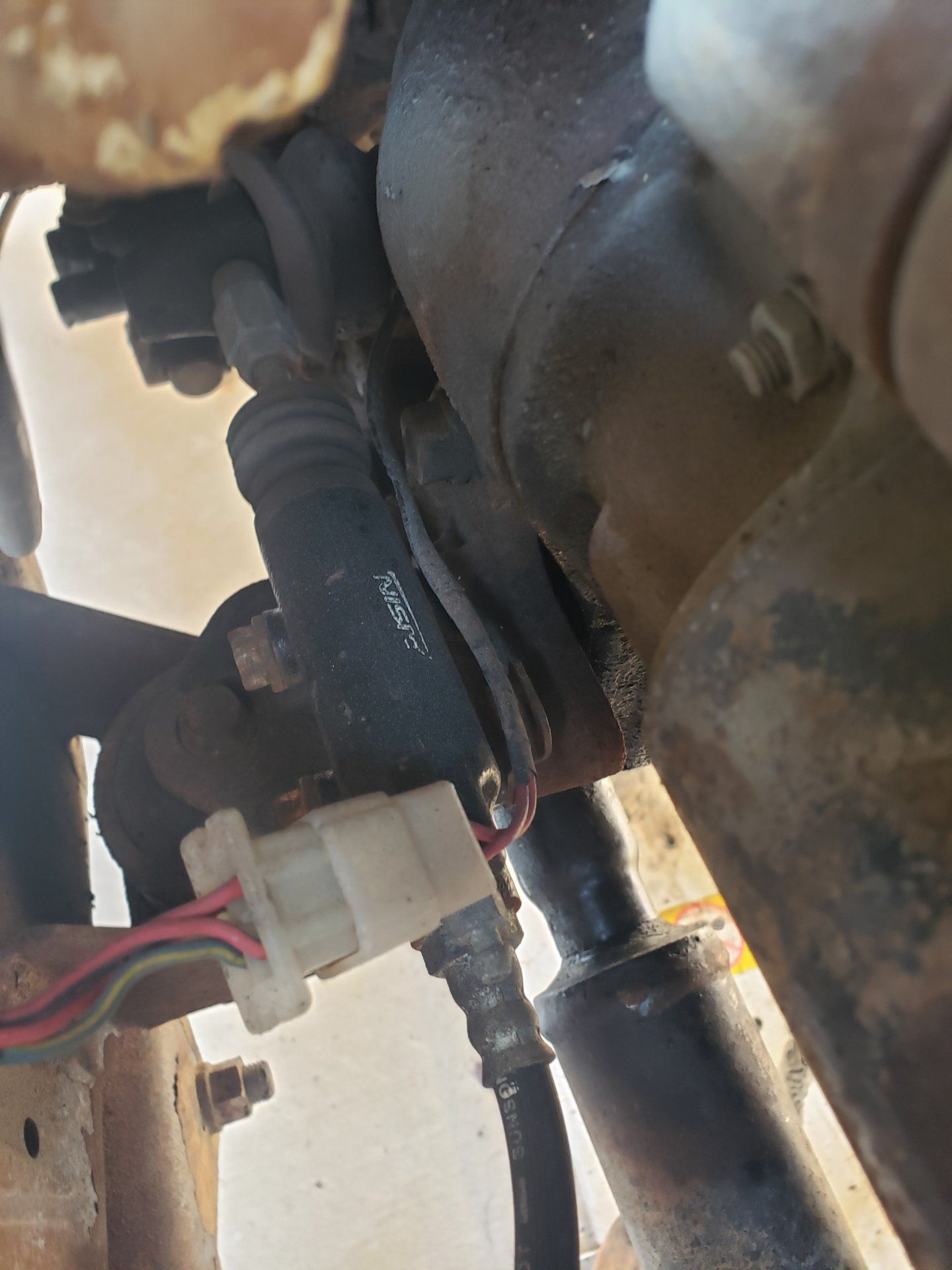

a few more pics of attempted set up like above. Don't have the emmissions fsm but even if I did, I couldn't make sense of what to do here. Also showing a pic where the old red and black vac lines to the vsm ran off the old carb
You're doing great 👍. I'm not sure about the vac off carb . Plug it and see what happens!! You've got it running a lot better! Keep it up 😉

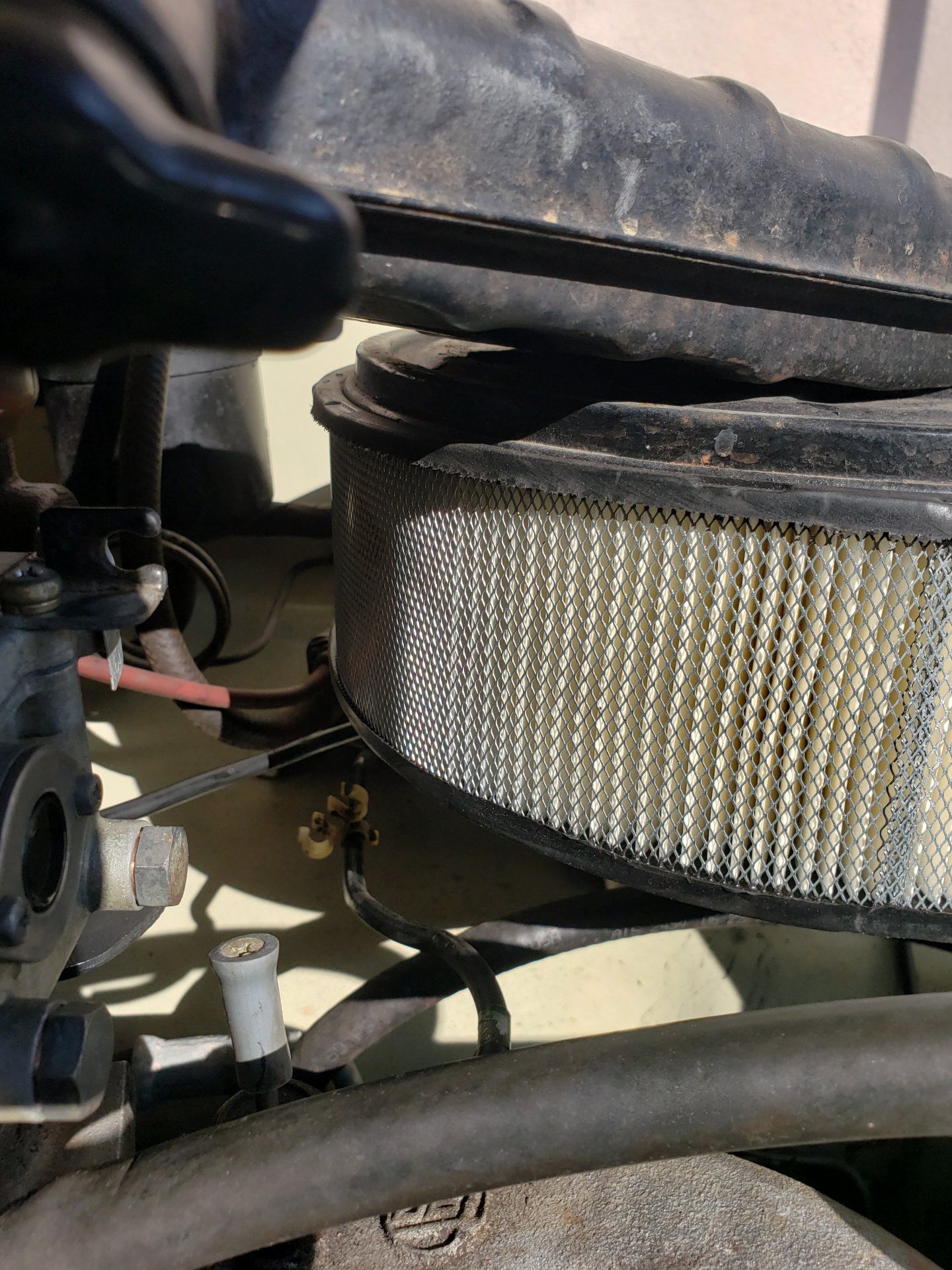

As for the VSV and vacuum stuff, I ordered the FSM on emmissions from SOR so I can test things out. That said I found a thread in the 40 section that pretty much shows the proper hose routing (see below). I tried it and it ran like crap. Hesitates and isn't smooth. I pulled them off, capped the one to the intake, and ran one hose from the carb base to the diaphragm and it runs great. I realize this pulls the lever so it pretty much always has the throttle closed (got that from another thread, not 100% sure what's happening with the diaphragm vacuum line, but I can see it's engaged and pulled closed).
If this setup seems OK to everyone, I think my next move will be to direct the charcoal canister directly into the air cleaner assembly. I do want that system to be functional if at all possible. The bonus of this will be that I can remove the VSV all together which I think gives me enough room to put the stock air cleaner bottom assembly back in there (removed because it doesn't fit with the power steering conversion).
