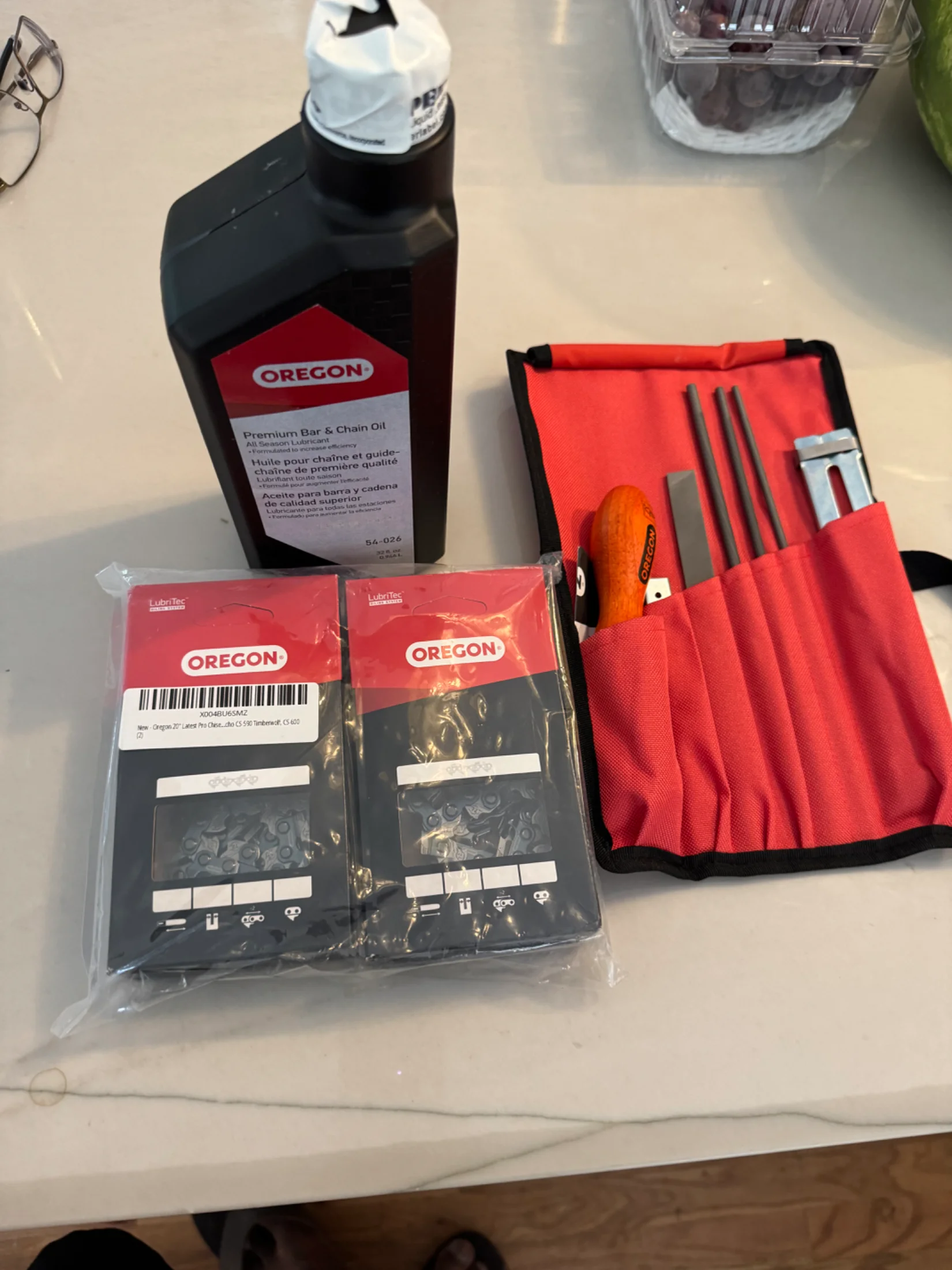

Have me a Echo CS590 20” bar. Its been great!!! Lots of low end grunt. Chain kept loosening. Checked the sprocket, no wear. Checked specs on bar. Should have 70 drive links. Chain on it was 72 DL. Came that way. Got some chains. Pro series, full chisel. Also got me some bar oil and some hand chain sharpeners. Old school sharpeners is where its at. Got to see it true up.

Yep. Got the depth setter for the raker filing. Got flat file as well. Figuring out its not oiling. No oil streak on cardboard at full throttle and oiler screw wide open. Need to dig into this.

Oh I know. Thats an amazing saw. Pretty penny too. I dont do that much to warrant a MS400. Did figure out the oiling issue. Bar hole where oil feeds was clogged. My cs590 has less than 10 hours on it! Nothing like seeing a freshly honed kerf on the chisel. Hand sharpening it is for me. The Oregon full chisel pro chains eat!!!!

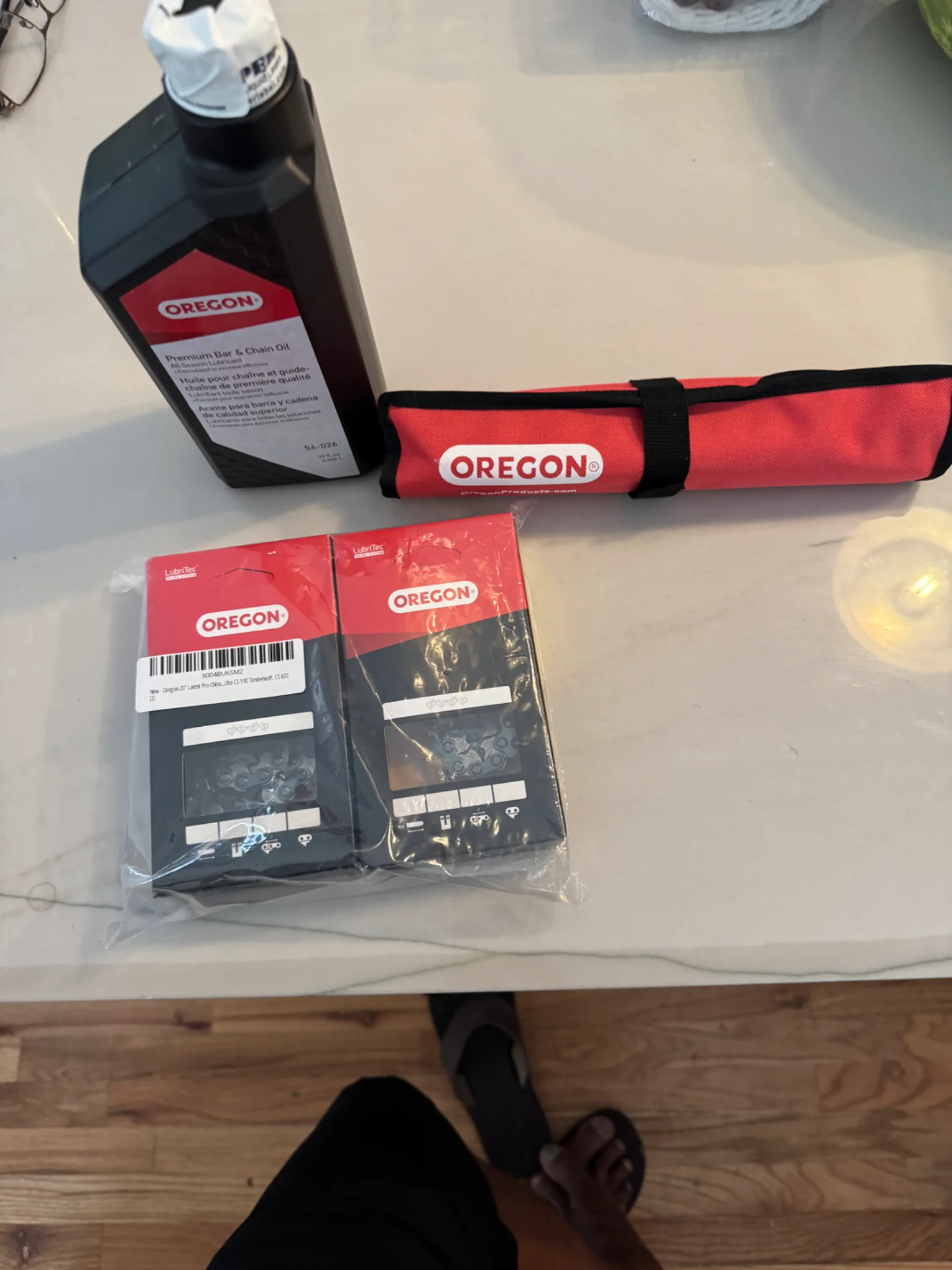

This is what I got. Works on any bar. I used my timberwolf bar. Your bar should have specs etched on it. Match Oregon chain to it. It cuts like budda!!! After you put it on the right direction🙄.
