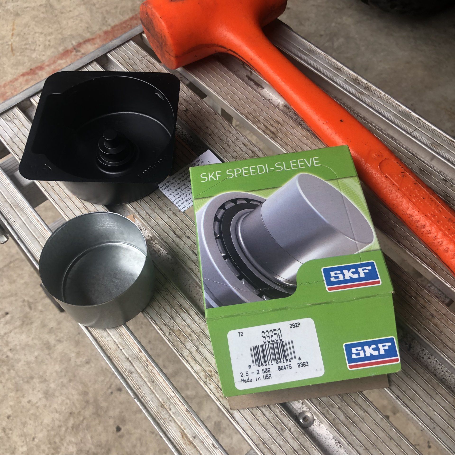

Napa will have the Speedi Sleeve later today. Since it works with my seal and I’ve read good reviews and talked to some buddies I going to go there first. The loctite 545 will be here later today for the seal install into timing cover.
Got my elk rack back from our taxidermist. Makes a great hood ornament.:rofl:

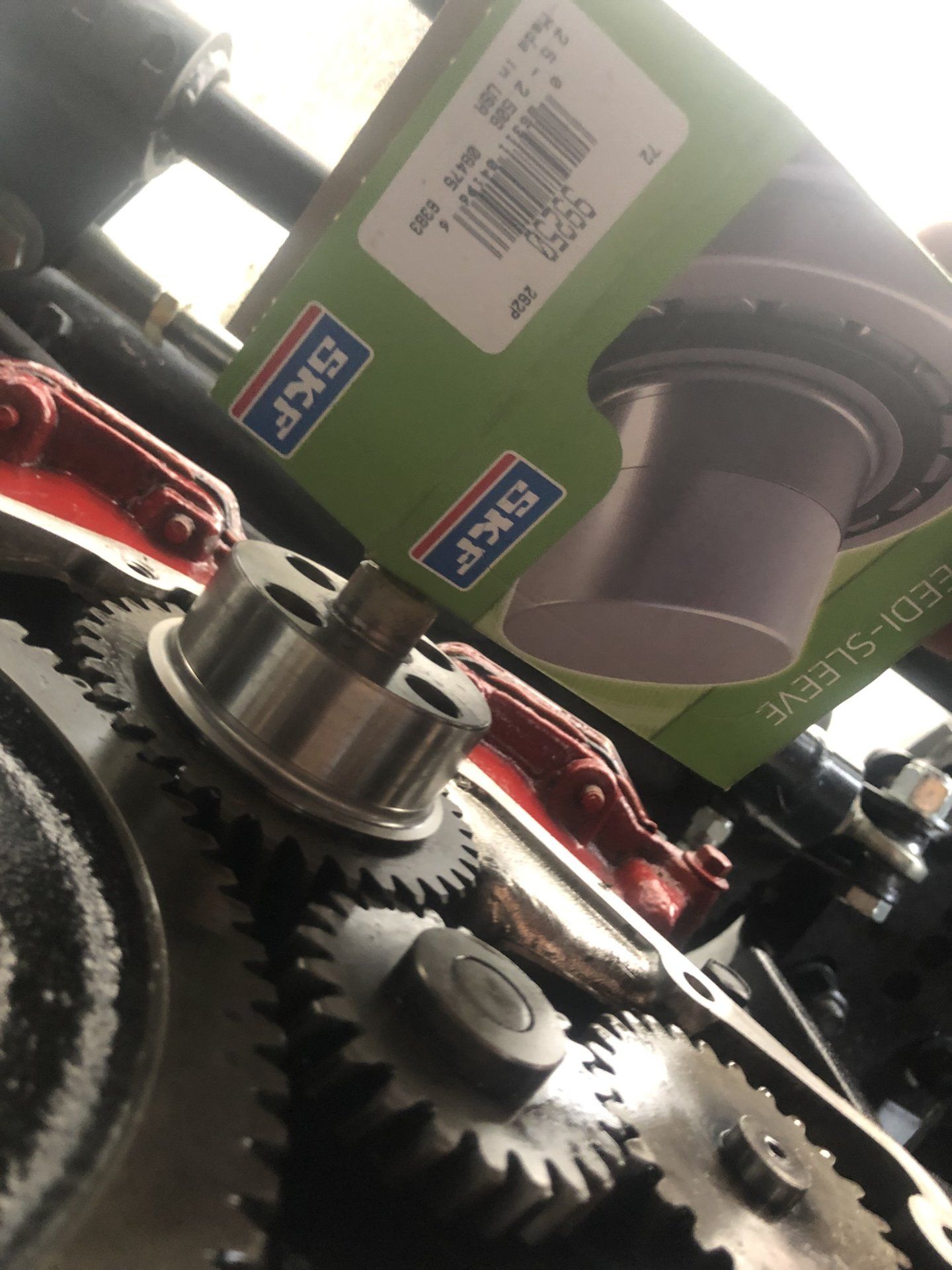

Napa has the Speedi Sleeve in so I decided to go this route because I could use my new seal and also good reviews. SKF #99250
Slipped on nose of crank and used dead blow to slowly tap the sleeve on with the install tool. Went on with ease.

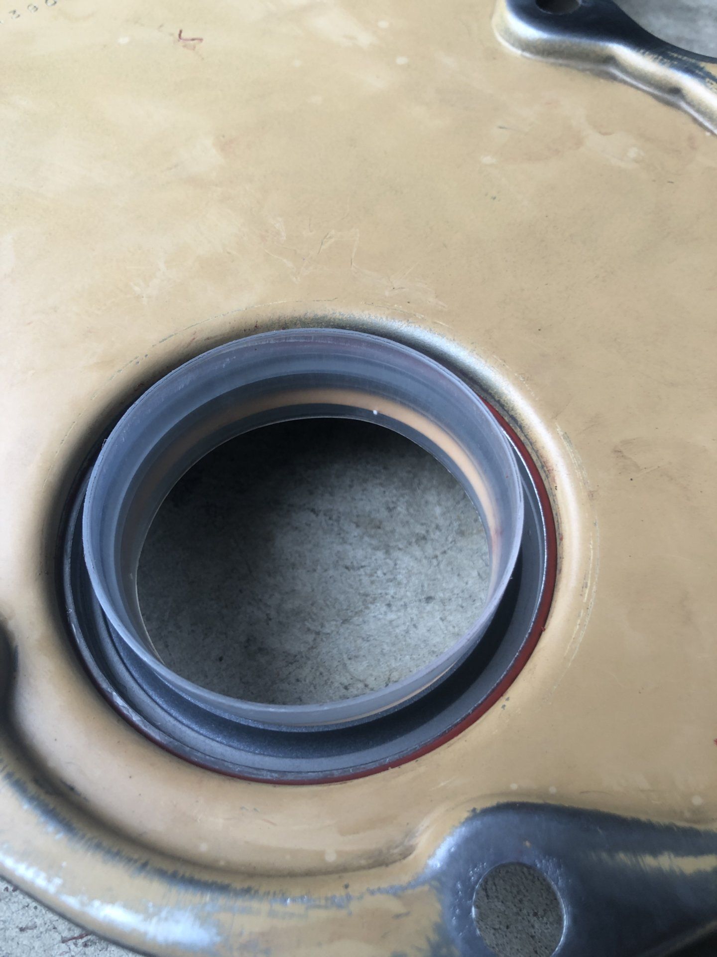

Got the front crank seal installed in the front timing cover.
Seated view from the front side
From the oil side

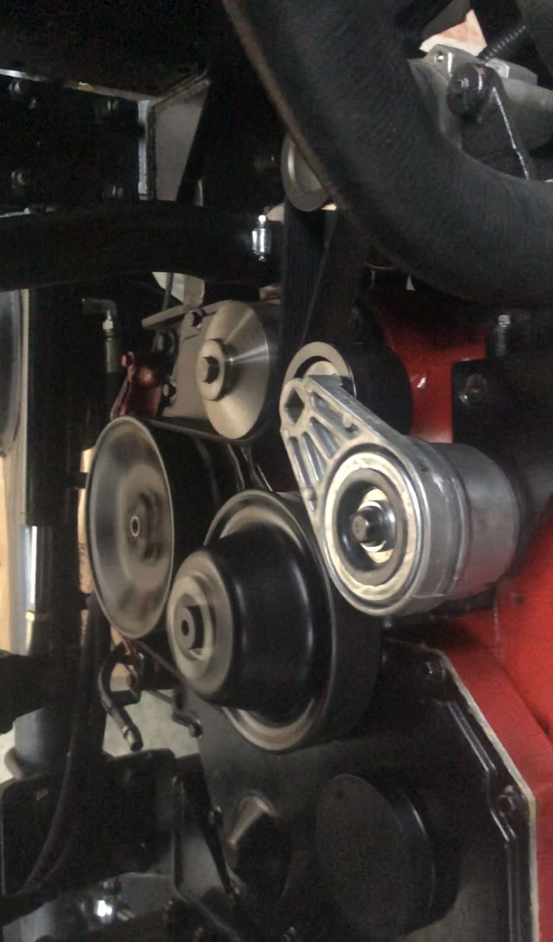

Got the timing cover installed and finished bolting it all up. Installed the belt and started it up. Ran motor at idle about 15 minutes til the oil pan got hot and saw no leaks.

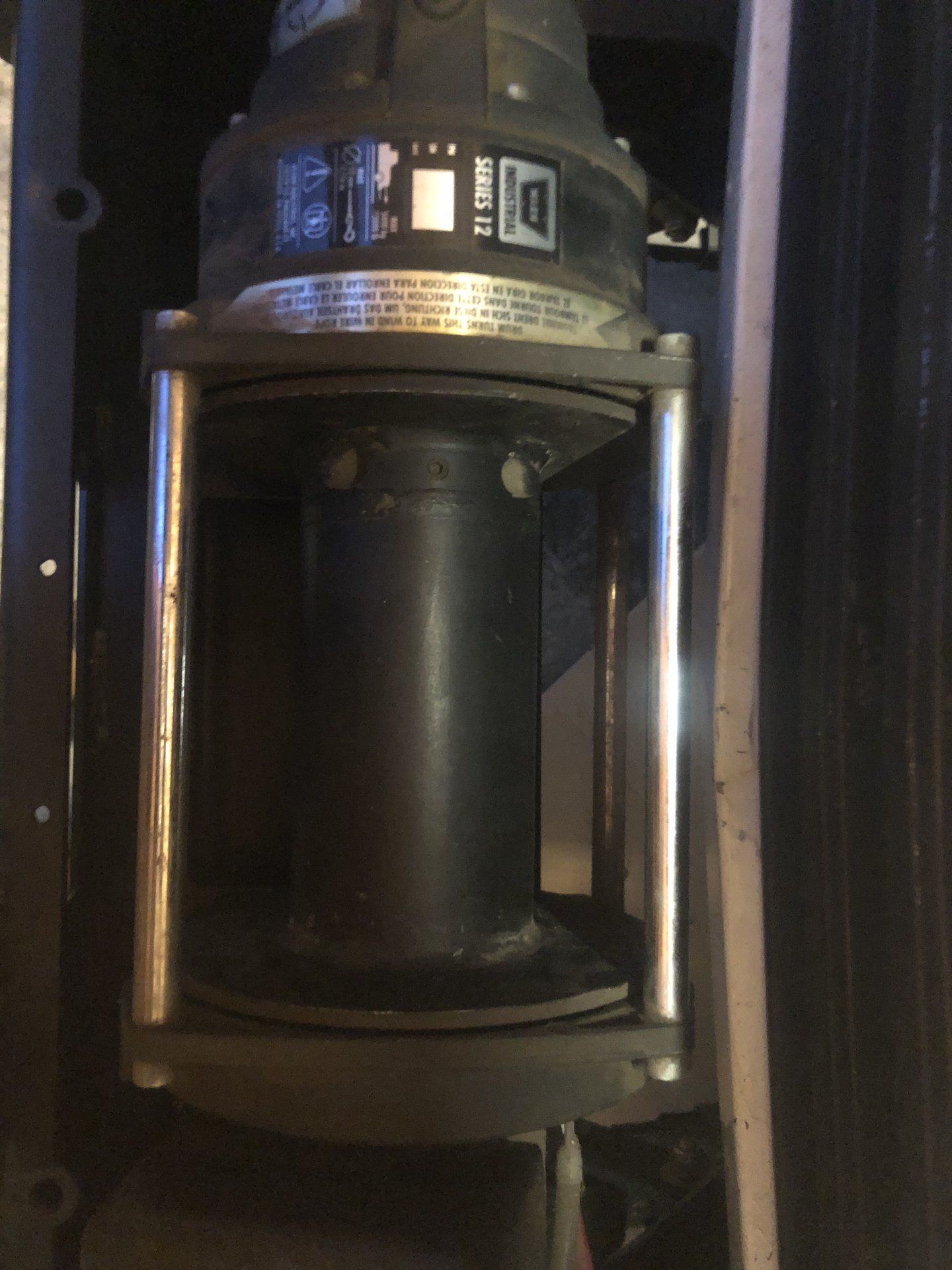

Now for fun I decided to try figment of the WARN series 12 winch on the 4 plus.

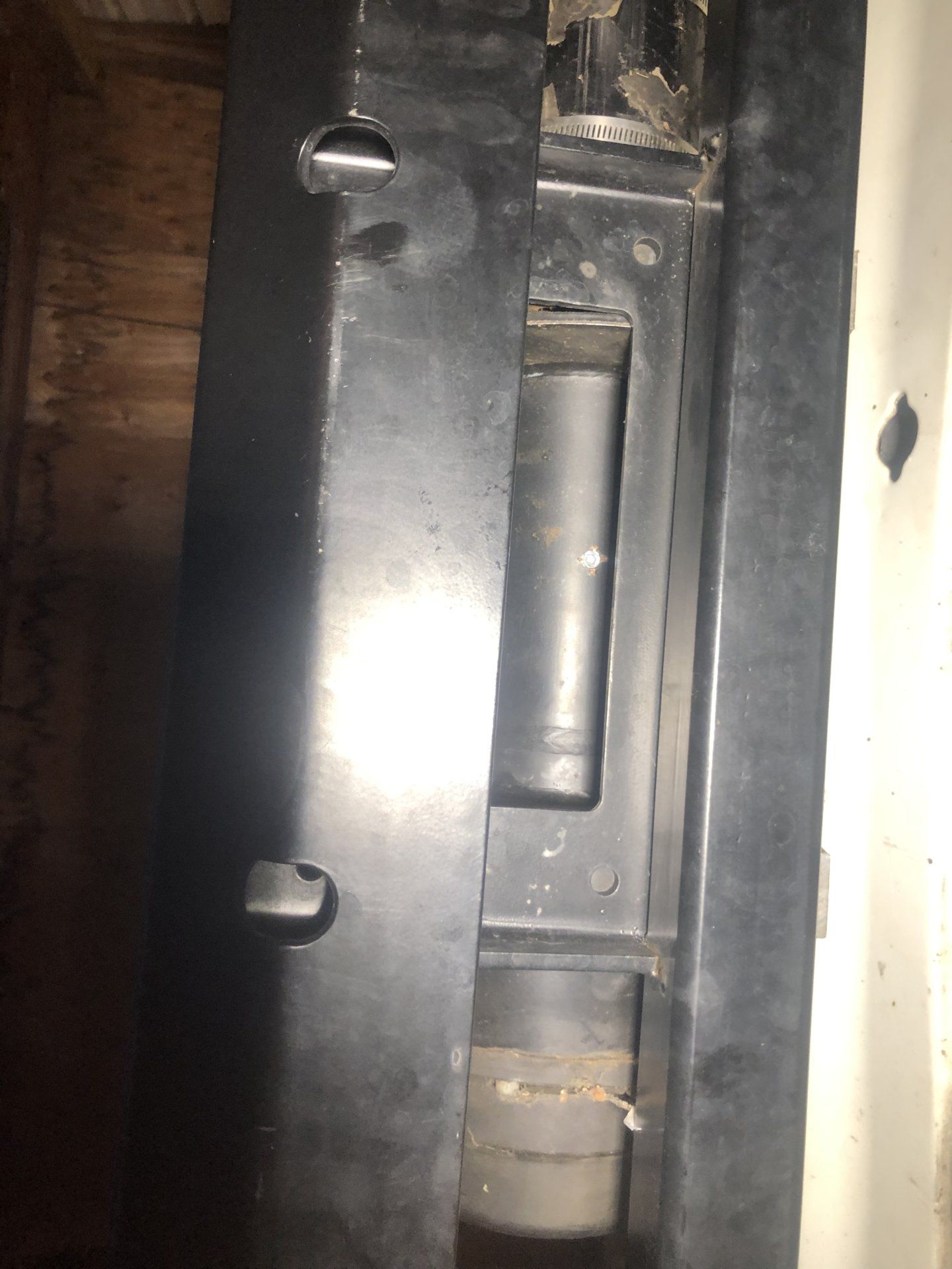

It doesn’t have enough room when the 4 plus is pushed back far enough for the bolt holes to line up.
Moved it forward and there is room.
This winch is a beast.
I think I need to weld extensions on the 4plus to allow it to go further forward and allow the 8 bolts to attach it to the 60 frame.

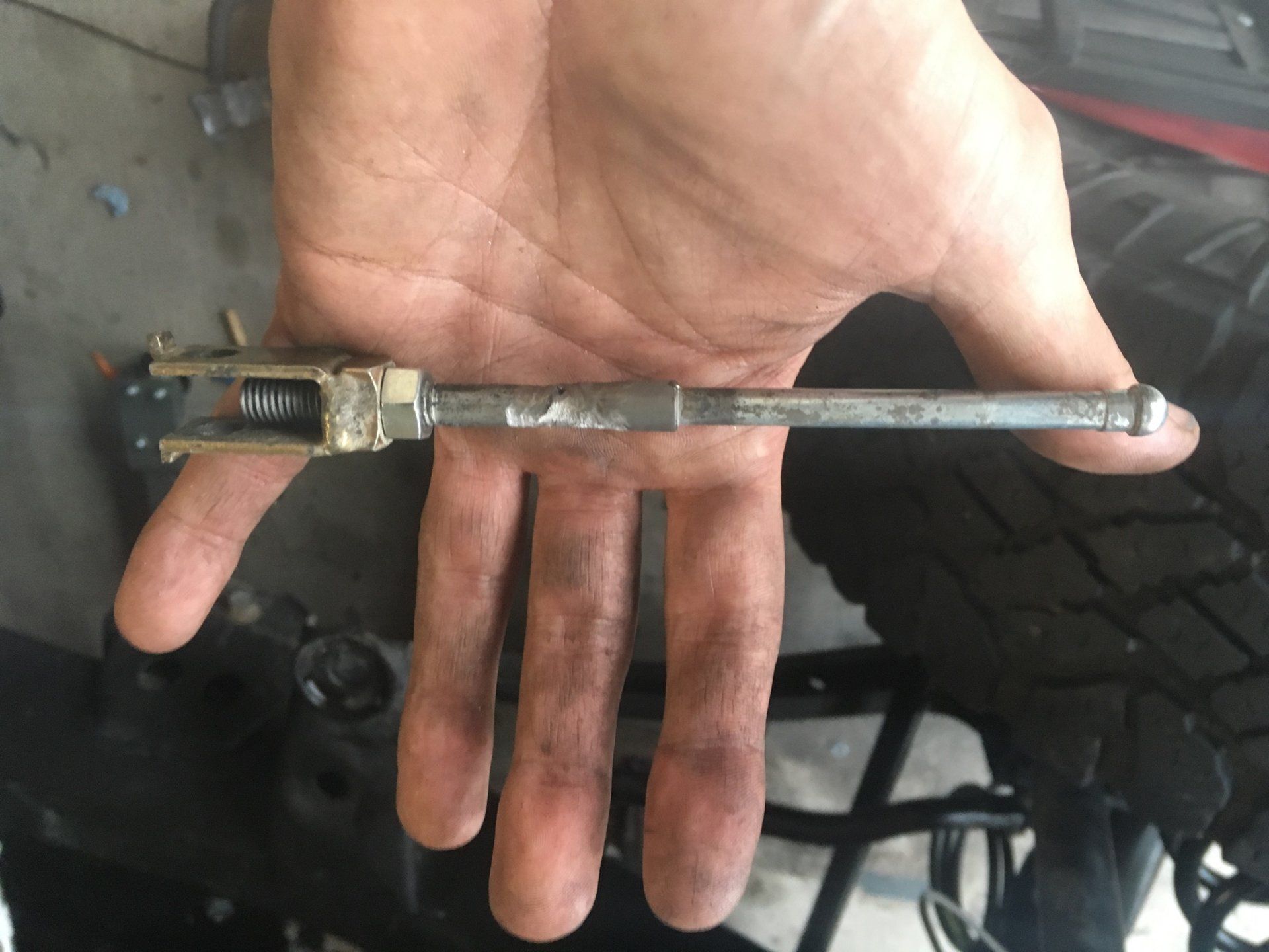

I ended up cutting the Dodge push rod and welding it to a bolt so I could mount it Toyota style and adjust it. I won’t be able to do any adjustments until I have it running. I did add some length to the rod.

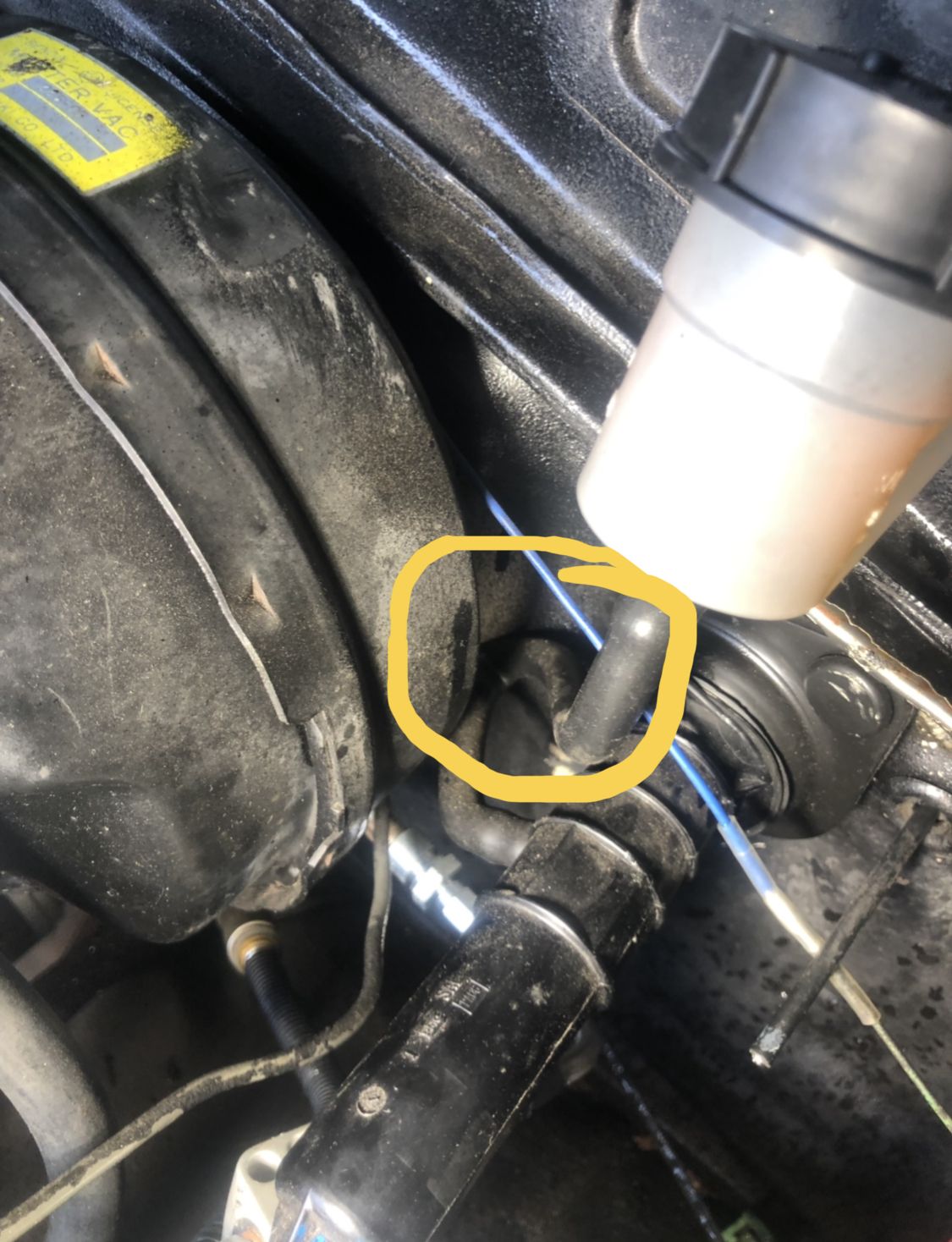

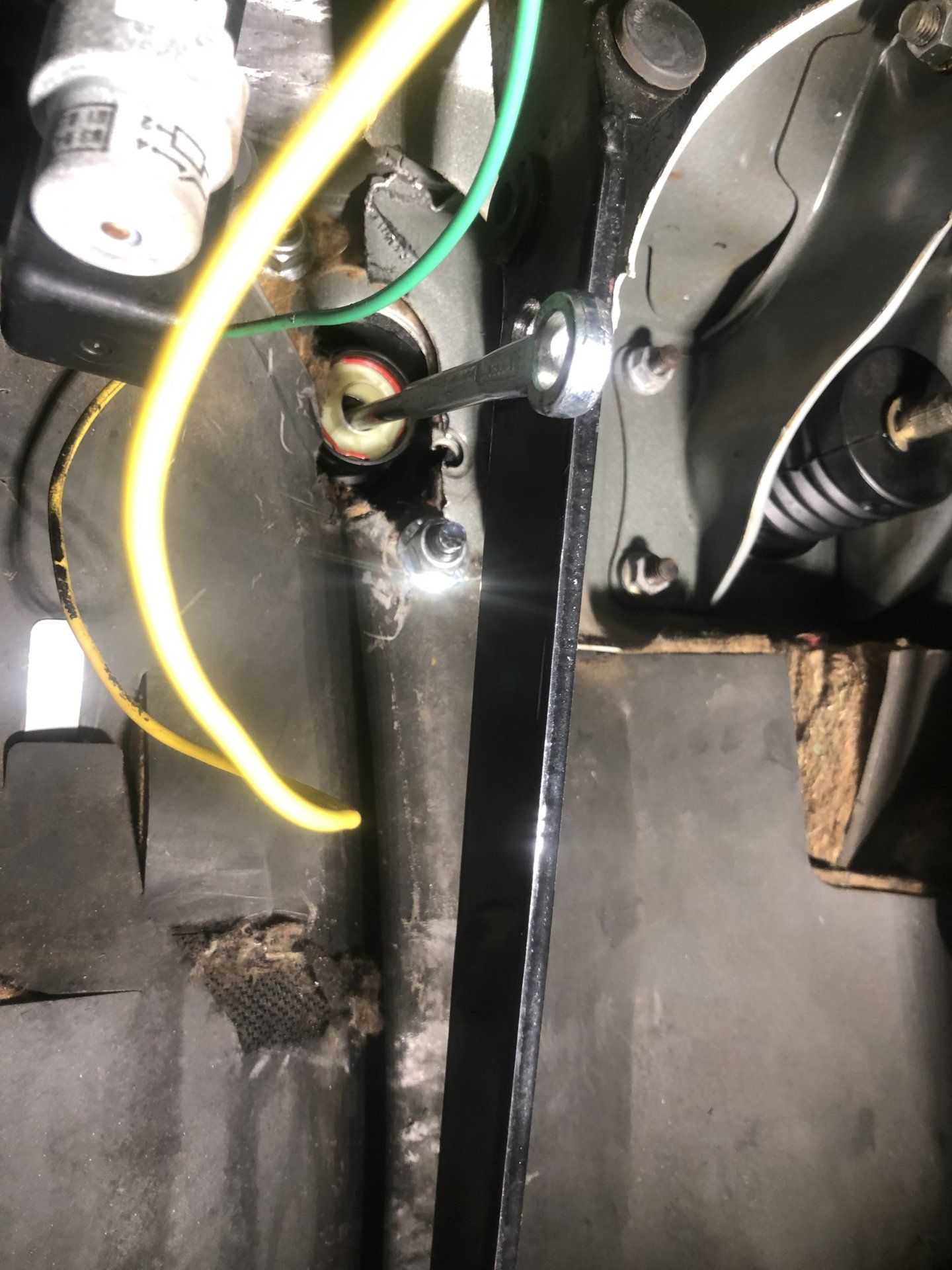

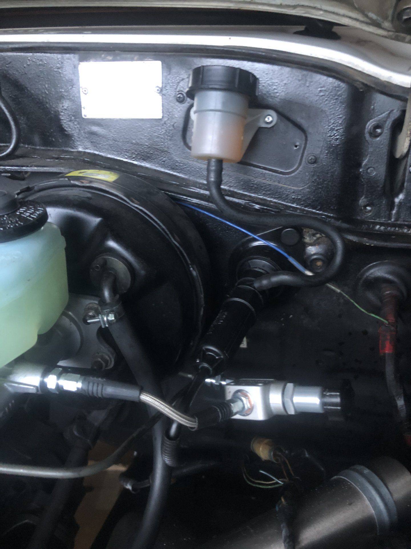

Working on the clutch master cylinder I noticed a kink in the line between the master cylinder and the reservoir.
I rotated the master cylinder and while doing that found that it was hitting against metal one one corner of the fire wall. Cut the opening larger with sawsall.
Reinstalled the master cylinder with the hose supply to reservoir now going up.
Took it for another drive and the clutch felt a lot more solid. Got on the highway and it drove really nice. Pulled back up to our gate and waited for it to open and it went right into reverse. Pull around back and it still gave a little trouble getting in reverse.
