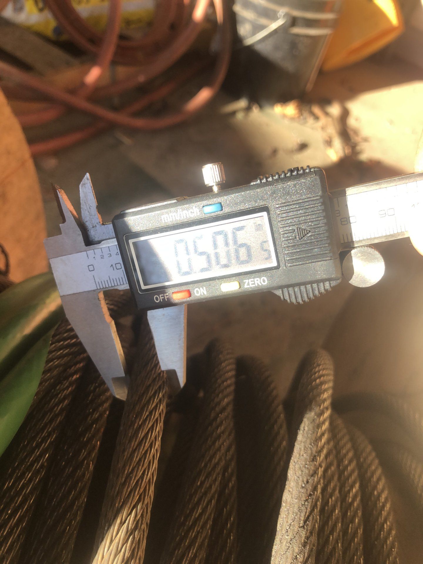

Will 1/2” cable work on the series 12 WARN? I have a large spool of it from our pump hoist.
Waaaay too big. Steel cable is already heavy enough. Steel winch cables are normally 3/8". Get some synthetic and loose 80 lbs off the front of the truck.
3/8” is standard for the 12K WARN I’ve seen online. Just didn’t think a 1/8” would make much difference other than heavier and less room for cable on the drum. It’s free which you can’t beat.
I'm not saying it won't work. Just that it's way less then ideal. Plus you will probably loose a bunch of length that you'll be able to have spooled up.
It’s free but may not use it. I’ll see how it works.

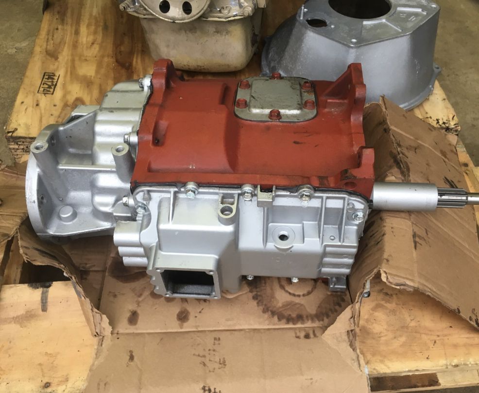

I saw some transmission fluid leaking at the top of shift tower riser below the shifter. Is that a gasket seal?
Do you have early or late top plate? Directions for my short shift kit calls for RTV for the seal between top plate and tower. Also on the bolts that hold it down.
My short shifter tower is blue. If you can unbolt the shifter and its square you have the newer top plate.

I've determined that every NV4500 has it's own unique quirks. My favorite was @GLTHFJ60 with the short shift kit. It was niiice. Also, mine has leaked a little bit from the shift tower before too.
