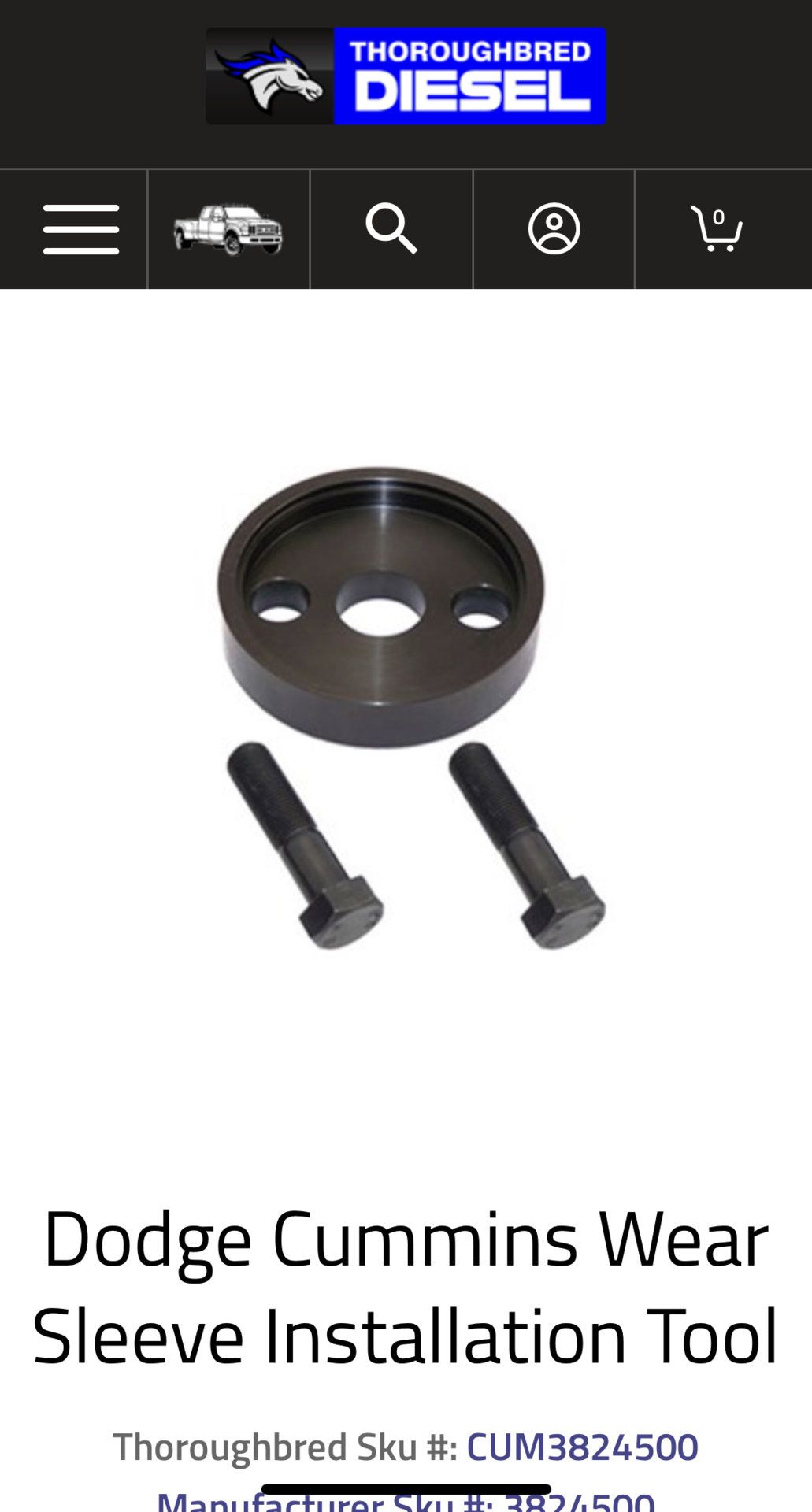

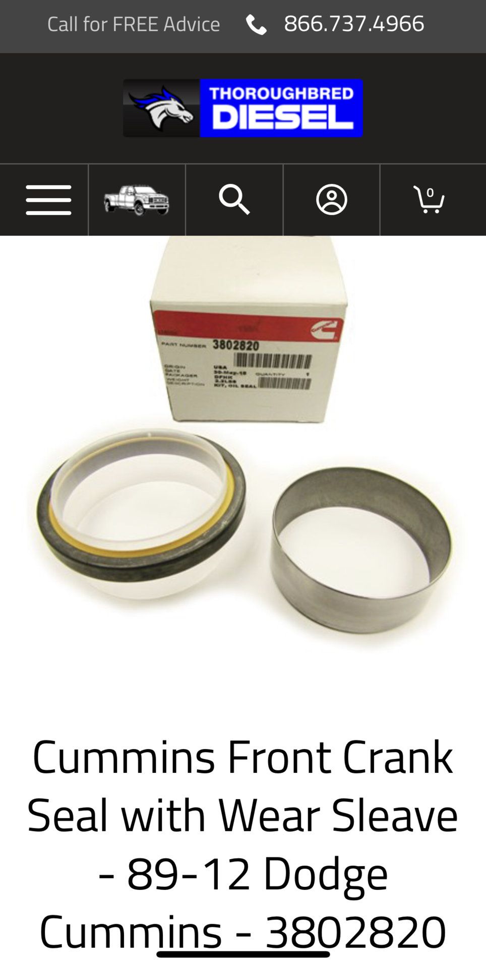

A buddy brought up Speedi Sleeve as an alternative to the Cummins wear sleeve.
It’s thin enough to utilize the stock seal and not need another seal with smaller ID for the thicker wear sleeve.
