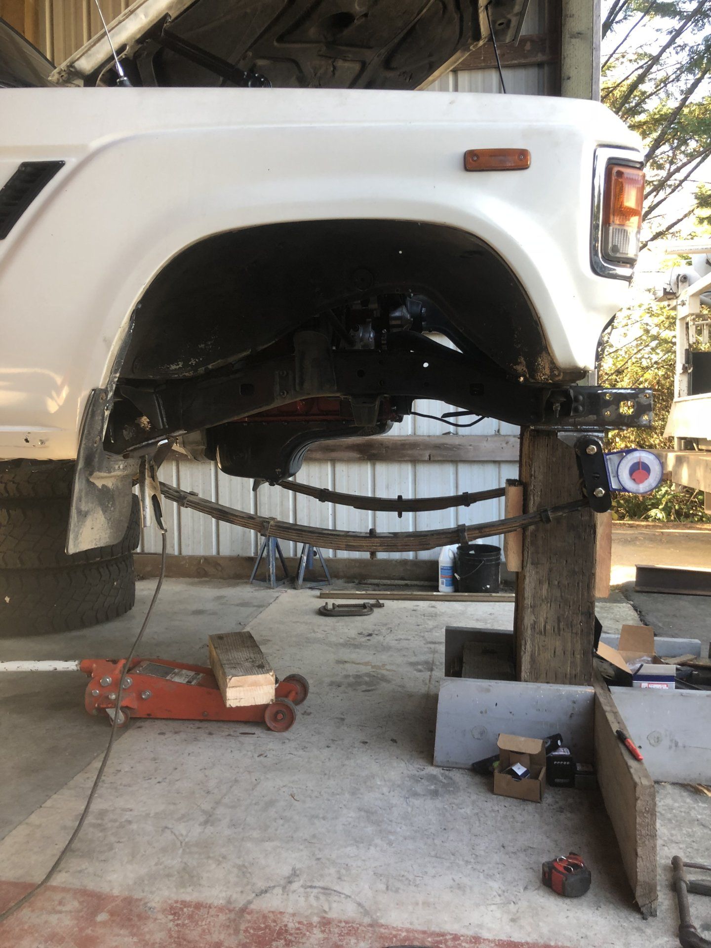

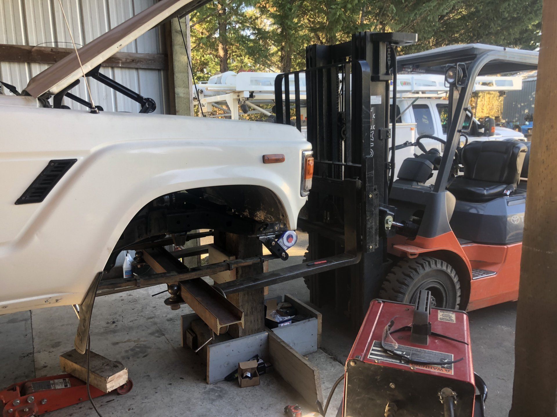

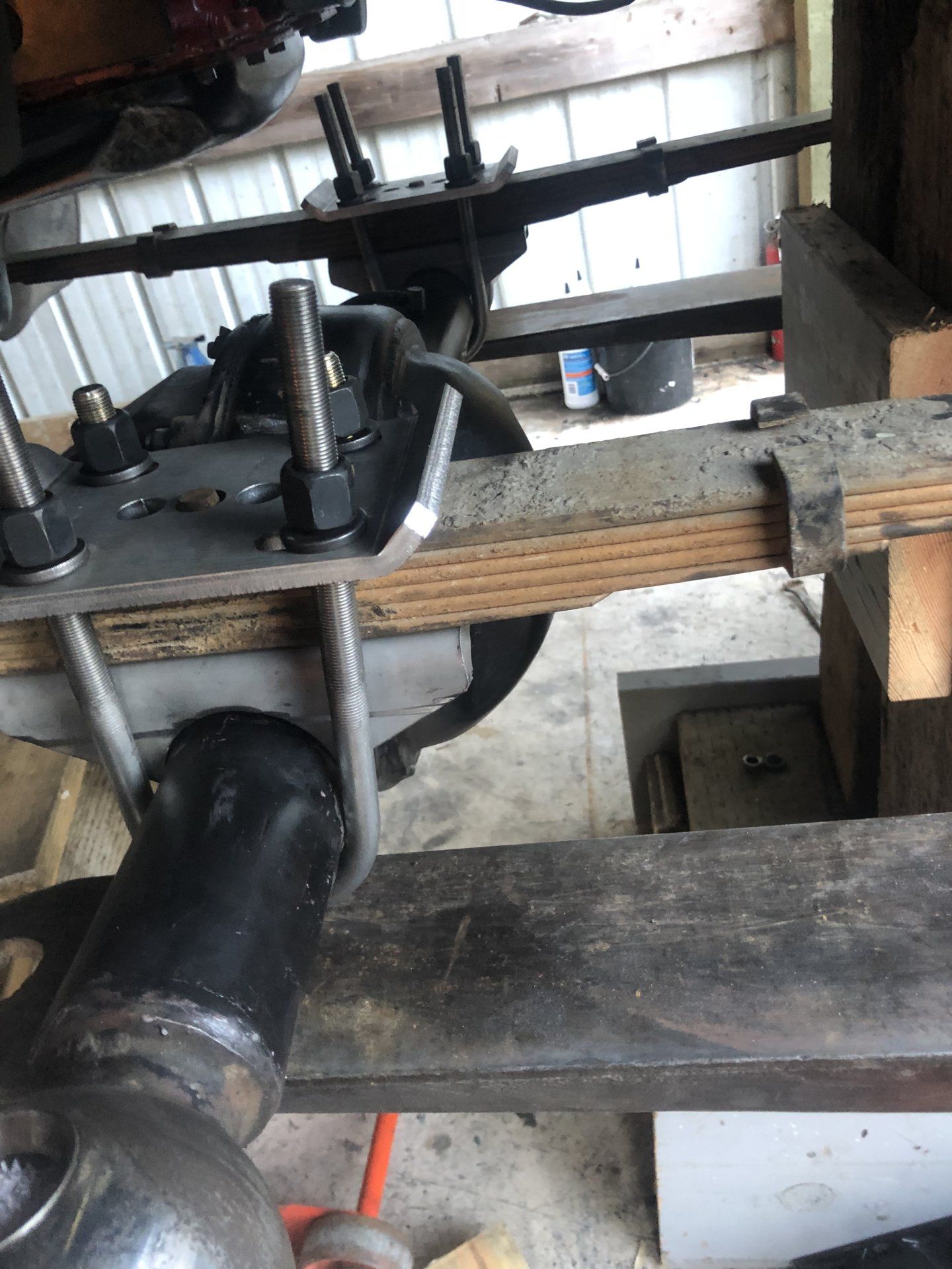

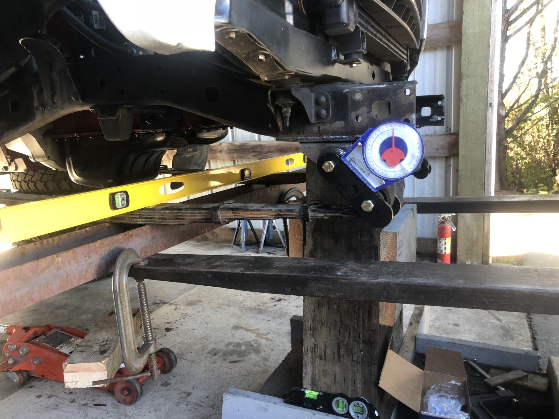

About 10 hours of non stop work on the front axle today.
Used the I-beam and forklift to get the weight of cruiser on the springs.
Shackle angle at ride height ended up being 41 degrees.
Finally the installation of the Ruff Stuff Kit. Axle placement is 1-1/2” forward from stock.
Mocking everything up and figuring out pinion angle.

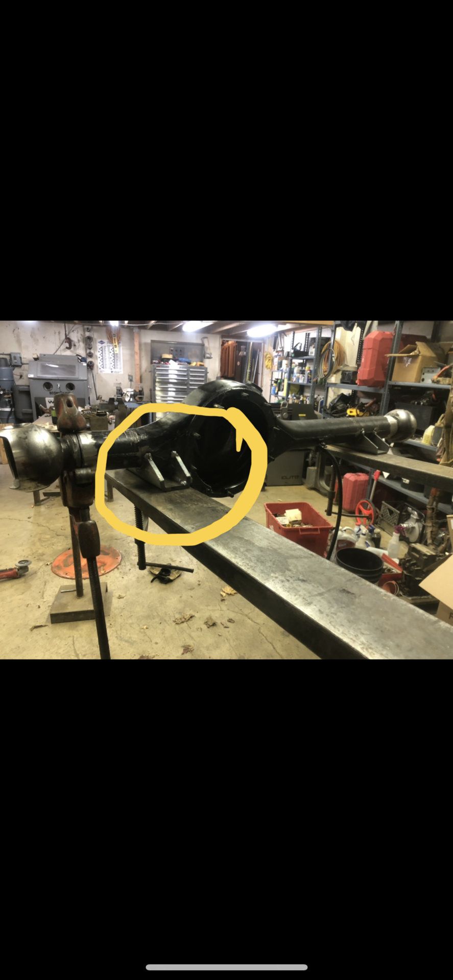

Tack welded the brackets to the axle.
Removed the axle and welded on the hardware.
We made good technical progress today and having that forklift to play with was awesome. It made getting ride height with the weight of the rig super easy and we were able to really drill down on what it was going to sit like. With the pinion angle set (will run a DC joint on the driveshaft) we had 2 degrees of caster. Since the axle was prepped we went ahead and cut 'n turned to 4.5 degrees of caster. I know it was only for 2 degrees more but running bigger meats, being taller, and Hojack's intended usage made the cut 'n turn worth it. It only added about an hour of extra work so it wasn't out of the way in the big picture of the time we're spending on it to do it right.
We did do a bit of grinding on the ruff stuff passenger perch to get it set where we wanted it but I think it turned out great. The 3rd member will need a slight shave to be able to slide the rear perch inner bolt into place from beneath.
Looking at the springs we want to put in a long AAL to give the pack a little more support. With plans to take the packs apart for cleaning and painting anyways it will be convenient to do. They turned out very flat at ride height.

As for that passesneger side spring bolt I just ground half of the bolt head off. I just completely tossed that thin piece they sent to go under the passenger spring perch, I was not impressed by that design.
I see you also have the same issue with the u-bolts as I did. Either Ruffstuff is sending the wrong bolts or they are bending them too small, I had to cut them all off and get 3.5” U-bolts
from a 1-ton axle and they fit perfectly.

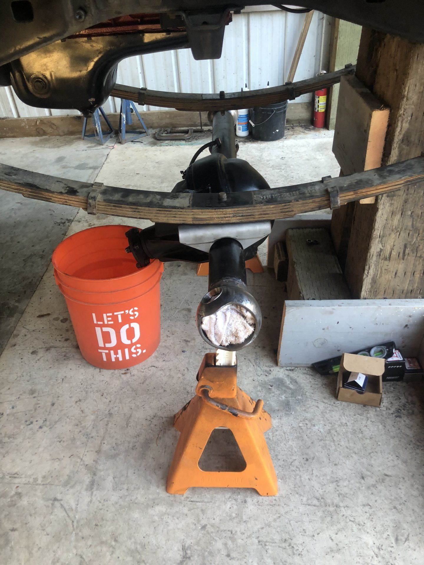

After tack welding the perches we removed the axle and welded both on the axle stands. Cut that plate in half. Used grinder to match the contour of the side of the pumpkin. I should have taken some pictures but evening was quickly approaching. I’ll take some when we pull the axle again for painting and installing the locker in 3rd member.
We had to also grind the axle for the U-bolts but they fit tight. I think Ruffstuff would rather have them too tight then too loose.

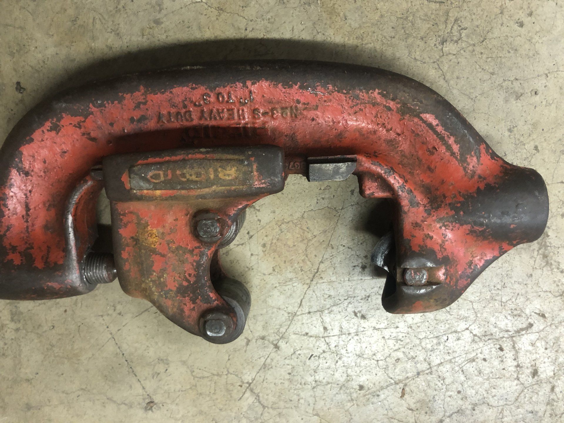

The cutter wheel broke just as it cut through the outer axle. Had to use angle grinder with cut off disc on the second cut. Both worked well. The blade on our Rigid pipe cutter is really old, plus the deeper the cut and it started to drift more toward the shoulder of the axle.
