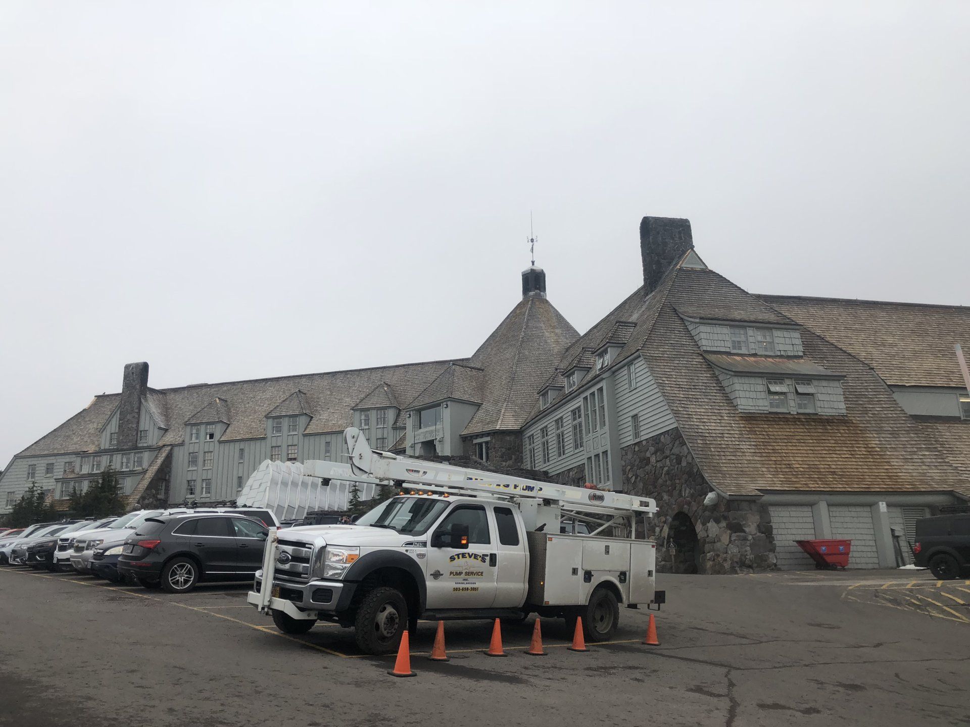

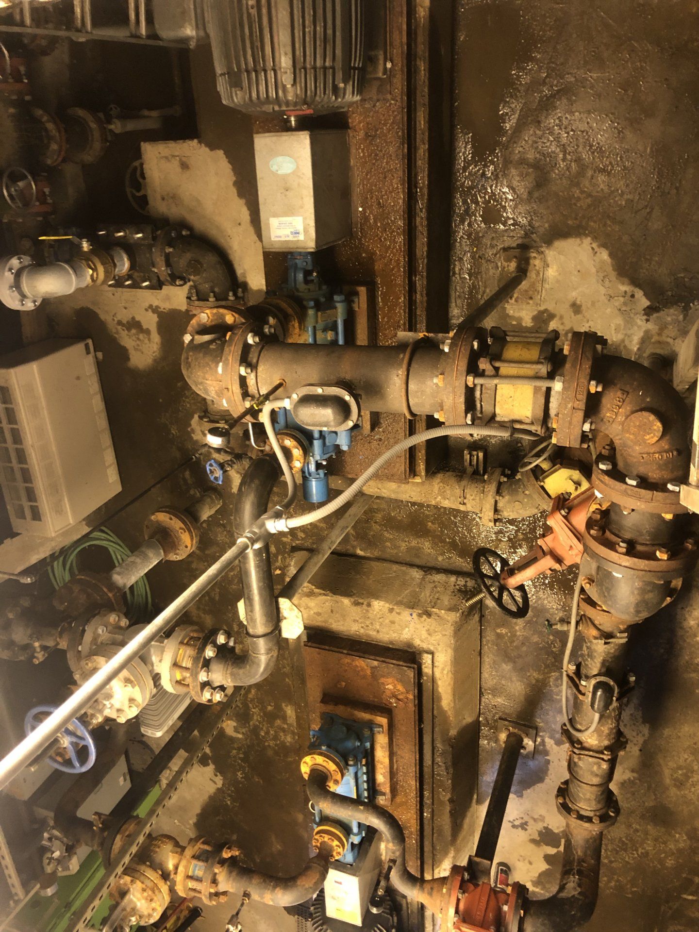

Today was finishing up on the booster pump for snowmaking operations for Timberline Lodge. The 2 big booster pumps are 100 HP and push the water about 1,000’ in elevation so it can gravity flow to the Lodge.
The static pressure on the gauge to the storage tank above the lodge. This gauge when the pumps are running is over 600 PSI.

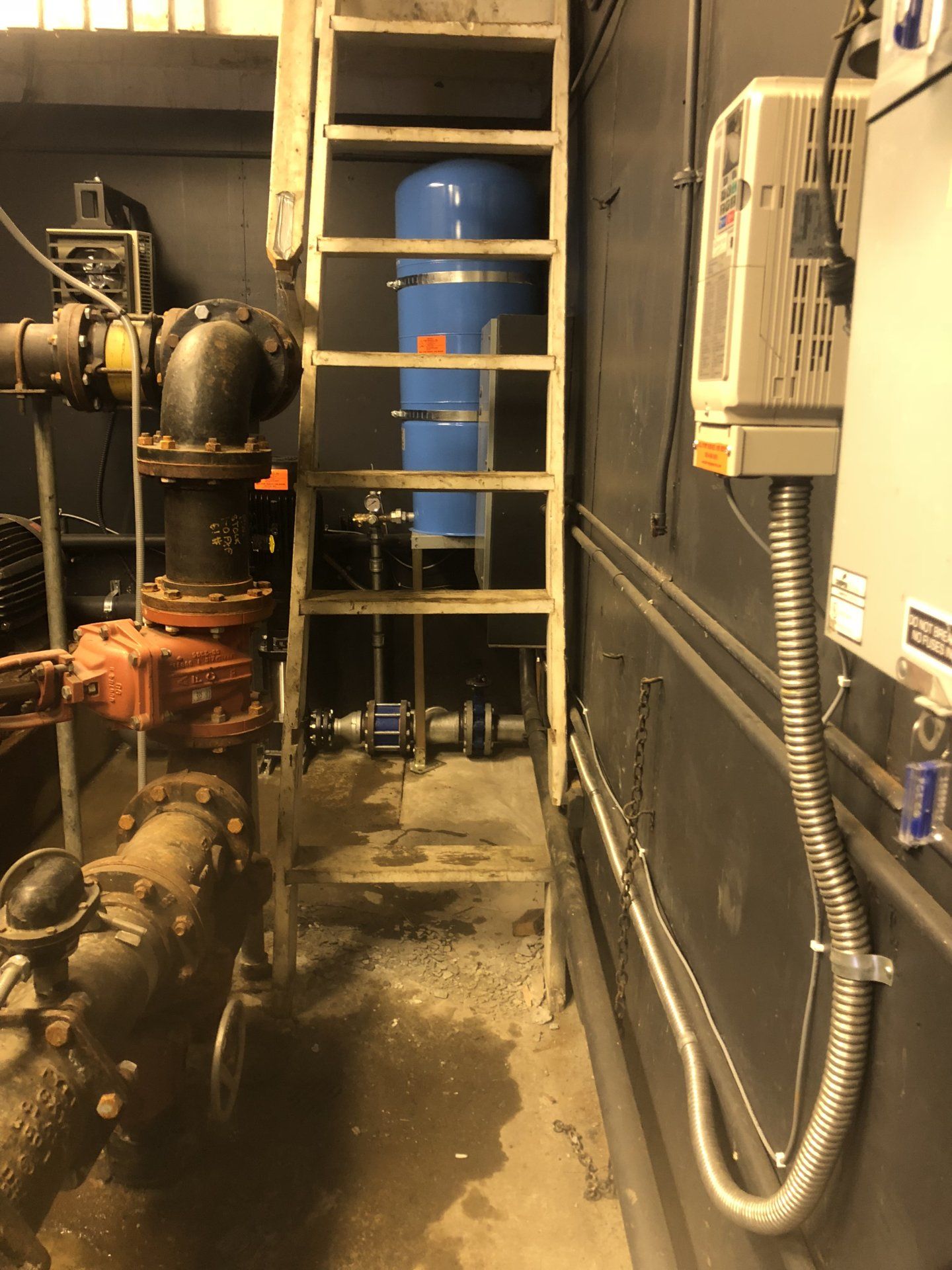

The new 15HP 460Volt 125GPM Grundfos Booster Pump. With Variable Frequency Drive ( VFD ) and pressure tank.
Not a lot of room to work. Had to squeeze through the stairs to work.

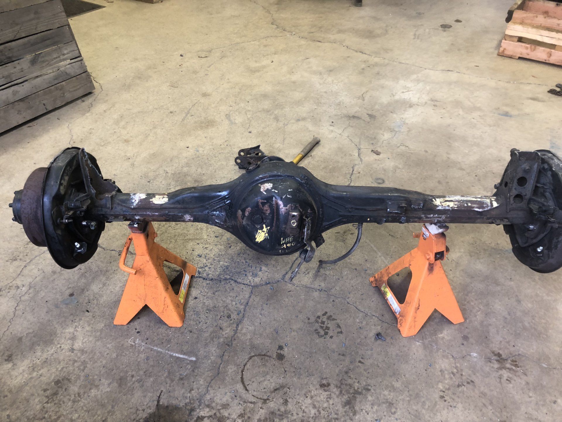

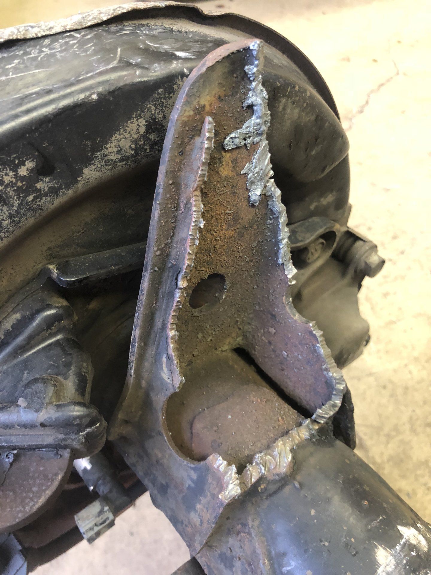

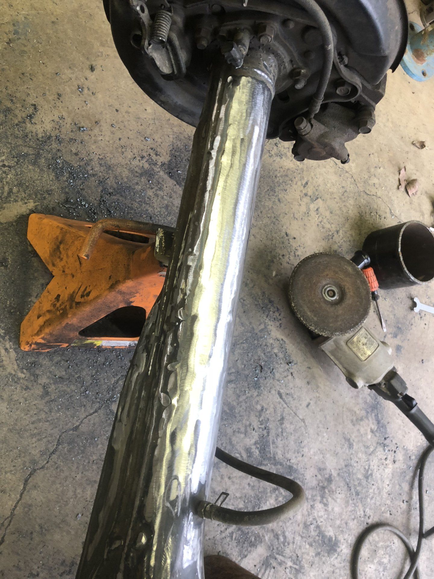

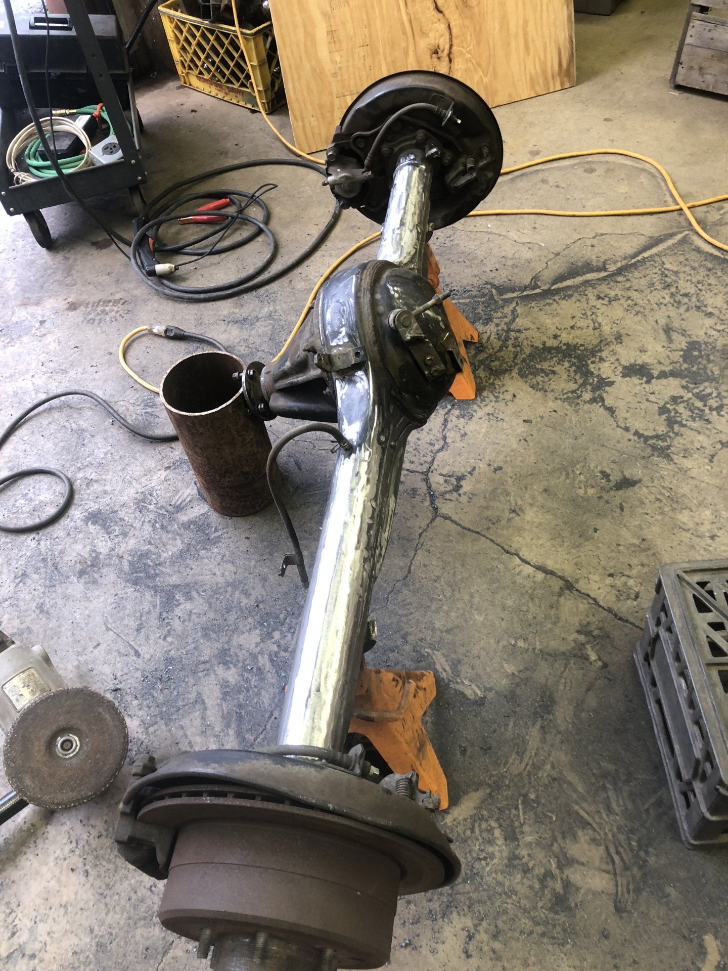

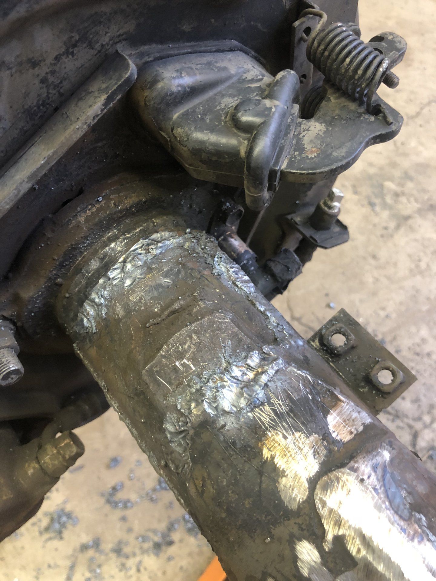

Got some time to finish the 80s rear axle tear down. I’m working on the brackets at the ends of the axle. How did you cut yours off? I’ve been using the Plasma cutter.
2” is what you need.
