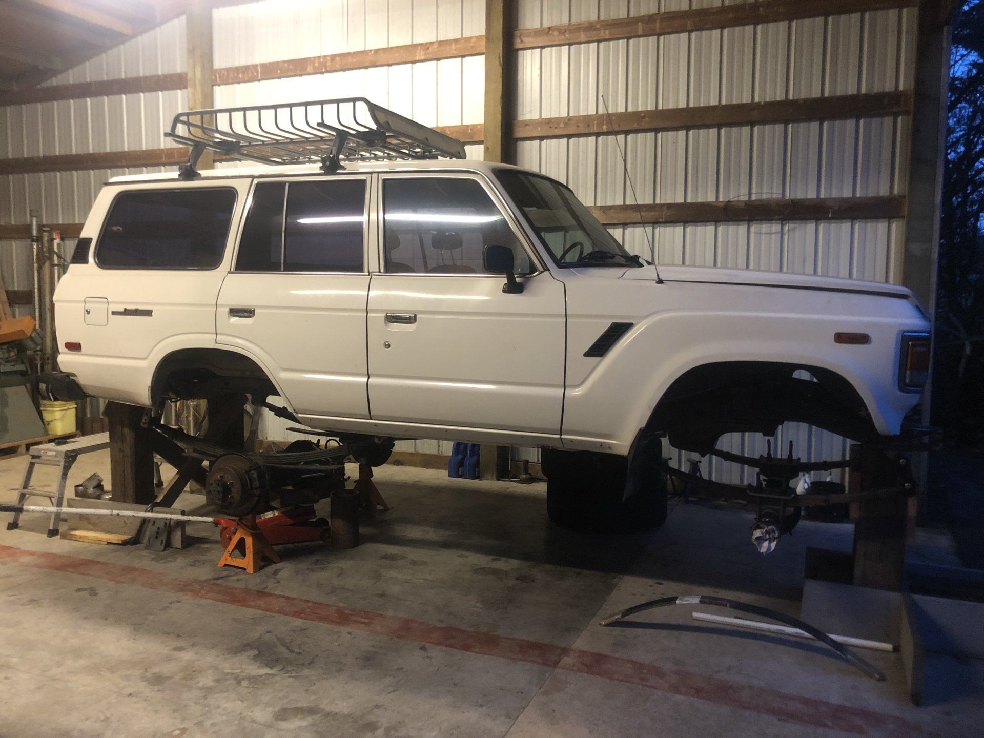

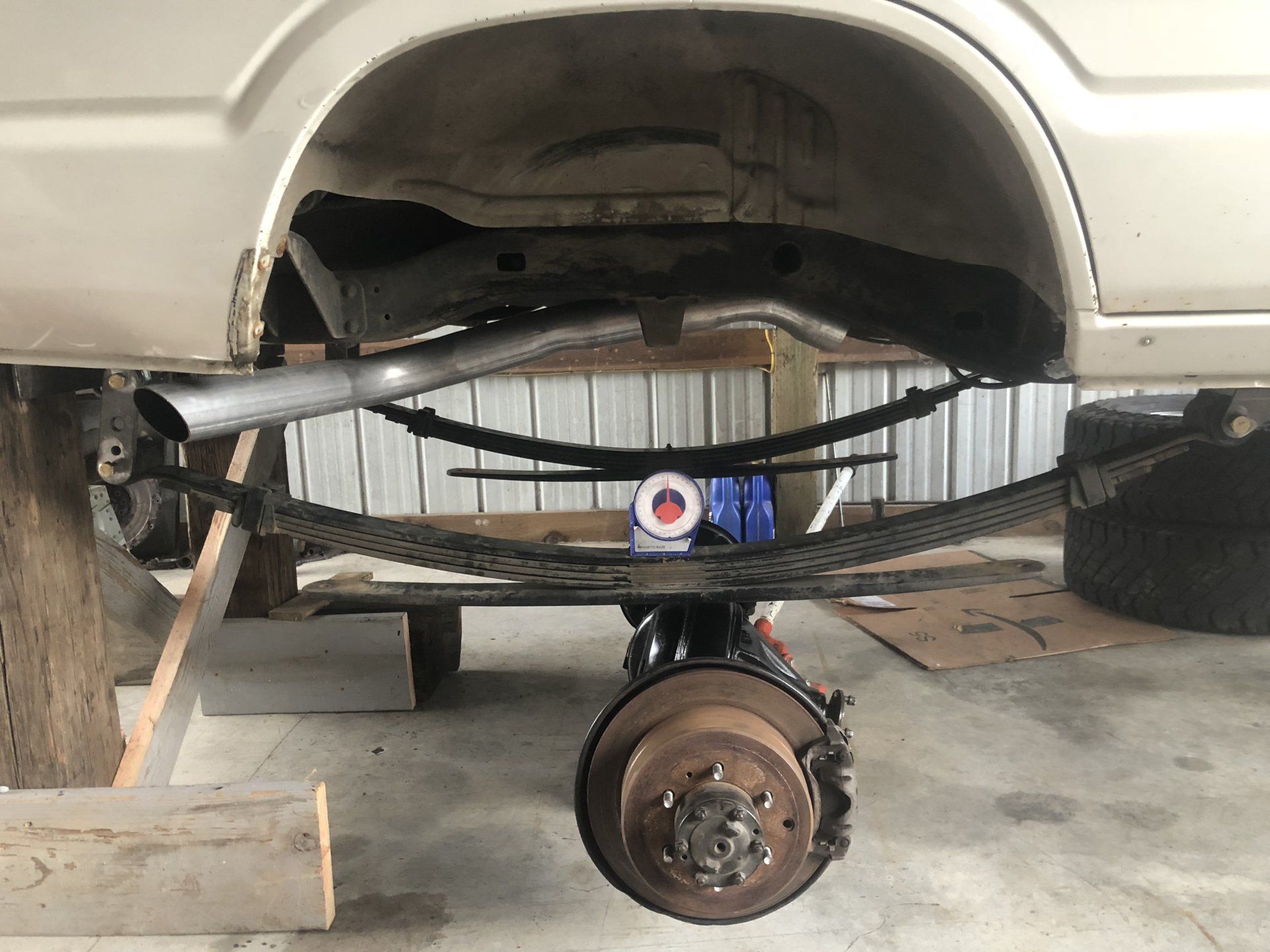

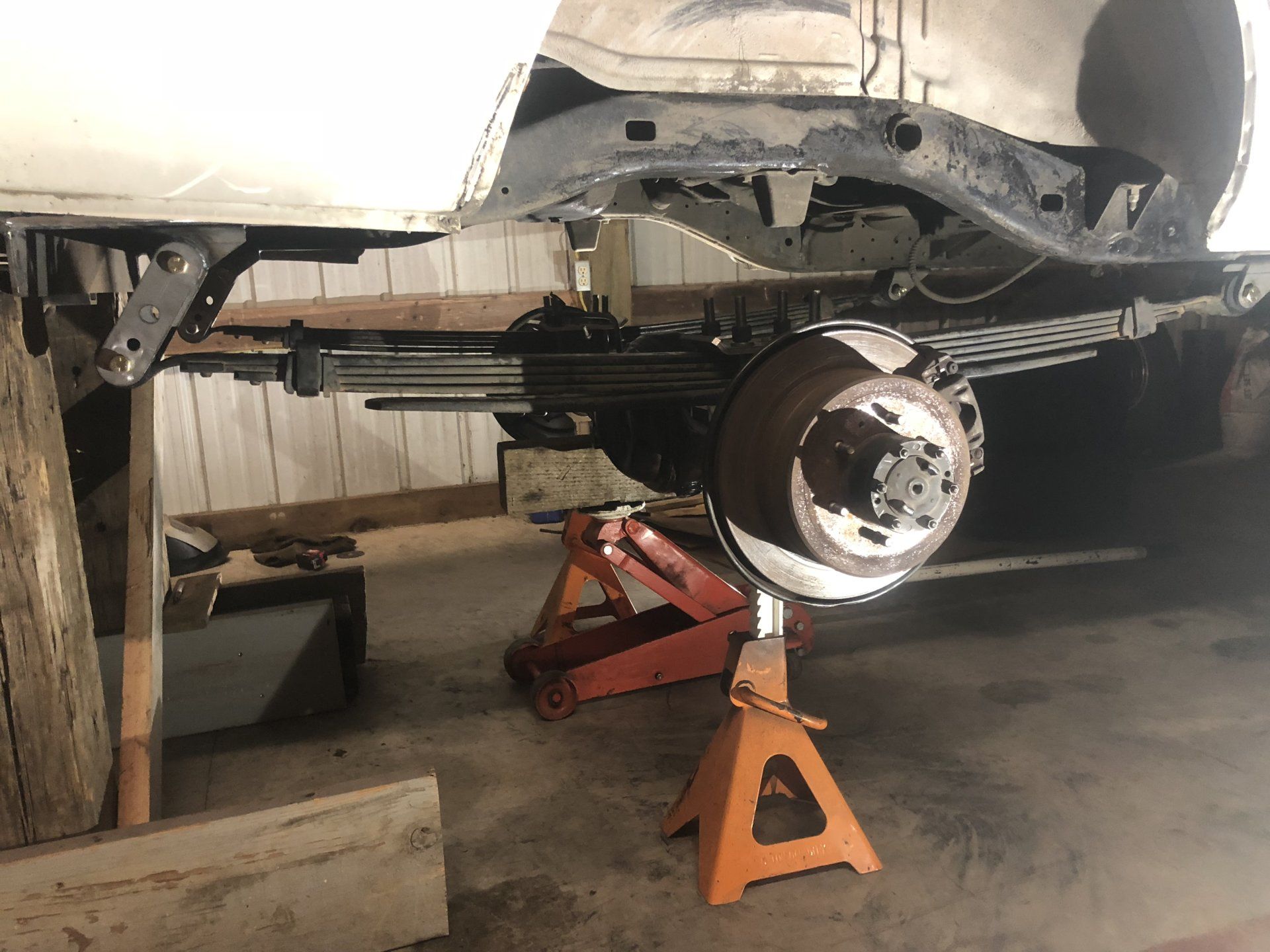

Today was installation day of the rear Chevy 63 springs and the FJ80s axle. These welding magnets I picked up for work are great.

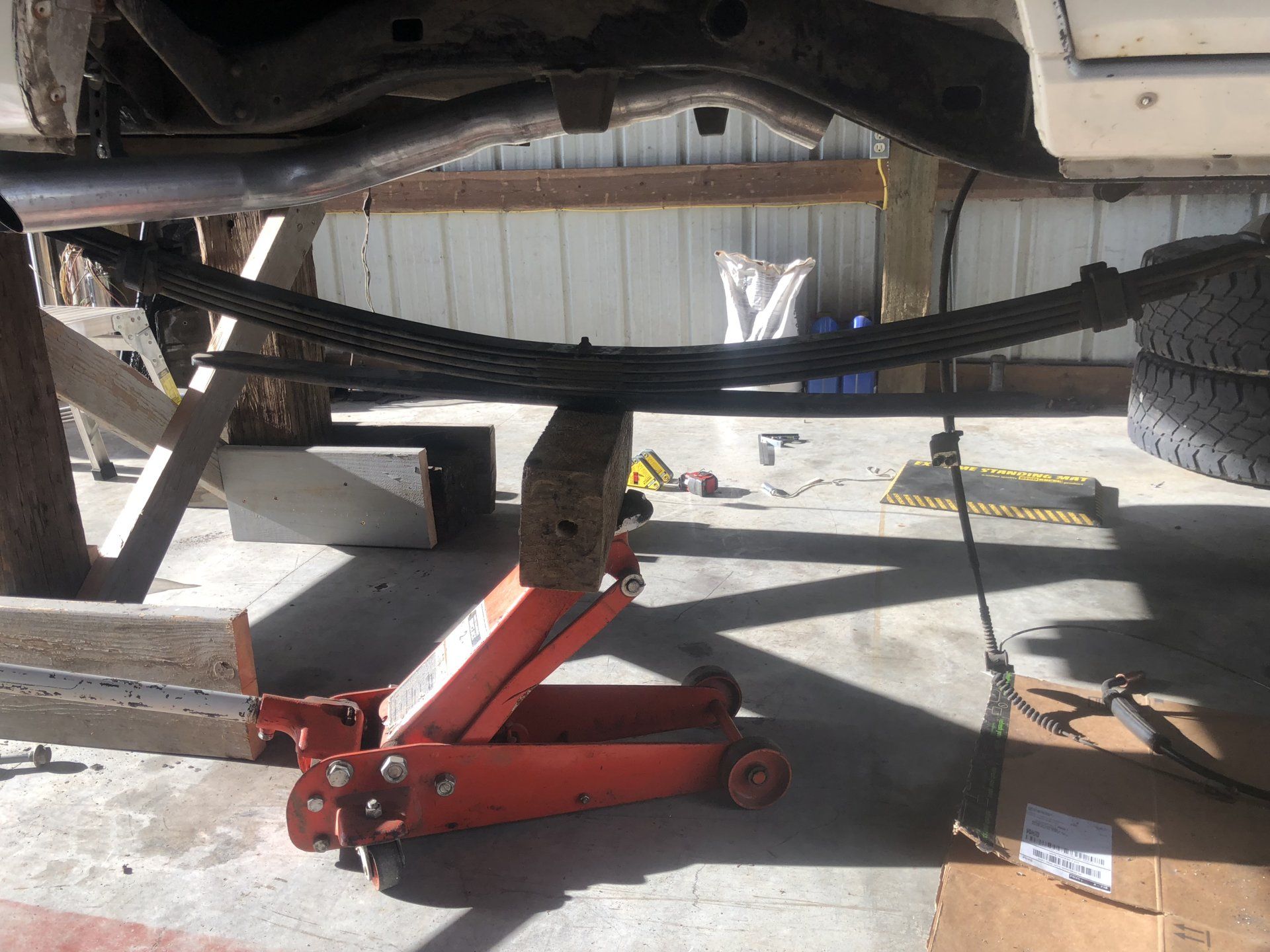

Working on the rear shackle angle.

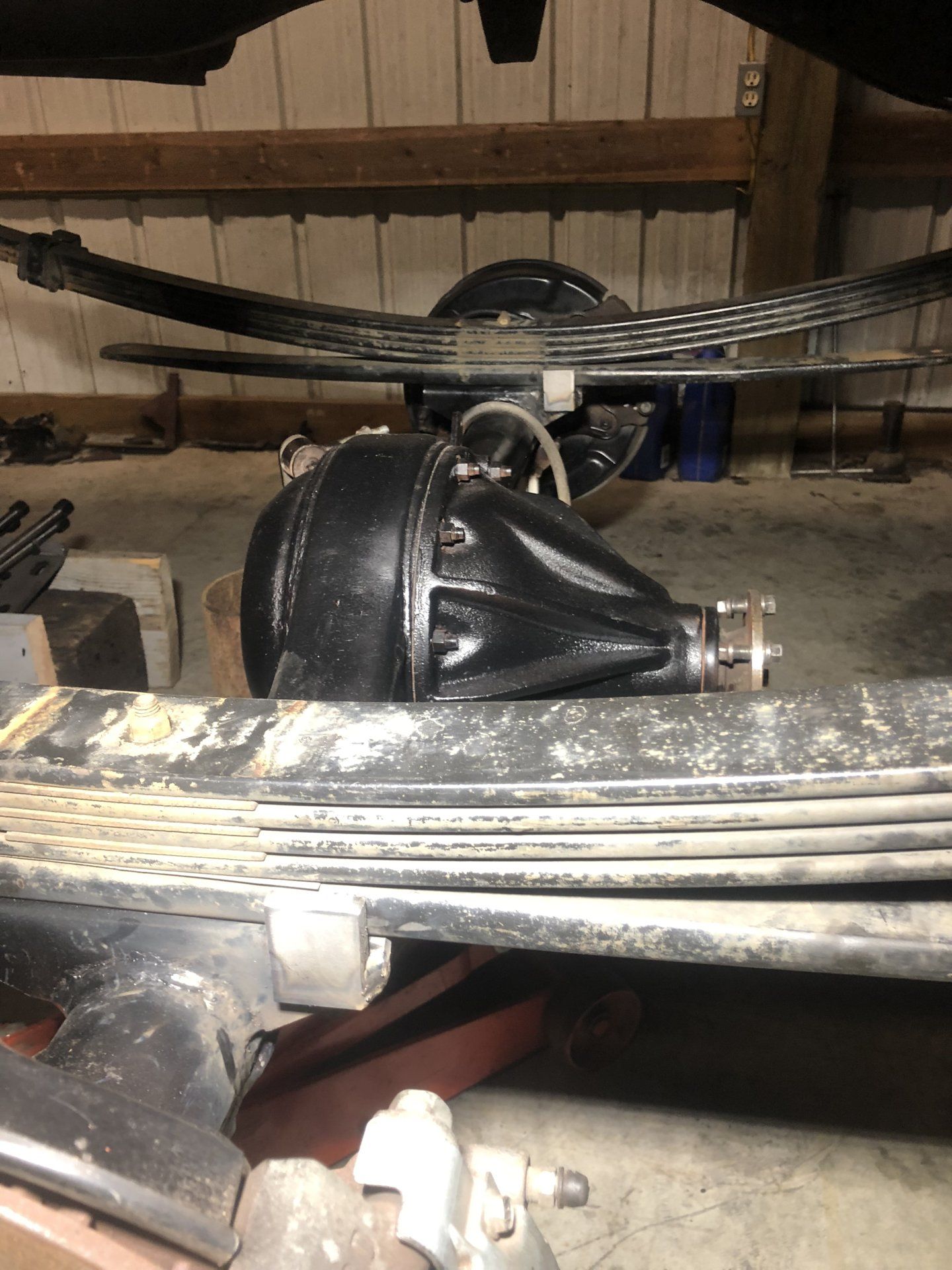

Finally getting the axle under the 60.

Regarding your rear disc rotors, no need to get fancy. The stock ones from Toyota work great.

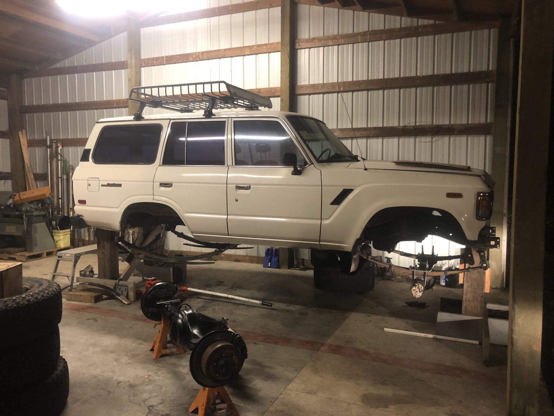

After getting a tree Bryan helped me get the freshly painted 80s axle under the 60 and into place for the u-bolts.

As for the antiwrap bar we have discussed it and will most likely plan to set one up after it's back on the road, whether it's a kit or build our own. The chevy 63s are pretty good at controlling movement but this is a torquey 4BT with a manual so it could become necessary.
For those tech junkies the transfer case flange is just about at 90 degrees. We will be redoing the tranny crossmember to get better vibration isolation and aim to keep that flange at about 90. To give us a little wiggle room to adjust ride height when we get it on the ground to see where the rear height ends up in relation to the front, we placed the rear axle flange at just up 2 degrees. We'll be reusing his current rear driveshaft that was already lengthened and is just a 2 joint shaft. This will allow us to drop to the shorter hole we made on the shackles or even recess the frame mount into the frame if needed and still have acceptable angle on the axle flange.
