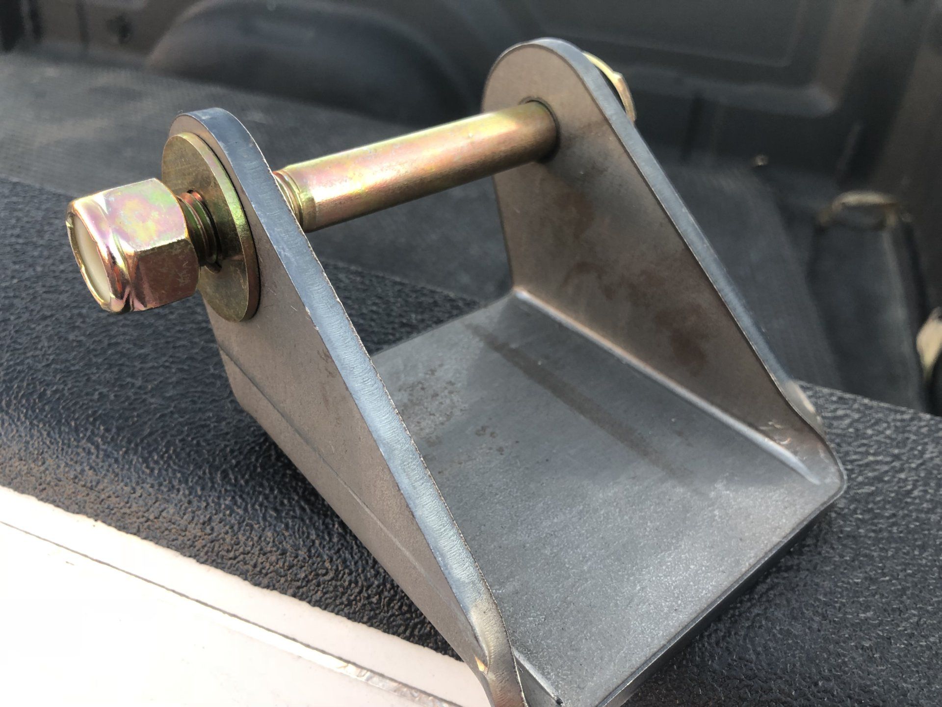

Cut steel to strengthen the front corner of frame for front shackle hanger.
Figuring out where to install the front shackle hanger.

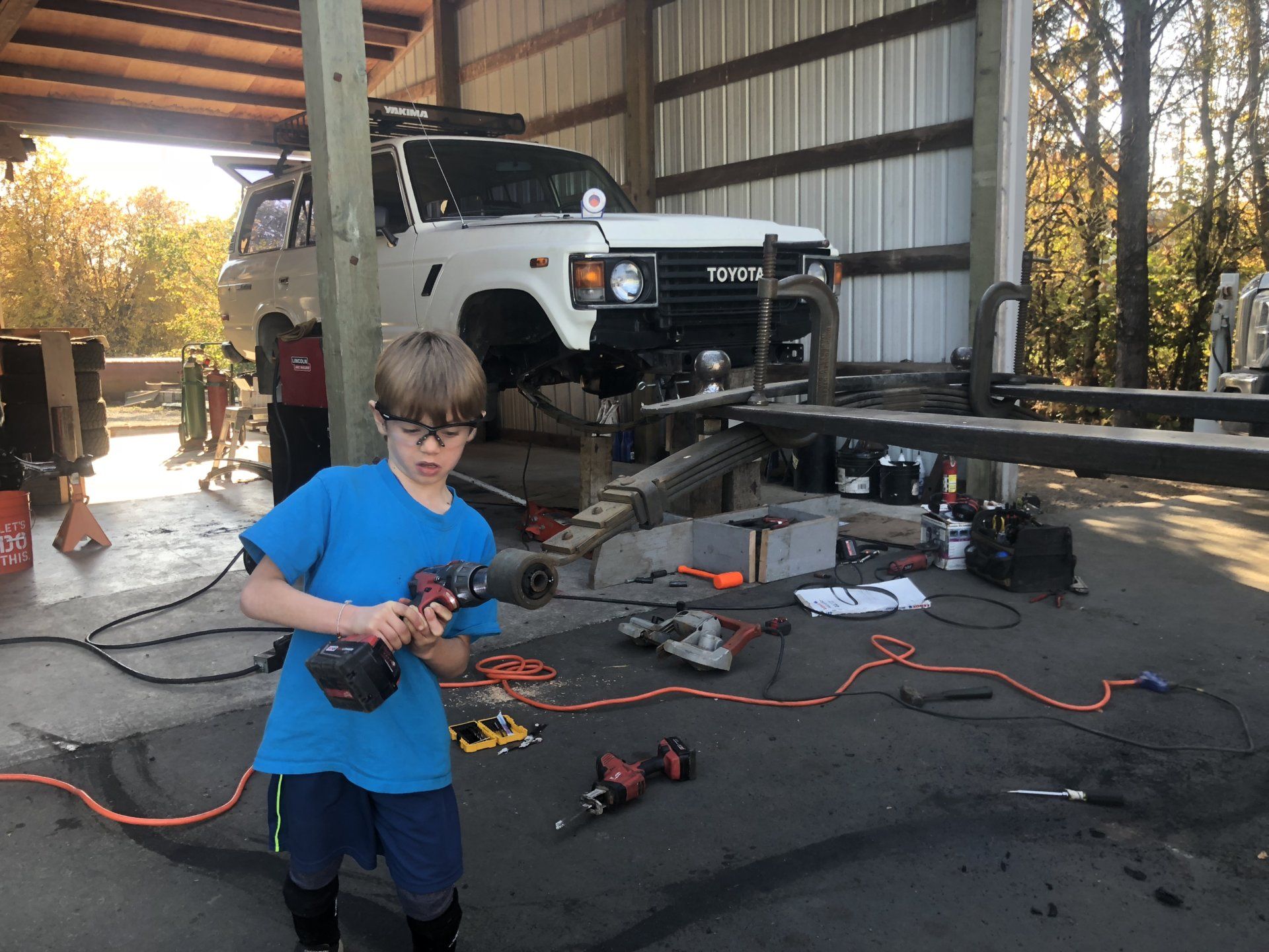

A much shorter day with just Mike and myself. Have a list of stuff to continue to prep. My son Ryder helped me remove more bushings and the collar from the inside of the 63 spring eyes. The portable bandsaw made cutting the metal collar out a breeze.

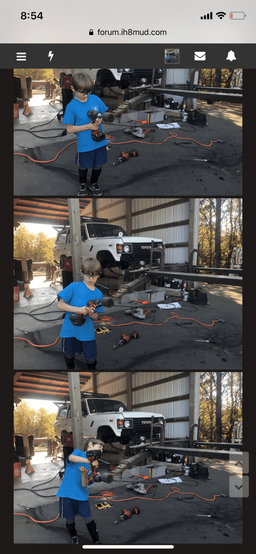

Took some pictures yesterday of my son hard at work on the Chevy bushing removal. Later I realized I caught the moments when the drill bit froze and the torque from the drill spun it into his face. He was alright but the wife and I had some great laughs with him that night.:rofl:
Whoa! Took me a few to take it all in! Wow! Bet it surprised him! Definitely by the look on his face too! Great wrenching lessen.
