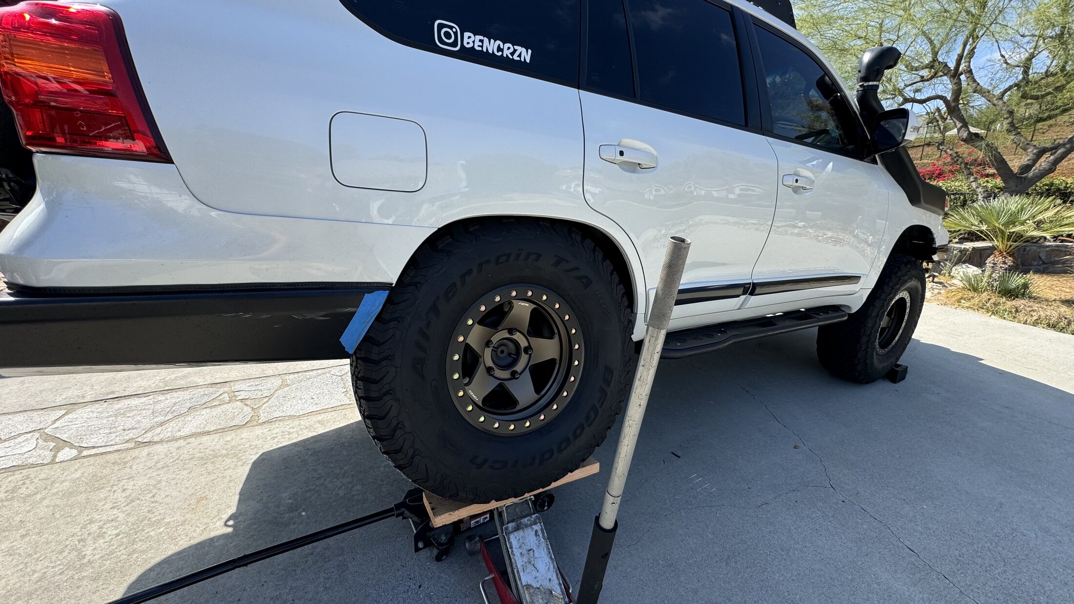

A little update on my 37's journey, the wheels are on the rig and it still fits in the garage! I am pretty happy about that. I did a little bit of trimming up front. Somewhat of a BMC. I just need it welded now. I don't have any rubbing around town the little bit of driving that I have done. I jacked up the rear a little to see how that will be impacted. I'll probably start trimming my dissent rear this weekend 🙄🫨🫢. I don't have any wheeling trips planned soon, but I really want to get the clearance issues dialed so I can see how much better this thing does on 37's on the trail.

I went little by little. I had to trim more and more on each side. Sawzall with a fresh metal blade was the best tool for the aluminum cutting. I'll get some more pictures for you of the finished cut. I feel like my spare swing out has more play in it than before when I swing it closed . I think I'm going to have to have someone weld on a replacement trim piece on that edge there for rigidity. The swing out doesn't move much while driving, but the idea of flying down a washboard road and losing my swing out scares me.
